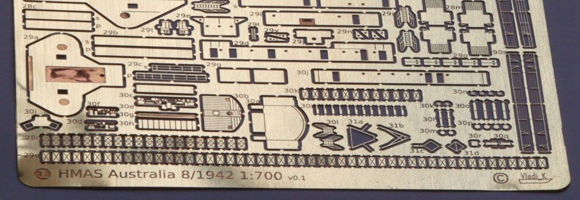

PE parts
The PE for Australia ended up to be my most comprehensive design so far, even more than my parts for USS Astoria. It included the complete forward superstructure and spanned over 2 and a half large A6 format brass sheets in 1/700. I didn�t count them but I guess there were close to 1000 individual parts. As usual, my first prototype version had some errors so I produced an improved version with even additional parts that I used for my build.
I did not make a complete deck overlay which I now think I could have done, but Aoshima�s deck planking is not bad. So the largest PE part is the overlay for the forecastle deck that was covered with wood planks, not metal as shown in the Aoshima kit. Additional large parts provide for a full replacement of the main bridge that was also different from Kent � more different than it appears at the first sight.
The PE set was designed for 1/700 but with the possibility of upscaling to 1/350 in mind. Upscaling would not mean degradation of detail in this case as the 1/700 is done in 0.1mm brass while the 1/350 would need 0.2mm thickness which would also bring an increase in the minimum dimensional requirements like line width, detail size etc.
Samples of my first attempt:
