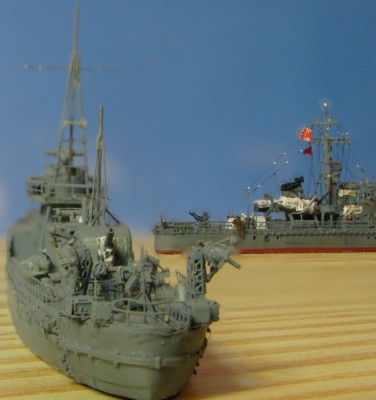

Here my progress:
I mentioned some of the PE I used. (FH=Flyhawk, Rb=Rainbow, R and LE=>Lionroar, VTW=Veteran Model).
This time I did not use primer. Some of the parts are only dry fitted. The masts are still very naked and I am still working on the stack.
Minesweeper07
Minesweeper07
Minesweeper08
Minesweeper08
In the background my nearly finished Subchaser.
Minesweeper09
Minesweeper09

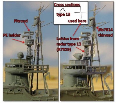

Here some more details added to the masts:
The crow�s nest is a short segment of brass tube which I modified by grinding and sawing with a Proxxon minidrill. The ends of the tube were closed with a layer of micro kristal clear. After painting this looks like one part.
Minesweeper10
Minesweeper10
I decided to add a type22 radar. There are some photos of W-19 class minesweepers prepared to receive a type 22 radar. There was already a cylindrical pylon. Here I used a nicer lattice structure which was one variant for Matsu-class destroyers.
Minesweeper11 (Rb=Rainbow, R =Lionroar).

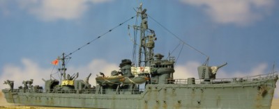

I continued with my version. Here a picture in the "David Bilek style". I am a non smoker and not so easy for me to organize a cigarette.
Minesweeper17
Minesweeper17
Here a picture showing the weathering, the addition of a flag and a little bit more rigging.
Minesweeper18
Minesweeper18
