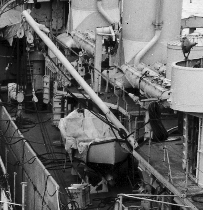

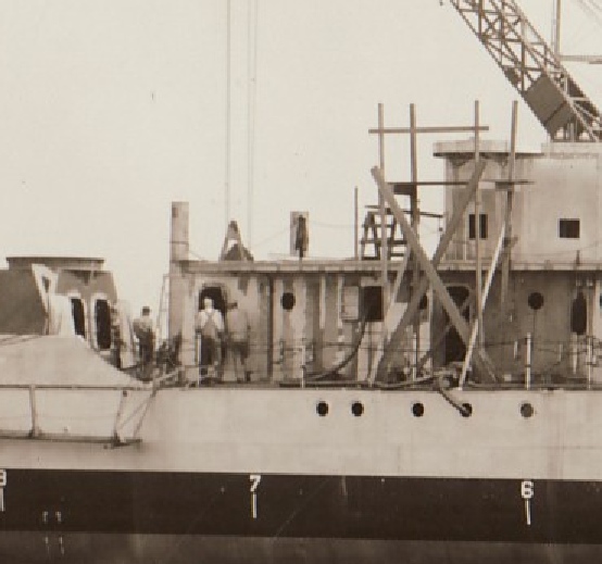

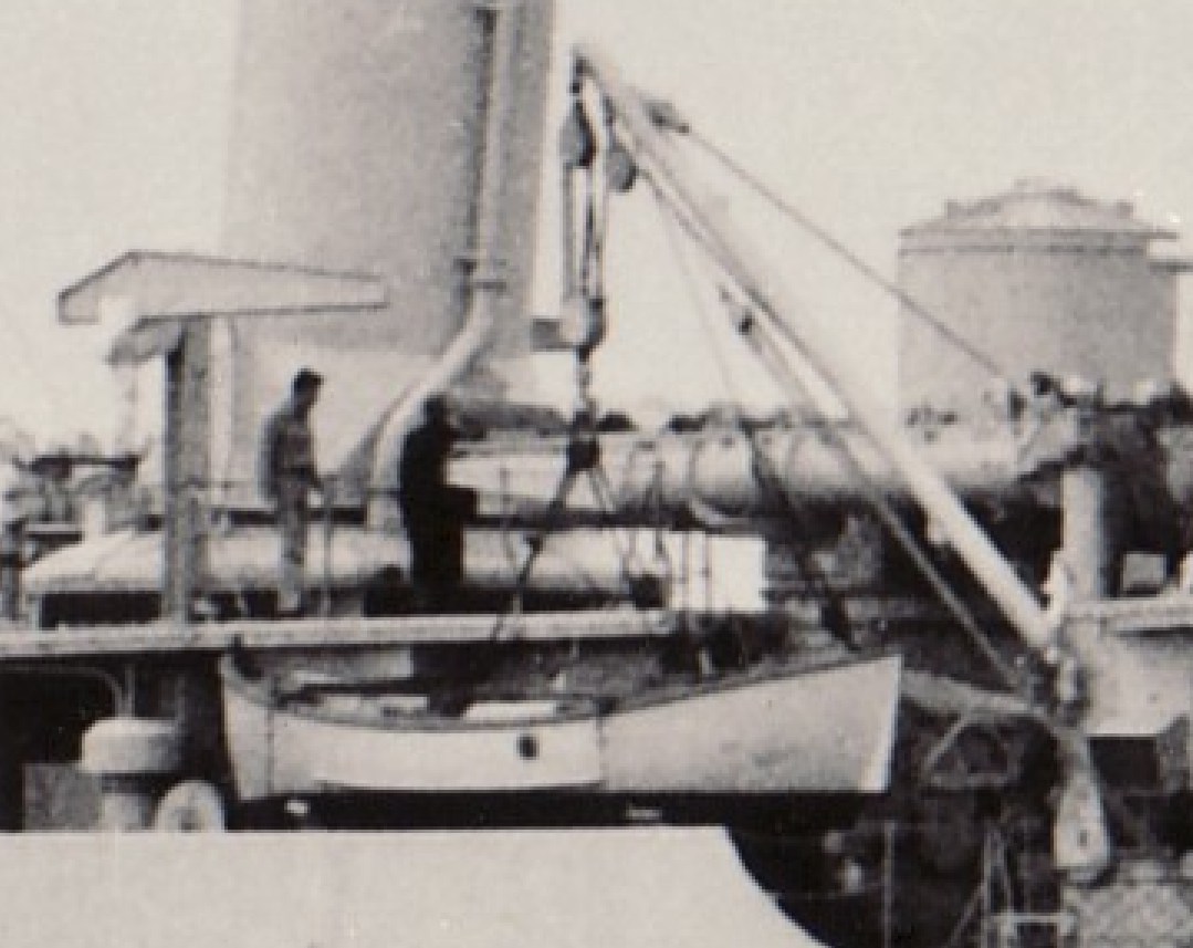

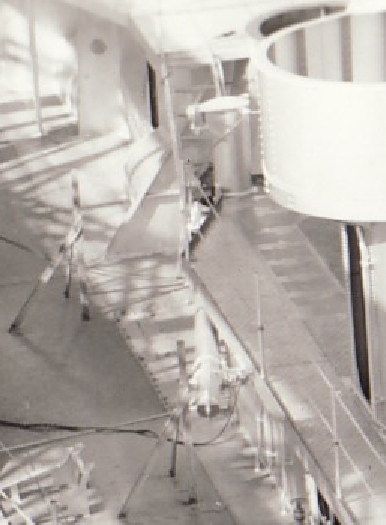

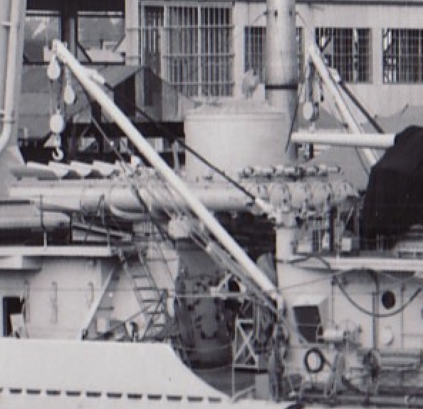

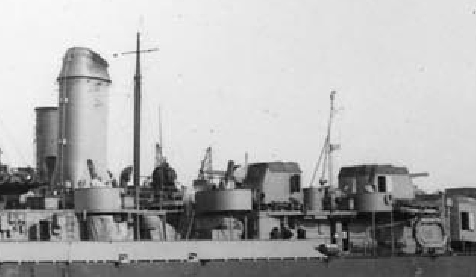

Rick, do you have photos of the boat cranes (booms? davits?) on the aft deckhouse of a 1940 Benson/Gleaves DD? R/David
- Posts: 3880
I don't have really good "detail" photos of the crane or that area particularly from onboard, for the earliest BENSON-GLEAVES units. It looks like the kingpost was located on the front corners of the aft deckhouse. Here are five cropped views from larger photos taken at various aspects and during different phases of construction that may help you.

Thank you, Rick. Those close-ups are great! R/David
