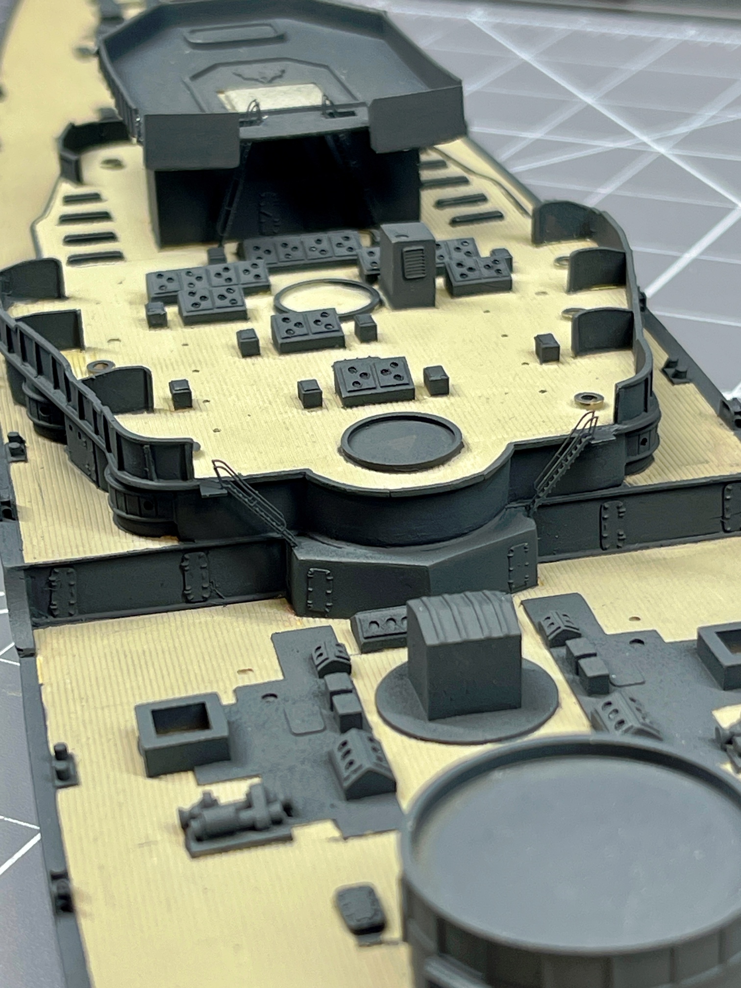

I also needed to make small platforms for the inclined ladders going down to the secondary signal platform. This meant I had to trim away some existing splinter shielding. That done, I added strips of plastic strip for the platforms. Those were painted, then I added inclined ladders from Infini. I also added a pair of Infini inclined ladders to the back of the main superstructure.
When all that was (mostly) dry, I nestled the hull in the seascape - which was now attached to it's case - and started filling in the gaps between hull and insulation foam, using tape to protect the hull from excess gel.
Prior to all that, I couldn't resist dry fitting parts to see where I was at. She's starting to look like a battleship!
