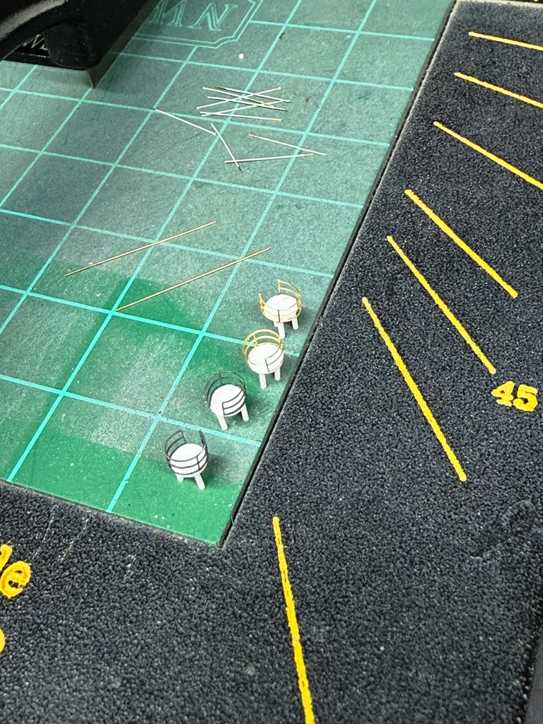

"Thingys" added to both cranes. Another round of painting next. Then some rigging from the top of the kingpost to the tip of the boom.
Given that I'll probably bump into these while handling, I decided to fix the alignment of the PE hooks right before attaching these to the ship.

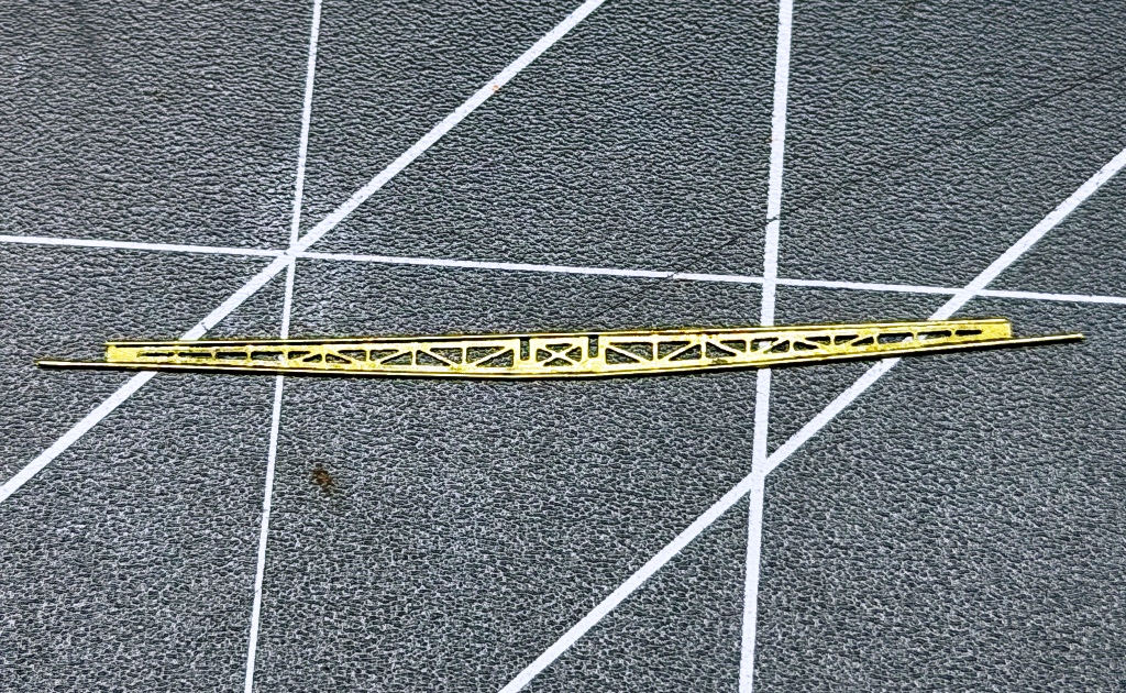

The small cranes on the quarterdeck needed some attention. I added PE ladders, wire booms, then grafted on the ends of the PE booms that came wit the kit onto the wire with CA. If I could manage to use a soldering iron properly, I would have soldered them, but solder and I are no bueno, as the folks in my office like to say.

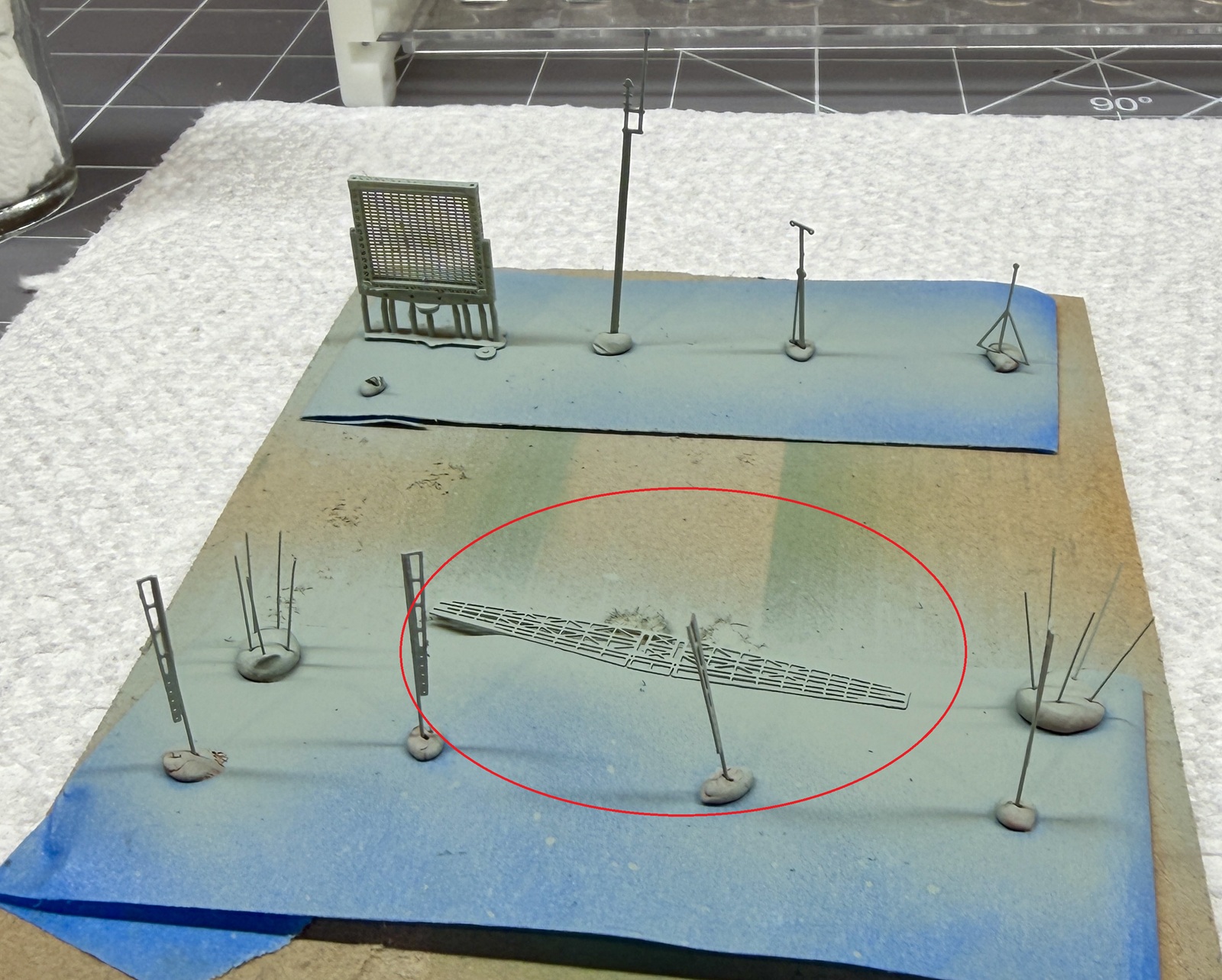

Broke out the airbrush and gave the funnels, cranes and boat stowage another coat of 5D.

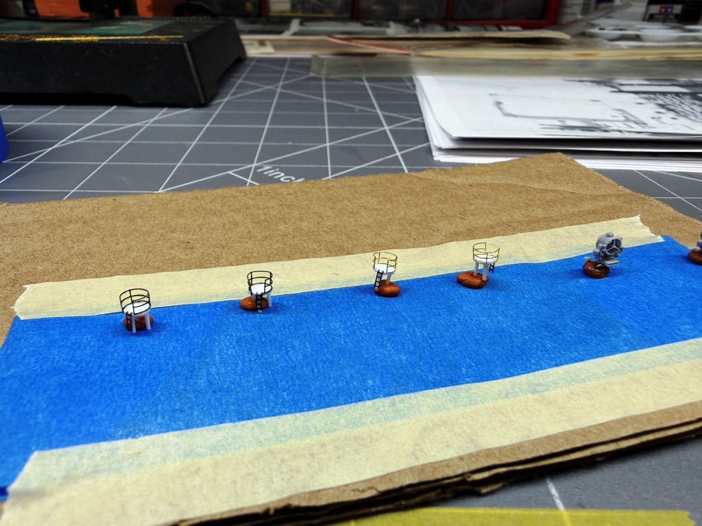

Also airbrushed ION figures white in advance of detail painting.

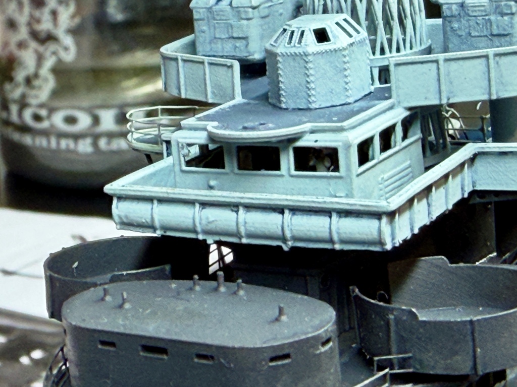

I decided to take the "f*ck it" approach, hoping that directors and other deck gear would hide any offending areas. Having thus decided to give no f*cks, I used slow set CA glue to attach the next level of the superstructure in place.
I then used water soluble putty to fill in the seams. After that dried, I used small Q-tips, dipped in water, to smooth down the excess.
I then touched up the paint, then added the highest level of the conning tower and the 3in gun tubs to this level.
I also added a pair of inclined ladders to the back of the superstructure, and filled in a seam around the back of the water soluble putty.

Looks good. The self leveled area just looks like it sees heavy foot traffic.

Regarding the splotchy painting photo - I get that when I'm spraying parts and the can is about to go bust on paint, or if the can's spray hole is getting clogged. You didn't say that you sprayed the items, but it looks like it to me.
One thing I'm finding out about Tru-Color enamels (lacquers) is that they don't work well when overpainting with a different color - i.e. touching up haze gray items/areas after painting with deck blue - the colors (in spite of drying overnight) tend to bleed into each other. I don't get this problem with Mr. Color lacquers.
But, your overall superstructure looks OK; I don't think those small areas will be visible once the model is complete.

The paint issue is barely noticeable anymore; it looks more like intentional aging.

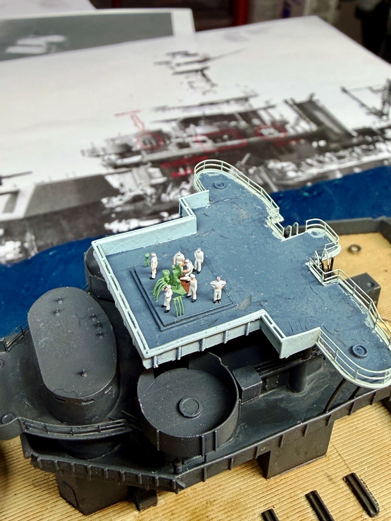

After my last update, I glued the next level of the superstructure in place. I then wanted to start railing the superstructure, then realized I was out of two-bar rails, so I had to order more.
While waiting for those to arrive, I finished one project and started another.
Bronco 1/35 M22 Locust
Tamiya 1/48 N1K1
Tamiya 1/48 N1K1
When those finally arrived, they were primed, and then I got to work.
Once the first two levels were done, I added rod to replicate the braces that help up the platforms for the small directors that were added to each side of the superstructure, as well as some small poles at the back of the superstructure, before starting the rail the pilot house level. I also added inclined ladders. The rails and the inclined ladders are from Infini Models.
The small directors are dry fit in the next two pictures, to make sure they clear the rails.
The pilot house level comes printed with the cage mast attached. In advance of adding this to the model, I attached the two Mk19 directors and the spotting top to this part. I will detail most of this - especially the spotting top, before permanently attaching to the model.

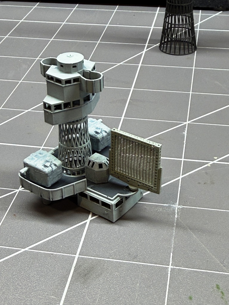

I dry-fitted the 3D CXAM radar that was graciously sent to me by another modeler (thanks Jim!) and found, to my dismay, that it doesn't fit:
I pulled out an Infini PE radar set, and this part matches up to that part, so I suspect that the small platform above the pilot house that housed this might be too small/short? I guess I can turn the radar a bit, so it will fit, but it will be obvious upon inspection that it wouldn't be able to turn.

The figures in the wheelhouse made me smile. I had asked myself the same question—whether they would still be visible later on. I can tell you: just barely. :cool_2:
