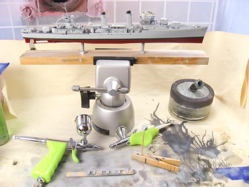

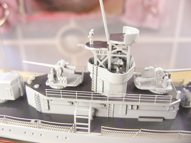

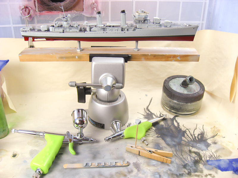

Back into the build. I asked elsewhere on the board about whether to rig before or after the gloss and dull coats. The answer was overwhelmingly to rig very last -- which is the way I've always done it, but just wanted some different opinions -- so Benson has now been Futured (I'm not sure that's a proper verb, but I like using it).
Not much to see in the photos except an overall shot with some equipment, and close-ups. I use Grex airbrushes now, and really like them. The Genesis is the button trigger model, small top feed color cup. I use this for the majority of my work, as I like to work in close with low air pressure. The top-feed color cup means you can work with very low pressure and very thinned paint (I'm not exactly sure what pressures I'm working at, but they have to be less than 5psi most of the time). The Tritium is for bigger work, the pistol trigger and the large side-feed color cup make larger surfaces and longer working sessions much easier to handle. The great thing about these airbrushes is that all of the interior parts, caps, needles, washers, etc. are all totally interchangeable between the two models. The only draw back to this setup is that sometimes I like to work REALLY fine, and when you get to a certain low pressure on these you get a little pulsating and the paint tends to dry too fast on the tips (I mostly use acrylics). I have a Badger Sotar 20/20 that I LOVE for those times I really need that fine control, but that airbrush has been broken for over a year now and I can't seem to get it resolved through Badger; so much so that they're sick of hearing from me and won't even answer my emails anymore!
The Future will cure today, tomorrow I can start with the washes. I'm going very light on the weathering on her because she's a full hull display. Just a wash to pick out details, a light drybrushing, and maybe some very very light vertical streaks on the hull to break it up a bit.

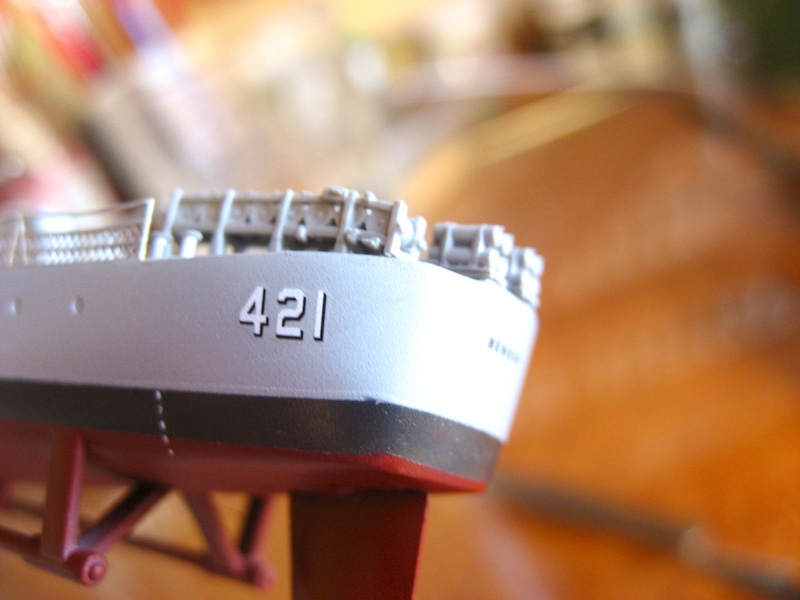

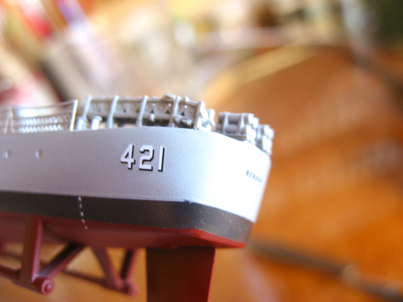

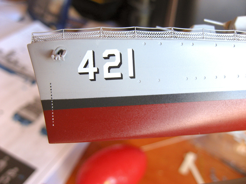

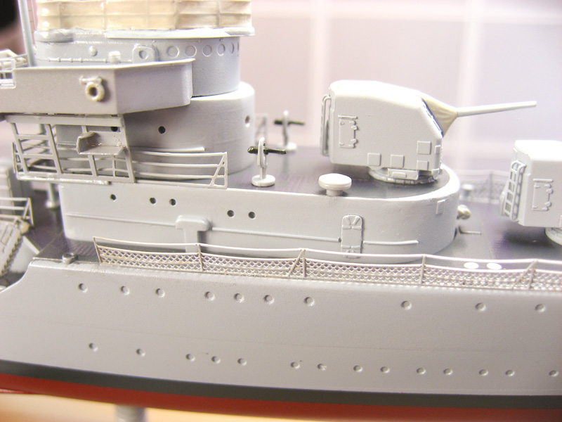

Just two photos today. Decals applied and anchors installed. I actually totally forgot about the anchors before the gloss coat. No worries, as once the decals finish drying, I'll go over them with a light mist of Future so they blend for weathering, and I'll hit the anchors with some gloss at the same time.

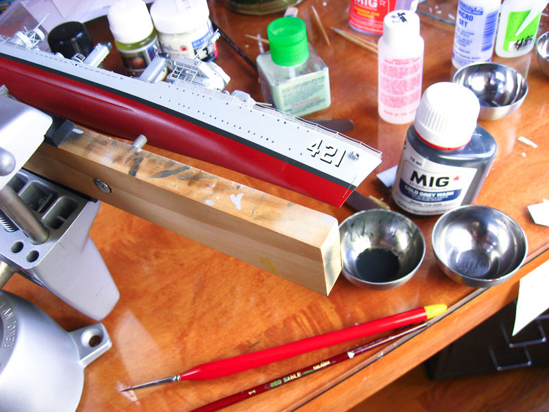

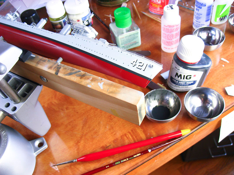

Wash in progress. As I stated, I love the Panavise as I can flip the model on its side to make sure the portholes get good and filled with wash. I don't like to drill out portholes, even in 1/350th scale, but you need something to make them pop.
I started using the MIG pre-mixed washes a year or so ago. At first I was one of those that said "How lazy can you be, to us pre-mixed washes?", but then I tried it once. They get a much finer grain to the paint solution than I have ever been able to achieve, and they dry in a matter of hours instead of the days it takes for a mineral spirits and oil paint mixture to set up. And yes, I've tried making washes with naptha instead of mineral spirits, and while it dried faster, it never dried properly, suffering a lot of crazing.

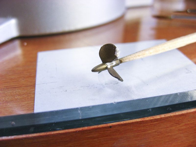

I've also done some work on the props.

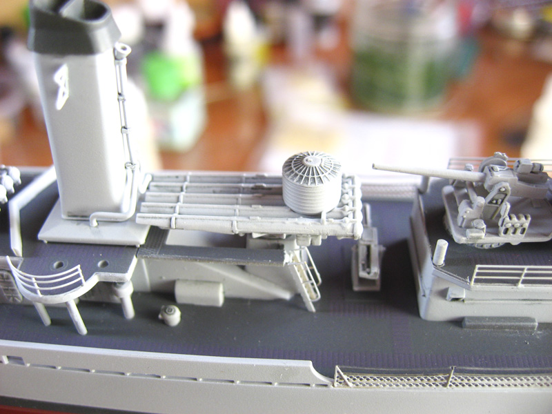

I allowed the wash to dry for 3 evenings, mostly because I was busy with other things, but it gave it a good solid finish before the dullcoat. I've been using Testors Dullcoat decanted out of a rattlecan for some time now, as it gives a perfect flat finish, but that stuff does stink to high heaven, and I just prefer to use acrylics when I can. Sargentx in this topic http://www.shipmodels.info/mws_forum/viewtopic.php?f=4&t=156653 introduced me to the Golden UV clear coats. The flat is dead flat, as much so as the Testors lacquer, maybe even a bit more. I cut it with just a small amount of their satin so that there's the slightest sheen and so that the blue hue to the paint isn't lost, and shot it, thinned 1:1 with water. I had to be careful as it was just a little too thin, so I'll change that ratio next time, but it came out beautifully. I have found my new clearcoats. (and don't worry, you don't have to buy them in big bulk jugs, they sell it in smaller squeeze bottles).
Next up was a drybrush. I normally do that with oils or enamels, but I'm running out of time, and went with Vallejo Silver Gray, cut with extender and glaze medium. It gave such a nice highlight effect, and so subtle, that I'm afraid I'll lose the shading if I clear coat again, so I'm going to move onto rigging next.

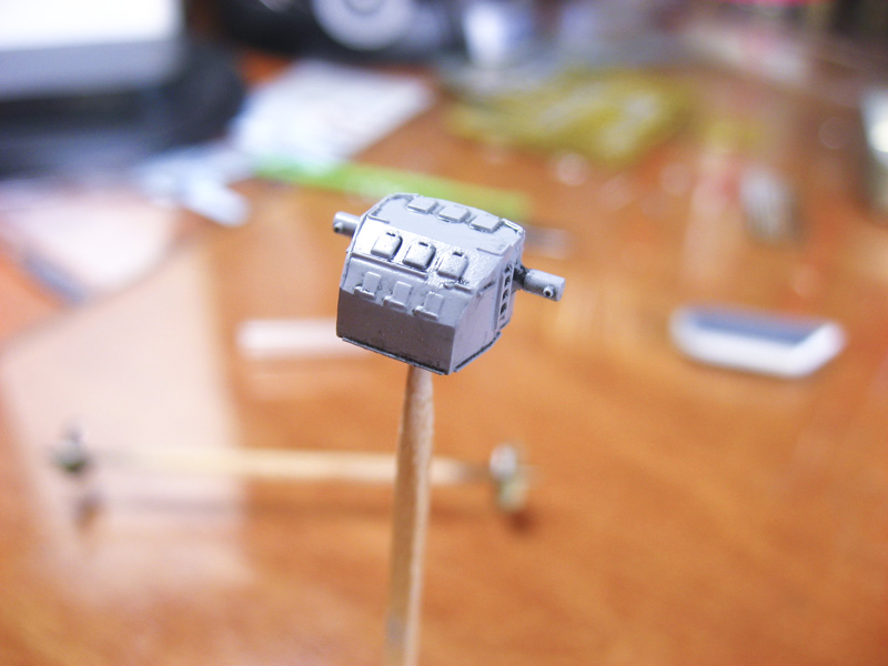

Rigging is under way. I started running the flag halyards, but then realized they'd be in the way for the mast stays, so I jumped to them instead. Using EZ line that's been snapped and then had individual strands pulled out of it. The strechyness (is that a word?) is very forgiving to work with. Another bonus is that, unlike the Caenis thread, the mucilage glue is sticking to this stuff wonderfully.
- Starting at the base of the gun director. I've drilled the tiniest holes I can and dip the tip of the line into superglue, then thread them into the holes. The clothes pin isn't full-sized, they're tiny ones I picked up in a doll store years ago, they have just the right amount of weight and grip for rigging work.
