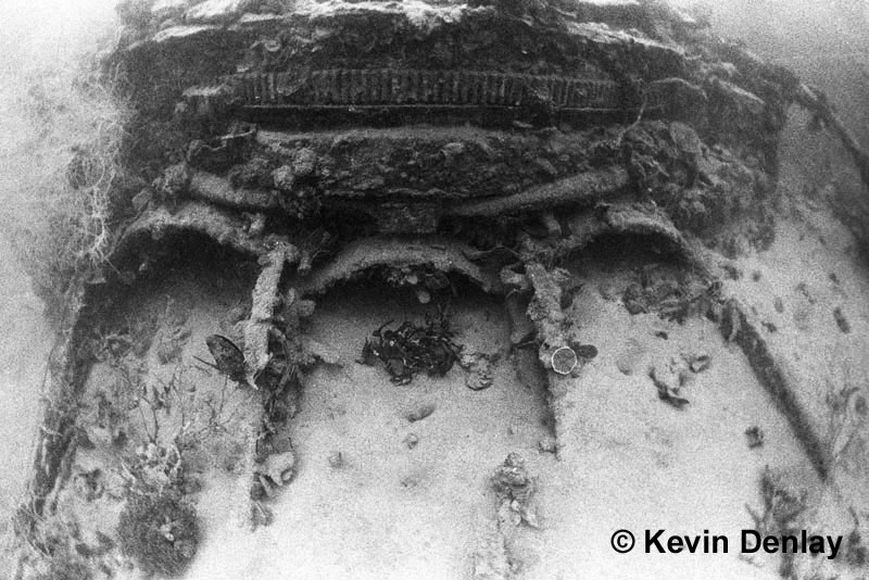

Dan K wrote:The raised, middle tube was a standard feature of the triple tube mounts used for the 61cm/24" torpedoes in the Mutsuki and Fubuki classes. It was eliminated with the improved triple mounts of the following Hatsuharu class ships. I don't know why this was necessary.
Below are some photos of said mounts on a Fubuki (Amagiri wreck) in a somewhat worse for wear condition. In the photo of the upside down mount (#1 mount) the center tube can be clearly seen to be raised.
Posts: 9128
Re: Calling all IJN Fubuki class (??????) Toku-gata fans
Post by Dan K »
Nice example, Kevin.
