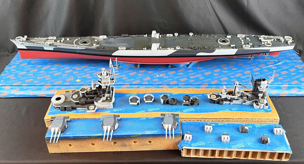

Limited time at the workbench, due to the aforementioned new job/long commute, but I managed to make "some" progress.
I finished tweaks on the spotting tops (added a handmade anemometer to the top of the forward one) and managed to get the catapult on top of turret 3 almost done.
Just have to make a few tweaks on the catapult and figure out where the last two PE platforms go, then it's onto the spray booth for all these parts (finger crossed).
Meanwhile, everytime I think the damn Alaska is almost done, I take step backwards. I replaced the following kit parts with 3D printed versions, as all of the kit parts were grossly under-scale, and poorly detailed: anchors (Model Monkey), 20mm (MicroMaster) and 40mm (Black Cat) guns. All these parts need to be painted and detailed before installation.
As I move along, I've been switching back and forth between these two builds, which is, of course, prolonging each of them. :doh_1:

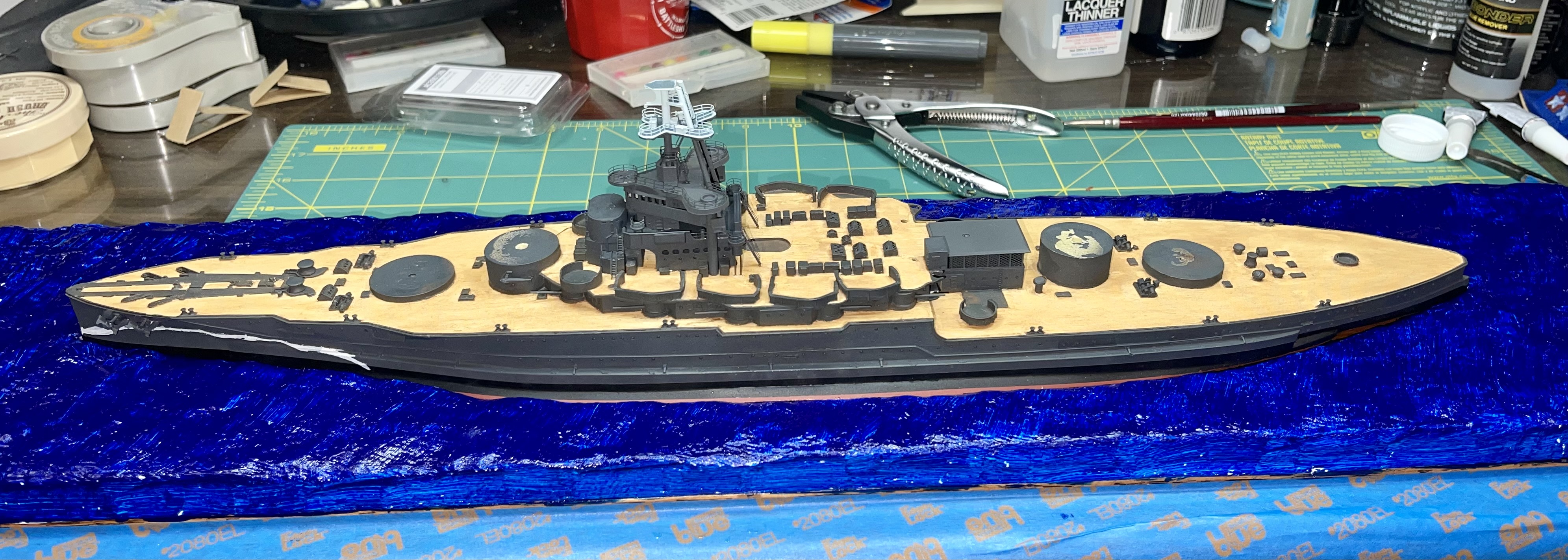

This beauty, the 700 Arizona casement deck, by Model Monkey, showed up today. Simply gorgeous!

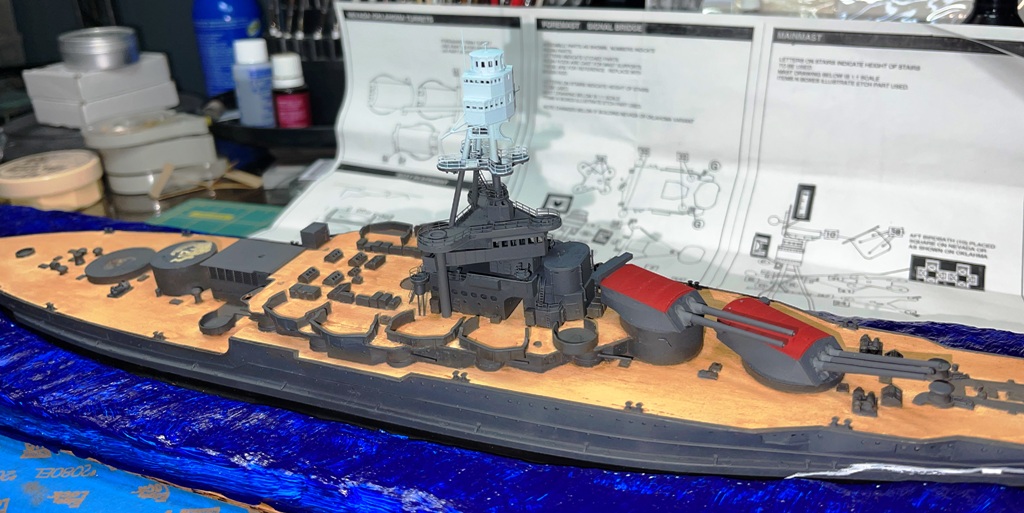

All railings and inclined ladders have been added to the forward superstructure. Time to do some touch up work before moving on.

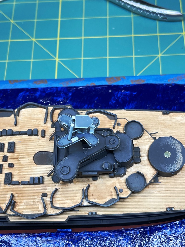

After touching up the bridge (I'm sure I'll find spots I missed later), I hit a bit of a milestone in this build, and permanently attached the forward spotting top to the forward superstructure. I'll go back and see what touch up works needs to be done once it's fully dry. After that, I'll decide what's my next move.
Turrets dry-fitted only
Meanwhile, Alaska has been given a flat coat, and is now that much closer to the finish line.
I'll "probably" focus more on Alaska at this point, seeing as she's further along, and I'd like to get her done.
