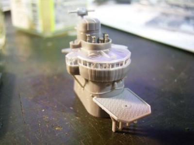

The FineMolds site has started an OOB build of the Amagiri. A nice point of differentiation with the Ayanami is the Amagiri's armor plating on the bridge facing. If you use Google's translator function, you get a somewhat decent translation of the commentary. See: http://finemolds.co.jp/kinsangatukuru/k ... kuru3.html

This looks interesting and the build thread looks very good. I have no knowledge about Japanese ships. Is it me or is the anti skid plating way out of scale? It looks grossly oversized to me.
Dave
Posts: 9128
Re: Calling all IJN Fubuki class Toku-gata fans
Post by Dan K »
If you are referring to the brass tiedown strips that hold down the linoleum sheeting, then, technically, yes, these are overscale. There was some variation but these were usually 30mm wide x 5mm high.
Personally, it bothers me less in 1/350 than in 1/700. And FineMolds has rendered it finer than most other 1/350 kits.

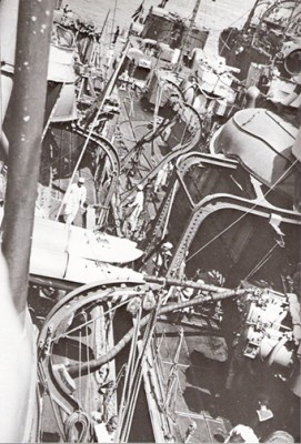

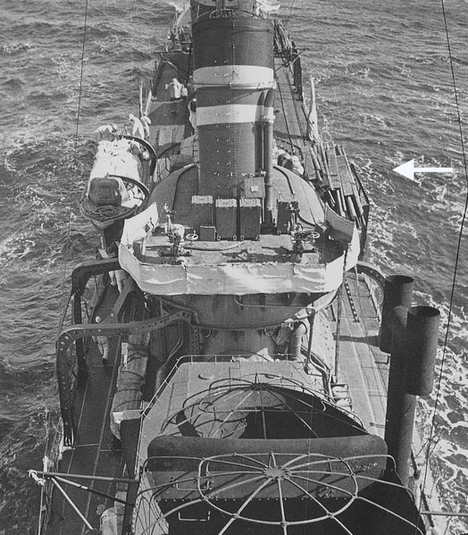

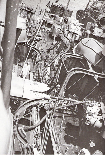

The real thing was visible up to a point, particularly because of the brass surface. In the first two pics below, notice the tiedowns at Oboro's stern, in the upper, center left of the photo. The perspective is probably 175' away.

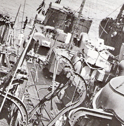

The third photo is just from above, and closer. It's instructive to compare the tiedowns in the center left to the size of the crewman's feet. Ignore the white arrow - from another discussion

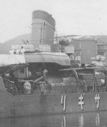

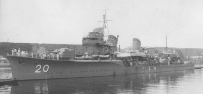

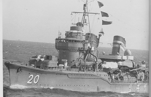

A very close examination of the photographic record shows (to my surprise) that the Type IIs, which were built initially with a small AA platform in this area identical to the Type Is, retained this smaller AA platform in front of #2 funnel as late as 1939-1940, while mounting either one twin 13mm or two singles. This platform was not widened to accomodate two twin 13mm mounts until sometime in 1941(probably during the same yard visit that their degaussing cables were installed). The photographic record for most of the Type IIs is fairly complete and in agreement in this regard.
A good example is taken from Sagiri, below, in which an exceptional view of her in 1940 shows one twin 13mm AA emplaced on a narrow platform. A year later, while she is on manuevers in October, 1941 with her DesDiv 20 sisters, the widened platform can be seen.
As a side note, it appears that the FineMolds 1/350 Shikanami may be in error on this point as the model shows the widened platfrom, yet the kit is supposed to depict her fit between 1936 & 1939.
While the photo record on the Type Is is a bit more sparse for the immediate prewar and wartime periods, I don't think it unreasonable that the same mods be apply to the Type Is as the Type IIs. We know Shirayuki sports the widened platform in March, 1943. My sense is that the platfrom was modified for all the Type Is and IIs during 1941.

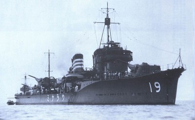

If you are referring to the Type A turrets, like on the pic of Uranami below, than all the Type I kits comes with a version of this turret (in fact, all the PitRoad kits come with a sprue with this turret on it, IIRC). Problem is that it's a bit small. The older PitRoad E-5 Equipment set has the best version of it. HTH.
