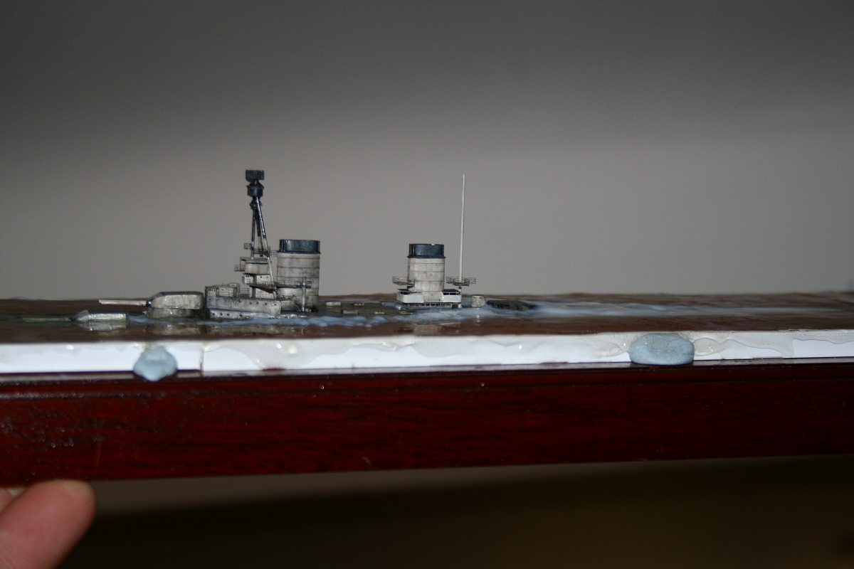

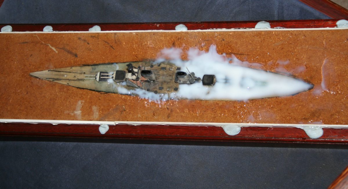

It really had dried out...!
so I have for the past few days been adding more THIN ( :big_grin: )layers...
I decided to persevere with the gl on this model as I did not want to start mixing differing media...
I had built a 'dam' around the base--partly t contain the gel--and partly to give a level to be able to keep the water to, I used a polished piece of styrene that I dragged across the gel to keep the level consistent across the baseboard.
from this viewing angle--( excusing the flash and lack of sharpness)
one can begin to see the desired effect....
:wave_1: :wave_1: JB

Bill Livingston
Posts: 730
Joined: Tue Jun 20, 2006 5:06 pm
Location: Cambridgeshire
Re: SMS Hindenburg on the bottom....Scapa Flow--around 1925
Post by Bill Livingston »
I've been waiting to see this!!!!!
Excellent! This is going to look wonderful.
Scary back there for a moment though wasn't it...:big_grin:
Bill Livingston
Cambridge
Olaf Held
Posts: 892
Location: Flensburg, Germany
Post by Olaf Held »
Looks like a giant surfacing sub in th second photo, HA!
That looks really great so far, keep it coming (eeeh... drying)
Happy modelling ~ Olaf!
