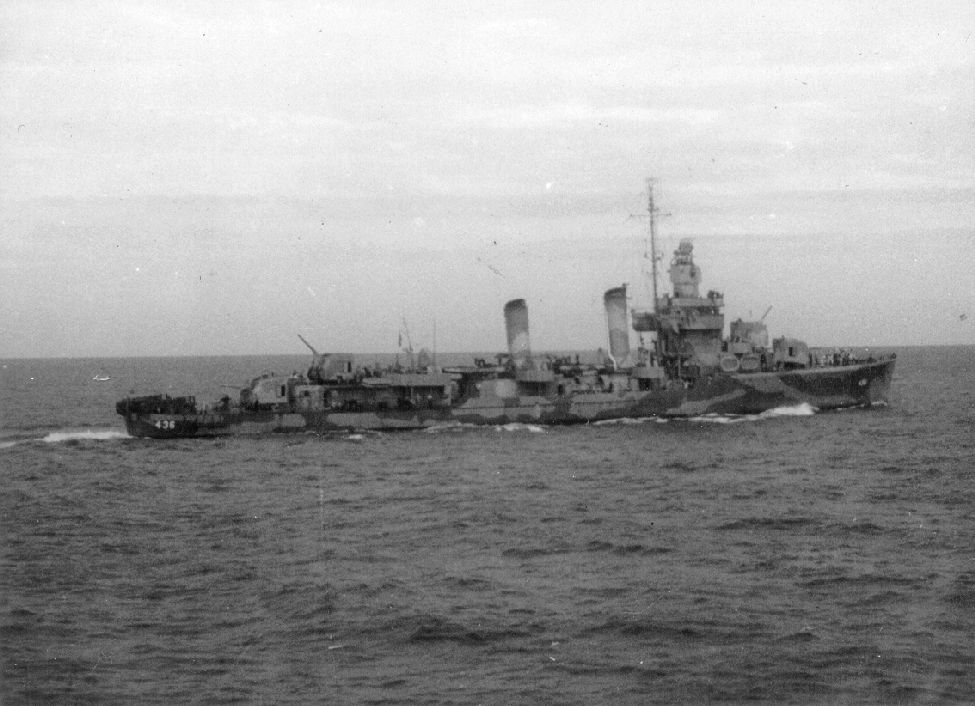

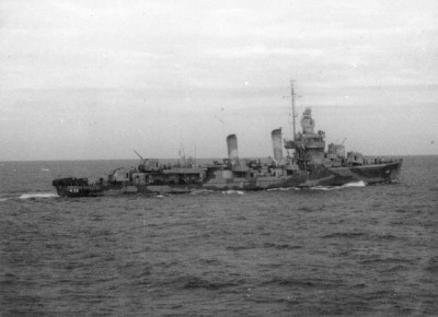

Posts: 3880
Post by Rick E Davis »
Don't trust John Barrett's illustrations for accuracy!!! The illustration you have has SEVERAL MAJOR errors for MEREDITH (biggest MEREDITH DIDN'T ever get twin 40-mm mounts!!!). Check out the images available at NHHC's website for MEREDITH at ...
.... http://www.history.navy.mil/photos/sh-u ... /dd434.htm ...
It looks like Barrett used this photo for his camo illustration, but not the ships actual configuration.
Also, here is a portside view of her sister GRAYSON (DD-435), these would be better guides on the "general" pattern for the Ms 12mod scheme MEREDITH was painted in.
Here is one of the last known photos of her sister MONSSEN (DD-436) before she was lost. It was taken by a HMAS ship in the Coral Sea area.

Oh yes I agree... The profiles r horrifically inaccurate!!! I just painted the camo over his illustration to get an idea of how it will look.
The only 2 photos if Meredith only show the port side which I draw up as above. I think I will be using the photo of the Monssen as a reference for the starboard side along either the extra 20mm by the forward stack.

Joe,
Barrett's illustrations are drawn to a single configuration that may represent a particular ship in a class and then used for multiple units by simply changing the hull number ... unfortunately for people wanting to use them as a guide they aren't correct. there is no excuse for making drawings this far off when there are photos and technical info and in many cases original drawings at NARA. Further, as Tracy said, you have to be careful that the photo isn't miss labeled or miss dated. The official photos in 80-G at NARA can be full of errors on the captions in dates and identities. A little checking can many times ID a photo and maybe even verify the date.
Reid,
If you look at the GRAYSON and MONSSEN photos ... the starboard and port side views show the patterns are close the same (in mirror image) on both sides. I was actually surprised to see that on two different ships. So I suspect you wouldn't be too far off mirroring the pattern seen on the portside to the starboard. Otherwise no views of her starboard have surfaced as far as I know.
