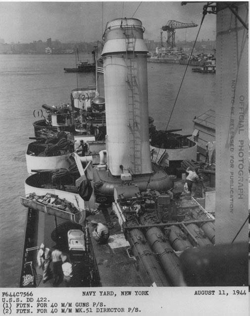

USS Mayo (DD-422) info needed
I have the Dragon kit of the 1945 Benson and would like to make her as the Mayo in late 1944, post Anzio rebuild. Looking at pictures of the Mayo it would appear that she has the aft Torpedo Bank removed and a platform in its place, but I can't tell what was on the platform. Does anyone have a drawing or a better photo that shows what should be there? Also, is the platform resting on the deckhouse or is it on supports.
Reading this forum I see that Rick Davis wrote an article in Warship International about the Mayo and her unique armament but I can't find that available for back order so if any one can answer this question from that I would be most grateful.

- Posts: 3880
You are asking for a couple of things here. MAYO was repaired and updated during her repair at New York Navy Yard. She had the AA augmentation of four 20-mm guns "temp" armament for service in the MED. The attached image from 15 August 1944 shows her with the platform that replaced the aft torpedo tubes. After this photo, MAYO had two single 40-mm guns added on the main deck. The second image shows the complete AA augmentation arrangement on NIBLACK.
Also, MAYO was unique in having had a walkaround extension to the bridge. See image 3.
Yes, in early 1945 MAYO had the extra 20-mm and singe 40-mm guns removed and the second torpedo tubes installed prior to heading to the Pacific.
