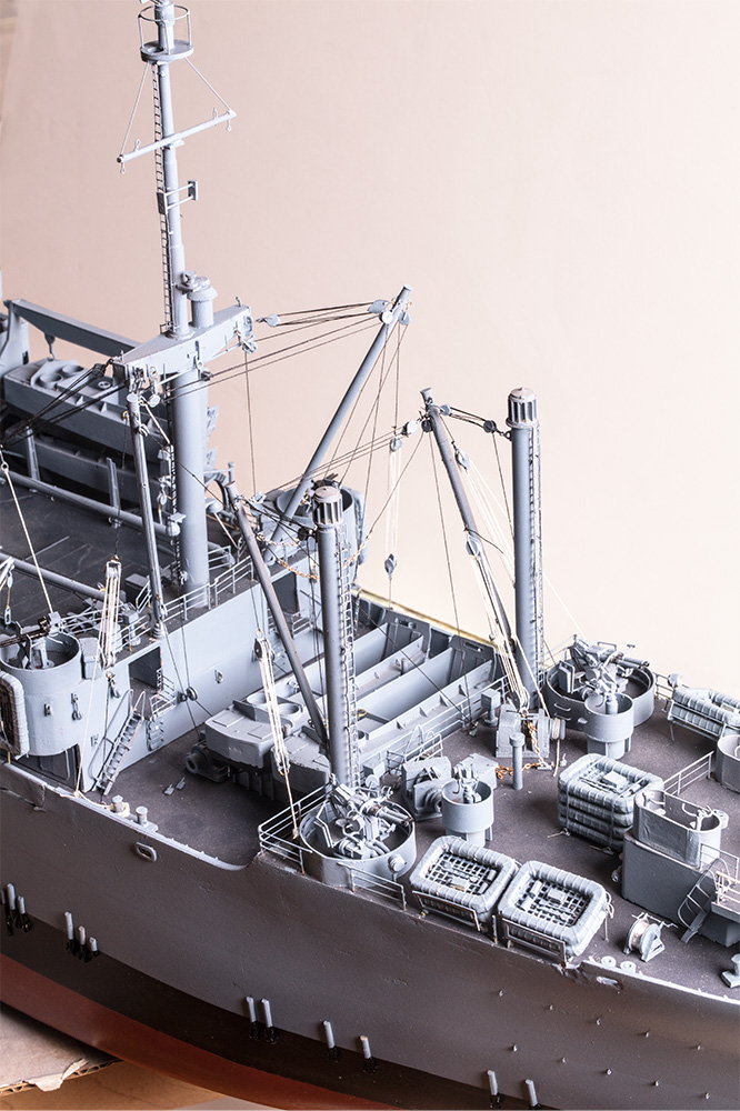

- Posts: 5068
Re: APA project
Bow on View of USS Randall APA 224

- Posts: 5068
Re: APA project
Thank you Hank! It's the period reversion to B&W. Something that helps a bit is "photo stacking" which in a longitudinal shot helps with the depth of field which is always a problem. I did miss one plane and it is little fuzzy in front of the bridge.
