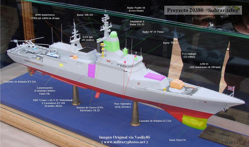

You could argue that the lay-out has something to do with the Krivak, considering hangar size/shape with the funnel as well as the AK-630s on both sides. I do think it is just speculation. One could argue about Talwar being the intermediate step, since she has such a funnel and lay-out (original ones with Kasthan, but later Talwars with AK-630s as well), but I doubt it's an immediate resemblance or ancestry. I think that's just a practical matter in their design. If I'm not mistaken they're also from a different design bureau. I suppose Gorshkov is more close to Stereguchiy and one could say Gorshkov has its ancestry in the Stereguchiy design.
It seems Soobraztelniy is the lowest model you've shown on the pictures as the pictures of the real ship don't seem to indicate the closure of the space behind the mast nor any VLS aft and 12 rather than 8 cells forward. The second model seems to show 12 cells forward, or at least 6 rows behind each other.
If she is that second model, then it's pretty clear she has kept her Urans as well (or are those Medvedka launchers?, they look more rectangular than the regular Uran launchers). If that VLS is a Klub, then this does raise some questions about her air defence though....

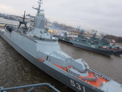

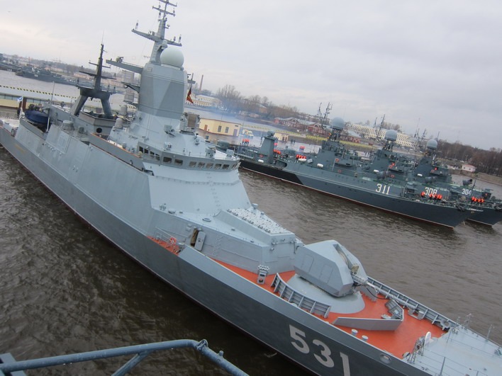

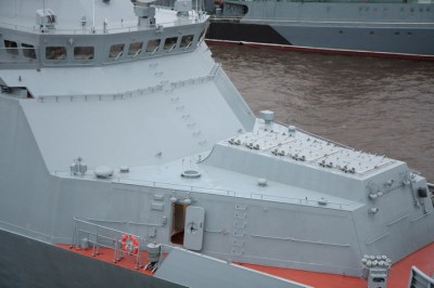

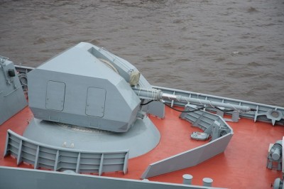

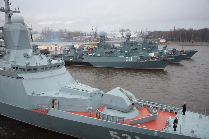

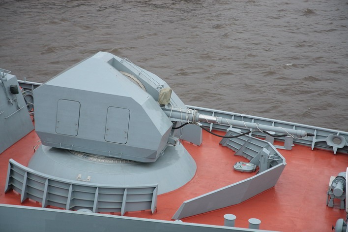

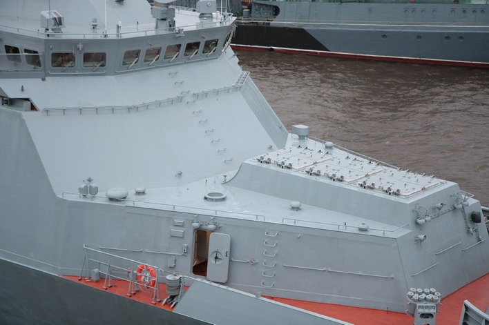

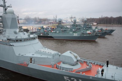

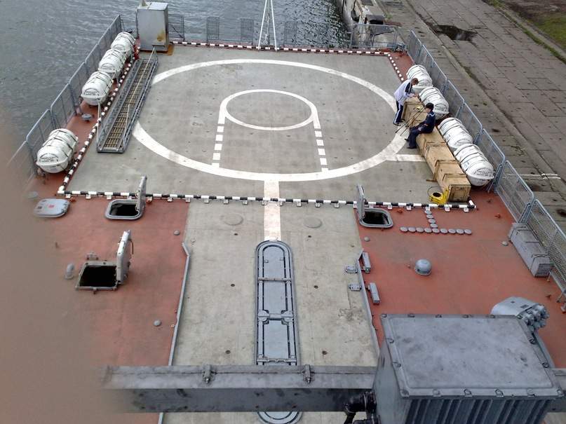

so I promised to keep you thinking. I've sent the spies of the Neptune Intelligence Agency out and look what they found.
I guess we have confirmation about the Uran being still there! And some nice pics of the forecastle including some deck fittings for detailing. Considering the size of the VLS I'd say it's Klub, perhaps VLS Medvedka, this would anyway make this ship very offensive with a very limited self-defence. Lots of anti-sub stuff (in version of Klub or Medvedka) and also anti-ship with the Uran still being there. Of course in the Baltic they'll have air cover.
Also note the wire lowering mechanism for the outward door near the Uran. The door seems to hinge outward, being lowered by a small wire. I never quite gave thought to that, never saw a picture of a ship with such a door hinged outwards.
I think I have to keep doing this untill you build at least one of each version
Kashtan stuff will be on the way soon.

yeah!!...these are great pictures to use for my arrangement drawings
i love you man
looks like the russians finally got the clue in getting the deckplating truly flat...
And what are they, are they riveting the superstructure together in the 3rd photo?

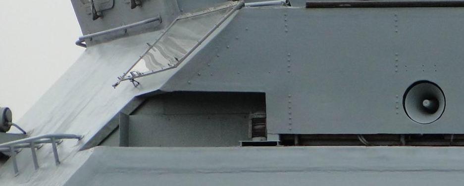

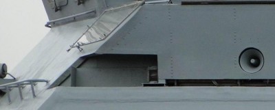

What is also quite interesting about that shot other than the rivetting is the way the screen slopes inwards as it goes down - see the ladder near the 630 to see where vertical is.SMART-L wrote:yeah!!...these are great pictures to use for my arrangement drawingsi love you man
Cheers David

Yeah, and the rivetting, well it's actually bolting, is also done on the fore deck, just aft of that VLS you can see it on the side shot towards the bow. Not sure why on some parts they bolted and other parts they welded. Perhaps it's a damage control method, the bolts will just rip out and the plate goes off without tearing, if you weld something like that it's likely to tear??

I think it holds the composite structures together Neptune. Makes it interesting to note that the part where the VLS sits in is made of steel (looking at the framing shining throught the deck) while the part on top of it containing the bridgedeck is made of composite. When looking at pictures of the unpainted superstructure on the first pages, you can see the difference in material used. Would be interesting to show these bolts on a 1:72 model. Scale 1:96 might be too small.Steregushchy Class was designed by Almaz Central Marine Design Bureau. The corvette incorporates a steel hull, composite superstructure and a bulbous bow. The hull is divided into nine watertight subdivisions. Source: navaltechnology.com

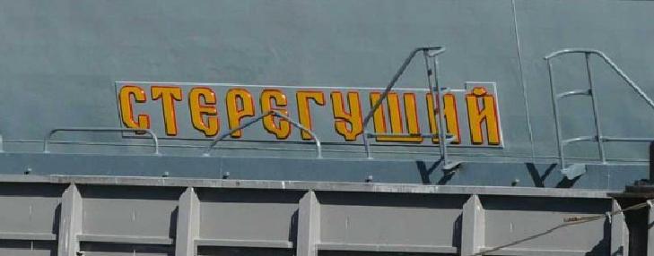

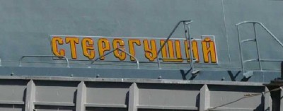

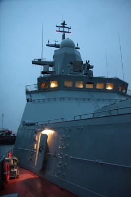

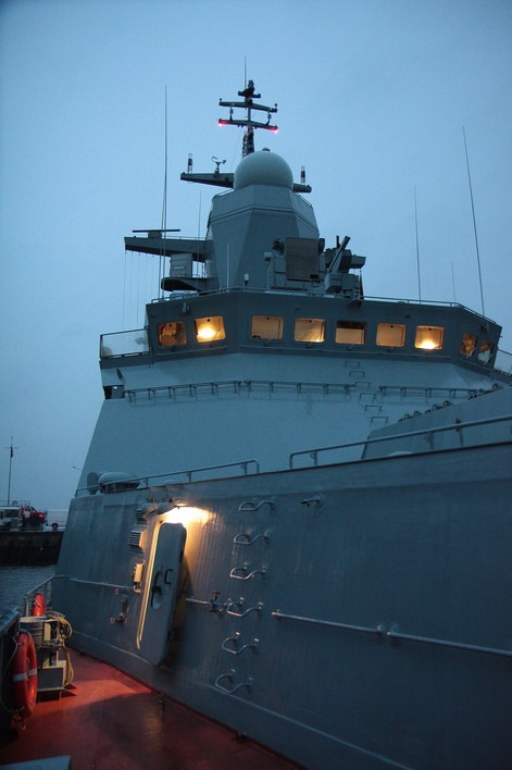

Hi Dave, wonderful project, I come here to make a few contribution, and hope it can be helpful.
Read the name STEREGUSHCHIY in cirilic:
And observe, in the edges, there is some RED, not only yellow............
I sent you some Private Message.
Detail here:
Nice regards: Jimmy
Detail here:

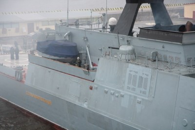

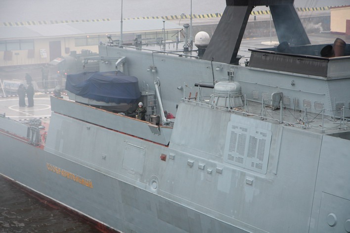

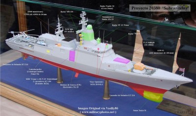

Soobrazitelny
VLS is REDUT System ( 9M96 missiles )
http://warfare.ru/?linkid=2179&catid=271
More details here:
http://www.youtube.com/watch?v=EfLD_aXTjUE

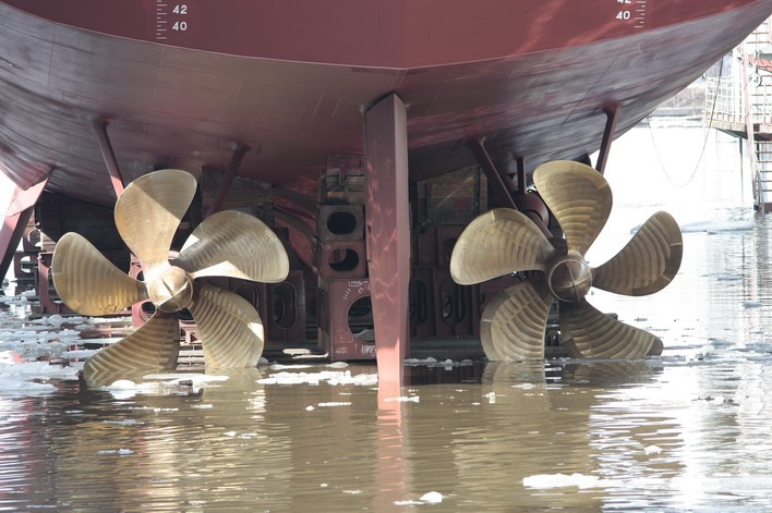

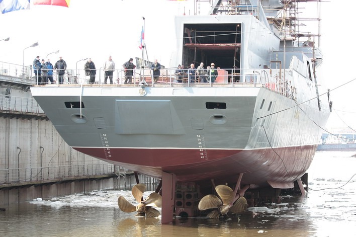

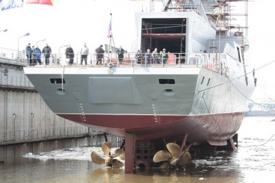

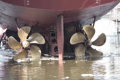

More photos here, but this time it is the "BoikY", the third unit of the Project 20380:
http://www.militaryphotos.net/forums/sh ... 9/page2856
There is a nice close in the props ( left hand port, right hand starboard, hub in Philips screwdriver shape ):
More pics here:
http://forums.airbase.ru/2009/01/t65924 ... hij-4.html
More pics here:
