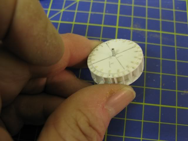

The first task is to assemble section 2 the mounting .
The base of the mounting is circular and around the edge are 20 flange pieces cut to the hight of the inner disc .
At 4 points the flange pieces are spaced quite close together .
The rest of the flange pieces are fitted around the edge .
With all the flanges fitted the centre point of the base and each of the 3 upper discs is opened up to 3mm
A centre pivot of 3mm aluminium tube is added to the base encased by a styrene tube for support .
With the lower part of the mounting prepared the upper discs can be added.
To be continued --------------

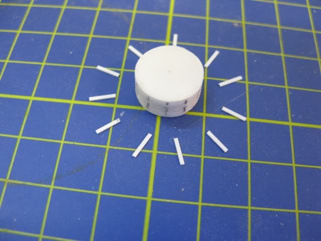

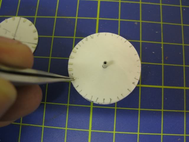

The next task is to fit the 1st of 3 discs . The 1st of which is a mirror of the bottom disc onto which the mounting is built.
Around to edge is a series of what I thought where bolts or rivet heads but looking a little closer they seem slightly elongated .
I estimated that there where 20 of these on the 1s disc with 11 on the 2nd disc.
The 3rd disc is ready to be fitted and onto that will fit the centre support for the tracking radar array
The mounting is now prepared . work can begin on the side drums and the centre support.
to be continued --------------

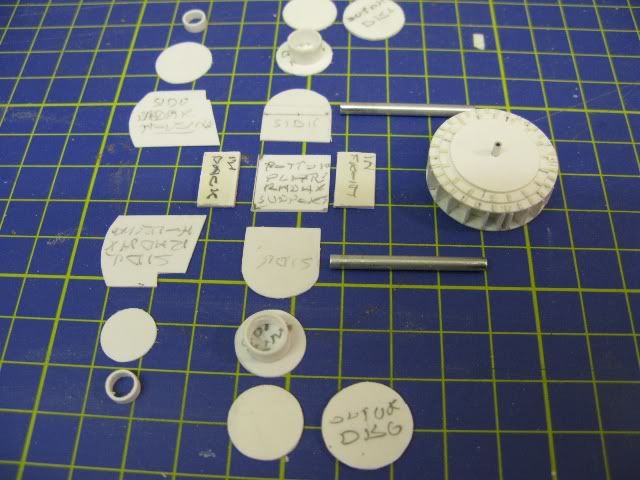

The mounting is ready we can move on to section 1 the side drums and section 3 the centre support.
I suppose the question can be asked "why didn't I use preformed tube to make the side drums� The answer is Evergreen doesn�t make the size I need so it�s bespoke to the diameter required at 1:72nd scale. It really is as simple as it looks.
The centre support in its very basic form consists of just three pieces, the base and two sides. Please note that the tops of each side are half round .The reason for this will become clear as we move along.
The parts thus far On the out side are two discs these will be fitted to the outboard side of the side drum .At the bottom are the 2 strips to wrap round the side drums.
With the side drums prepared segmented strips are cut and placed across the width of each drum, setting one end of each strip 1mm back from the edge .
The parts thus far but with the addition of the top cover for the centre support ,
Here the top cover is attached first to one side and when set folded over the top contours of the centre support and bonded to the opposite side .
That�s it for this session :thumbs_up_1: :wave_1:
