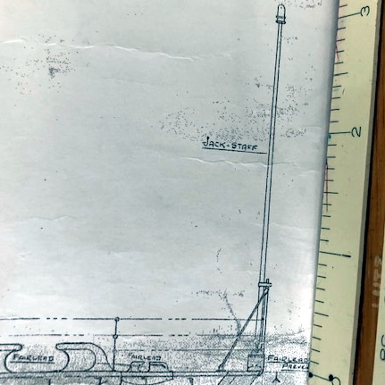

Regarding the assembly of the bow and stern staffs (page 3 of the instructions and a scan attached below), I assume parts 39A, for the bow, and 37A, for the stern, are bow and stern lights. If the bow components are assembled according to the instruction, the light would be behind the staff which, to me, would deminish the purpose of the bow light. While the stern staff assembly seems awkward, it does have the light aft of the staff which would make it clearly visible by a trailing vessel. Just wondering if I'm finding mistakes where none exist. Gotta get my model right.

The jack staff, when used, had two lights as I recall: One would have been atop the staff (and visible all around) and the second was behind the staff and could only be seen from astern. I've looked for some closeup photos, but cannot seem to find any with what I have on-hand. The best I can find are some somewhat distant shots showing the staff deployed and removed. I've included a rough example below.Grizly wrote:...If the bow components are assembled according to the instruction, the light would be behind the staff which, to me, would deminish the purpose of the bow light...
In reality, you have a choice here. Hood did NOT always have her two lower staffs (jack= bow, ensign=stern) deployed. I've seen photos with one, both or neither deployed. It depended on where she was and what she was doing/what the circumstances were. At sea, on a mission, it would not be uncommon to have the staffs stowed away (we have photos to prove this...just in case anyone doubts (sigh)). So, you can use none, one or both.
The staffs are rather like the six large stairways/ladders from the deck to the superstructure (two forward alongside the bridge from the focsle to shelter deck and four aft from the quarterdeck to the focsle deck). These were not deployed at sea...but somehow models of Hood look naked without them. So, you have many choices.

Right after posting my previous reply, I remembered that this sort of thing should be in John Roberts' excellent "Anatomy of the Ship" book (which I recommend any Hood enthusiast to add to their library...even though some of it is a wee bit dated, its still one of the best sources for details).FW_Allen wrote:Grizly wrote:...The jack staff, when used, had two lights as I recall...
Anyway, on page 99, figure F10 shows the jack staff. JR shows two lights- one atop the pole and a shielded one behind.
I also checked the official plans. Below is how the staff is depicted (just basics, no details). Even though it shows no rearward-facing light, I assure you it was there.
