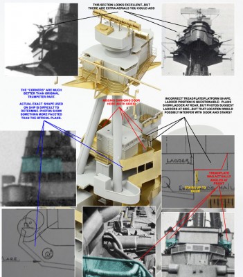

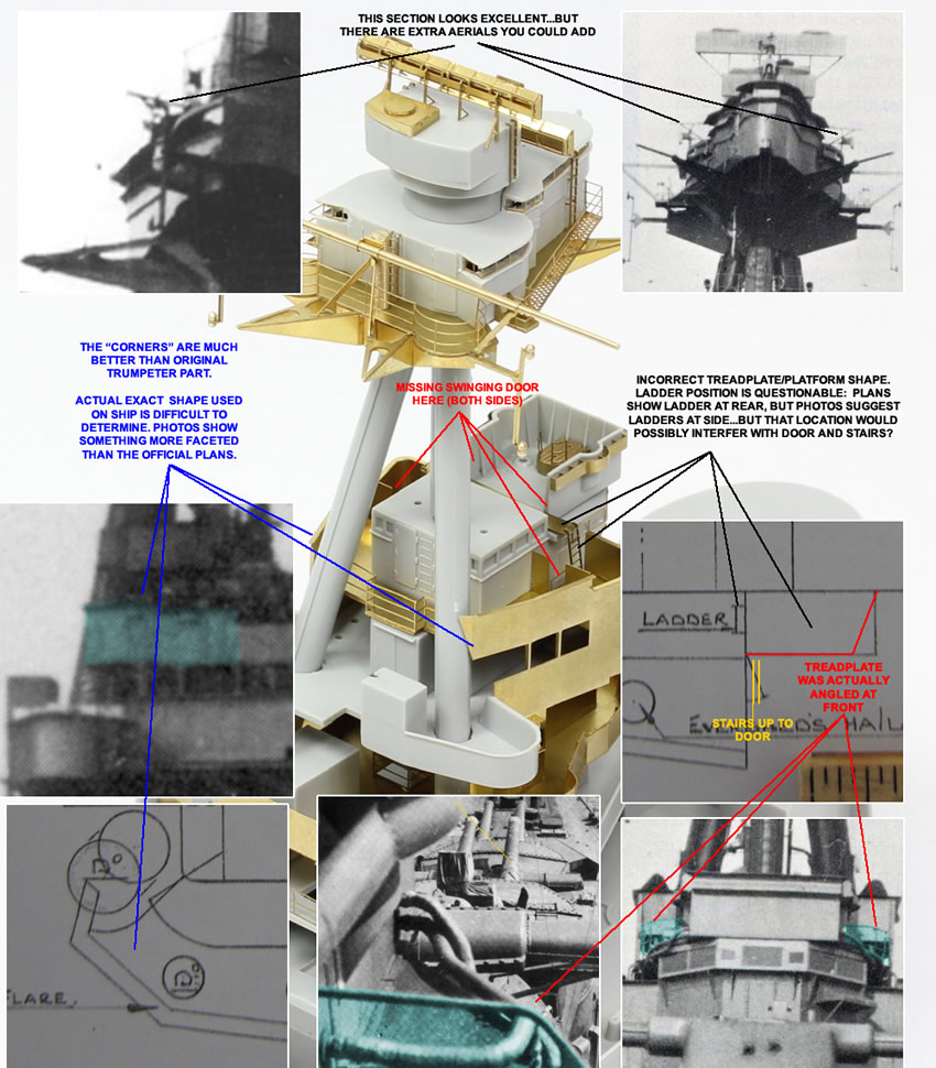

Minor Detail Corrections/Suggestions
Post by FW_Allen »
Hi Kim,
What you've shown us so far is excellent! It really is. There are a few very minor things you might want to consider though. I hope you don't mind, but I've annotated a few suggestions onto your original image of the 1/200 Trumpeter model bridge:
Starting at the top and going clockwise:
1. Your detail set appears to be missing the smaller antennae that were attached to the sides of the Control/Spotting Top. You can see these in the inset photos.
2. There were swinging doors between the Forebridge Deck and Torpedo Control Platform deck (in the splinter shield) AND just aft of the lower/forward Air Defence Platform (identical port and starboard).
3. The small treadplate (that your ladder is connected to) is too small and the wrong shape. The actual platforms (both port and starboard) were longer front to back. The front section was angled back. The front and at least half the side of the treadplate had safety railing. The inset copy of the official plans shows the correct length, but interestingly, they show the wrong shape of the forward end! The other inset photos clearly show that the front of the platform (well, the safety rails anyway) were angled back.
As for the ladder, the official plans indicate the ladder was at the rear end of the treadplate. Yes, I know that there are one or two photos that seem to suggest that the ladder was attached to the side of the platform the way you have it...but there is the problem of potential interference with the small steps leading up from the Forebridge to the Torpedo Control Platform. It might have been further forward...but then we know that there are hard rails in the way. So, perhaps the photos do not actually show ladders, but show other bridge equipment. Its difficult to say until we get a much clearer photo.
4. Your photoetch Torpedo Control Platiform is far superior to the Trumpeter version. Thank you for adding the higher deck and splintershield. The rear "corners" also look much better. Be advised however, that we're not certain that the corners were angled in that exact manner. Its one of those structures on Hood that are difficult to precisely pin down...the plans show simple angles, but photos of the ship show something more undulating. Of course, perhaps its just an optical illusion...but I see it in many photos...it seems "wavy" back there on the actual ship.

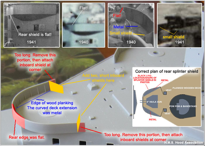

Please correct the mistake in the shielding with decking that allows for the removal of the incorrect splinter shields. I noticed on KA's deck that they didn't remove the splinter shielding and therefore the deck goes around the shielding. Man a picture would of been better than this ramble.

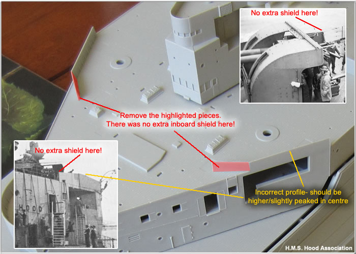

David Gatt wrote:Please correct the mistake in the shielding with decking that allows for the removal of the incorrect splinter shields. I noticed on KA's deck that they didn't remove the splinter shielding and therefore the deck goes around the shielding. Man a picture would of been better than this ramble.
Yes, he's exactly right. This particular splinter shield is very wrong...there was NO inboard section AND the outboard section is not the correct vertical shape.
There are also problems with some other 4" splinter shields forward as well as the one at the rear of the boat deck.
If Pontos cannot create replacement parts, can you PLEASE engineer your wood deck veneer to be the correct shape (or provide an alternate) and include the correct information in the instructions? This alone would be very helpful for us who want to use wood veneer.
