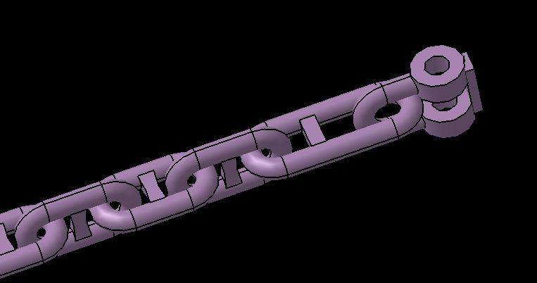

OK, I should have another small batch of 13.5 LPI x 15” bulk chain on my ebay listing tonight. Made a last-minute decision to travel to the Manitowoc show last weekend, which put quite a hitch in my “production process”!
Now, here’s a preview of a new design: Custom chain sets for the 1:200 Iowa Class. The images show CAD renderings for clarity, and actual initial samples.
The sets include:
2 runs of chain for the “anchor stowed” condition:
> 13.5 LPI chain links.
> Correct elongated link and bending shackle at outboard end. The bending shackle can be pinned to the anchor shackle with a bit of .020” (0.5mm) wire.
> Swivel link in the correct position (just aft of the middle chain stopper)
1 sprue with 6 + 2 extra chain stopper assemblies.
> Each stopper has a padeye, turnbuckle, pelican hook, and chain links. The upper jaw of the pelican hook is to be assembled onto the lower jaw, trapping the chain.
Using these stoppers will look better than the incorrect practice of simply using short runs of chain. Placing the pelicans under the chain (three places per side) will lift the chain off the deck locally, an effect which you can plainly see in any photos.
Questions:
> I have yet to see what Trumpeter provides for the anchor. I hope they include the anchor’s shackle?
> Not sure what Trumpeter provides for the padeyes on deck. Separate or molded on? Molded will require removal, and drilling of a 0.040” (1mm) hole for the provided chain stopper.
File comment: Elongated "bending link" and bending shackle, attach to anchor shackle.
File comment: Swivel at inboard end of "outboard swivel shot". From here, the first full 90 foot shot starts.

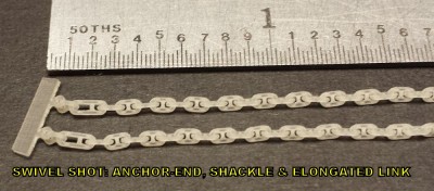

OK, I've added a few 1:200 "swivel shots" to the ebay listing:
http://cgi.ebay.com/ws/eBayISAPI.dll?Vi ... 1173646591
Includes 2x 7" lengths of 13.5 LPI chain, having the elongated link and shackle at the anchor end, and a simulated swivel link in the right place for Iowas.
Still working on those pelican hooks...

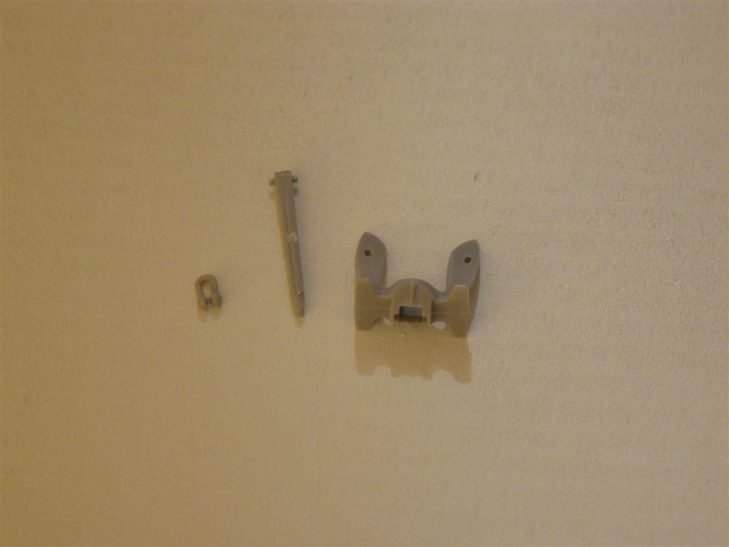

Pat,
Ok, here are a few pix of the Trumpeter 1:200 MISSOURI anchor parts:
Hope this helps,
