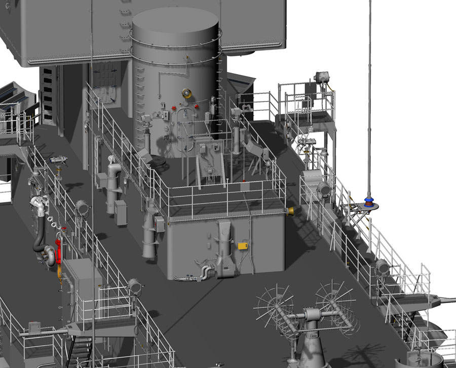

Making slow progress. May was incredibly busy - don't think I had time to do any work on the model. Less hectic now.
I have (almost) finished detailing the lower starboard side and detailed the lower port side. 470,000 entities in the drawing, with 3.7 million points. 325 megabytes - It is getting cumbersome to work with.
Still need to work on the O2 and O3 levels, and details at the aft end of the deck house. Lots of mooring line reels, more searchlights, binoculars and refueling stations. Then I will work on the details of the bridge wings and pilot house. Next will be adding the Mk37 director and a dozen or so life rafts. Finally the forward radar tower will be added, and the wire antennas, ship's flags and pennants will be rigged.

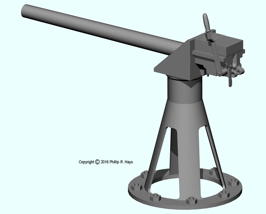

Here is another detail for the forward superstructure. This is the 40mm saluting gun. The OK City was a flagship and we visited a lot of ports and hosted many dignitaries - all calling for salutes.
The saluting guns were an oddity on the CLGs - they were positioned at different places on most of the ships. On the OK City and the USS Little Rock they were on small outboard platforms at the O1 level, but some ships had them on the O4 level.
I have never found plans for these guns, but photos from WWII ships and modern era ships show they were essentially the same over the years. I concocted this design from many ship photos and even a publicity photo for a movie. It is pretty much a "Heinz 57" variety.
If anyone has plans for the real thing - or good close-up photos - I would appreciate having them.

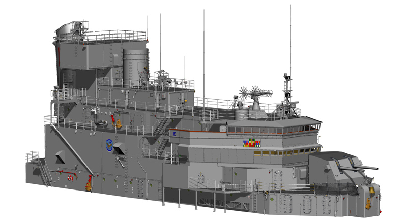

More progress on the forward superstructure. I think I have finished all of the nit-picking details like water washdown piping, lights, switches, wiring, etc. But there still may be a fire plug and hose on the port O3 level - I just don't have clear photos of that area.
Next I need to detail the open bridge wings - Captain's chair, wood gratings, pelorus, etc. Someday I will detail the enclosed navigation bridge and pilot house.
There are two more searchlights to do, and I need to add the big binoculars and the Mk 37 director. The last details to add will be about a dozen life rafts. That will increase the file size quite a bit and slow things down even more than they are now.
After that I will add the huge forward radar tower to finish it off - that will bring the file up to about 280 Mbytes. Then working with it will be very slow!
I ran into a snag a couple of weeks ago. When I started the forward superstructure several years back I mistakenly read a blurry dimension from a blueprint. Instead of setting a point 12 inches forward of a frame I put it 18 inches forward. After that I occasionally found things that just didn't fit right. Well, I found the error just as I thought I was about finished with the navigation bridge, and had to redraw most of the navigation bridge and flag bridge! But now things fit together nicely.
That was the whole point in creating the CAD model in the first place - to be sure the parts fit together before I start cutting material and spending time on the real 1:96 model.

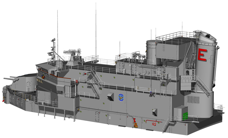

Finally, after nine months the forward superstructure is (almost) done. I say almost because there are a few details I am not certain about and I need to decide what signal flags will be flying and add two wire antennas.
315 Mbytes, 6,460,977 points and 847,080 entities in the drawing!
The majority of the work is done on the model - I'd estimate 95%. There are some details to add to the main deck on the hull - lifelines and such, and a bunch of nets around the flight deck. Then I can put it all together.
I want to create a set of 2D drawings from the model and that will take quite a while to finish.

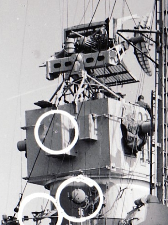

I was looking back over pictures of the Mk 37 director and noticed a detail that I had missed.
On the optical range finder arms there is a bit of plumbing. In some pictures it looks like solid pipes and in others I can see what appears to be sections of pipe joined by pieces of rubber hose with hose clamps. In the middle is what appears to be a solenoid valve.
My guess is that is is compressed air piping with an electrical valve. Perhaps it was used to blow water/dust off the lens, or maybe it was used to blow off the caps that normally were fitted over the lens tube when the director wasn't being used.
Does anyone know for sure what this was for?
The Mk 37 instruction manual says the optical rangefinder operator should remove the lens caps, but it doesn't say how. He could climb out on the side ladder and pull them off by hand, but the compressed air "ejector" could be operated from inside much quicker.
Note: The lens caps were attached to the structure with short chains (not shown) so they wouldn't be lost when they were removed.
This piping was not installed on the directors in 1941, but appears to have been common in late 1942.

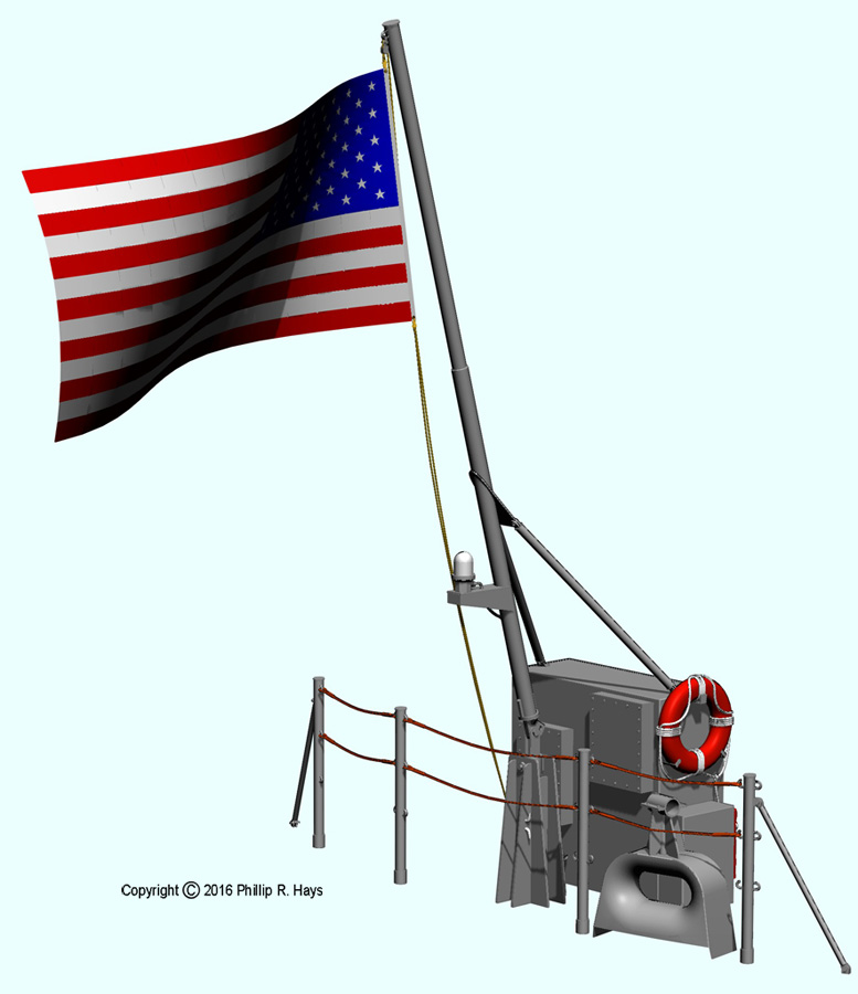

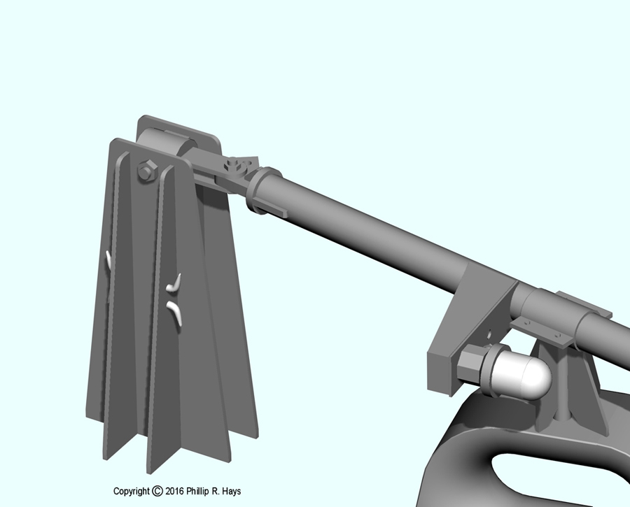

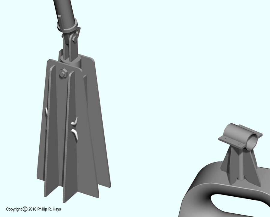

Here is the flagstaff on the stern again! I have found very few photos of the flagstaff and most were fuzzy pictures shot at a distance. None showed the area where the staff attached to the base. I had to guess how the mechanism worked for swinging the flagstaff horizontal to clear the helo pad for operations.
I was looking through a ship's cruise book and found a photo of the stern lookout. In the corner of the photo was the image of the hinge mechanism. Maybe this will be the final iteration!
