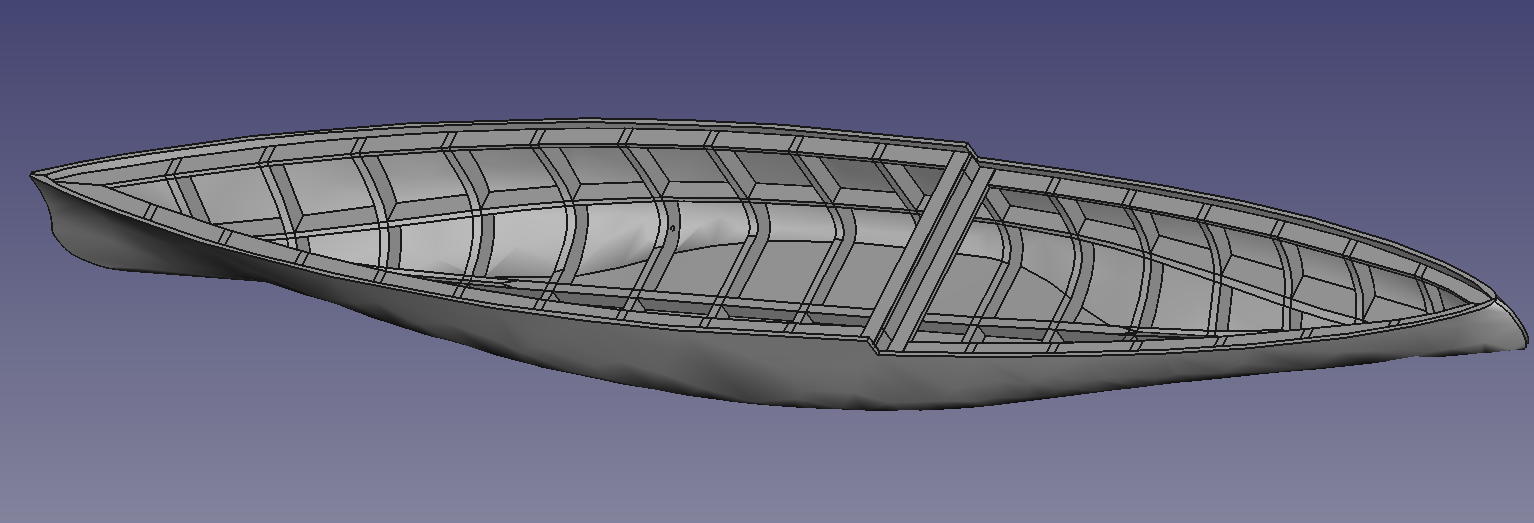

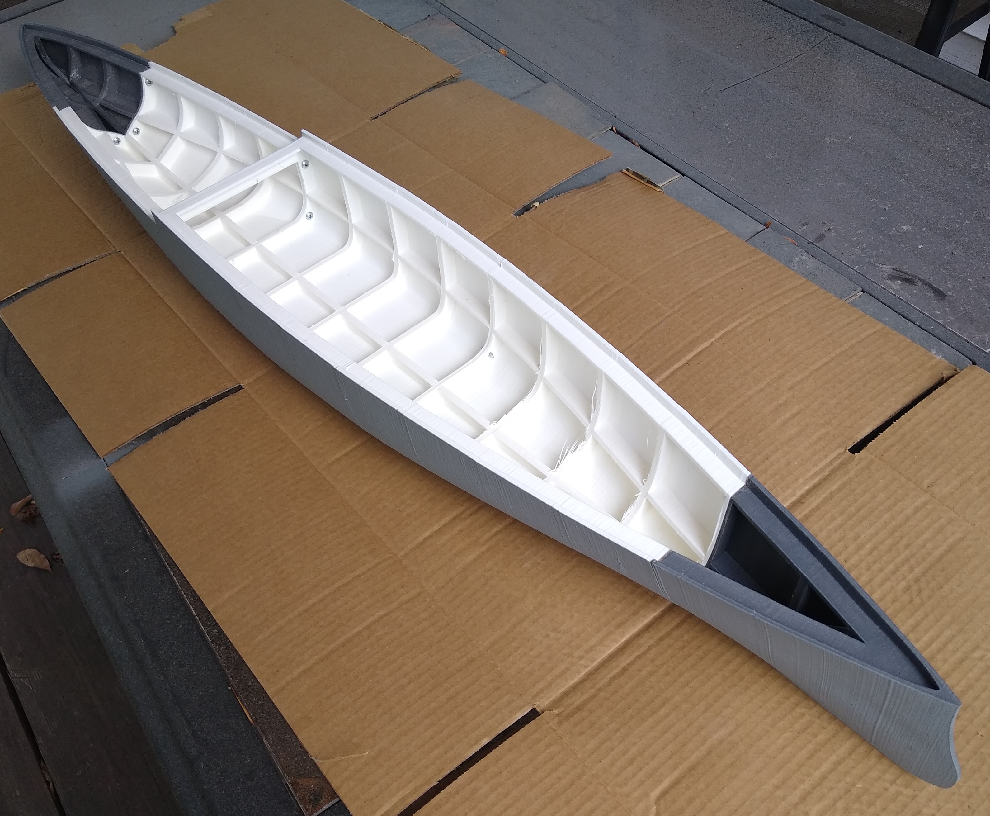

After seeing some posts on various forums about using FreeCAD to model ship hulls, I decided to give it a try myself.
My original goal was to make laser cut hull kits for 1:144 Scale RC Combat. For various reasons, I'm less inclined to actually produce those kits but, I'm planning to build a relatively detailed RC version.
It all started with some scans of the plans that I found online.
I'm pretty happy with the shape of the hull that I've come up with and my 3DP prototype came out pretty well, IMHO.
Currently, I'm working on deck pieces and superstructure parts.
C&CC Welcome.
C&CC Welcome.

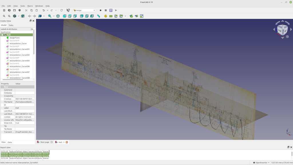

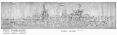

I found a scan of the hull lines for "Cruiser no. 785", online, that was sufficiently high resolution to trace.
They could be wrong but, they seemed to be close enough to match up with the other references I used.
I'm curious if you may be able to confirm my guess?

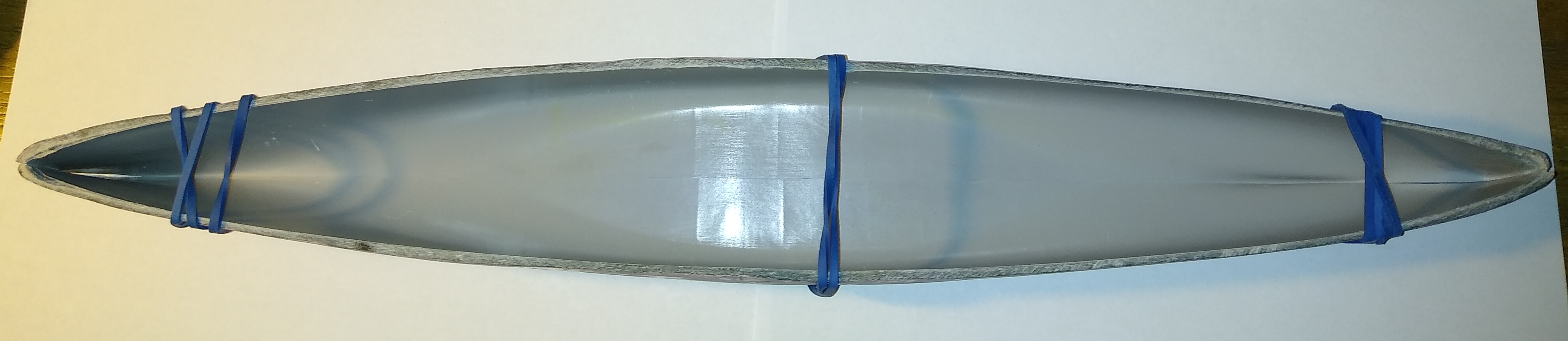

In another thread a poster posited that I might be afraid of resin kits... I think I am, especially of the cost of screwing one up. It got me thinking though. A good friend of the family made a "test" mold from a 1/350 print of my Invincible hull. (Please see the attached pic) He does amazing work on full scale skiffs and this mold came out very nice, I think. We were thinking about making fiberglass hulls in 1/144 scale but. I wonder if we could cast resin parts in 1/350? If we did would anyone be interested in them?
Xanthar
- Posts: 63
- Joined: Fri Feb 12, 2016 8:31 pm
Re: Modelling an HMS Invincible class battlecruiser
That does look nice and seems to still be available, so it's maybe not an urgent itch to scratch.DavidP wrote:how thick is the hull skin?
1/350 scale resin version already being done.
http://ironshipwrights.com/pages/Invin-Rizzato.html
http://ironshipwrights.com/ships_350.html
I'll go back to working on the super structure for Jutland : )
PS. The hull thickness in my model is parametric. In 1/144th scale I was using 4mm.

I haven't updated this thread in a while. I've printed out a second hull that will be used to make copies in fiberglass and I'm working on the superstructure for the first hull which will likely just be a static model.

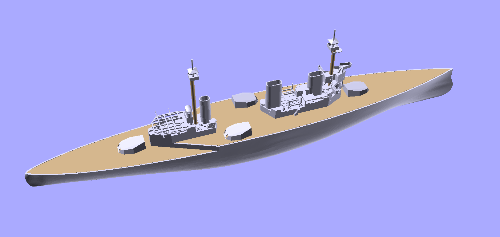

In the CASF thread @davidp noted that the wing turrets don't look right in the pic above and asked about the decks. I guesstimated their locations but, I'd love to know if anyone has actual dimensions or frame numbers for where those barbettes lie.
The decks will be either luan or plywood. I printed 2D templates from the FreeCAD model that I'll use to cut them out.
FYI, the gun houses in the mock up are my versions of the ones used on HMS Dreadnought : P I've got a decent version of the fore and aft ones printed and I'm working on the model of the wings.
The plug is the correct scale. The inside surfaces of the mold conform to the outside surfaces of the plug. Hulls made in the mold will match the plug.DavidP wrote:are the hulls printed at correct scale or printed under size so that the fiberglass versions are correct scale? look at the drawings I sent you for the frame numbers. I use a different method to get the correct locations of an object.
Hehehe. I used those drawings to do the mock up : P
I'm curious ... what method do you recommend to locate those features?

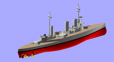

Here are two recent renders of my CAD model with some progress on the turrets and super structure.
Please let me know what you think?
FFG-7
- Posts: 733
are the prop shafts horizontal or slightly angled upwards towards the ship's center?
your prop shafts are to long when compared to my attachment which means the shafts are horizontal which they are not supposed to be.
