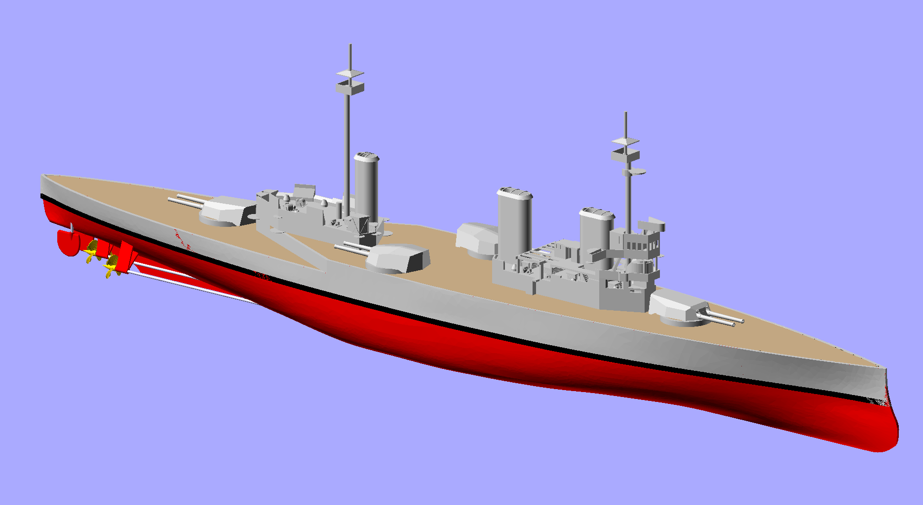

After seeing some posts on various forums about using FreeCAD to model ship hulls, I decided to give it a try myself.
My original goal was to make laser cut hull kits for 1:144 Scale RC Combat. For various reasons, I'm less inclined to actually produce those kits but, I'm planning to build a relatively detailed RC version.
It all started with some scans of the plans that I found online.
I'm pretty happy with the shape of the hull that I've come up with and my 3DP prototype came out pretty well, IMHO.
Currently, I'm working on deck pieces and superstructure parts.
C&CC Welcome.

I'm also wondering if there are any pictures, drawings, or descriptions of what was changed in her refit at Gibraltar after the Battle of the Faulklands?
I'd like to build her as she would have appeared at Jutland.

I haven't updated this thread in a while. I've printed out a second hull that will be used to make copies in fiberglass and I'm working on the superstructure for the first hull which will likely just be a static model.
In the CASF thread @davidp noted that the wing turrets don't look right in the pic above and asked about the decks. I guesstimated their locations but, I'd love to know if anyone has actual dimensions or frame numbers for where those barbettes lie.
The decks will be either luan or plywood. I printed 2D templates from the FreeCAD model that I'll use to cut them out.
FYI, the gun houses in the mock up are my versions of the ones used on HMS Dreadnought : P I've got a decent version of the fore and aft ones printed and I'm working on the model of the wings.

DavidP wrote:
are the hulls printed at correct scale or printed under size so that the fiberglass versions are correct scale? look at the drawings I sent you for the frame numbers. I use a different method to get the correct locations of an object.
The plug is the correct scale. The inside surfaces of the mold conform to the outside surfaces of the plug. Hulls made in the mold will match the plug.
Hehehe. I used those drawings to do the mock up : P
I'm curious ... what method do you recommend to locate those features?
