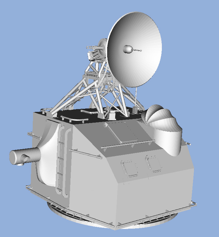

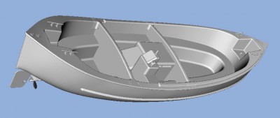

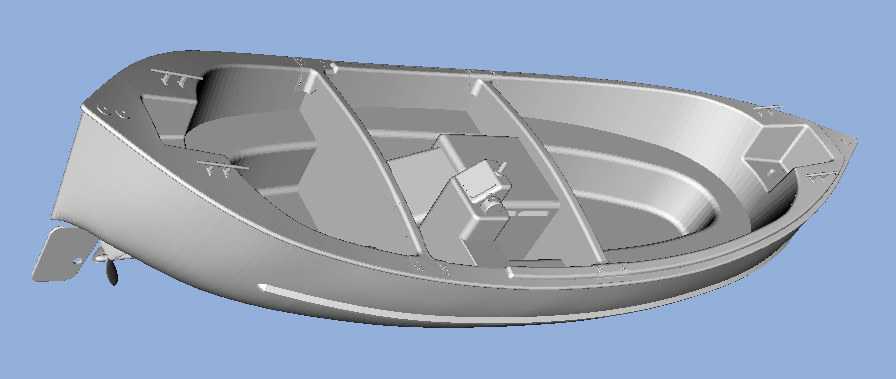

Here is an AccuTrans image of a motor whaleboat hull STL generated from a DesignCAD DXF file.
I should add this this one was a major pain. It was my first attempt at generating a STL, and it leaked like a sieve. Fortunately there are STL cleanup programs that will patch all the leaks.
This is a Mk37 director STL image.
