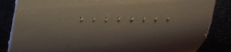

I have been wresteling with this issue.
The best way I have found to do this is to use a 1mm HSS drill bit, insert it in to a pin vice 3 jaw chuck and put this assembly into my variable speed drill, I mean a drill that is variable from 0-whatever speed your drill goes to. Many drills say they are vairiable speed but not from zero.
I put the drill into the middle of the port hole and start drilling very slowly at first gradually getting faster. I have found that doing it this way the drill bit bites into the plastic without slipping, the holes are the correct size and very clean and in a straight line as marked on the hull.
I have just done Academy's Graf Spee this way and am very pleased with the result. It is also a very fast way to drill out port holes
If you are getting slip put masking tape over the holes and push it into the depressions with some thing the same size as the port holes. eg the reverse end of the drill bit.

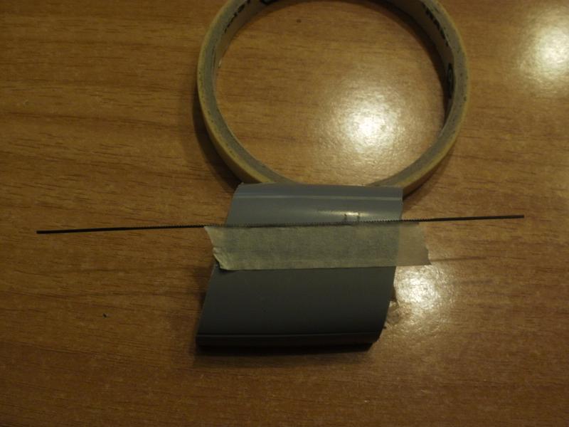

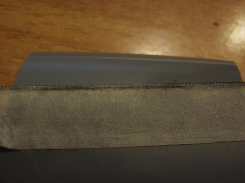

The techniques for aligning holes in a straight line have been covered by the fellow modelers above.
My two cents worth are on how to space the holes so that they are equidistant from each other. The technique is useful when portholes holes are totally missing on the model, or when handrails/footrails need to be added.
1)Tape an old saw blade from a hand saw on the bulkhead or hull, so that its teeth protrude from the tape.
2)Mark each hole with a sharp needle/pushpin every few "teeth" (always the same number of teeth). Let the needle hug the bottom of the "bay" formed by two adjacent teeth.
3)Remove the tape and saw blade and drill the holes using progressively larger drill bits, as JFoeth described above.
The above procedure maximizes the chances that the holes will be on a straight line and also equidistant from each other.
For tight spaces you need to cut small pieces of saw blade--I always keep some lying around. For bulkheads with curvature you need to prebend the blades, as the tape will not be able to hold them in place. Always be extra careful and wear protective glasses when bending the steel saw blades as they are very springy.

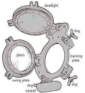

Sure! I have been down a similar path and have never been satisfied with the results of drilling. A couple of things to consider: airports / portholes are flush to the hull shell plating. When the hull flares a great deal, the porthole looks oval from the side when properly done. Secondly, and most importantly from my perspective, the inside of the porthole is essentially flush or very nearly so with the shell plating in the cases I've seen. (Exceptions may abound, and feel free to point them out.) That is to say that the glass or metal blocking plate (deadlight) which swings in in place of the glass are inset no more than a (scale) inch, if that.FEB wrote:I have tried to drill out port holes with a small pin vice and different size bits,the outcome is not so good,some are off center,out of line with each other,no 2 are the same,etc.what is the best method to make them nice and clean or is there an alternative to drilling?
The method I use is to smooth the side of the hull filling in any portholes cast in the resin or plastic. I then mark the location of the center of the portholes on the hull. Then I use the appropriate size and shape of P/E portholes. I use acrylic gel medium or Gator glue, or something similar, sparingly to hold the porthole in place and in the proper orientation if there's an "eyebrow". Then paint over the whole shooting match with the final colors.
If you choose to show "glass" in the porthole, a carefully placed gloss dark gray drop of paint at the end does the job. On the other hand, if you are modeling a warship at GQ, the blanking plates would be in place and they would be the same color as the surrounding hull color(s). This, of course, saves the need for the extra steps.
Heres a picture of a USN WWII-era porthole, viewed from inside the hull, showing the various moving parts. Other nations may use other variations, but suffice it to say that during combat, the ship wanted to keep as much glass as possible out of the line of fire while maintaining splinter- and watertight integrity.
Is this method a PITA? Why, yes, of course it is. This is modeling - it's not meant to be easy!
Personally, I like these results better than drilling holes. Not sure my heart could take trying to do this in a smaller scale than 1/350.
Two companies that make portholes as separate P/E sheets that I know of are Flyhawk and Northstar. There may be others.
