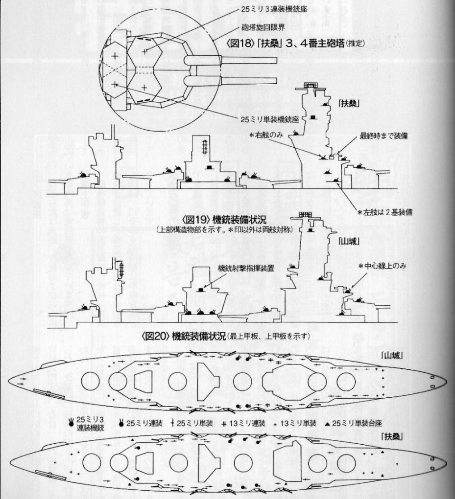

from gakken #30 on fuso class
ciao peppe

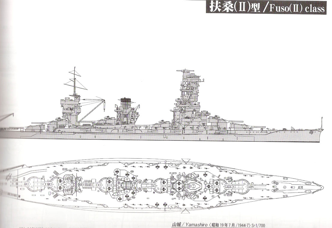

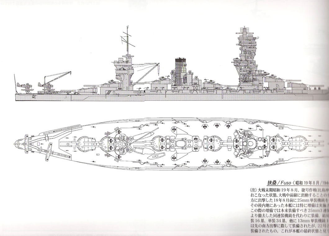

I'd forgotten about the Gakken volume. Well, one can now compare that to the material from the Ishibashi volume. The illustrations are too big to depict in their entirety but the gist is here. The Fuso version has one more 25mm single in front of #1 turret that was cut off.

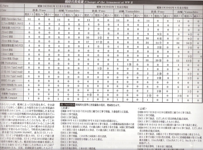

Trying to do a Yamashiro in 1943 is discombobulate, what you think Dan ?
Most of the 1941 double 25 mm have been removed by triple, first the one above number 2# turret in the overhang platform with the 3.5m rangefinders , second the pair of doubles on the platform at the aft part of the Pagoda have been replaced by triple and strangely, the two 25mm AA guns on top of number 2# turret is triple according to Ishibashi diagram.
According to Ishibashi table, Yamashiro had also by 1944 2 double 13mm AA guns, strange.Also according to Ishibashi table Fuso had her type 21 radar in 1944 while at AOTS:Fuso the type 21 was added at July 1943(page 134), while Yamashiro had no additions of extra AA light gus at all until 1944, so no change for her at 1943, but, is that correct ? Ishibashi table also inform us that Yamshiro never had type 21 radar wich is 1) typo error, or 2)tottal wrong statement cause Yamashiro's TROM state the addition of type 21 radar in 1943:
July 1943:
At Yokosuka. Refit. A Type 21 air and surface search radar and twenty-one 25 mm AA guns (17 single and 2 twin-mounts) are fitted making a total suite of thirty-seven 25-mm AA guns.
But this sounds quite suspicious as it sounds like Fuso's TROM, as it states the addition of single and 2 double 25mm AA, wich in first case, Ishibashi table is wrong for Yamashiro 1943 and type 21 radar or, Yamashiro's TROM in Nihon Kaigun site is a copy paste of Fuso's TROM.
Whats your opinion Dan ?

I don't know what to think, Atma. The guys who work on the TROMS are pretty diligent about getting it right, and I know that Tony Tully has a hand on these two ships as well.
Yet, the Ishibashi book is considered top rate as well & I see that the Fukui diagram does not show radar either for 8-1944. Fukui's diagrams usually do inicate radar set-ups, even if they are focused on AA.
These ships are not my strongpoint so, I don't know what to make of the contra-indicating information.

In looking at the Ishibashi table, I see that Yamashiro received Type 13 and 22 radars by 1944. I suspect that her Type 21 air search radar was replaced by the Type 13 as sort of an experimental alternative. THis would explain her gaining a Type 21 earlier, then losing it.

Well the Ishibashi table suggest that she never carried the Type-21 radar. Type-21 radar is the most common radar in Japanese Navy, and I find it hard to belive she never carried one. So i guess its a typographical error in the Ishibashi table that Yamashiro never carried a Type-21 radar. I think in the Ishibashi table the truth about the absence of Type-21 radar in that table for Yamashiro lies somewhere in the comments, it needs to be translated.At the moment I insist, that the Ishibashi table is suffering from a typographical error about Yamashiro's Type-21 radar.

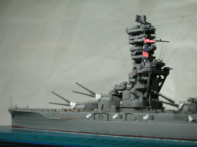

Can someone tell me at what level and where the signal flag lanyards tie off to on a 44' Fuso? A picture would be great or just mark the area below on my build. I sort of figured either of these two areas.

I believe that the main yardarms are two levels down, Kym. My home scanner was broken so, these will have to do.
First is a 1941 inclining test for Fuso from Maru Special #3. Skulski indicates that there is not change in the yardarms from 1941 to 1944.
The second is of this area from an outstanding 1/700 build of Fuso 1944 by Toshifumi Kimoto (the vanguard website). I forget which Navy Yard Special this has appeared in.

Thanks Dan, but what I meant was, which level had the flag lockers and tie off points from which they attached the flags? The added top line in my photo was drawn in because I hadn't attached the yardarm at that stage. The dotted lines are the outside flag lanyards.

While I can't find close-ups or diagrams that show flag lockers, that level does make the most sense as it is the base level for the halyards. FWIW
