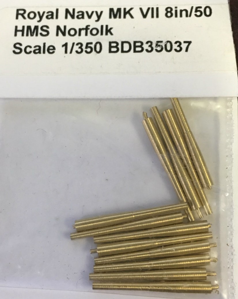

I have been checking for metal barrels for the 8" cannons, would these be appropriate? (Out of stock anyway�).

Yeah, noticed that, but HMS Norfolk mounted MKVIII (not MkVII) 8" 50 Cal. cannons. Could it be a printing mistake?

That is what I think. Out of stock anyway, HA!

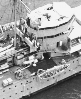

SovereignHobbies wrote:Planking and boat cradles between davits either side of bridge eliminated:
Hi James, thanks for paving the way! I started also on this little mod, and found this high oblique picture as well:
When looking at it I realised: there is a passage underneath the shelter deck! This is entirely missing in the Trumpy kit. The forward wall of this passage aligns with the forward edge of the unplanked deck area. Also, the deck passages along the foot of the bridge superstructure are much too narrow, so there needs to be done some mods on this part as well.
I'm going to look now how this shelter deck can be partially planked, using the appropriate Evergreen pre-scribed plate stock. I'll post the result.

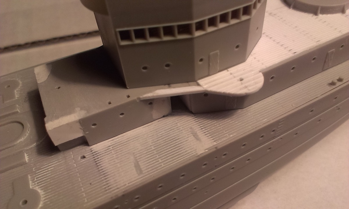

Maarten Sch�nfeld wrote:I'm going to look now how this shelter deck can be partially planked, using the appropriate Evergreen pre-scribed plate stock. I'll post the result.
And this is the result. I used Evergreen 2025 V-Groove plate, with grooves at .025" spacing, very close to the rest of the decks.

Damn. That rather good photograph is new to me and I missed that passage. I wonder if I can sort that. It may do more harm than good trying now :/

'He that increaseth knowledge increaseth sorrow.' The high oblique photo is a clipping of the very good picture in Wikipedia of Exeter at anchor in 1934. It was so to say 'under our noses.'
On drawings I only found it back on the deck plans of HMS York, but then it wasn't covered, as the superstructure of York was smaller in footprint. But maybe there are other drawings too.
In the Gallery is this build from David Hogue, he did a great job on the ISW resin kit. I think he did a lot of research for us, look at all scratch improvements he did. But he also missed that passage.
