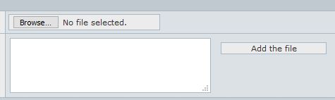

Just a reminder - if you are embedding photos into a CASF thread, please use the function to add a file to the post, so that the photos is part of the permanent record. Otherwise, links to photo hosting sites will eventually break...
