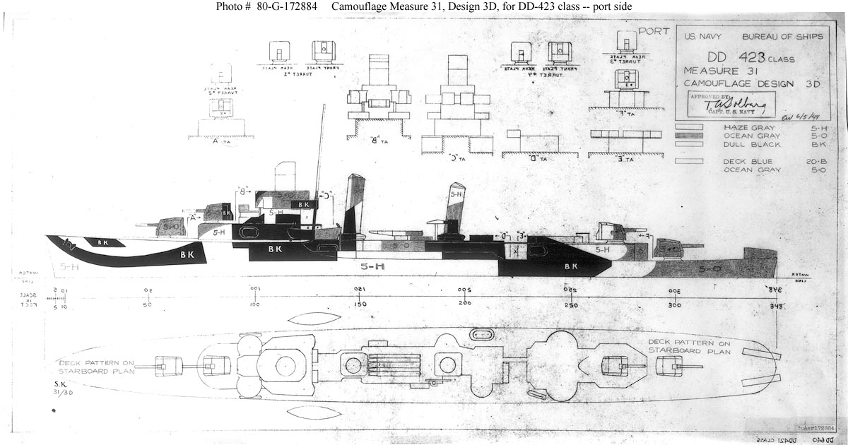

Tracy White wrote:
PeeJay333 wrote:...found a number of pre-war camouflage patterns for application of Measure 31 to these ships.
Welcome aboard! Just a quick correction, the dazzle schemes didn't come about until 1943, and weren't a pre-war scheme.
Camouflage measures didn't exist until January of 1941, and up until that point everything was #5 Standard Navy Gray with the exception of ships they were experimenting with. Measure 3 is similar to the prewar colors, but it is incorrect to say (such as Squadron's Destroyer Camouflage book suggested) that the prewar scheme *was* Measure 3.

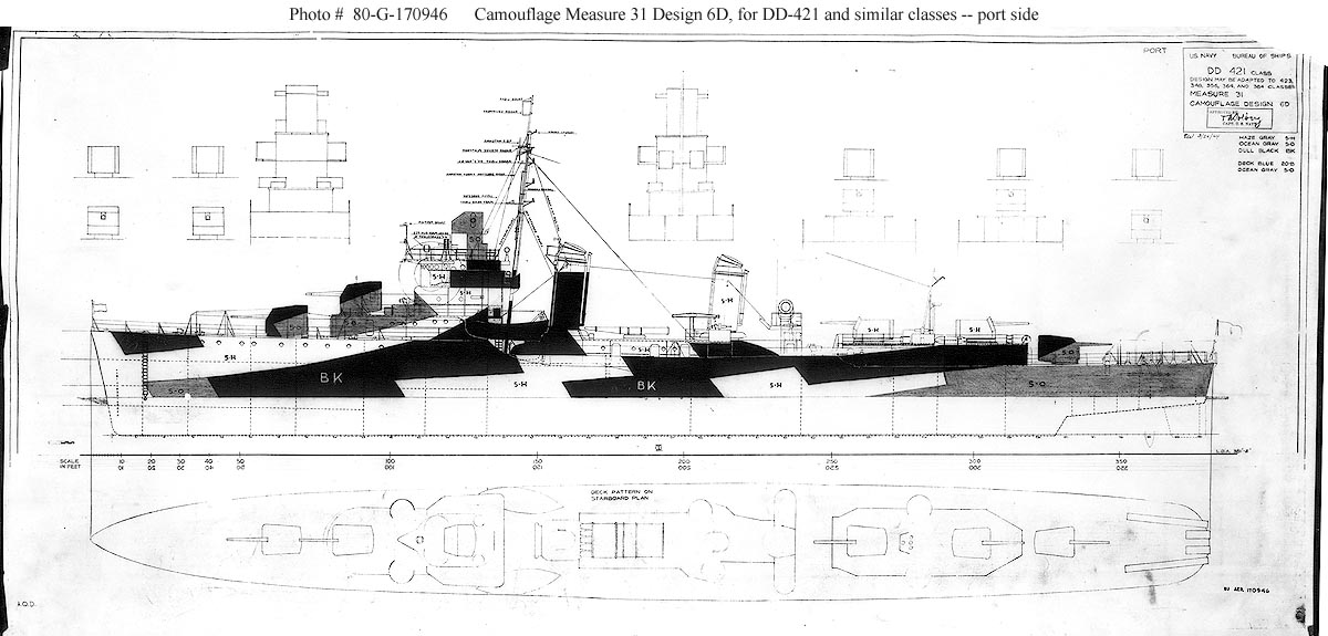

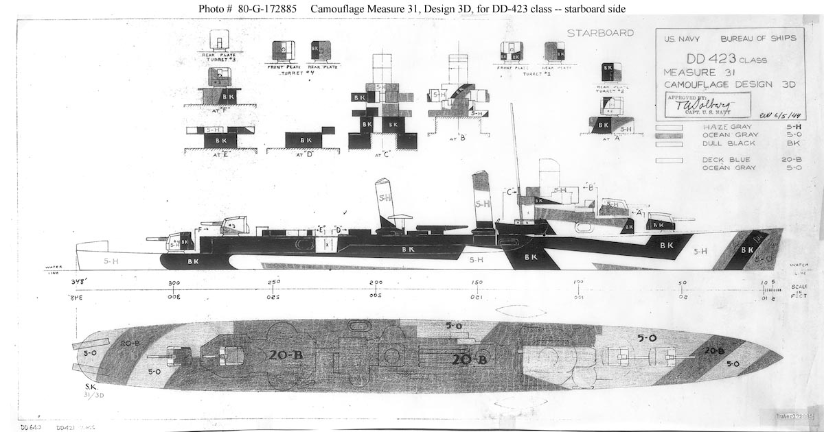

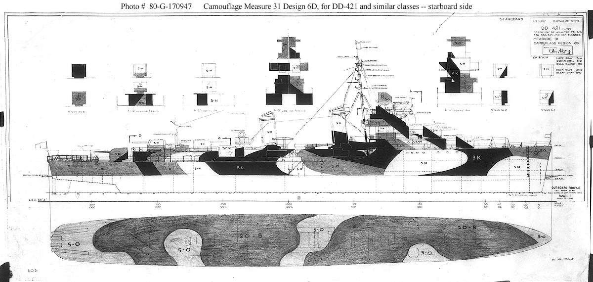

Thank you for the clarification. What I should have said is "Camouflage patterns for these pre-war classes of Destroyers," meaning the 'pre-war' was descriptive of the ships and not the camo patterns. Here are two examples of the Benson/Gleaves patterns I found in the National Archives Photos.
PeeJay
Measure 31 3D - Gleaves Class - Port Side
Measure 31 3D - Gleaves Class - Stbd Side
Measure 31/6D Benson Class Port Side
Measure 31/6D Benson Class Stbd Side

Yes, and in case you haven't been there before, or for others that haven't, we've posted those with a time line for each ship on the ShipCamouflage.com Benson/Gleaves page

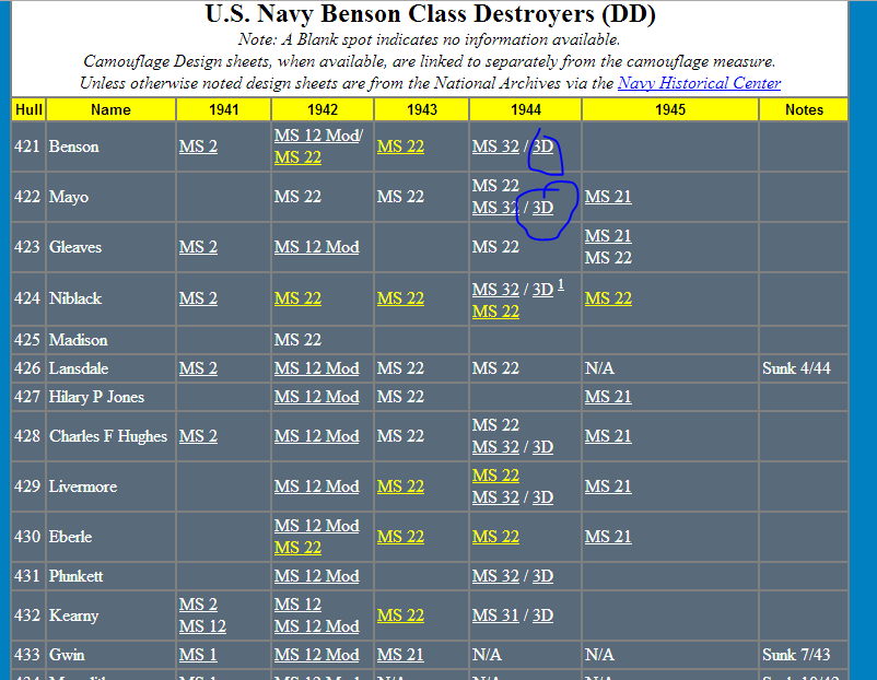

Tracy White wrote:Yes, and in case you haven't been there before, or for others that haven't, we've posted those with a time line for each ship on the ShipCamouflage.com Benson/Gleaves page
I thought that was where I originally found these diagrams for the Fletchers, but after my computer got replaced, I lost all of my bookmarks. I found the listing and timeline for each ship in the Fletcher class and the Benson Gleaves classes, but I can't find the link that actually takes me to the diagrams. So I went through the photo archive listing and downloaded the diagrams I found there. I would still appreciate the link to the diagrams on the Camouflage Site if you can tell me how to get there. Thank you.
PeeJay
Posts: 12466
All of the patterns that have diagrams uploaded are indicated with an underline. Just click on them to see the diagram.

Timmy C wrote:All of the patterns that have diagrams uploaded are indicated with an underline. Just click on them to see the diagram.
Thank you. That must have been how I got there the first time.

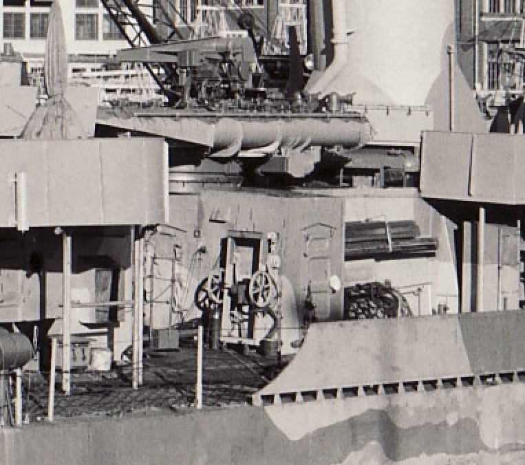

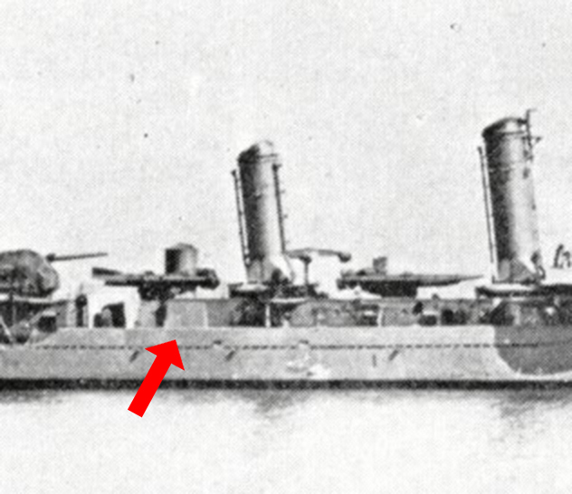

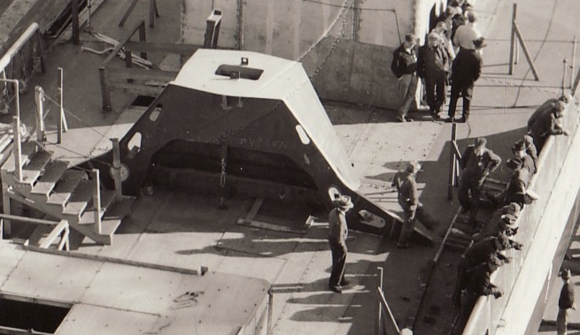

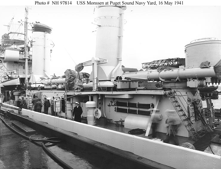

Rick, would happen to have any info on the middle deckhouse underneath the after quint-TTs? They differ from the ships who have the search light (which my plans show) in place of the TTs. I know they are angled and there is a great photo of the Monssen that show is area very clearly. But photos aren't plans and plans aren't photos.
Reid, PIO of the 48th Fleet
http://www.48thfleet.com
Posts: 3880
Post by Rick E Davis »
Reid,

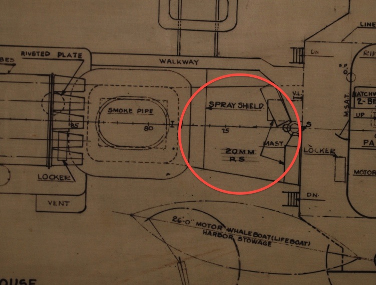

Well I don't have a lot, on this area. The DML kits seem to model this area well. MEREDITH was an original GLEAVES class unit, but in this area the BENSONs were similar. At the bottom are a couple of close-up views of the Aft Torpedo Tubes Foundation structure. Because the smoke uptakes and some of the fresh air returns were below this area and entered the main deck, an "arching" structural support was installed to transfer the load to bearing areas outside the intakes. (see the construction view aboard DD-427) The sides of the foundation then appears to be covered in sloping bulkheads with stowage lockers being utilized. Also, at least on the starboard side of many units (all?) a stowage cabinet/locker was installed attached to the foundation. (see attached view of GRAYSON in July 1942) At the same time (at least on GRAYSON) there doesn't appear to be a corresponding locker on the portside. There doesn't seem to be a single standard set of lockers added to the aft TT mount foundation. (see the 1945 plans for MAYO) In many cases, it appears that the addition of these various cabinets/lockers and stowage of other equipment covered the sloping sides of the TT mount foundation.
I have limited views of BENSON-GLEAVES class drawings from official Booklet of General Plans at the National Archives. The closest I have are for USS MAYO in 1945 rig and then I don't have complete plans of all aspects. I can't afford to buy scans of ALL plans I look at or have an interest in, but I take digital camera images and keep a "database" of them. If I find an overwhelming need for a set of scanned plans, I get them later. I have a modeling project dealing with USS MAYO, so she got priority.
I would suggest for MEREDITH as modeled at the time of her loss, to look at photos of her sister GRAYSON taken at Mare Island in July 1943 as your best guide. The first few units of the repeat-GLEAVES class (DD-453 on) also still had this foundation built in, there was too much work to take it out and replace with a more conventional deckhouse as was used on most repeat-GLEAVES units.
WARNING. The following deck plans apply to USS MAYO in 1945 ... structures and location of weapons won't necessarily apply to MEREDITH in 1942.
This view shows an inboard profile of "as built" contract plans of the midship area for the BENSON class (which was in general used for the GLEAVES class as well). For the GLEAVES class, a more conventional deckhouse was built between the aft stack and the aft TT mount.
This view shows the deck plan of 01 deck amidships for USS MAYO in 1945.

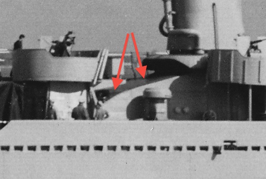

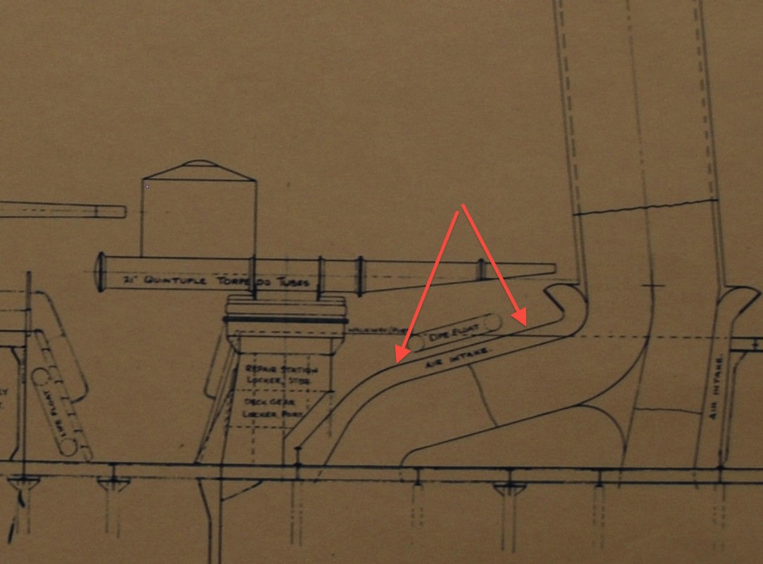

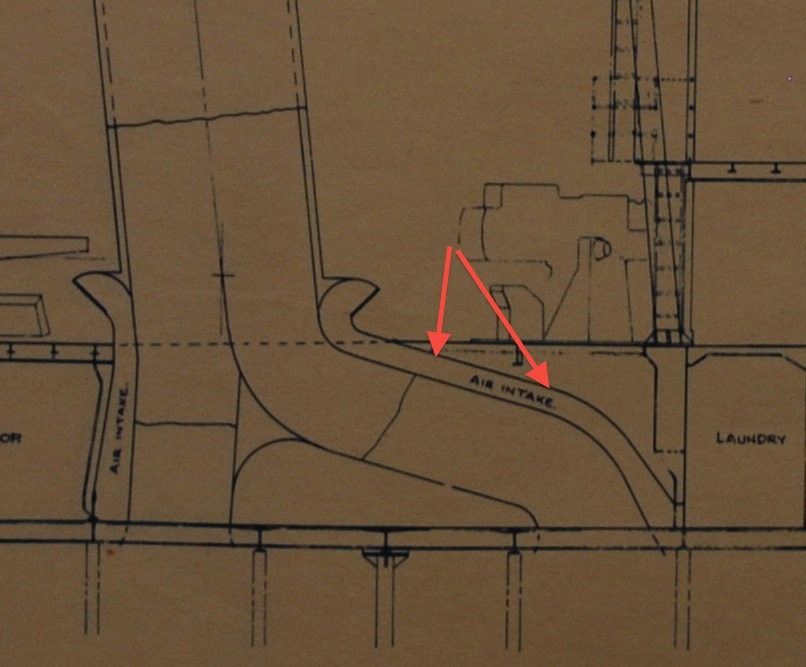

Something to be aware of is one of the differences between Benson and Gleaves class DD's. On the Gleaves class, the angled boiler uptakes at the front and back of this middle structure were enclosed by the deckhouse. On the Bensons, they were not. The angled uptakes were exposed and a catwalk led from the central deckhouse to the torpedo tube foundation.

Thanks for the info Rick!! That is very helpful. Kinda opened a can of worms for me though.
On that note, Dick, is this kinda what you were talking about (see attached). This is supposedly a pic of the Meredith as you can see near the after TTs, it looks like there is another sloped portion of deckhouse just forward of the sloped back area.
I'll post of what i have been working on to get some professional input.
Posts: 3880
Reid,
Dick is talking about the difference between the BENSON class and the GLEAVES class layout of their midships deckhouses. The BENSON class were built without building a deckhouse over the stack uptakes and the GLEAVES class did. The forward uptake (images 2 & 3) on the BENSON class and the space between the aft stack and the aft torpedo tube mount (images 1 & 4) many times (depending on when and what configuration) had false decks built over these areas so that they could be used for stowage or other purposes. It is real hard to find photos for these areas with the ships boats and the various lockers/cabinets/gear stowed.
Since MEREDITH is a GLEAVES class unit, the midships deckhouse extended from the fore mast area to just beyond the aft torpedo tubes foundation ... with varying structures added or removed over time by different builders or USN requirements. The uptakes on GLEAVES class units couldn't be seen at all. I don't have any good drawings of GLEAVES class to show the difference.

OOHHHH!!!!! That has really cleared up a lot!! thank you so much for the clarification!
