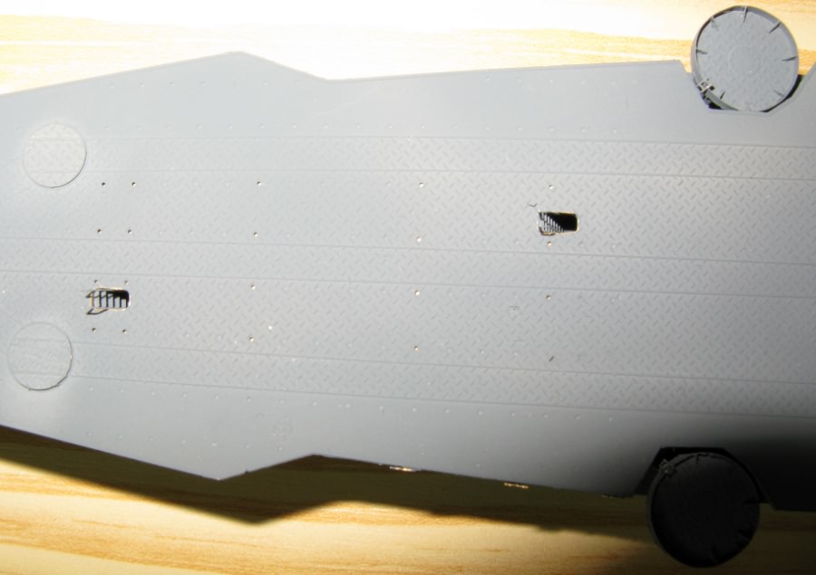

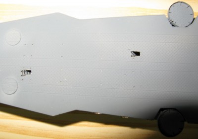

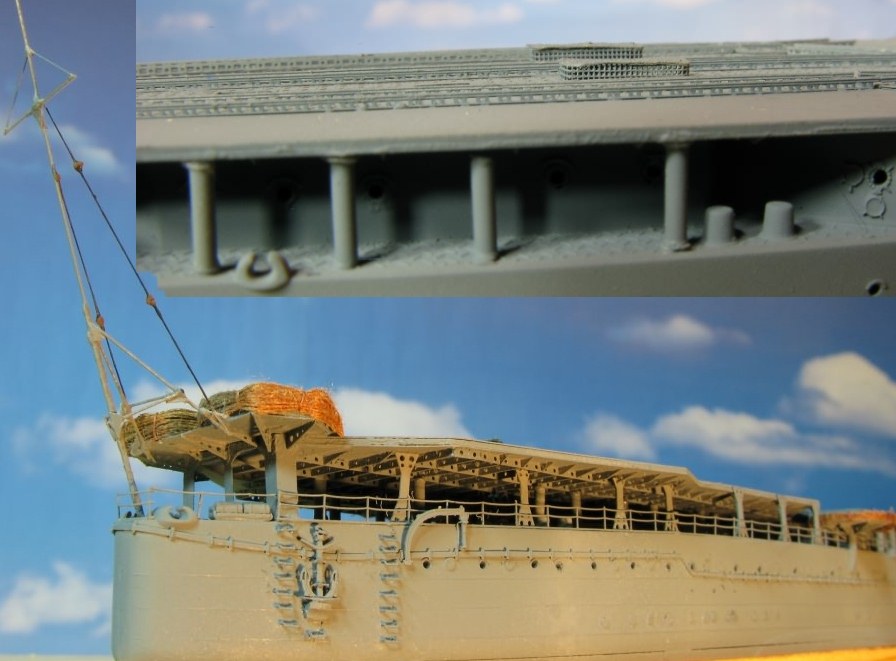

Here my latest progress report:

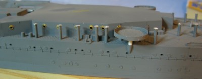

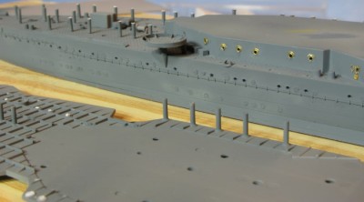

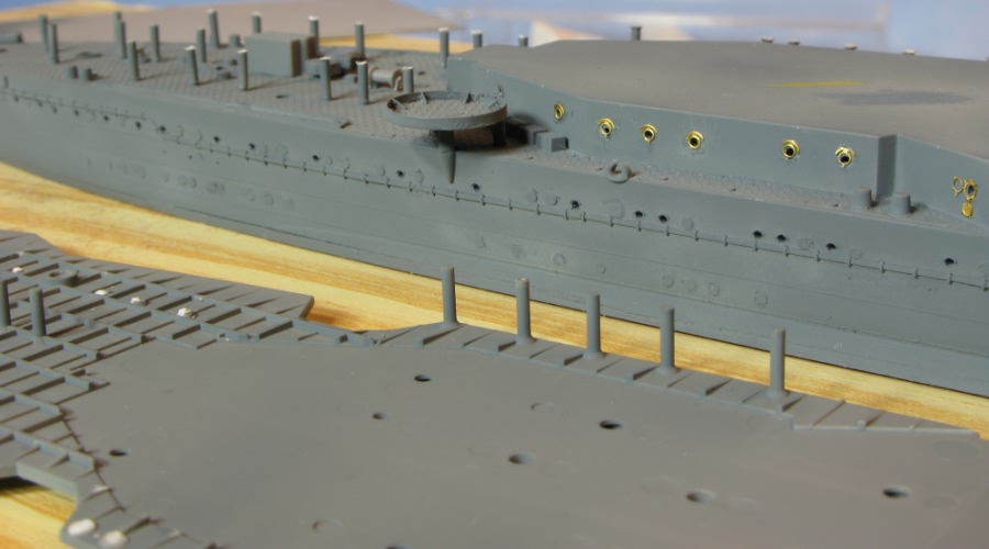

It seems that adding the Lionroar floatplane handling deck (�flight deck�) is really very complicated. :thinking: I needed some time to develop a plan. First I cut all the plastic pillars from the Tamiya plastic flight deck and glued it one by one to the corresponding position of the lower deck (Mogami37).
Mogami37
Mogami37
The Lionroar instructions are not very clear here but it seems that it is expected to cut these pillars from the resin rod. This is difficult because the pillars seem to be different in length. Another reason not to use the resin rod is the larger diameter of it compared to the plastic rods. Mogami38 depicts the plastic pillars in place.
Mogami38
Mogami38

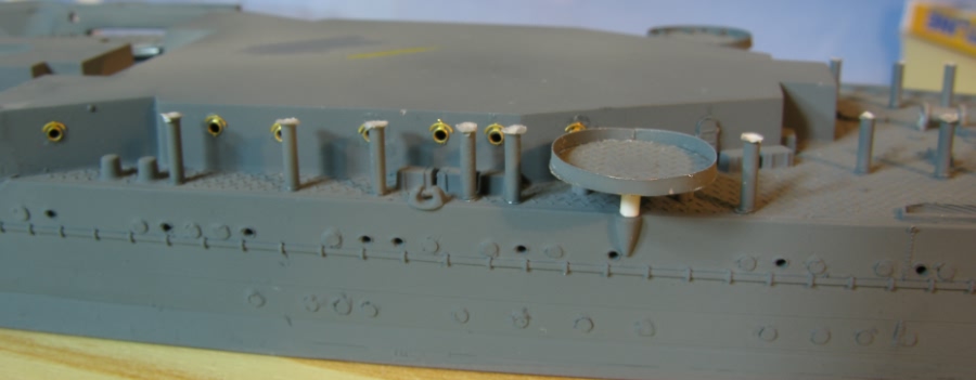

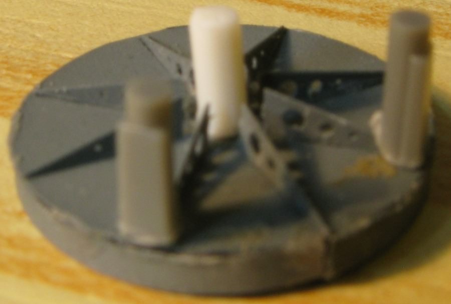

For the AA position I used the Lionroar PE parts and a segment of the resin rod and also two Tamiya plastic struts (Mogami39).
Mogami39
Mogami39
Mogami40
Mogami40
In Mogami40 this AA position is in position and some additional bull eyes are visible. Next step: A little bit of Kure grey air brushing. Here only a picture of me prepared for airbrushing.

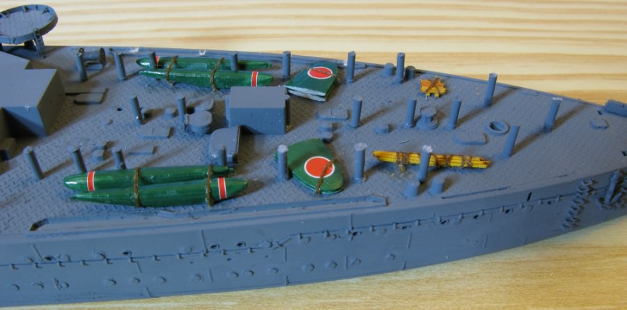

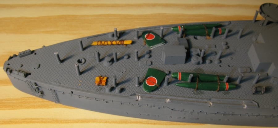

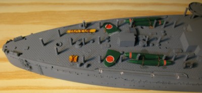

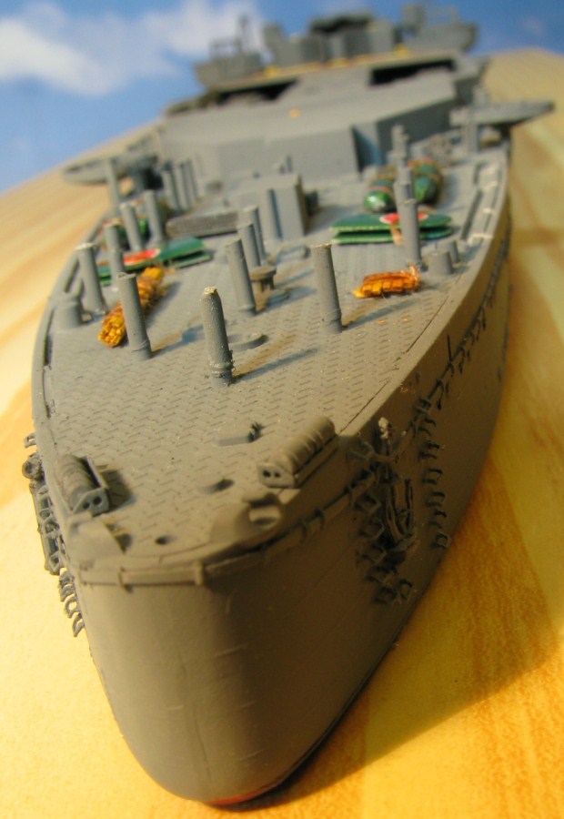

In Mogami41, 42 and 43 the lower deck is shown after adding some floatplane spare parts and other details.
Mogami41
Mogami41
Mogami42
Mogami42
Mogami43
Mogami43

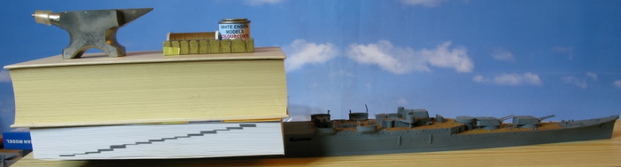

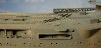

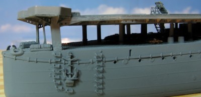

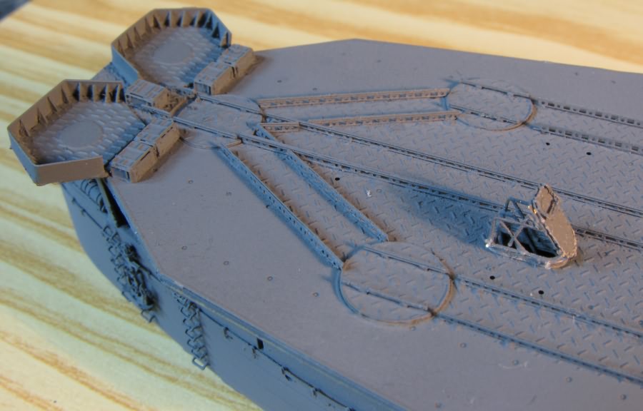

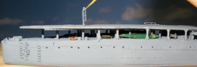

Last time to reach these areas before gluing the flight deck. Then I used super glue (gel) on all the pillars and other areas to glue the flight deck. Then I loaded the flight deck with some extra weight (Mogami44) to make sure that the gluing is successful everywhere.
Mogami44
Mogami44

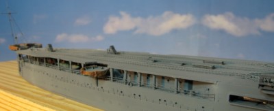

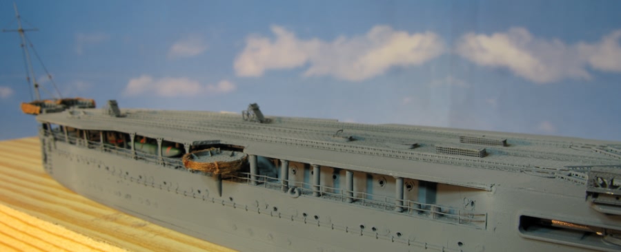

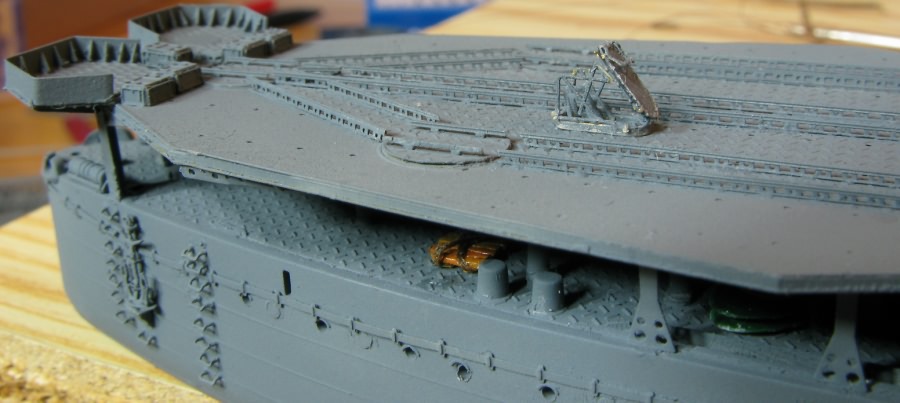

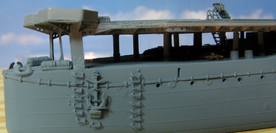

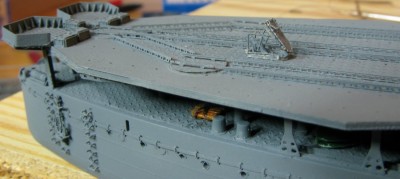

Mogami45 shows the result after adding the flight deck.
Mogami45
Mogami45

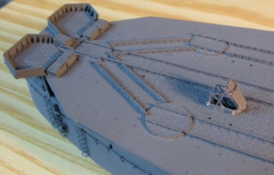

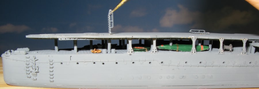

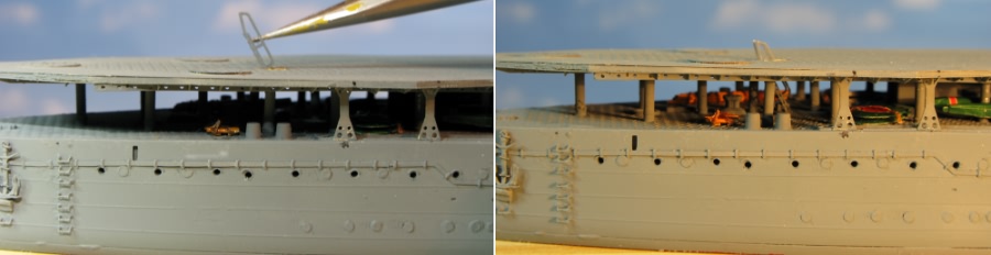

I chose to add the 14 additional struts after adding the flight deck. The first 5 are visible in Mogami46.
Mogami46
Mogami46
This is also a painstaking process because the Lionroar struts are too long and have to be shortened individually. Now I also added the two PE ladders (Mogami46-48), which substitutes the Tamiya �Aztec temples�.
Mogami46
Mogami46
Mogami47
Mogami47
Mogami48
Mogami48
Still a lot to do on the flight deck but I am really happy that the flight deck is installed now. My headache is cured now.

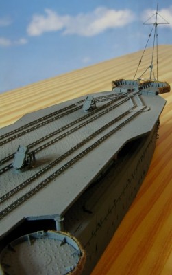

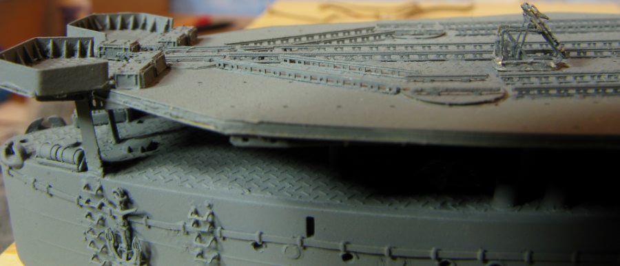

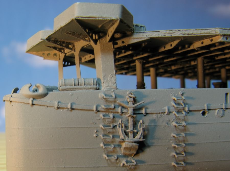

I added some details to the floatplane handling deck. Here the aft AA gun position is shown (Mogami49).
Mogami49
Mogami49
This position was added to IJN Mogami in her third wartime modification in June 1944. It is not included in the Tamiya and Lionroar kits and I used brass strips and other PE parts. I also modelled an open hatch in the flight deck (WEM IJN hatches).
Mogami50 shows the support construction of the deck.
Mogami50
Mogami50
More views of open hatch, AA position and rails are shown in the following pictures.

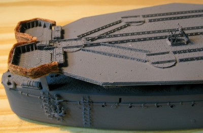

Post by Dirk »

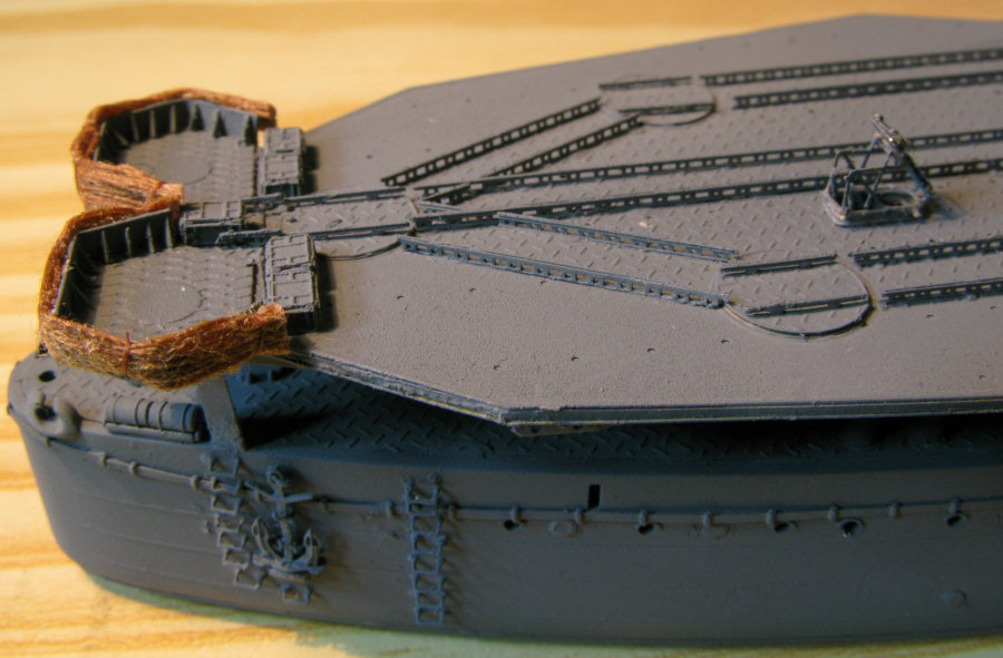

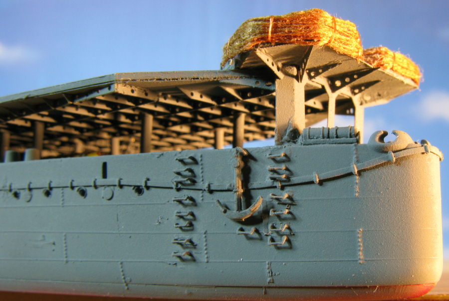

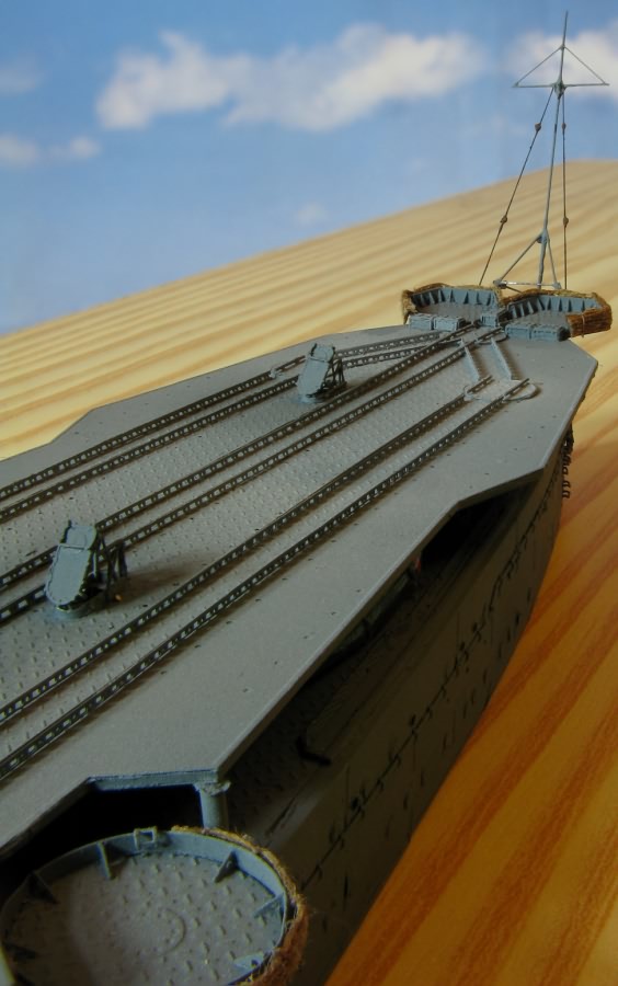

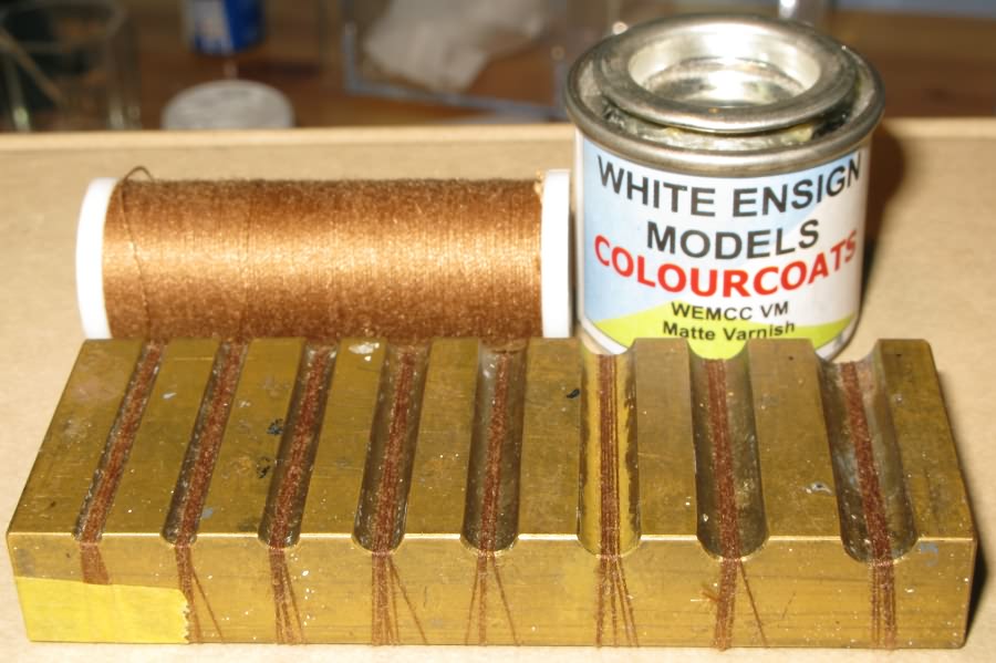

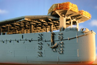

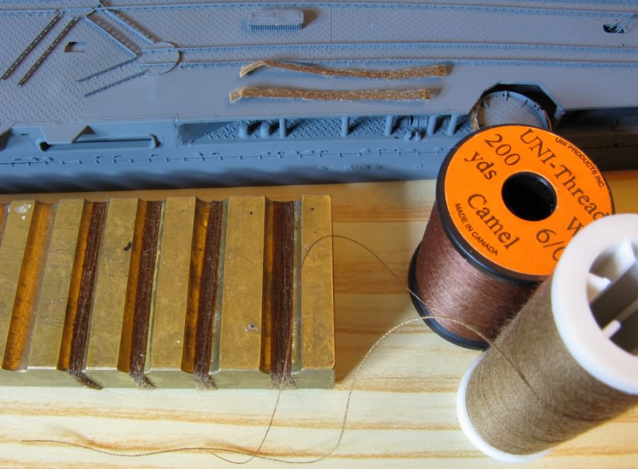

In the next step I misused Burckhardt�s (BMK) PE bending device for producing ropes for splinter protection (as a kind of �Reeperbahn�). I coiled very thin sewing thread around the recesses and fixed it with matte varnish (Mogami54).
Mogami54
Mogami54
The semi product can be seen here lying on the deck (Mogami55).
Mogami55
Mogami55
For imitating the holding ropes UNI-Thread W6/0 was very useful (even thinner than the sewing thread).

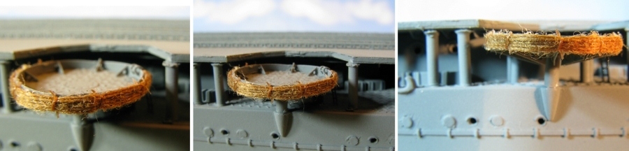

Here the results:
Mogami56
Mogami56
Mogami57
Mogami57
Mogami58
Mogami58

That was a hell of an idea on the rope Dirk :thumbs_up_1: :thumbs_up_1: say wouldn't have been better if you had added the deck railings too before adding the airplane deck? hope you got another escape plan on this one :big_grin: it looks to me like a tough one with the plane's deck in place.

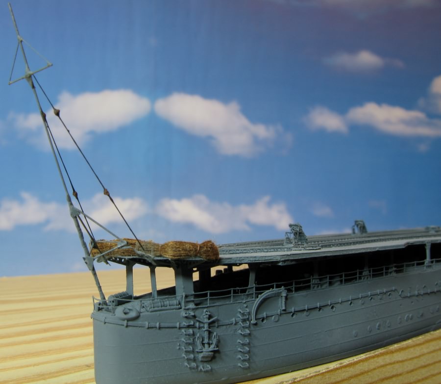

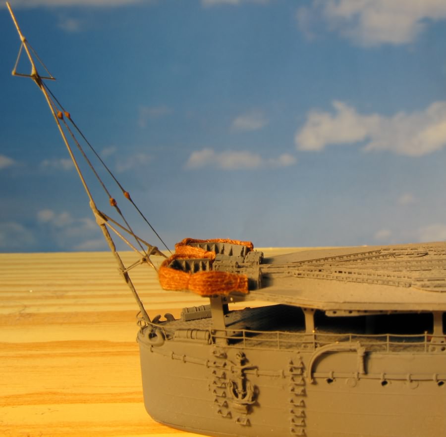

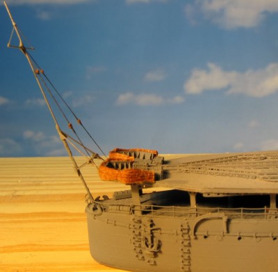

I added the rear flag staff (Mogami59).
Mogami59
Mogami59
I followed the Miyukikai 2001 Mogami plan which depicts her in her last appearance. For the flag staff I used thin steel needles and triangles made from PE �sprue�. In the next pictures also the added hand rails are visible (Jose, do you men these railings?).

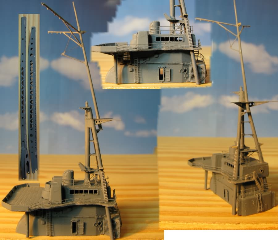

Here a baby step update of my progress:
This is the aft bridge and main mast in a semi finished state.
Mogami65
Mogami65

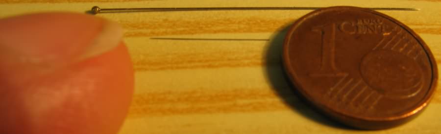

I intend to add a lot more of details. The upper part of the main mast is a tapered brass mast from BMK, some PE parts from the Lionroar kits (reinforced by steel needles). I used also some steel needles alone. I really like them. The larger ones have a diameter of 0.25mm and the tiny ones a diameter of 0.1mm.
Mogami66
Mogami66
They are original intended to penetrate insects (insect pins) but I prefer the application in a ship model. In Germany they can be ordered at
http://www.fiebig-lehrmittel.de/index.p ... egoryid=19
For some of the details I followed the Miyukikai plan. But in this plan Mogami�s aft bridge have a very different appearance compared to the Tamiya version. Another question is the crane (see Mogami 65). In the Lionroar kit there are two different versions. One is the same like in the Tamiya kit (only much better detailed). In the Miyukikai plan it is also the same but here it is clear that this is an I-beam profile. Looks a little weak and in the book �Mechanisms of Japanese Heavy cruisers� there are two pictures where such a crane failed (bended in the middle by more than 90�). But I can not read the Japanese text. So I decided to use the heavier crane version because I think especially in a ship like Mogami with all the floatplanes (also the Zuiun was planned) a more stable crane is very likely. Dan, do you know more?

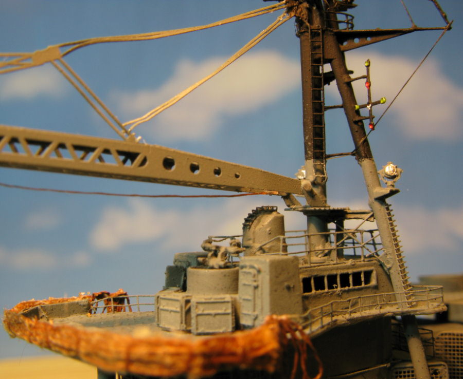

Post by Dirk »

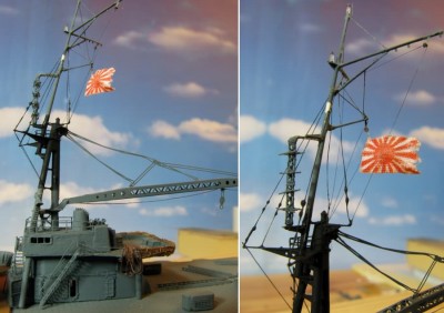

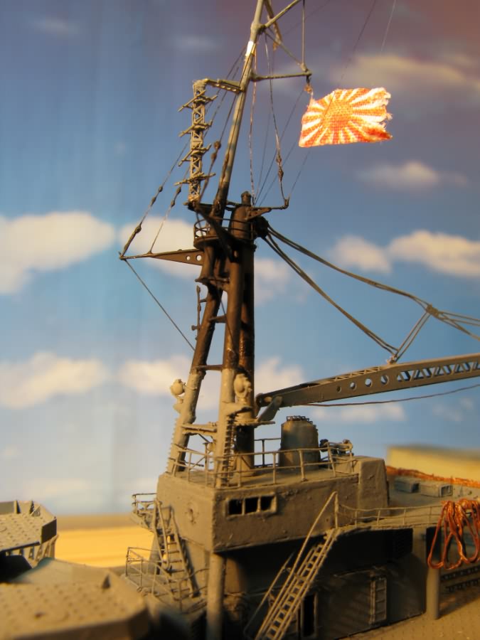

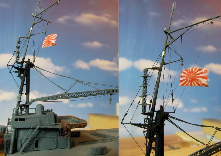

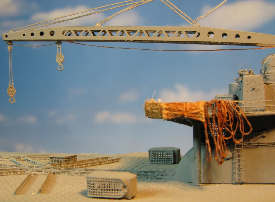

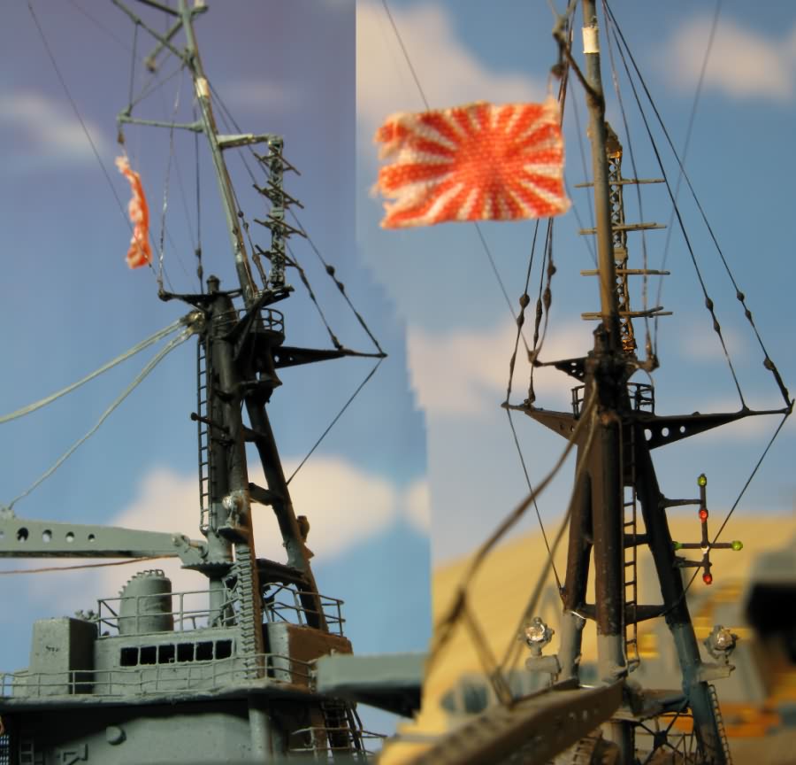

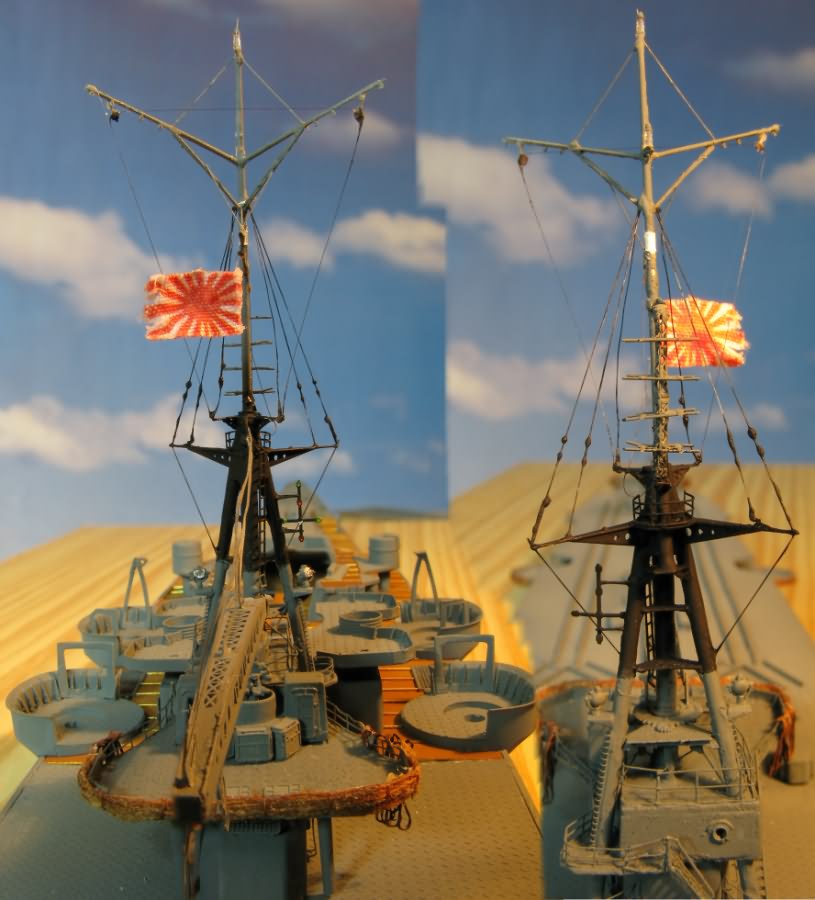

The aft bridge is nearly finished. I added the crane, splinter protection, radar (1944 modification), a wind worn flag and some of the rigging.
Mogami67
Mogami67
Mogami68
Mogami68
A problem was the Lionroar PE part for the rigging of the crane. It was not fitting and after adjusting (by some force) it was bended. Hard to substitute, but I will think of it.

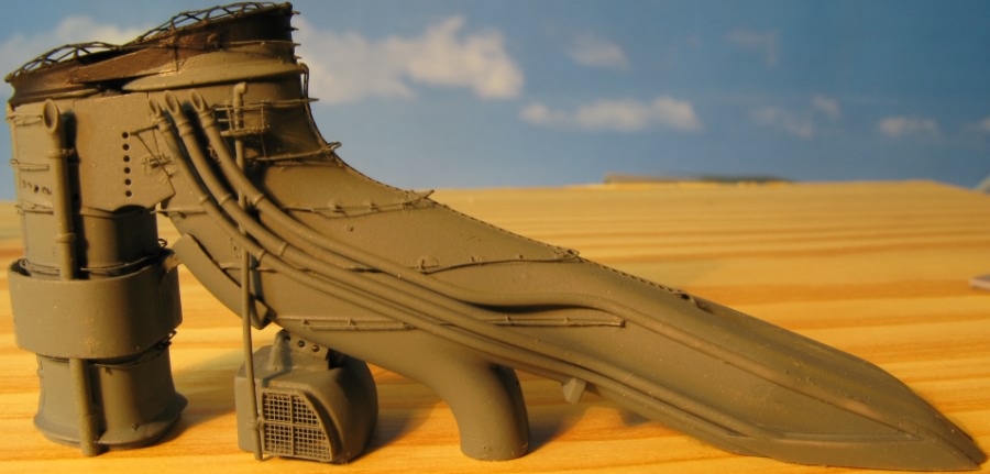

The funnel is prepared.
Mogami73
Mogami73

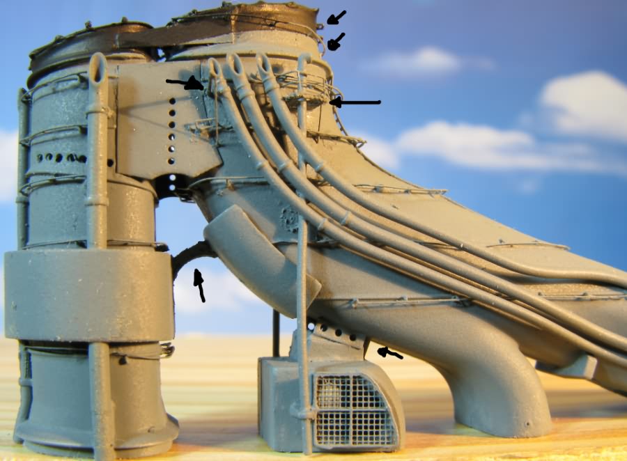

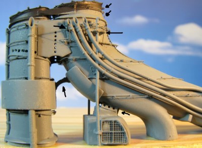

For me these funnels with their strange shape are the most interesting parts of the IJN cruisers.
Mogami74<br />Black arrows indicating my further additions
Mogami74

Soo much detail :faint: i think i could stand next to the funnel on shot 74 .. awesome work Dirk :thumbs_up_1: :thumbs_up_1:
