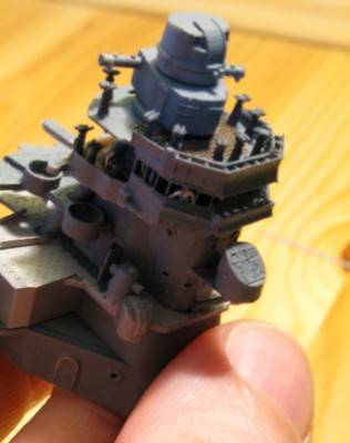

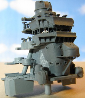

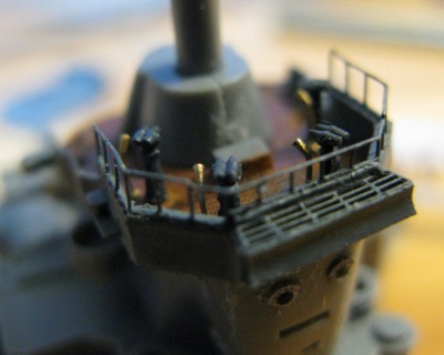

I started to prepare the working area for Captain Toma and his crew (Mogami01). One of the wind baffles from the LionRoar set are already in place.
Mogami01-Bridge
Mogami01-Bridge
Mogami02 depicts a later state with Mogami's navigator, Lieutenant Commander Nakano already on the bridge.
Mogami02-Bridge
Mogami02-Bridge
... and more wind baffles (Mogami03). I like the LionRoar PE wind baffles and I think it it worth the efford to exchange the plastic ones. There are also PE substitutes for the navigation lights on the sides of the bridge in the LionRoar set. At first I thought that the plastic parts are fine enough. But looking on this picture at this magnification they appear a little bit clumsy. Maybe later I will remove them and add the PE parts.
Mogami03-Bridge
Mogami03-Bridge

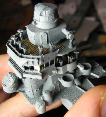

For the structure on the floor of the antiaircraft command platform (Mogami04) I used the Flyhawk 1/700 net 0.5mmx0.5mm.
Mogami04-Bridge
Mogami04-Bridge
Here I used mainly brush painting because I still waiting for my gas mask for air brushing (enamel paint !).
Still a lot to do with the bridge area ...
But I will continue with other parts in the following.

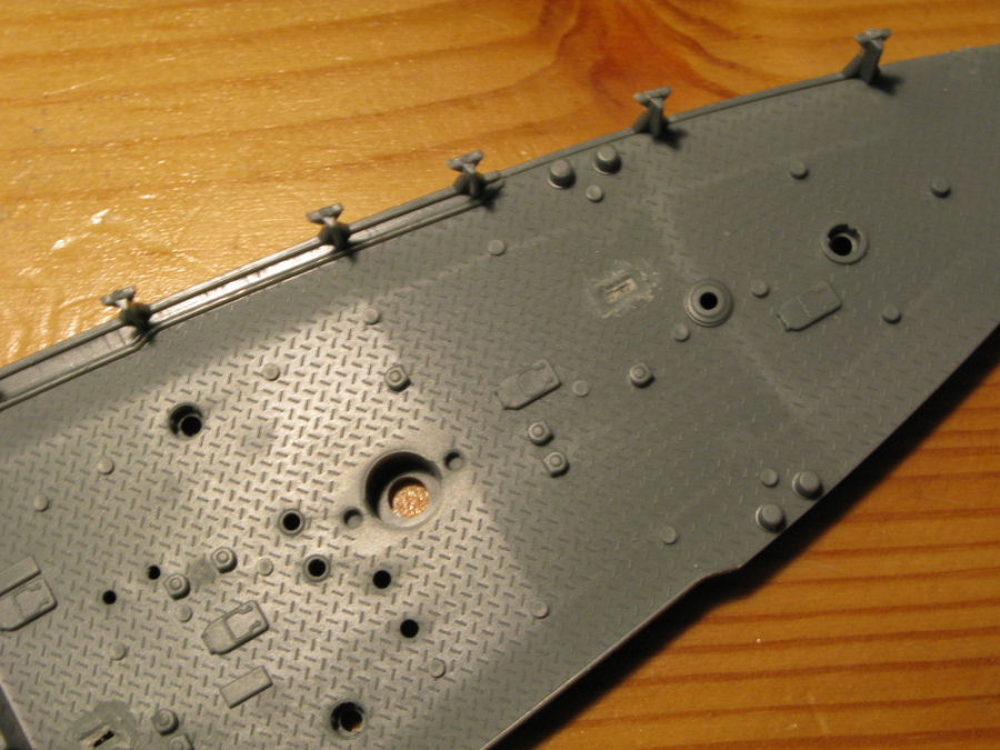

For the linoleum imitation in the area of the turrets I used the WEM IJN linoleum colorcoat. But in the middleline I added a little bit of yellow to the linoleum paint. I was supprised by the effect by using the airbrush that it is relatively easy to produce a color gradient (Mogami05). Here it�s producing a weathered appearance (compare with the deck section in front of the bridge which is only airbrushed with the original linoleum paint).
Mogami05-Linoleum covered deck

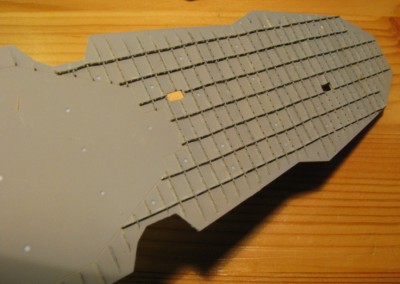

This is the bottom side of the aircraft handling deck from the Lion Roar Mogami set (Mogami07).
Mogami07-Aircraft handling deck from below
The upper and lower layers are deep etched brass sheets sandwiching a plastic middle layer. The three layers fit well together and have exactly the same shape like the corresponding Tamiya plastic part. It is already quite stiff and the thickness looks good. But it is well known that the Mogami was a very tough ship, surviving even a crossing of the T. So it�s a must to add further reinforcements to the deck. To be honest, I am not sure if much of this construction will be visible later after the complete assembly. But it seems to me at least a good exercise for the 1/350 Hasegawa Akagi.
I used a method by first priming the complete PE sheet and then assembling it. This has some advantages and disadvantages. By the way: I learned a trick from an airbrusher�s book: By using an airbrush for priming you have a better control then by doing it with a �rattlecan.� But if you are stubborn like me and you want still to use your Tamiya primer from the rattlecan, you can attach a straw (the big ones with the joint) to the business end of the rattle can and spay a certain amount into a glass jar. Then you have to wait until the gas escaped the paint (>1h) and then spray it with the airbrush. Especially for small delicate PE parts with tiny holes etc. this works better then the rattlecan.
Mogami08-all struts assembled
Mogami08 shows all the struts in place and airbrushed in Kure grey. During the assembly of the struts you need some concentration: In the Lion Roar instruction it is sometimes not very clear which strut comes next. I made one mistake and had to remove one of the struts again (where the primer is scratched in Mogami07).
Mogami09-PE supports for deck
Then next comes a hard decision: Substituting the plastic supports of the �flight deck� with the Lion Roar PE supports? In this case the plastic ones have to be removed. Because the PE supports look very nice (Mogami09) I decided to take the challenge. But for security a took picture Mogami10 to �remember� the correct positions of the supports.
Mogami10-Positions of deck supports

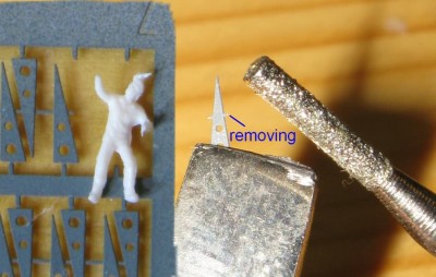

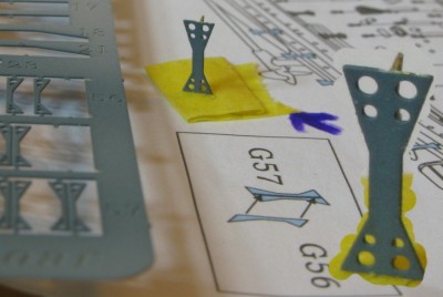

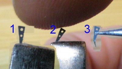

Next I added reinforcement gussets to the HA gun positions. I used gussets No. 6 from the Flyhawk FH-700055 (1/700 WWII PERFORATE GUSSETS), shown in Mogami11 left. I removed the attachments by using a slow turning Dremel-like Proxxon (Mogami11 right).
Mogami11-prepare gusset
� then holding the gusset with a pair of pliers at the correct position for bending (Mogami12-1), bending by finger (Mogami12-2), making it plane and the result (Mogami12-3)
Mogami12-bending gusset
These are two of the HA gun emplacements with the added gussets (Mogami13).
Mogami13-HA-gun positions with attached gussets

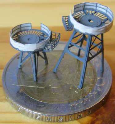

Mogami14 depicts two search light towers. I used a grid from Flyhawk to bend a cage. I think these cages were for storing canvas.
Mogami14-search light towers with cages

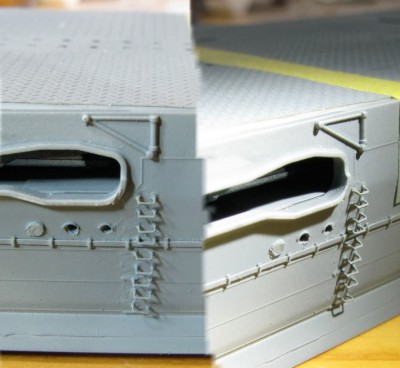

I started to attach step irons to Mogami (Mogami15).
Mogami15-step irons
Mogami15-step irons
I hope �step iron� is the correct term.
They are not as beautiful as the step irons of Le Bosco�s VII-C (Topic Work in Progress Re: Revell VII-C /41 1:72). (I love the step irons of Le Bosco�s VII-C). But okay, in scale 1/350 they are 5 times smaller than in 1/72.

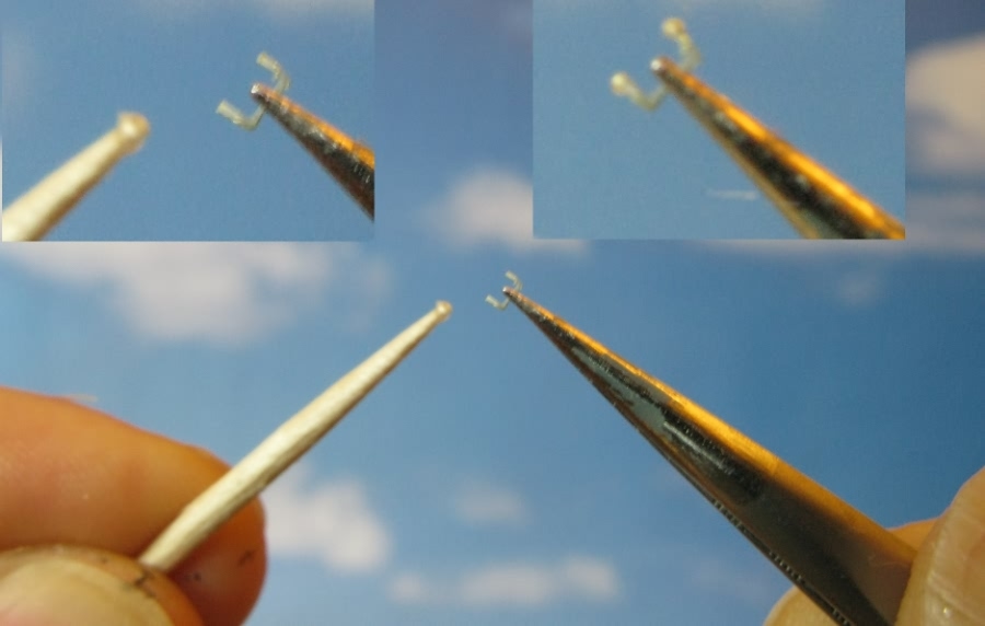

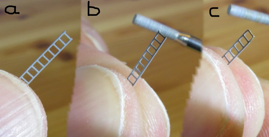

Here is my method:
Mogami16<br />(a) taking a segment of PE ladder with the desired size (easy to handle)<br />(b) grinding the corners to a rounded shape by using a slow rotation dremel (I use  a voltage of 3 V for my Proxxon)<br />(c) after grinding
Mogami16
(c) after grinding
Mogami17<br />(a) end of ladder with rounded egdes<br />(b) bending the tip by a pair of pliers<br />(c) after bending
Mogami17
(c) after bending
Mogami18<br />(a) cutting with scalpel<br />(b) after cutting<br />(c) one step iron ready
Mogami18
(b) after cutting
To be continued �

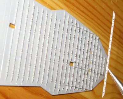

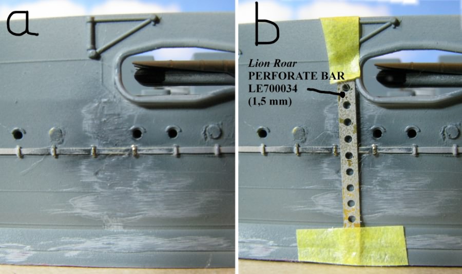

Here now the attachment of the step irons:
Mogami19<br />(a) removing original plastic step irons<br />(b) fixing �perforate bar� into position
Mogami19
Here I used the �1,5 mm� perforate bar from the Lion Roar PE LE700034.
The distance of the perforations is exactly the distance I want for the step irons. (The holes in the Flyhawk perforate bars are too narrow.)
Mogami20<br />(a) using a fine (0,1mm) marker pen �<br />(b) � to produce equidistant marker dots
Mogami20
Mogami21<br />using a toothpick to cover the ends of the step iron with superglue gel
Mogami21
Dirk

Mogami22<br />(a) gluing step iron into position <br />(b) second step iron attached
Mogami22
This is the tricky part :puppy_eyes: because you have to hold the step iron some seconds in the correct position until the superglue �bites�. Due to the gel there is a little bit time for fine adjustment.
I have already shown the final result above (Mogami15; after one cover of Kure grey airbrushing).
