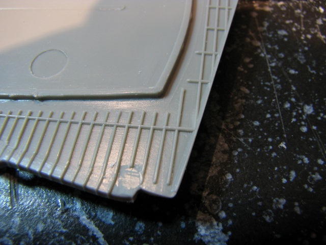

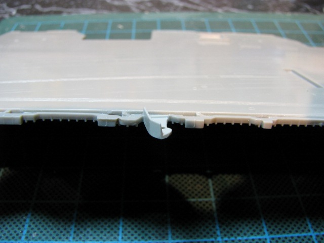

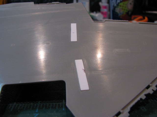

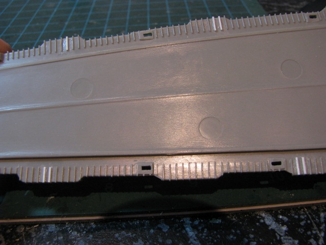

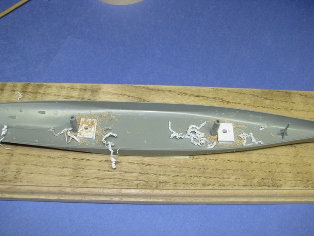

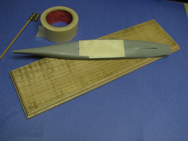

This is my WIP for the venerable Revell 1/720 USS Enterprise CVAN-65 in 1968 configuration.
[I'm also going to build one each of all the CVW-9 Aircraft in 1/72]
I started in December 2012
Below are all the kits, sets, parts, etc. I'll be using. And the references I'm using below that.
(Amazing how much stuff one accumulates!)

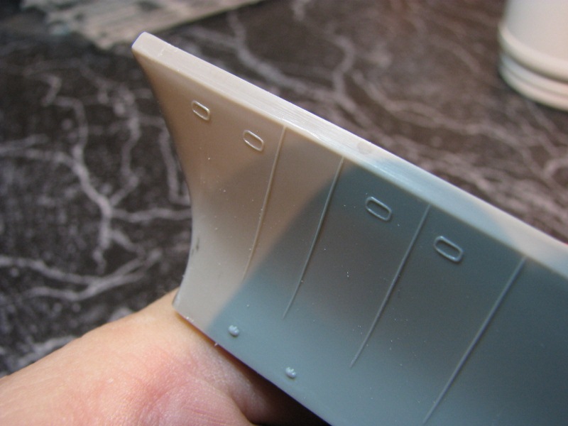

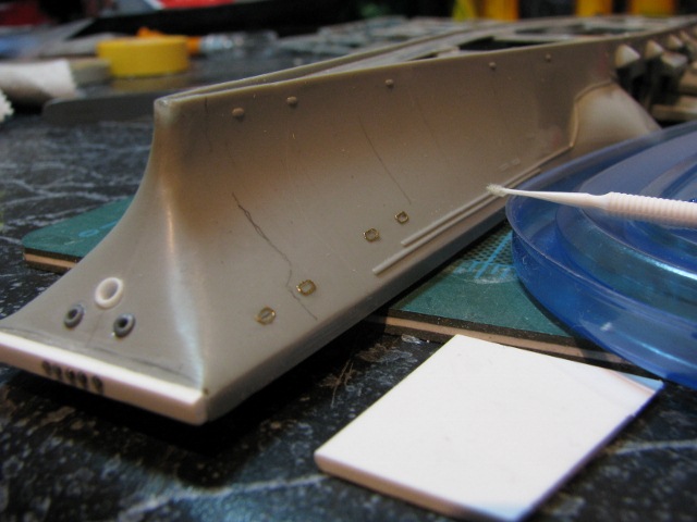

First set of pictures below. More to come...

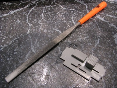

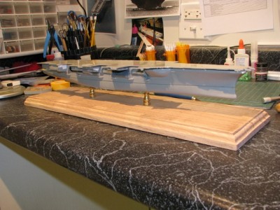

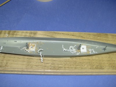

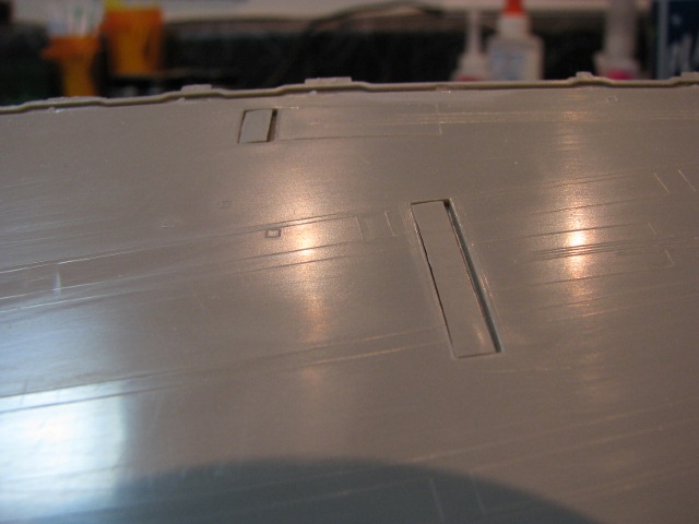

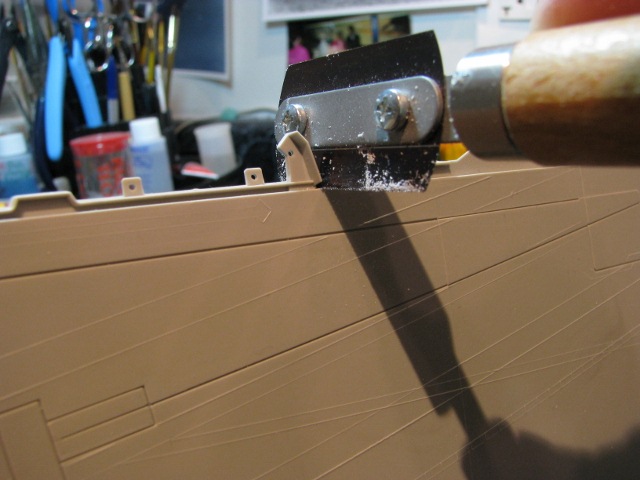

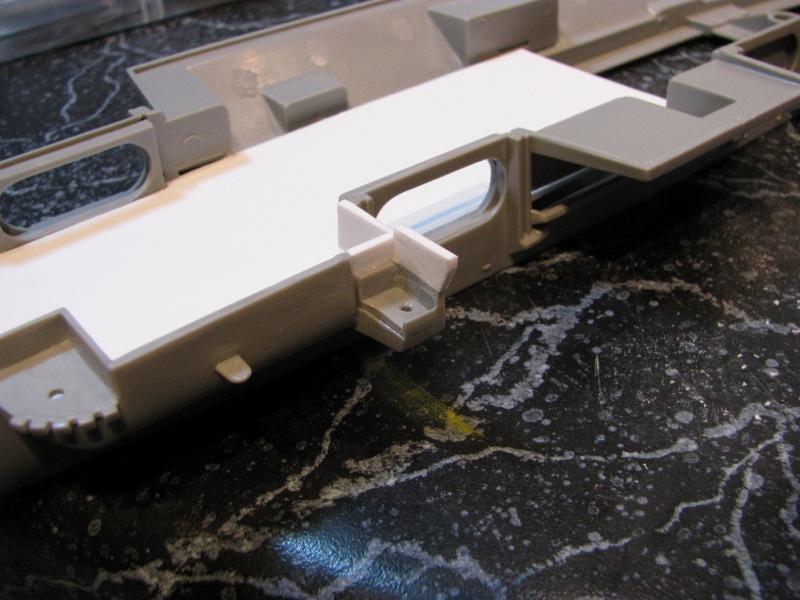

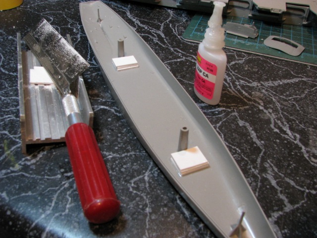

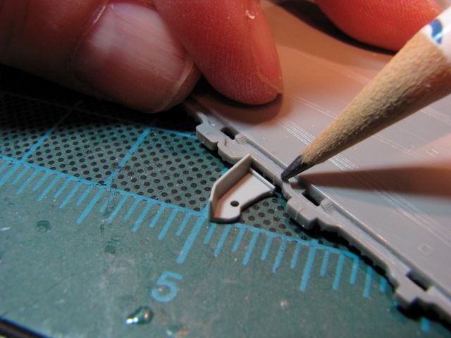

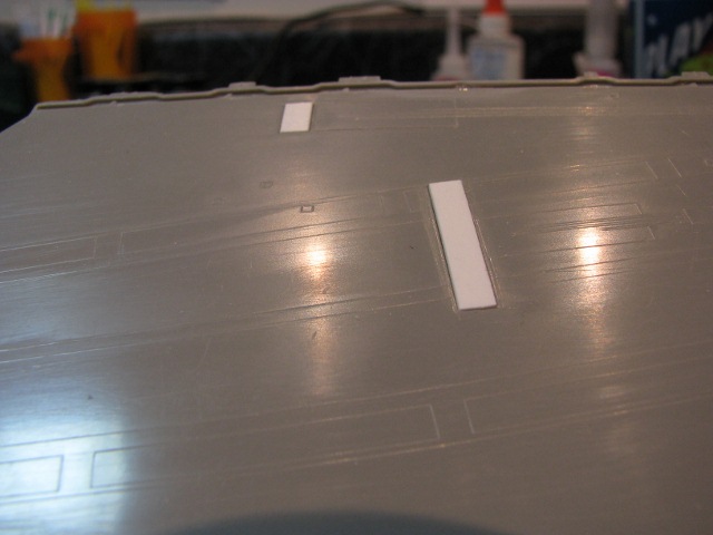

Re: 1/720 Revell USS Enterprise CVAN-65 in 1968 configuratio

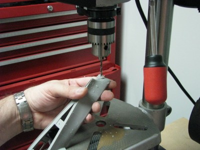

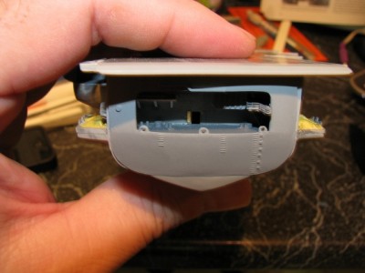

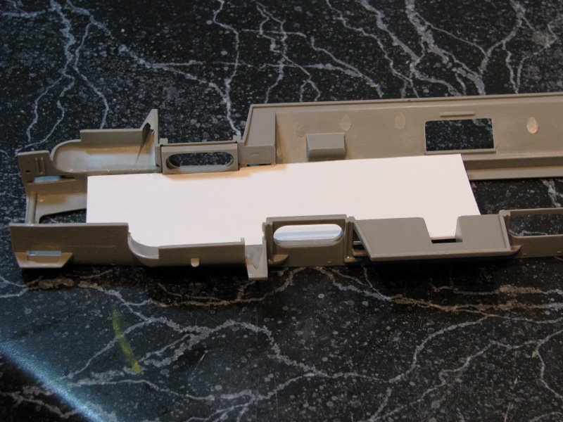

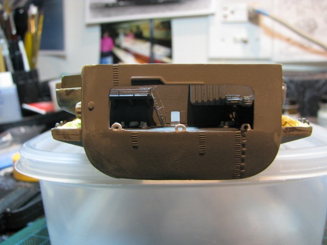

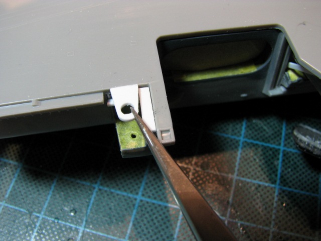

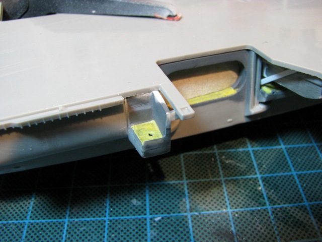

Bought this kit 10 years ago and have been collecting all the aftermarket stuff, not to mention all the 1/72 kits/stuff ever since.
Would be a shame not to build it now.
And from what I understand, the new Dragon will be very accurate....whats the fun in that!?!
It's the fixing up, scratchbuilding, and correcting that challenges and forces the learning of new skills / techniques.
But seriously, the Dragon will save modelers who want accuracy a lot of money...all that stuff to correct this thing wasn't cheap.

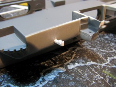

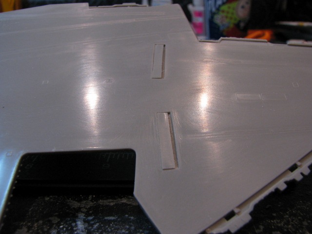

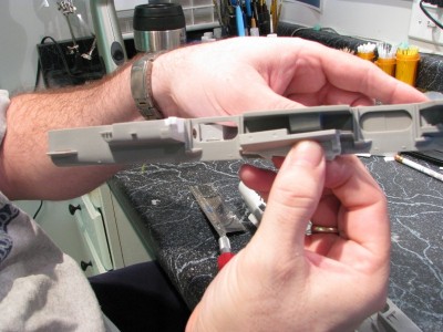

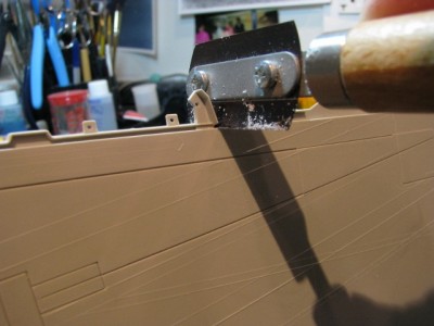

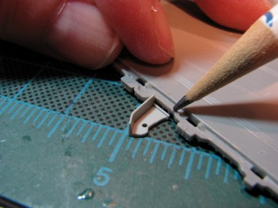

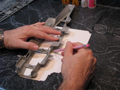

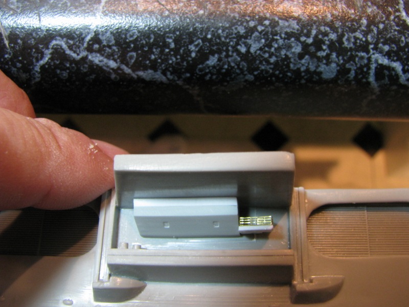

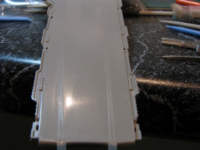

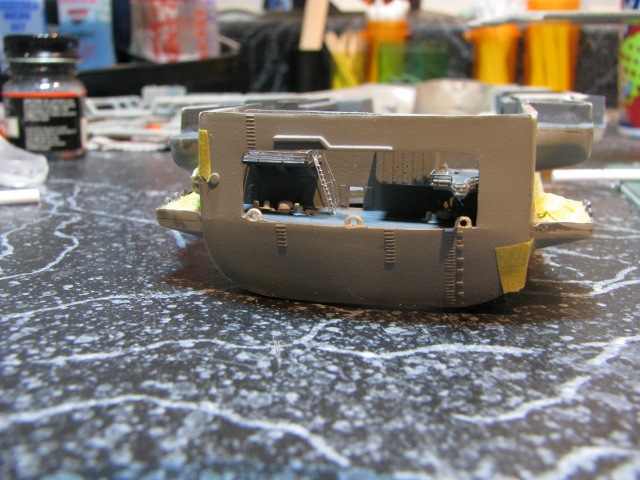

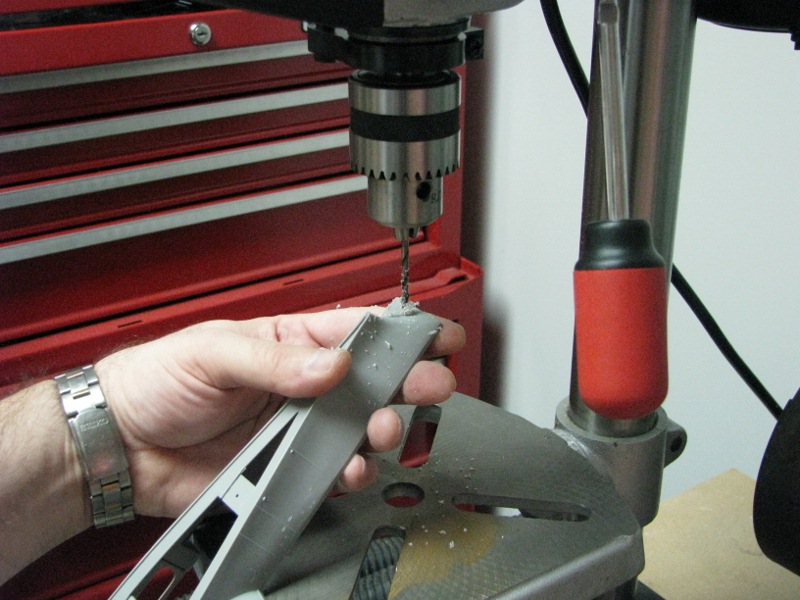

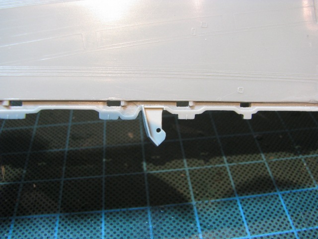

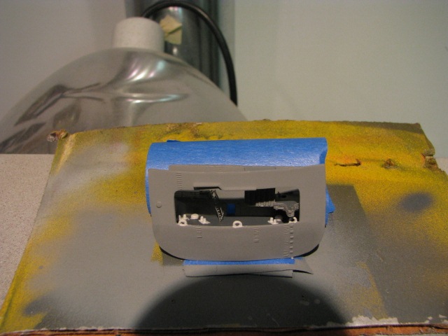

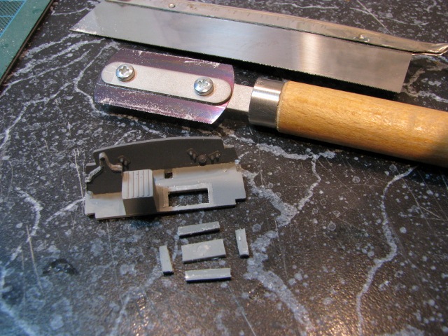

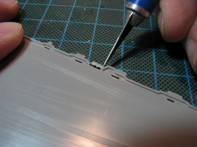

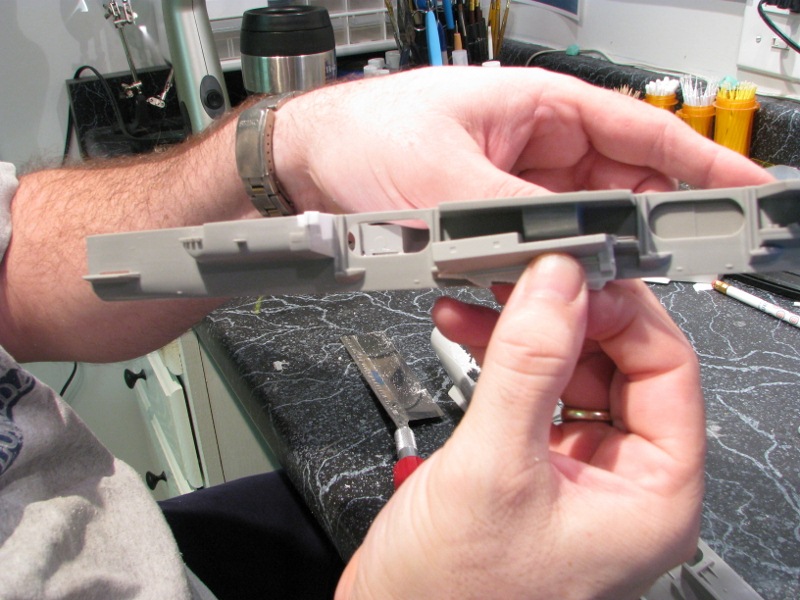

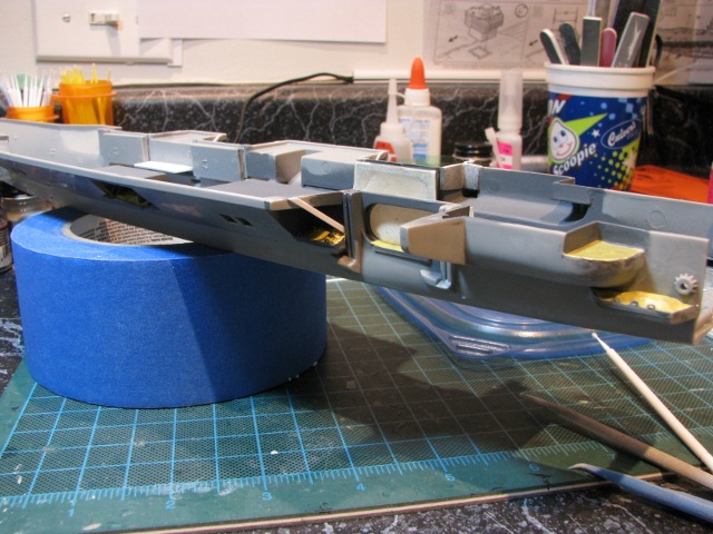

Speaking of corrections, below is opening 2 doors, the partial hangar deck, corrected crane area, and workshops/rooms on the starboard side.

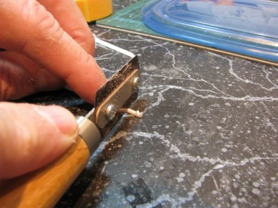

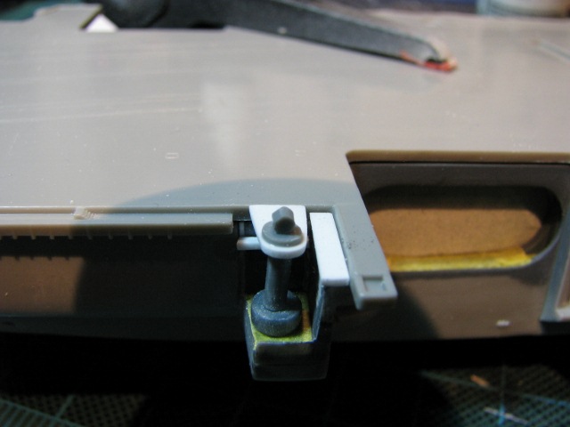

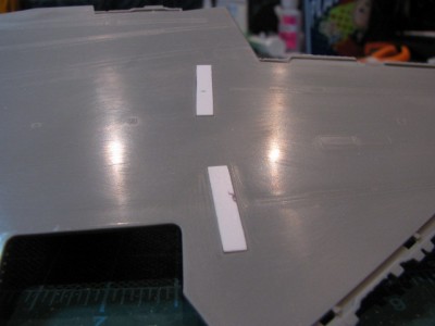

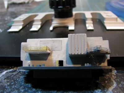

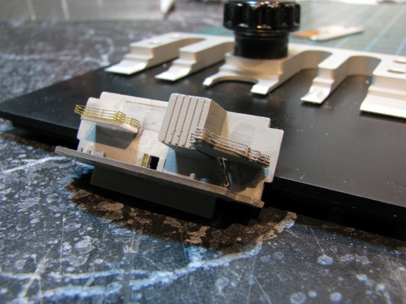

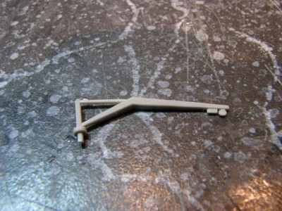

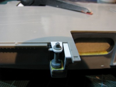

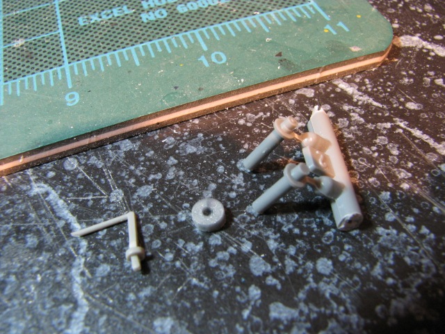

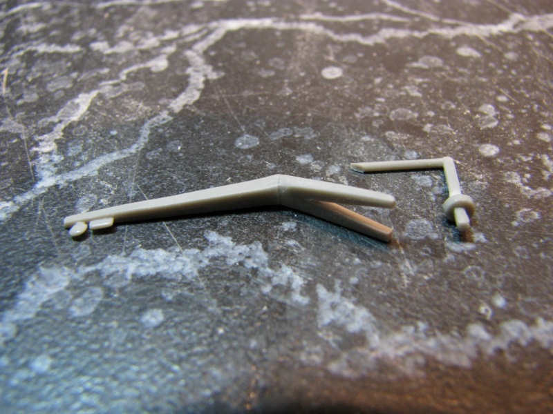

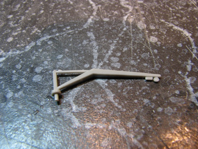

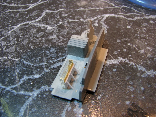

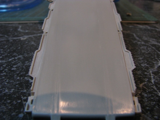

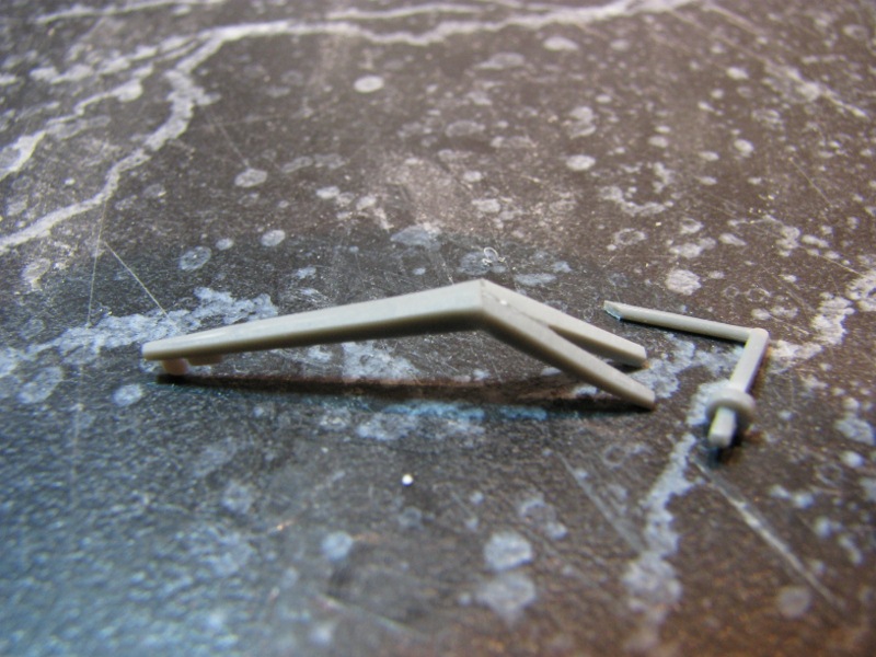

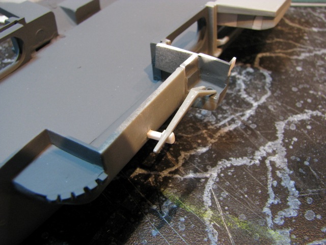

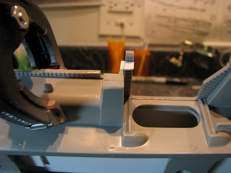

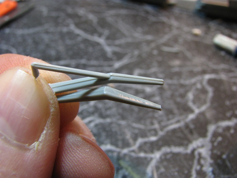

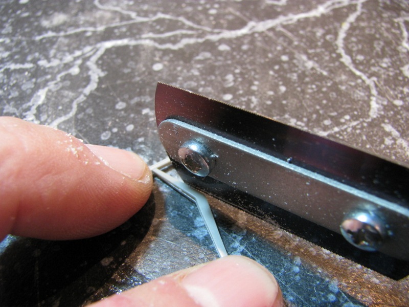

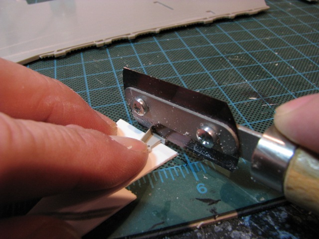

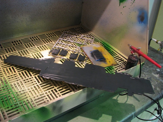

Corrected the crane - (again canibilized the Independence crane for half of it )

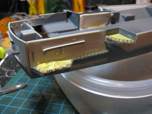

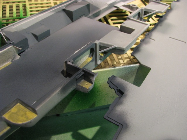

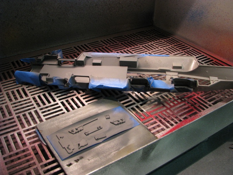

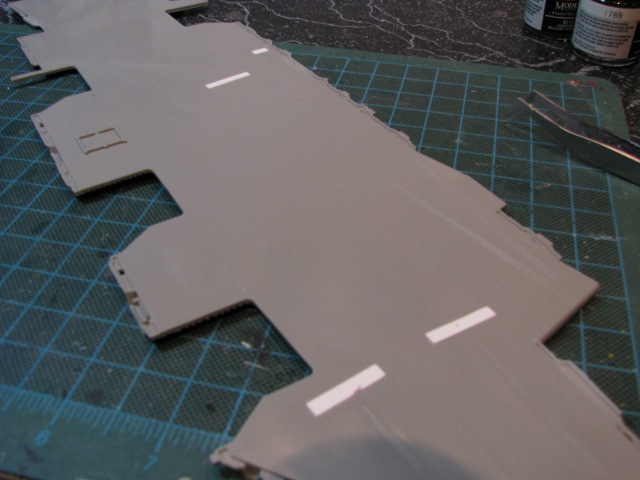

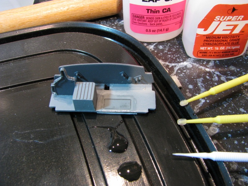

Painted horizonal surfaces of the various sponsons/platforms and hangar deck

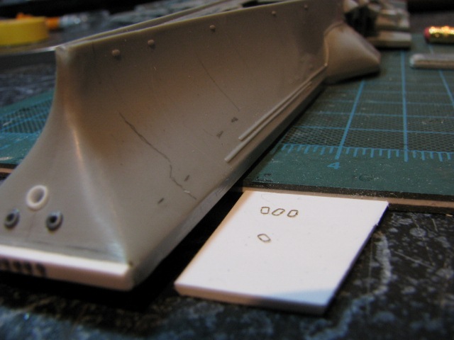

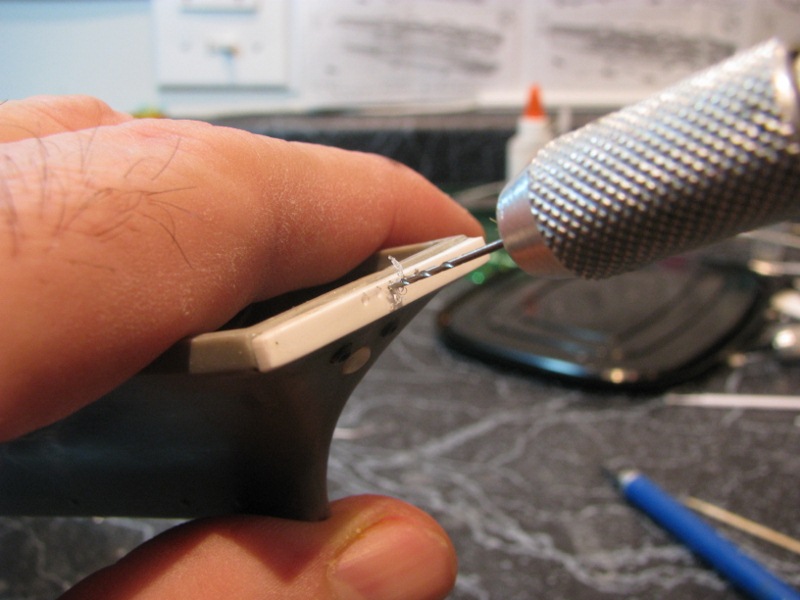

Mark, I checked out your page....wow nice job on those Vikings! Your skills look fine to me!
Up until mid last year I was exclusively a plane guy, 1/72 & 1/144. My last build was the 1/700 CV-8 Hornet and correspondingly Doolittle's B-25 in 1/72.
The Hornet was my first experience with photo etch. It was like I had never built a model before! But once I got the hang of it, I was hooked and decided to tackle this Big E kit which I'd had for some time.
I also have one of each of the aircraft in CVW-9 (on Enterprise in 1968) in 1/72. And I'm thinking what I'll do (once the ship is done) is build a 1/72 aircraft first, then with that as the example, try to replicate it as best I can in the 1/700/720 squadrons, then on to the next one, and so on. That way the whole project (1/720 ship w/aircaft and 1/72 aircraft) will finish up at the same time. (And there's an Airwing Forum on this site, so maybe I'll post progress on those there when the time comes)
I decided to take this approach after having done the 1/700 B-25s with the Hornet, then wishing I'd waited after I did the 1/72 B-25 and looked back at the 1/700s afterward. I would have done a few things different for better accuracy.
So given you've done the Vikings already, maybe you might want to keep going with the rest of that Ranger's air wing.

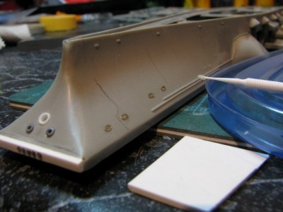

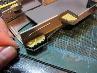

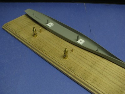

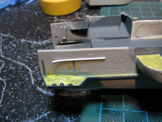

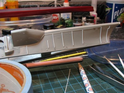

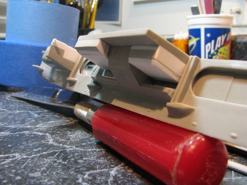

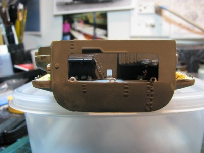

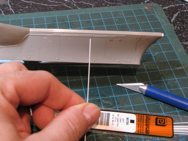

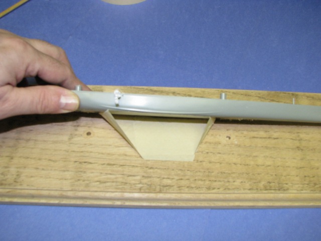

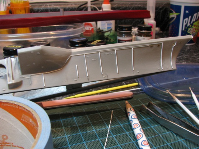

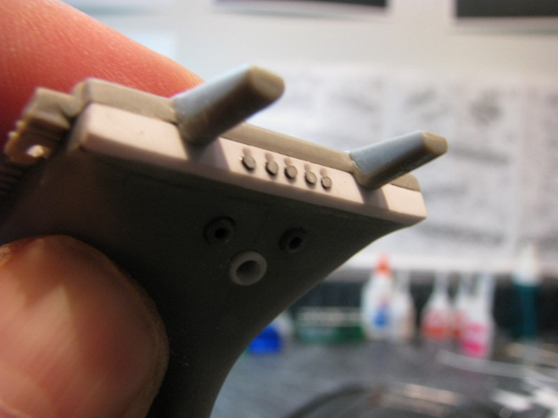

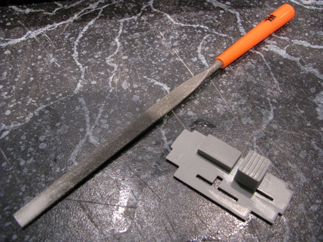

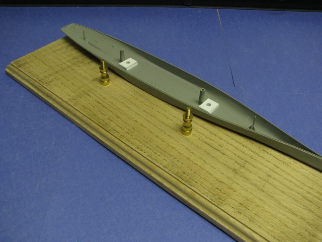

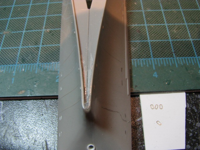

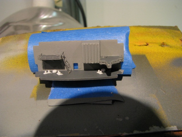

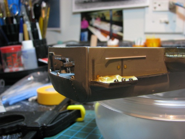

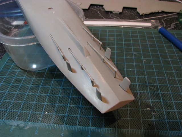

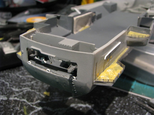

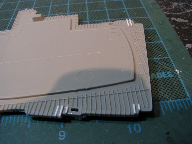

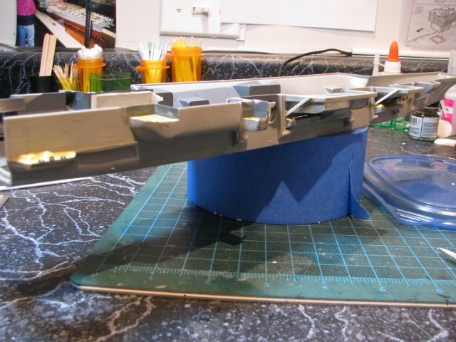

Anyway, below are pictures of the "stash" and my latest work to correct the fantail/aft.

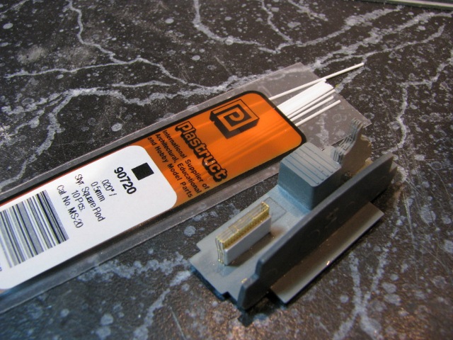

And my Plastruc square rod just arrived so I'll be going back and adding supports and posts under the added decks and platforms soon. And I obviously still have to add ladders here and there.

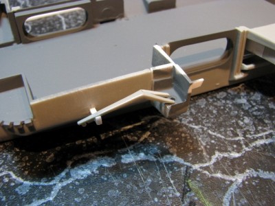

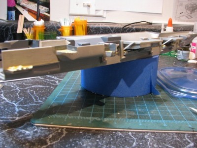

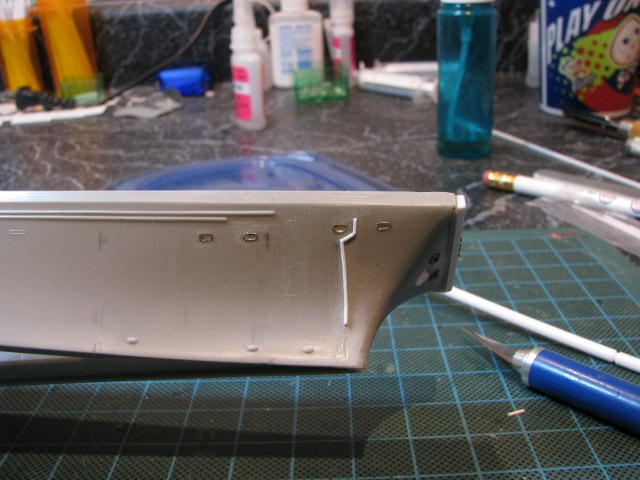

Was distracted by a school project with the oldest, a scale Parthenon, for her social studies class.
Finally have the workshop back to myself.

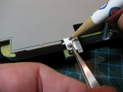

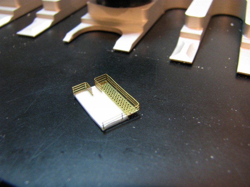

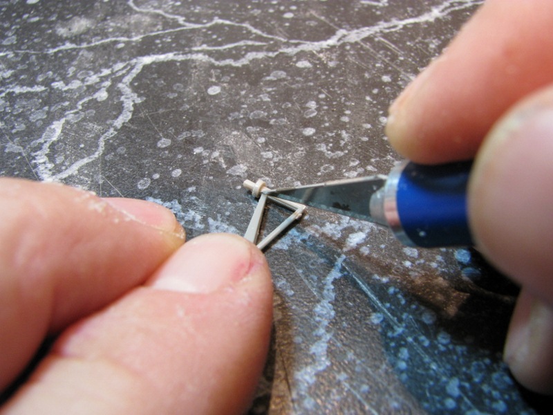

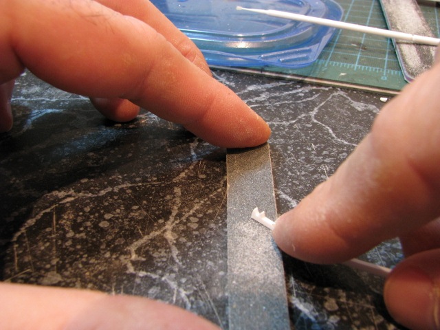

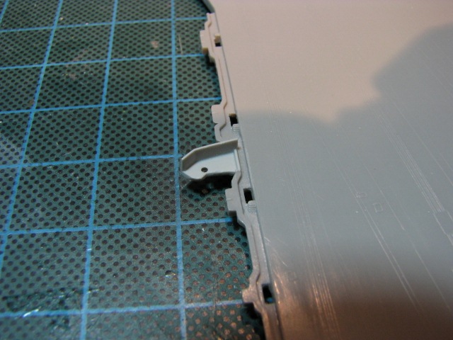

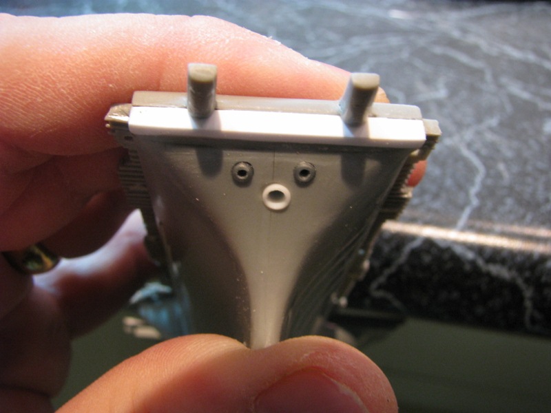

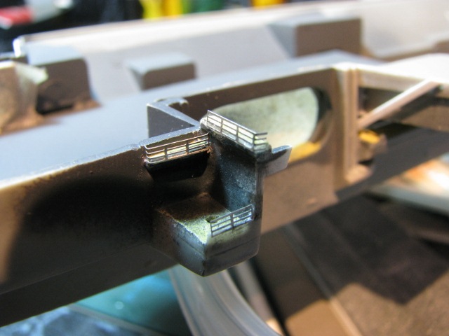

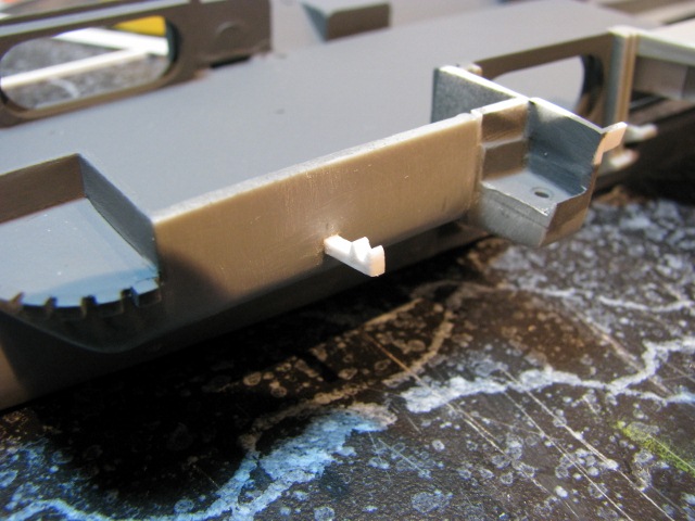

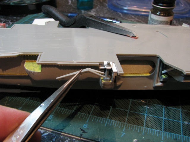

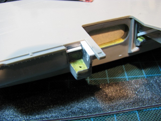

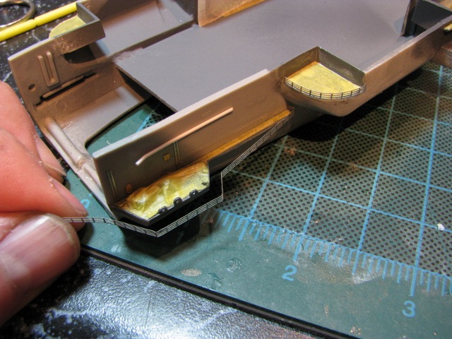

Shots below - fixed the resting point for the crane and added supports to the platform aft.

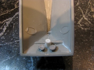

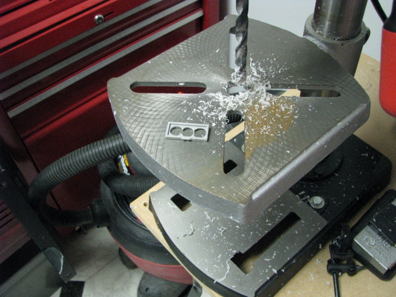

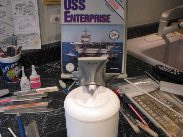

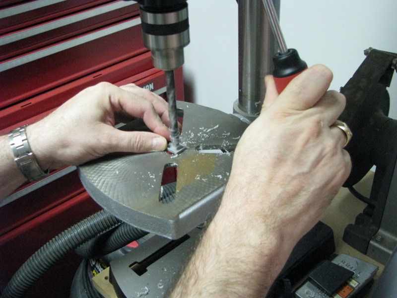

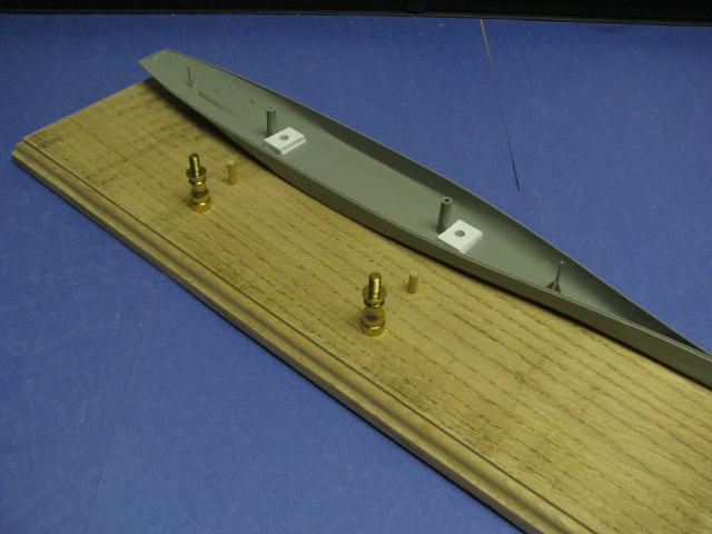

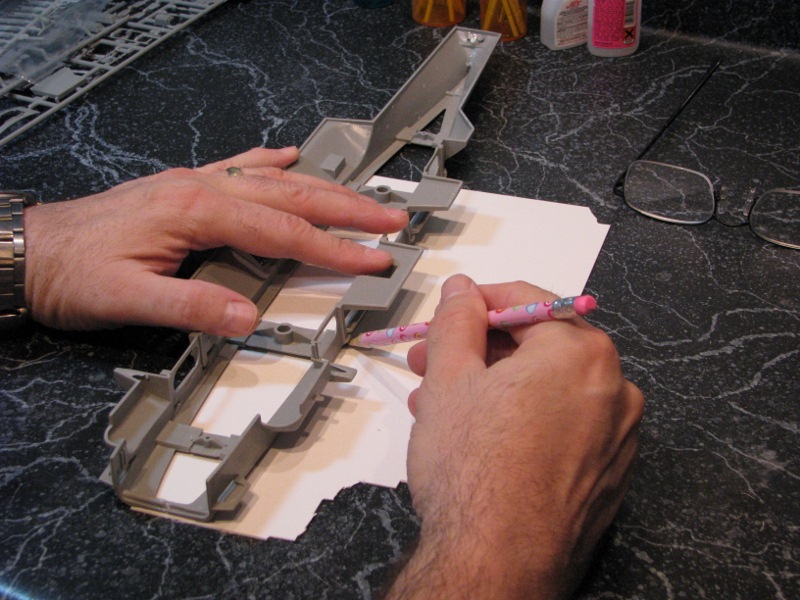

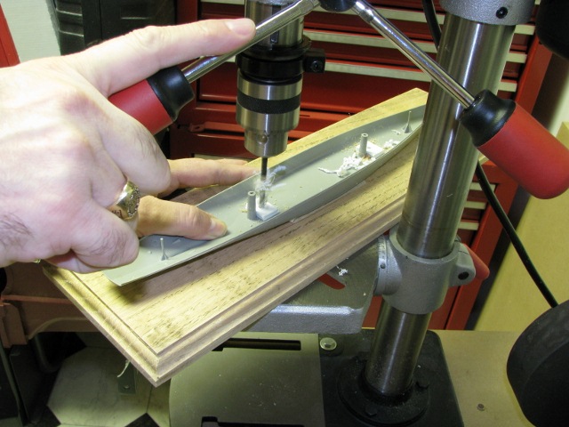

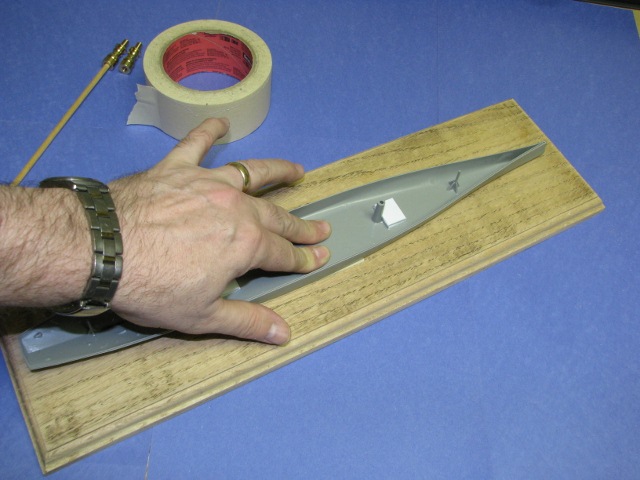

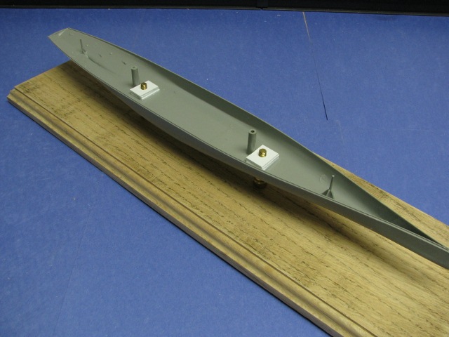

I'm coming to the point where I'll have to bring the 3 horizontal sub-assembilies/sections together, the lower hull, upper hull and deck.
Luckily I realized I should address how the ship will be mounted now and prepare for that.
So I built up the hull in the 2 finiale attachment points with 3 layars of .6mm styrene sheet about a 1/2 inch square and super glue.
Dry fit the ship from deck down; placed on the oak base; line up the ship and marked the base.
Taped the bottom hull section to the base as marked
Drilled holes through the bottom hull section and into the display base simaltaneously
Cut doll rods to size and place finials over rods
Placed ship over finial tops
Now I can assemble the hull, and continue buiding from the hull up to completion; as well as sand and stain/varnish the base; then glue one to the other when the time comes.

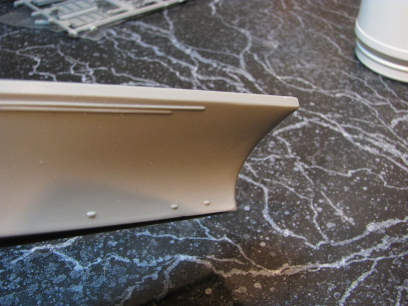

More shots of dry fit ship on the finiales.
Dry fit the fantail

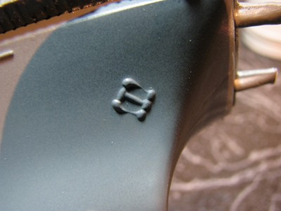

Used PE WWII bulkhead door openings as mooring line openings on port side bow
Marked out and started adding drain pipes on port bow; but thinking Ill attach and clean up lower hull first.
Dry fit the fantail

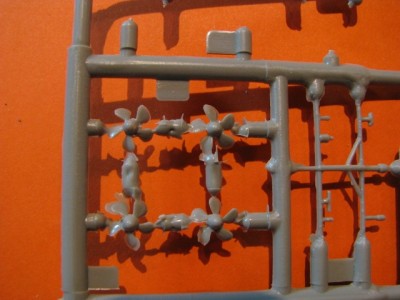

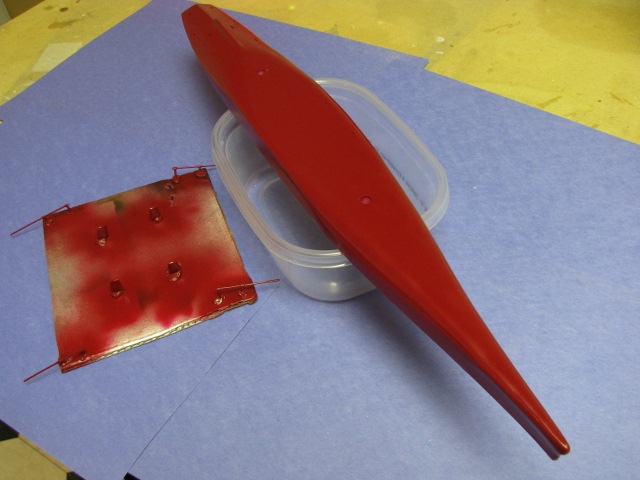

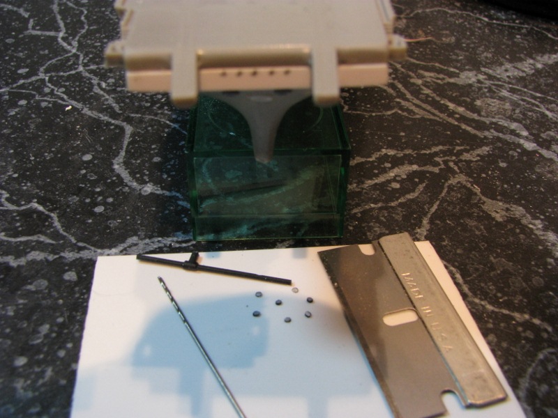

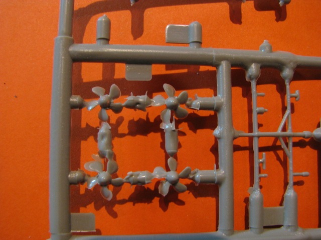

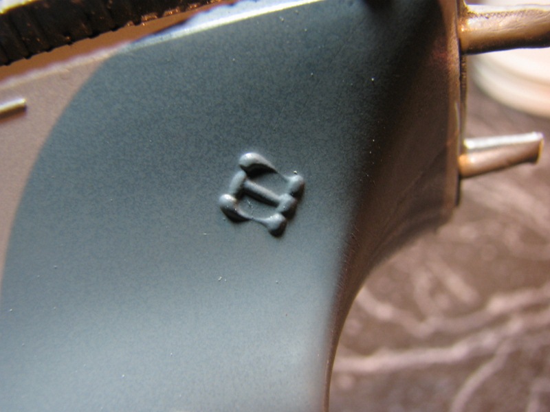

Progress over the weekend:
Cleaned up the rudder and prop shaft kit parts and dry fit. I'll use orig kit parts if possible, probably look better with scratch built metal, but we have to chooose our battles.
Scratch built the drain pipes on port side
Painted the lower hull, rudders and shafts
Painted the new platform on fantail; completed detail painting the aft/fantail and did final dry fit.
Added angled support beams starboard and port. Masked all decks and doorways starboard and port
Now on to carving the props out of the sprue ....Holy Excessive Flash, Batman!
Thanks all for the kudos. Just taking my time and doing the best I can.
Below is this evening's work...
Removed all the molded in hose reels (which will be replaced by PE)
Terrible fit on the kit blast shields so I made new ones from sheet styrene
They are NOT glued in. Will most likely pose at least one raised for a take off.
I think the deck is now ready for paint

Today's progress:
Not quite time to paint the deck yet.....
Cleaned up the ejection pin marks on the underside of the flight deck and replaced the obliterated support struts with .5mm Plastruct square rod. Would anyone have noticed? Probably not. But I would have known, and it would have bugged me.
Also canabalized the fresnel lens platform from the Italeri CV-62, Independence kit. Removed the deck edge in the appropriate spot on the port side. And grafted the platform on.
The weekend update�
More fixing up around the crane � added 2 walkways.

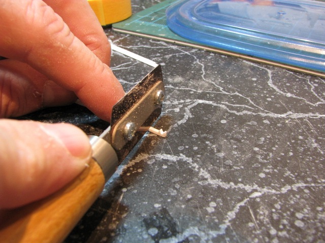

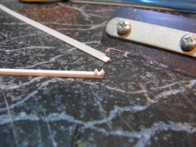

I was disappointed with the kits crane mast � not thick enough and the upper portion of the mast is completely wrong as it is not even attached at deck level�. so more scratch building.
I found some good bits in the spares box.
I crafted the upper support structure out of sheet styrene and drilled a hole for the mast rod.
Lined up the support and marked it at the right depth and dry fit
I cut the top of the mast piece and flipped it to create the pulley at the top of the mast
Dry fit of the new mast and supporting structure surrounded by new walkways
Dry fit with the previously corrected crane
Finally ready for the flight deck paint. First I hit the edges and new decks and masked.
Based on research and photos, the flight deck is a dark asphalt grey.
Based on some reading, I combined the following. I started with a combo of the first 3 then added black to darken to my satisfaction.
40% Navy Gloss Gray FS 16081
35% Dark Sea Blue FS 15042
10% RAF Dark Green
15% Flat Black FS 37038
And lastly, while I let the flight deck dry/harden for a few days at least, I�m starting on the PE details around the upper hull.
10% RAF Dark Green
Well, I went to start the PE railing and realized its time to put the fantail on�.so I did.
Then added railing �.got from the fantail around to the crane last night.
