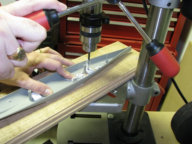

File comment: Drilling the bow openings

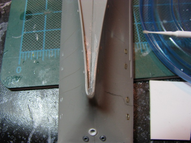

File comment: Correcting the bow with sheet styrene

File comment: Corrected bow (for now)

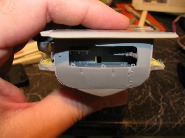

Speaking of corrections, below is opening 2 doors, the partial hangar deck, corrected crane area, and workshops/rooms on the starboard side.
File comment: Drilling open the hangar doors

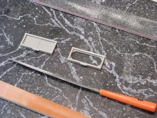

File comment: Deconstructing kit part

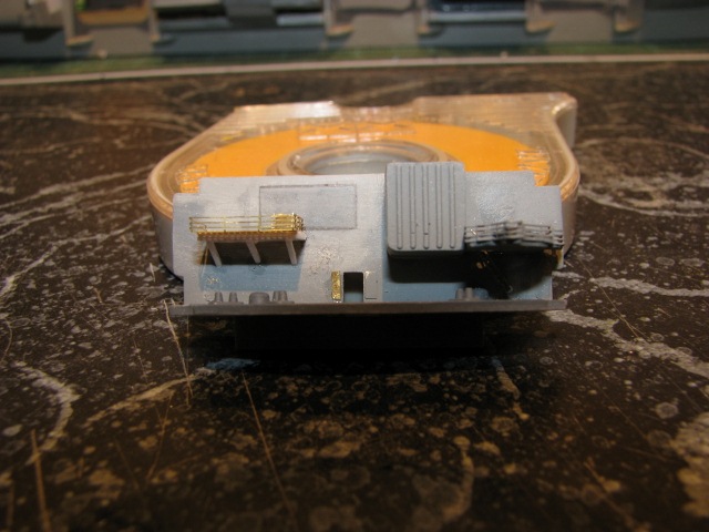

File comment: Half Entrps crane, half Indy crane

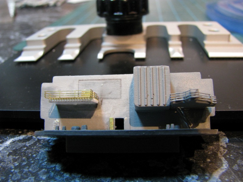

File comment: Finished (for now) product

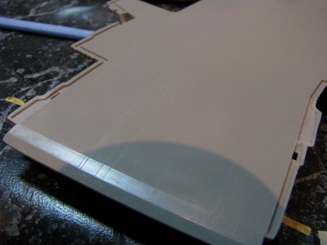

PostPosted: Mon Feb 18, 2013 12:53 pm
Joined: Thu Oct 18, 2012 9:52 am
Posts: 104
Location: Illinois, USA
Was distracted by a school project with the oldest, a scale Parthenon, for her social studies class.
Finally have the workshop back to myself.
Shots below - fixed the resting point for the crane and added supports to the platform aft.

I'm coming to the point where I'll have to bring the 3 horizontal sub-assembilies/sections together, the lower hull, upper hull and deck.
Luckily I realized I should address how the ship will be mounted now and prepare for that.
So I built up the hull in the 2 finiale attachment points with 3 layars of .6mm styrene sheet about a 1/2 inch square and super glue.
Dry fit the ship from deck down; placed on the oak base; line up the ship and marked the base.
Taped the bottom hull section to the base as marked
Drilled holes through the bottom hull section and into the display base simaltaneously
Cut doll rods to size and place finials over rods
Placed ship over finial tops
Now I can assemble the hull, and continue buiding from the hull up to completion; as well as sand and stain/varnish the base; then glue one to the other when the time comes.
File comment: I built up the hull in the 2 finiale attachment points with 3 layars of .6mm styrene sheet about a 1/2 inch square and super glue

More shots of dry fit ship on the finiales.
Dry fit the fantail
Used PE WWII bulkhead door openings as mooring line openings on port side bow
Marked out and started adding drain pipes on port bow; but thinking Ill attach and clean up lower hull first.
File comment: dry fit ship on the finiales

Progress over the weekend:
Cleaned up the rudder and prop shaft kit parts and dry fit. I'll use orig kit parts if possible, probably look better with scratch built metal, but we have to chooose our battles.
Scratch built the drain pipes on port side
Painted the lower hull, rudders and shafts
Painted the new platform on fantail; completed detail painting the aft/fantail and did final dry fit.
Added angled support beams starboard and port. Masked all decks and doorways starboard and port
Now on to carving the props out of the sprue ....Holy Excessive Flash, Batman!

File comment: Scratch built the drain pipes on port side

Below is this evening's work...
Removed all the molded in hose reels (which will be replaced by PE)
Terrible fit on the kit blast shields so I made new ones from sheet styrene
They are NOT glued in. Will most likely pose at least one raised for a take off.
I think the deck is now ready for paint

File comment: Molded in reels gone
File comment: Bad fit of the kit blast shields
File comment: New shields from sheet styrene
File comment: New shields from sheet styrene, not glued yet.

- Revell 1/720 USS Enterprise CVAN-65 ca.1968

PostPosted: Sat Mar 02, 2013 9:04 am

Today's progress:
Not quite time to paint the deck yet.....
Cleaned up the ejection pin marks on the underside of the flight deck and replaced the obliterated support struts with .5mm Plastruct square rod. Would anyone have noticed? Probably not. But I would have known, and it would have bugged me.
Also canabalized the fresnel lens platform from the Italeri CV-62, Independence kit. Removed the deck edge in the appropriate spot on the port side. And grafted the platform on.

File comment: Canabalized the fresnel lens platform from the Italeri CV-62, Independence kit
File comment: Cleaned up the pilfered platform
File comment: Marked the section to remove
File comment: Removed the edge wall to receive the platform
File comment: The new fresnel lens platform attached -1
File comment: The new fresnel lens platform attached -2
File comment: The new fresnel lens platform attached -3

File comment: I hit the edges and new decks and masked
