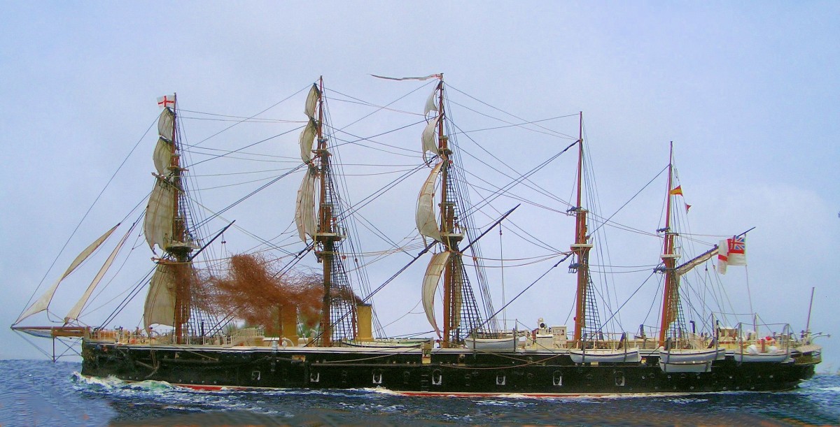

I have been toying with the idea of trying to emulate the famous John Prothero-Thomas, who ( 100% scratch) built the fabulous model of HMS Minotaur in 1/ 384 scale.
.... except I wanted to make life much harder for myself and do it half the size in 1/700...! :cool_2:
JPT's model :

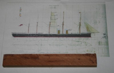

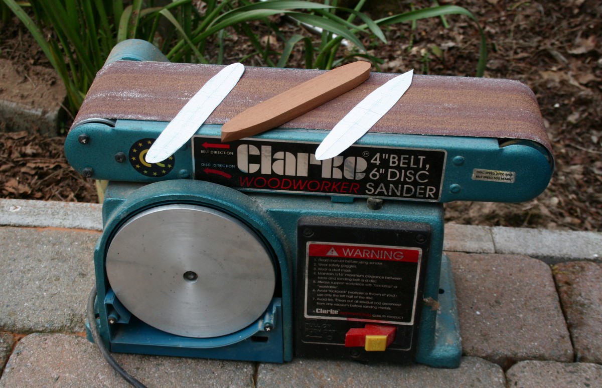

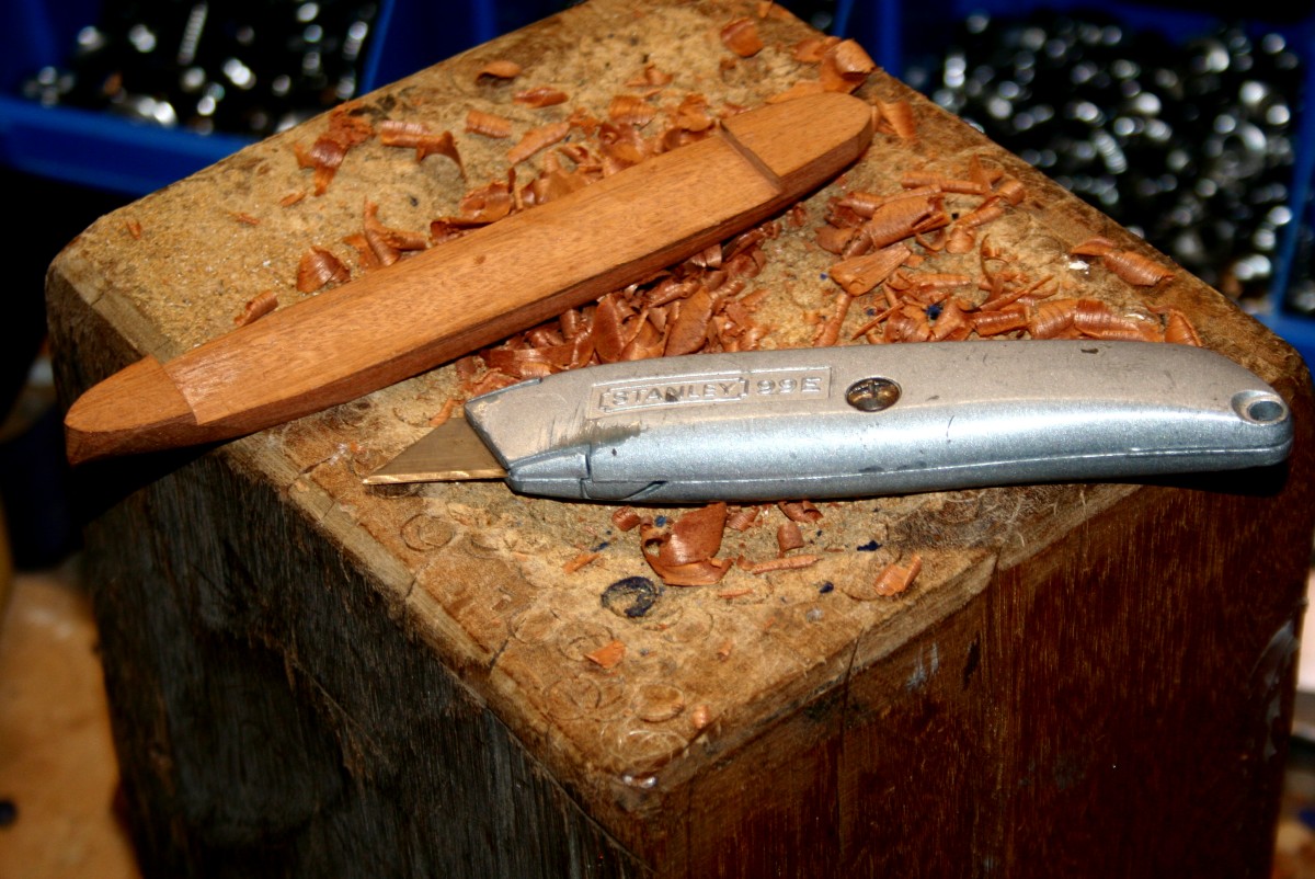

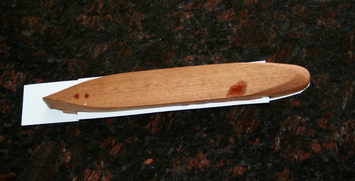

The hull is to be carved from solid wood- a fine piece of 50 year old teak ( I guess it must be seasoned well by now!!!)
-mainly because I want to have solid anchorage for the extensive and complex rig- those five(!) masts are happiest being immovably located in a solid hill--such as resin or hardwood.
- a hollow styrene carcass hull would not in my view give the required strength...

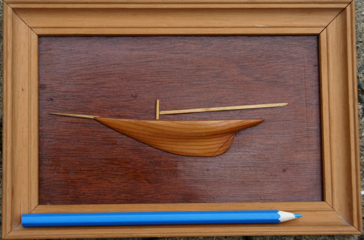

I am also happy carving hull shapes from a blank--I have previous form for this enterprise in my youth..;
==> when I was 17-18 years old I earned myself sufficient money for my first MG sportscar by carving and selling half hull models--using nothing cleverer than a Stanley knife and sandpaper.
*(some of the un-sold ship-models I still have --see below)

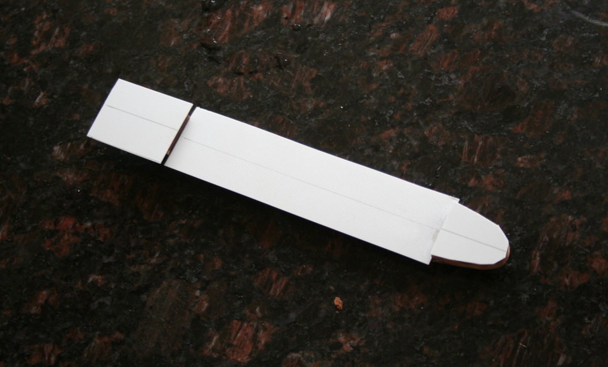

I made some external cross-sectional shape templates in styrene sheet based on JPT's drawing--which in turn is based on the original NMM plans of Agincourt and having rescaled to 1/700 drawings, flipped , reversed and re-sized photos to 1/700 --
I felt a start needed to be made!

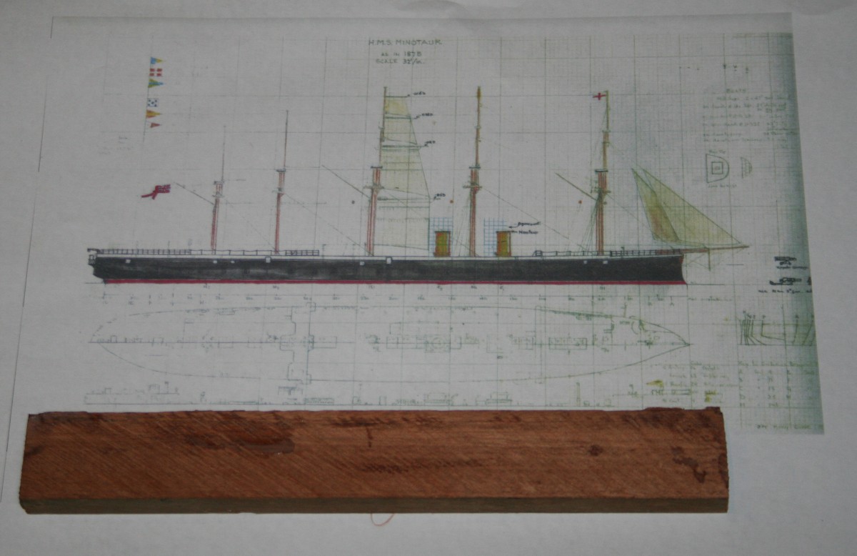

a useful small version of NMM Agincourt plan has appeared in print in a book

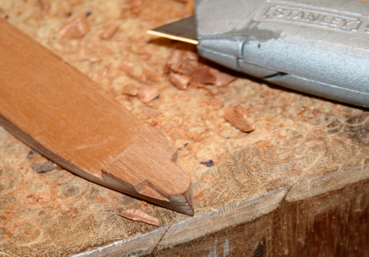

These days I like to get a project moving with greater alacrity than pure hand-whittling -- so resorted to mechanical aids in roughing out the shapes

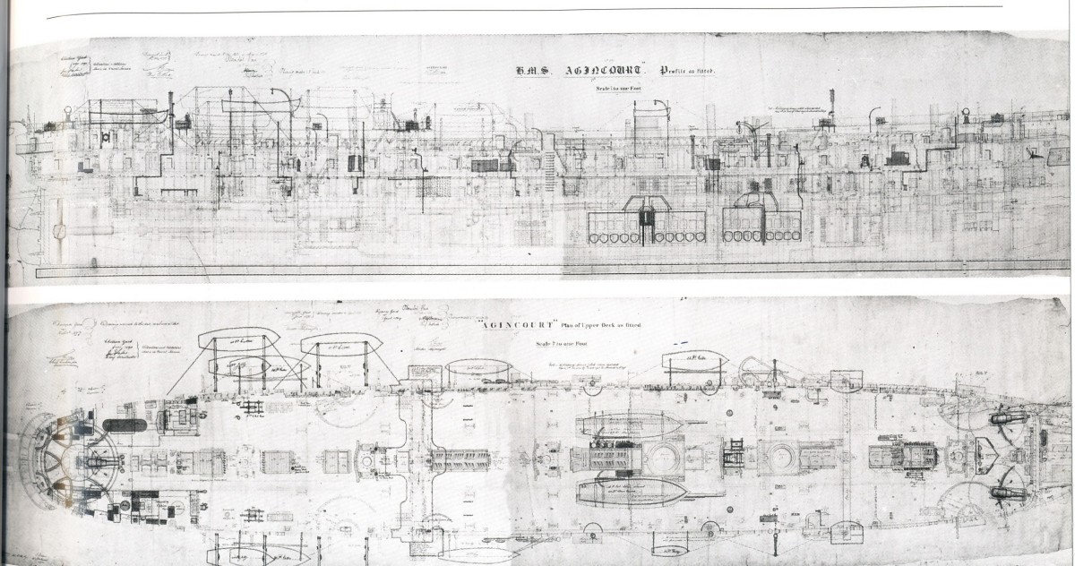

From looking at photos in side elevation is easy to assume that the ship had one long deck
==> ( such as found on he 1860 HMS Warrior!! ) -however there is a distinctive fore and poop deck-- with high Bulwarks atop of which there is the hammock stowage .
Having HMS Warrior a mere 17 miles away is very handy--as Minotaur and Warrior were close contemporaries -and many aspects of fitting out are likely to be very similar
On Agincourt's hull the mid section had to be carved out--I did this with saw cut for and aft and carved the centre out with a 'Stanley' Knife and eventually pared the center deck flat.

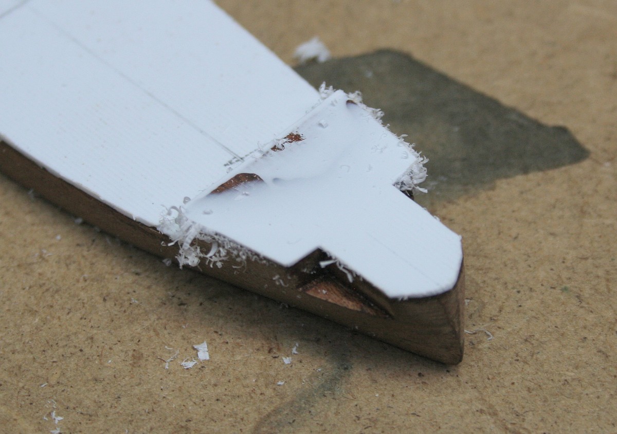

the sharp--yet higher up , very bluff bow was quite tricky to carve

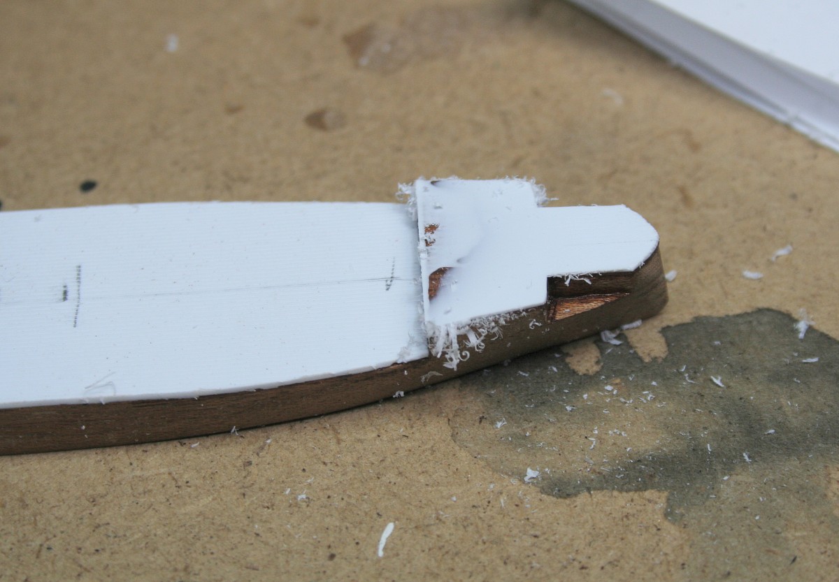

The fwd guns had cutaways either side
Thereafter the deck "planking" made of Evergreen N-sale car siding--was added and glued on with slow-set CA
This will be cut back and sanded flush with the hull.
That is the tangible progress so far .

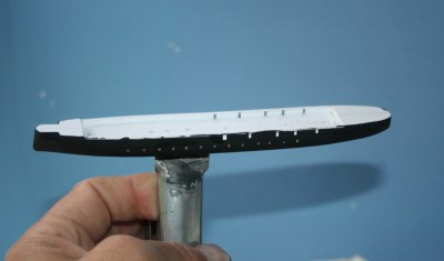

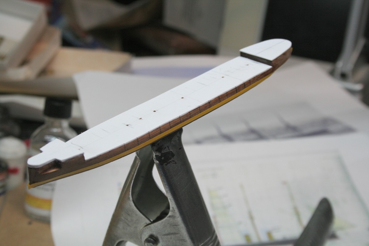

PostPosted: Tue Apr 30, 2013 10:47 am
Posts: 5568

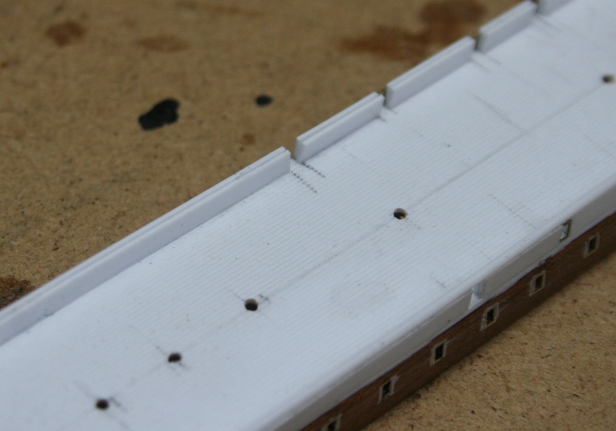

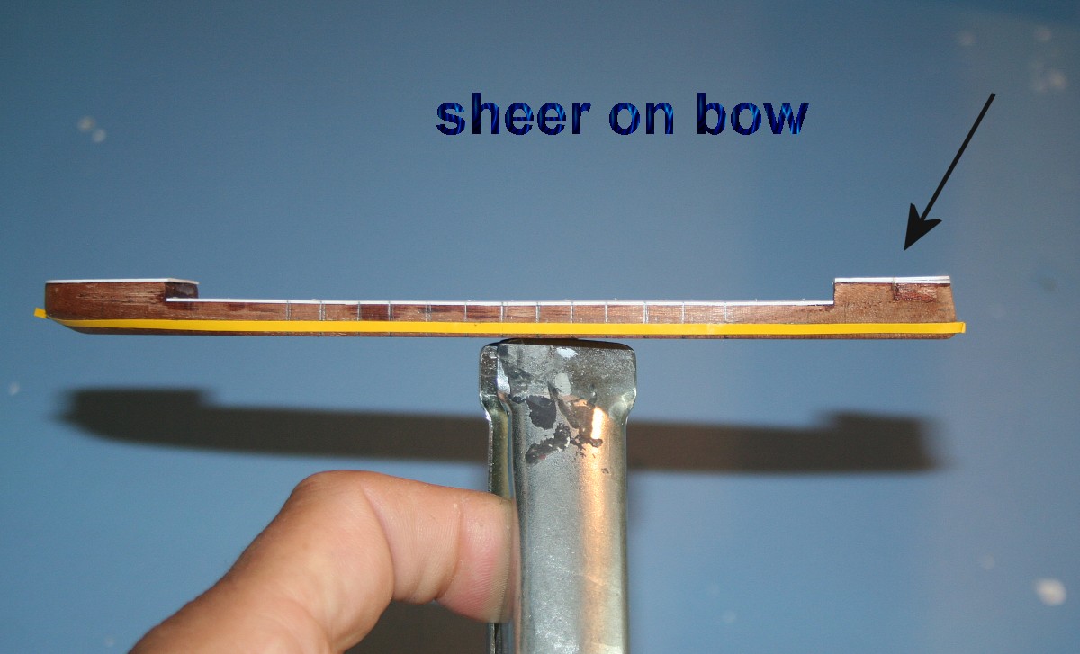

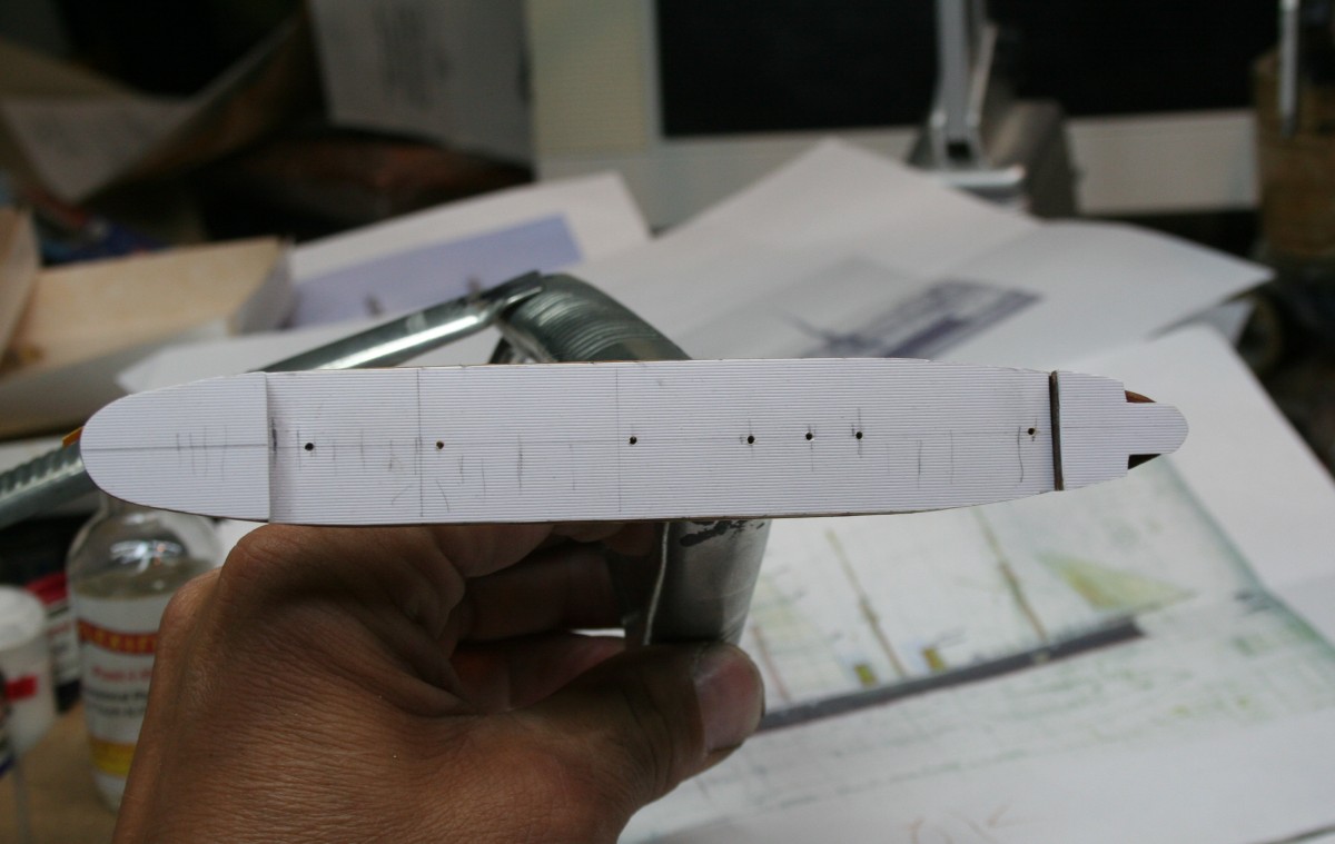

Agincourt had virtually no sheer ( deckspring) fore and aft
certainly nothing discernible in 1/700 APART from the very bow...
I pared down the previously fitted deck to a mere wafer
and re-decked with a small wedge to bring the bow up to match the plans

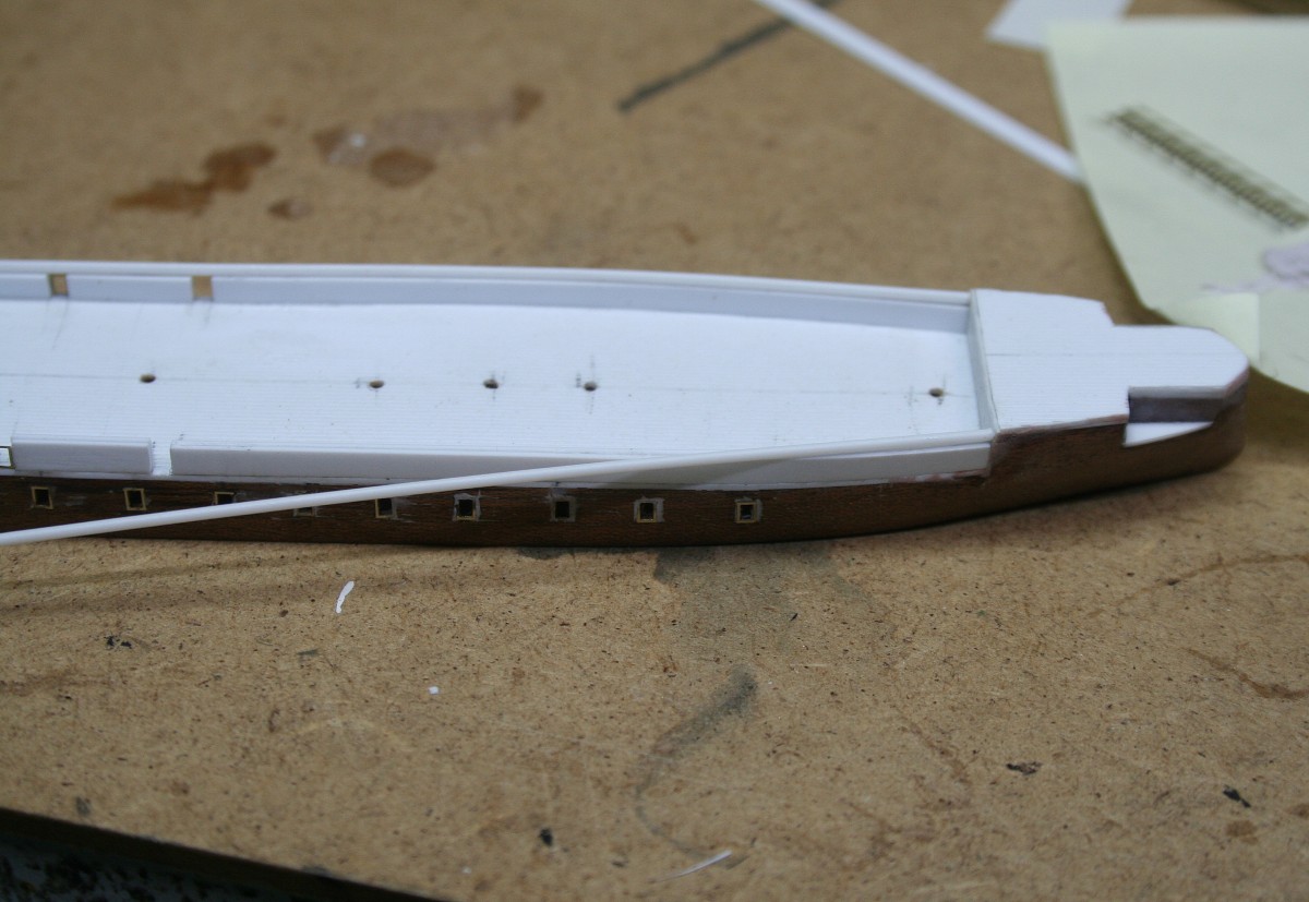

I also drilled all the way through the hull the positions of masts and funnels so as not to lose the items once paint and fittings are added

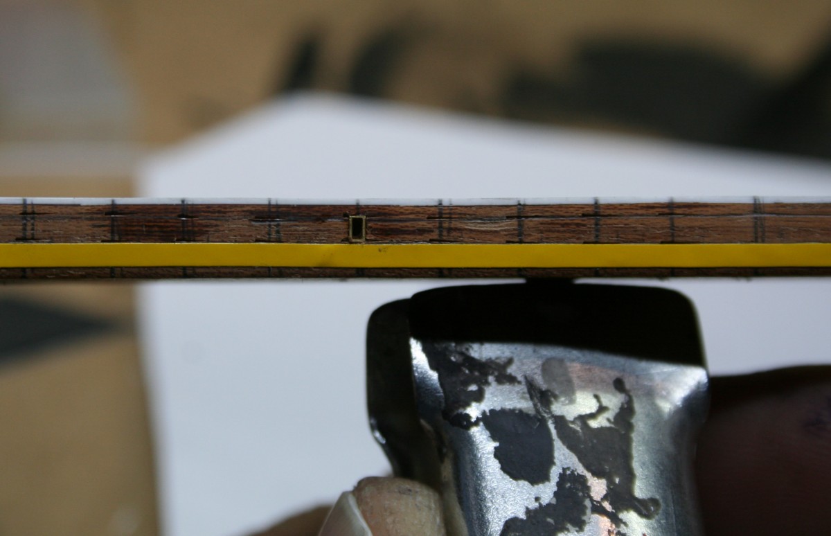

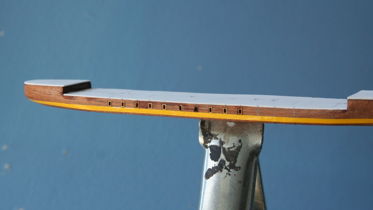

Being a broadside Iron clad she had gunports -- much like HMS Warrior--
a continuation of the multiple levels of gunports of the big Sailing ships-of-the-line( HMS Victory et al !)
The methodology of these held little fear as I had already done similar openings on the resin hull of Jeann'eD'arc
( finished model) http://www.modelshipgallery.com/gallery ... /index.htm
(method in build thread) viewtopic.php?f=59&t=104027
I will however admit to some trepidation--as this was wood.... direction of grain etc
I first assessed and marked their longitudinal positions from plans and photos, then applied some vynil tape to give me horizontal lower edge location...
With a Microchisel ( Mission models-thanks Harry @ BFM ! ) I made a horizontal cut top and bottom and a vertical cut each side.
this then allowed me to 'flip' out the square as it slit on the grain--the advantage of working with wood!

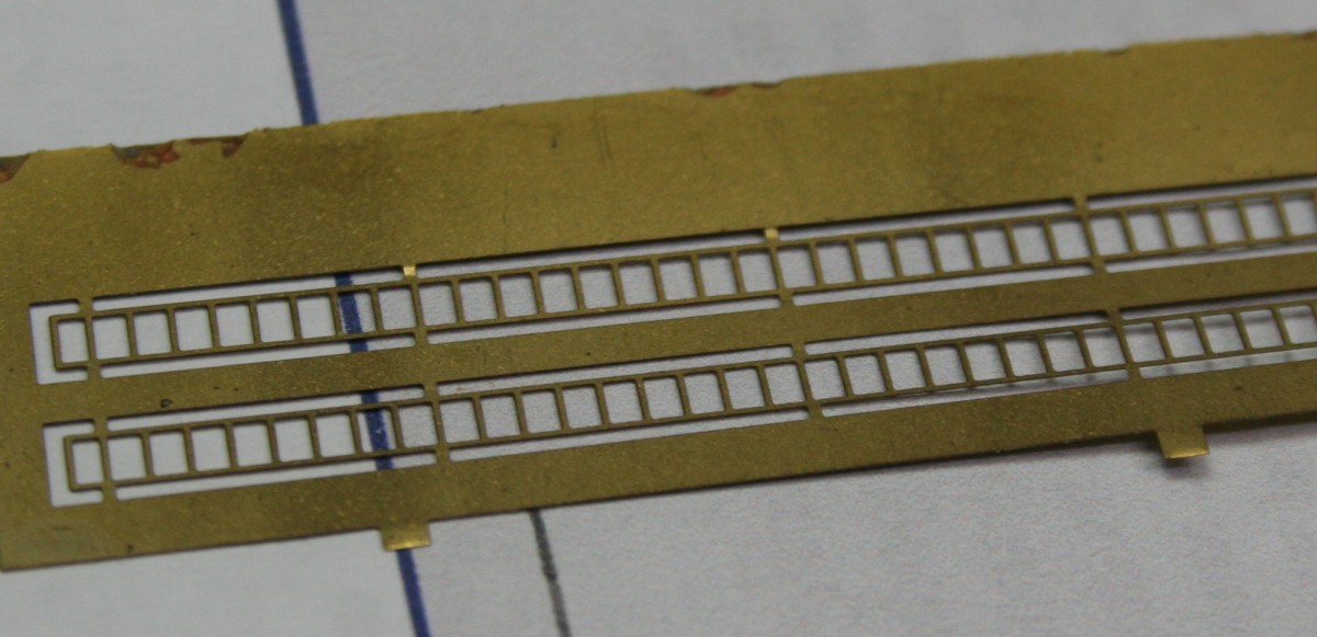

Thereafter I deep drilled the apertures before applying the brass inserts
I deliberately made the apertures oversize--wood is not that precise a medium-( with my lack of wood-know how anyway!)-so as to allow for wiggle room for the insert.
The inserts were made of brass ladderstock.
I sieved thru my PE stash and spares box until I found some 1/200 ladder stock whose internal aperture was suitable.
I the simply edge glued the inserts and spent approx 10-15 mins on each aperture.
I may need to pull some out yet to get them 100% square--but the overall effect should be good.
More progress soon
Jim Baumann :wave_1:

PostPosted: Fri May 10, 2013 7:01 am
Posts: 5568
Contrary to popular opinion I have not fallen off a cliff-- merely 1/1 scale work has been rather hectic of late
The bulwarks have been constructed of two layers of styrene strip with a small gap left on top
This is so as to be able to drop some round styrene rod into it to help simulate the canvas covered hammock stowage
when all is set I shall infill the turn from the edge of the outside of the bulwark to rod so as to give a smooth transition.
First coat of paint will be used a sealing and guide coat when sanding--thereafter a couple of coats of dark grey-black...
then the interesting part begins-- detailing the deck and outside, masts and rigging et al!
