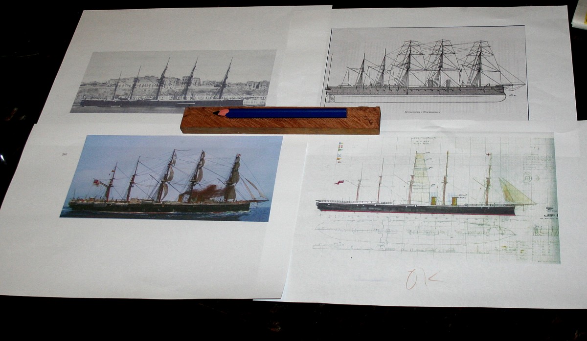

The hull is to be carved from solid wood- a fine piece of 50 year old teak ( I guess it must be seasoned well by now!!!)
-mainly because I want to have solid anchorage for the extensive and complex rig- those five(!) masts are happiest being immovably located in a solid hill--such as resin or hardwood.
- a hollow styrene carcass hull would not in my view give the required strength...
I am also happy carving hull shapes from a blank--I have previous form for this enterprise in my youth..;

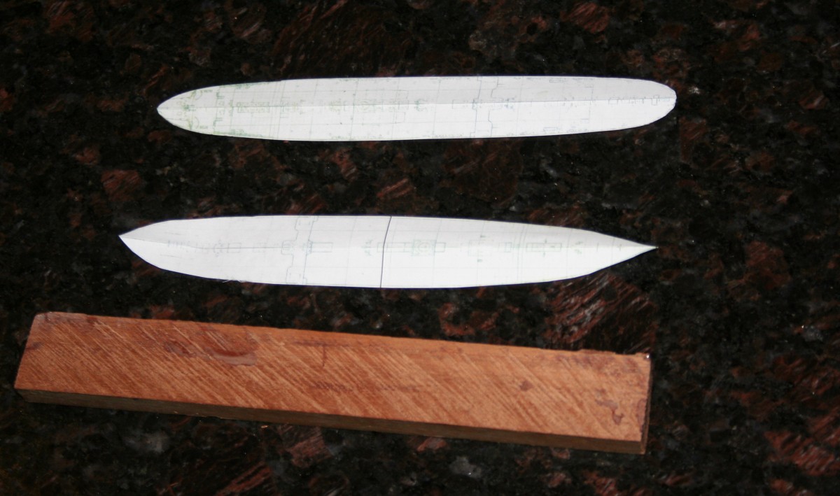

I made some external cross-sectional shape templates in styrene sheet based on JPT's drawing--which in turn is based on the original NMM plans of Agincourt and having rescaled to 1/700 drawings, flipped , reversed and re-sized photos to 1/700 --
I felt a start needed to be made!

a useful small version of NMM Agincourt plan has appeared in print in a book
These days I like to get a project moving with greater alacrity than pure hand-whittling -- so resorted to mechanical aids in roughing out the shapes

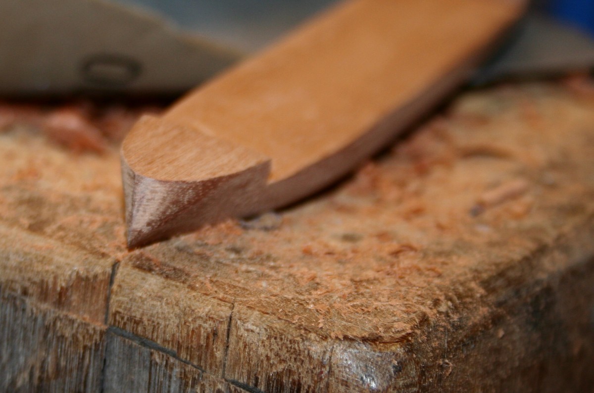

On Agincourt's hull the mid section had to be carved out--I did this with saw cut for and aft and carved the centre out with a 'Stanley' Knife and eventually pared the center deck flat.
the sharp--yet higher up , very bluff bow was quite tricky to carve

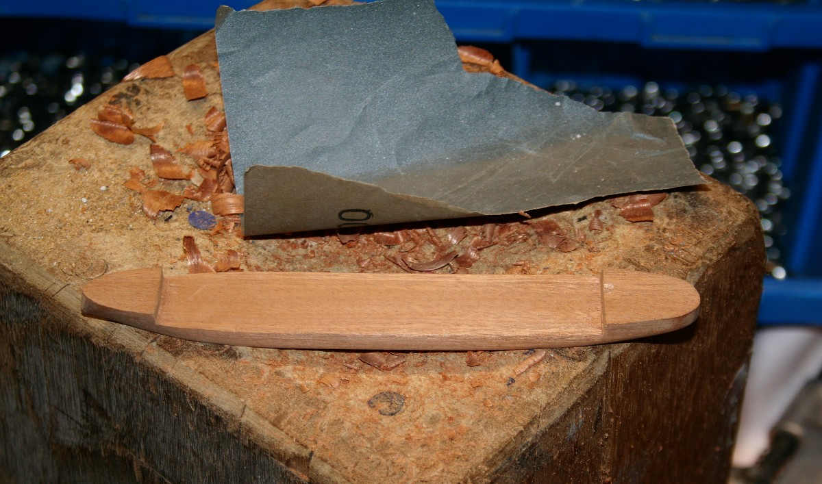

Thereafter the deck "planking" made of Evergreen N-sale car siding--was added and glued on with slow-set CA
This will be cut back and sanded flush with the hull.
