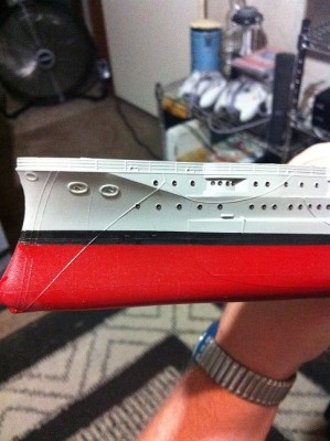

Hey guys,
I've been out of modeling since my real early teens. Fast forward 20 years and here I am. This is my first attempt. This probably wasn't the best kit to start on because in my building i've noticed that the details are fairly bad and even on som eof the sprues the molds don't appear to have been set straight and there are offsets in the pieces. But here is a little progress shot of what i've done so far. I wanted to built this kit as it came in box without any expensive addons like brass barrels, PE, etc.
I'm chosing to do a simple light grey color scheme on this. Not really wanting to get drawn into a debate on whether it was appropriate for when she was sunk at Pearl Harbor or not. This is how I wanted it to look as I like the lighter grey better than the darker pacific scheme.
A few things. In addition to the model (my individual kit) being pretty horribly molded i think this is a really old revision. The model has a stamp on it that says 1959. the details aren't real great, but there seems to be a complete ship's worth of parts so I can deal with it. I've also noted that I really need to work on my use of paint when hand brushing. I've run into instances where the paint seems to get sticky while i brush it on and not really coating well, going on more gloopy. think I just need to thin them out. (I'm using the standard Model Master enamels). And I think I need to mostly ditch hand brushing and get setup with an airbrush kit for flatter coverage.
Anyways. Here's a pic of some of the progress so far. I got a little sloppy on the masking job near the front rigging. I apologize for the iphone pic quality. It's all i've got. I do plan on painting the rigging/details and do some weathering eventually.
pic of the hull.
pic of the hull.
So here it is. Progress has been pretty slow the last few weeks due to a shipping delay on some paints that I wasn't able to source locally.
I welcome any advice or tips you guys have to offer.

Hi Hallis.
I'm working the same kit as well. Here are some of my observations.
Hallis wrote: in my building i've noticed that the details are fairly bad and even on som eof the sprues the molds don't appear to have been set straight and there are offsets in the pieces.
Yep. I got two "partial" kits off ye olde evil bay and both of them had this problem. And when you get to building the masts with their platforms and fighting tops, and you go to level things out, file down the high sides on all the support bracing. The first time I tried to use the parts as is without really correcting the error and it caused fit problems with the platform pieces and the tow support legs of the tripod. I took the same parts from the other kit and filed down the high side of the support braces and things fit much better.
And you will probably have to either drill out the mounting holes in the gun deck for the main mast's support legs or trim down the mounting pegs on the legs themselves because of the misshapen molding.
Hallis wrote: I've also noted that I really need to work on my use of paint when hand brushing. I've run into instances where the paint seems to get sticky while i brush it on and not really coating well, going on more gloopy. think I just need to thin them out. (I'm using the standard Model Master enamels). And I think I need to mostly ditch hand brushing and get setup with an airbrush kit for flatter coverage.
Did you wash the kit parts in warm soapy water to remove the mold release agent before you began the build? I use dishwashing soap and old nylon gun cleaning brush. I've found over the years that this step helps tremendously with Model Master paints.

Well the bow is looking good. Hope to see more.

Hi Shane,
Since this is your first build in two decades, it is wise of you to keep it simple. I think it looks good, but I think everybody will agree that an airbrush saves you a lot of time. If you don't want to invest in an airbrush, you could try a spray can. Good luck!

I used a rattlecan for the grey on the hull there. Notice how it looks pretty good? ;) But man Testor's Model Master spray paint is ~$6/can. So for a can of a color i'd use a lot of like this grey it is ok. but for something i'd not use as much of i've got bottles. I'll be investing in an airbrush eventually. Just need to save my pennies. Starting next week i'm going to be working from home :woo_hoo: so that will be some money i'll be saving in commute expenses.

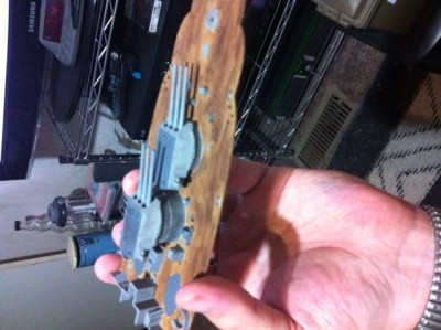

A questionable attempt at adding some weathering and some darkness to the deck.
I'm not entirely happy with it. Think I like the clean look better. Enjoy this free laugh, on me.

A small blast of primer and I can live with myself once again, lol.
Learning experience, folks. I'm having them. :cool_1: :thumbs_up_1:
