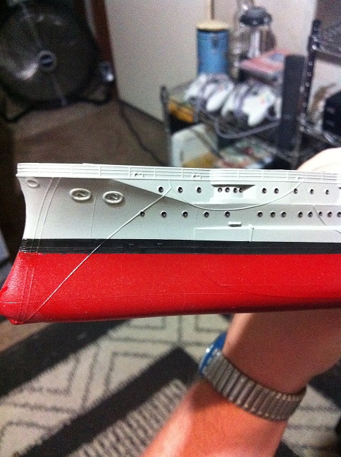

Hey guys,
I've been out of modeling since my real early teens. Fast forward 20 years and here I am. This is my first attempt. This probably wasn't the best kit to start on because in my building i've noticed that the details are fairly bad and even on som eof the sprues the molds don't appear to have been set straight and there are offsets in the pieces. But here is a little progress shot of what i've done so far. I wanted to built this kit as it came in box without any expensive addons like brass barrels, PE, etc.
I'm chosing to do a simple light grey color scheme on this. Not really wanting to get drawn into a debate on whether it was appropriate for when she was sunk at Pearl Harbor or not. This is how I wanted it to look as I like the lighter grey better than the darker pacific scheme.
A few things. In addition to the model (my individual kit) being pretty horribly molded i think this is a really old revision. The model has a stamp on it that says 1959. the details aren't real great, but there seems to be a complete ship's worth of parts so I can deal with it. I've also noted that I really need to work on my use of paint when hand brushing. I've run into instances where the paint seems to get sticky while i brush it on and not really coating well, going on more gloopy. think I just need to thin them out. (I'm using the standard Model Master enamels). And I think I need to mostly ditch hand brushing and get setup with an airbrush kit for flatter coverage.
Anyways. Here's a pic of some of the progress so far. I got a little sloppy on the masking job near the front rigging. I apologize for the iphone pic quality. It's all i've got. I do plan on painting the rigging/details and do some weathering eventually.
So here it is. Progress has been pretty slow the last few weeks due to a shipping delay on some paints that I wasn't able to source locally.
I welcome any advice or tips you guys have to offer.

Hi Hallis.
I'm working the same kit as well. Here are some of my observations.
Yep. I got two "partial" kits off ye olde evil bay and both of them had this problem. And when you get to building the masts with their platforms and fighting tops, and you go to level things out, file down the high sides on all the support bracing. The first time I tried to use the parts as is without really correcting the error and it caused fit problems with the platform pieces and the tow support legs of the tripod. I took the same parts from the other kit and filed down the high side of the support braces and things fit much better.
And you will probably have to either drill out the mounting holes in the gun deck for the main mast's support legs or trim down the mounting pegs on the legs themselves because of the misshapen molding.
Hope this helps and have fun with the build

Well the bow is looking good. Hope to see more.

Hi Shane,
Since this is your first build in two decades, it is wise of you to keep it simple. I think it looks good, but I think everybody will agree that an airbrush saves you a lot of time. If you don't want to invest in an airbrush, you could try a spray can. Good luck!
Jeroen

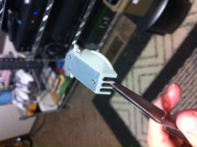

Did a little work today. I sprayed some matt clearcoat on the decks and decided to paint the turrets while I had a mind to. Not looking too bad. Still trying to decide if i'm going to attempt to put some bags on the main guns or not. I'd have to make them out of putty if i did. But I do have a block of Milliput sitting here that I just received. However i'm not sure I have the requisite skills to pull it off with any uniformity. lol.
Here a pic of one of the turrets. Just put the base coats down. It'll be far less glossy once I coat it with clear. I decided to use Model Master "Gunship Grey" FS36118 for the top. I've had that bottle on hand for a very long time and it seemed like a good dark grey to use.

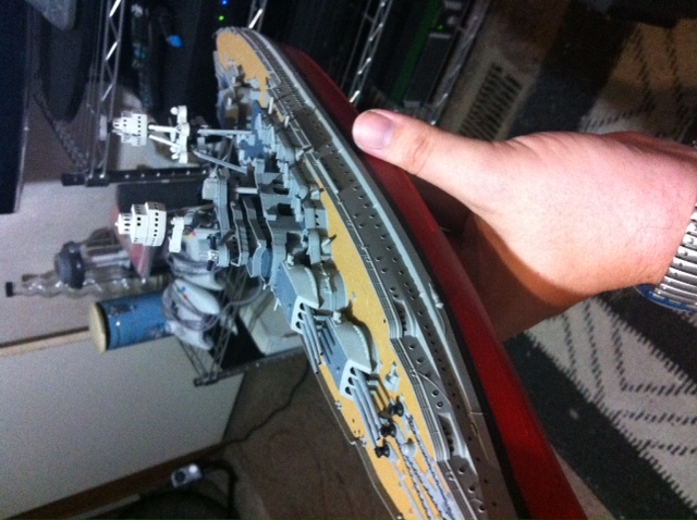

Put some preliminary lacquer coats on a few of the pieces that i'm largely done with. Here's a little dry fitting, She's starting to look the business. Still trying to figure out how i'm going to do bags. And also trying to figure out if i want to attempt some weathering or not.
(note: the 5" guns are done but aren't in this pic.)
Pic
Pic

Looks good Shane. Very clean.

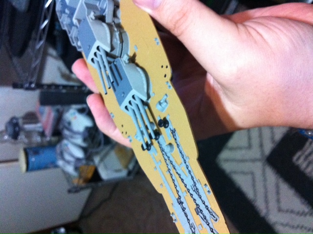

Great work so far!
Mark B.
That's one of the things I am looking into on my build. I was able to do the anchor chains and those two things that the cables attach to on the sides of the hull with a fine Sharpe marker but it's not fine enough to do the cables themselves. That liquid masking idea does sound very doable though. Thanks.Hallis wrote:I've not done a whole lot of work the last few days. Trying to figure out how i'm going to do some finer details. But not really coming up with any good ideas. Those ropes that are molded into the side of the hull for example. I'm finding that I can't get a really good mask on them for painting. might have to use some kind of liquid masking.
Mark B.

A black sharpie is exactly what I used on the anchor chains and the portholesBrocky wrote:Great work so far!
Mark B.
Update: I did paint and put the superstructure decks together yesterday. Looks ok. I didn't take a picture because I felt those sections by themselves were rather unimpressive. I'll be doing a little work on the masts and the accompanying sections tonight. I'll probably post up some pics of those once i've got them assembled.

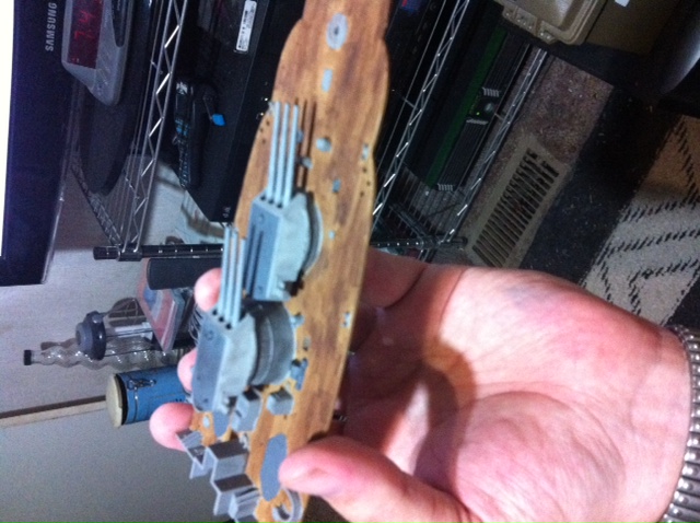

A questionable attempt at adding some weathering and some darkness to the deck.
I'm not entirely happy with it. Think I like the clean look better. Enjoy this free laugh, on me.

A lot of bits had been complete in sub assemblies. Finally started slapping them all together. She's finally starting to look the business. Still have the boats, catapults, cranes, boarding ladders, and a few other thingies to finish up and stick on but she's finally starting to look like a warship. Will probably be mostly done tomorrow evening.
Here's a crappy iPhone pic.
