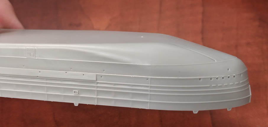

Now a bit on the hull. As you might notice, there is distortion and oil canning molded into the hull as well as some ribbing and bumpers. While LSTs did have this, it is a touch over done for my tastes. The oil canning is very well done where present, however it stops short of the stern and bow and it just looks a bit off to me. There should be less of it in these areas, but there should still be some. The box was neither too tight or loose with parts, however the bow had some visible stress discoloration and the bow is spread wide. The stern has a bit of a gusset plate so I focused on gluing that first and ignored the bow joint for now. The below photo shows the stressed plastic and how far the bow joint is spread with the main deck more or less in place:

Details look nice. Agreed the oil canning looks a bit overdone from your photo.

I think the oil canning would be A-OK if it weren't for the raised detail. I have one on pre-order from FreeTime and am contemplating sanding the external ribs off on that one to see how just the oil caning alone looks.

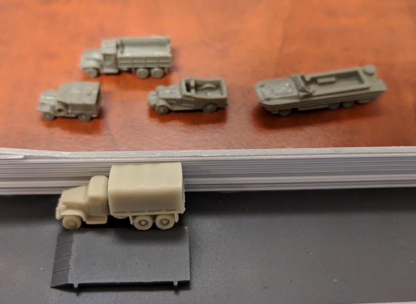

A quick update. I pulled out some old L'Arsenal GMC trucks I had (my set was all covered) as the AFV set, while nice, is essentially two each of a wide variety, which was not the usual LST load out. They are too wide, however, to fit around the elevator (aft tires are resting on top in the picture below):
The AFV club trucks are thinner and do fit, but Not with a clearance that I feel many drivers would feel comfortable with. I honestly don't know if this is L'Arsenal's fault or if the vehicles drove around or over the elevator and their dimensions are bang on. The plans show portable ramps at either end whereas the kit only has one, more permanent looking ramp. It looks like the deck to either side of the elevator platform might be too narrow for the larger trucks even in real life, but I don't have any good photos of a tank deck loaded up to know how this generally looked or how they unloaded.
Being familiar with the Washington State Ferries and how they load and unload, I had planned on having one truck on either side of the elevator platform driving around it, but now I'm leaning towards having a "wall" of trucks aft of the elevator to represent the unloaded vehicles waiting with a line of 2-3 between, one at the door and maybe one driving down off the elevator platform like below:
Not that much will be visible with the deck on - it at least appears it will fit without causing issues:
