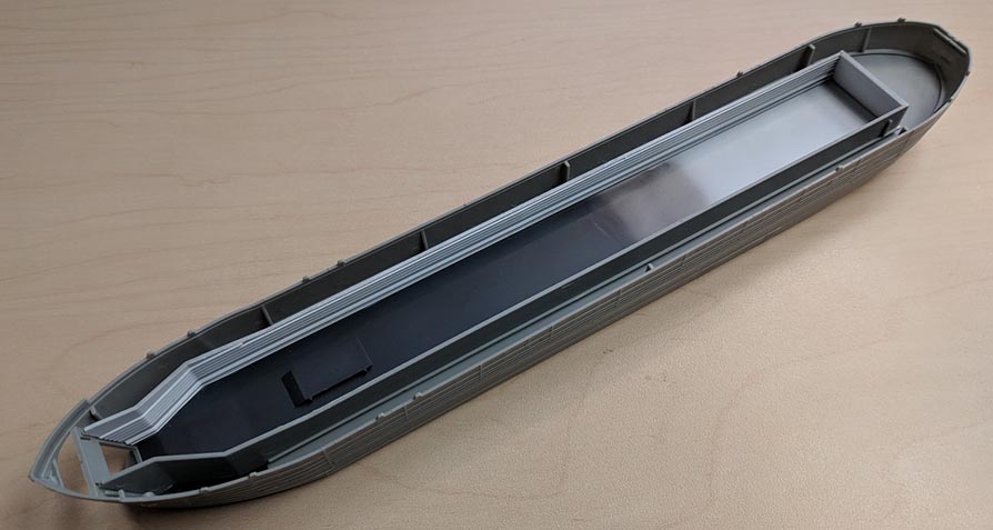

File comment: Deck and starboard bulkhead glued and primed.
Fit has been really good so far as long as you take the time to make sure you have cleaned up the mating surfaces - sanding down the nubs from the tree left a wee bit of a raised edge on the corners, which could affect fit if not subsequently stripped off. Below is the stern showing the lower hull (easy waterline!) held up to the port and starboard hull halves:

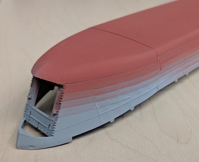

I did not get any painting done last night and might not this weekk - however I did get the lower hull about 75% glued on. It's attached up to the point of the "bend" that there was in each hull half:
I wanted to wait until the joints I had glued were fully dry before I start pushing the bow into shape. The plastic's thin enough I don't anticipate much problem, and I should be able to hold the upper forward deck in place to have upper and lower guides while the glue sets.

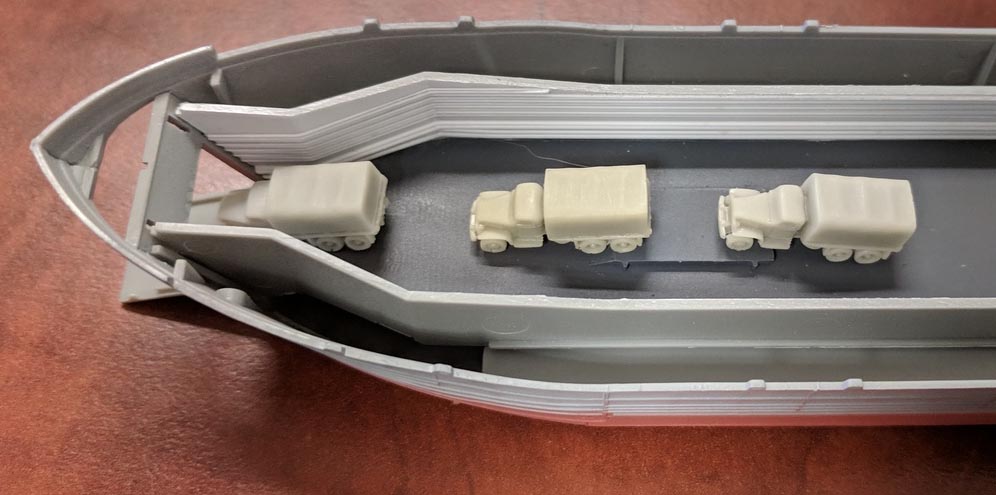

A quick update. I pulled out some old L'Arsenal GMC trucks I had (my set was all covered) as the AFV set, while nice, is essentially two each of a wide variety, which was not the usual LST load out. They are too wide, however, to fit around the elevator (aft tires are resting on top in the picture below):
The AFV club trucks are thinner and do fit, but Not with a clearance that I feel many drivers would feel comfortable with. I honestly don't know if this is L'Arsenal's fault or if the vehicles drove around or over the elevator and their dimensions are bang on. The plans show portable ramps at either end whereas the kit only has one, more permanent looking ramp. It looks like the deck to either side of the elevator platform might be too narrow for the larger trucks even in real life, but I don't have any good photos of a tank deck loaded up to know how this generally looked or how they unloaded.
