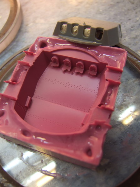

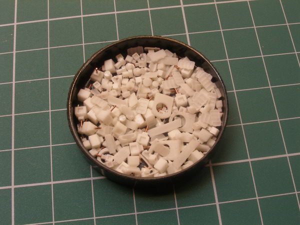

After summer break I return to construction of its models.
After ascent of models happen to make anew all small details:

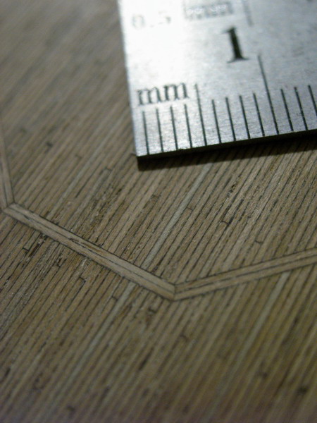

Re: 1/350 HMS Prince of Wales
g8t attention to detail

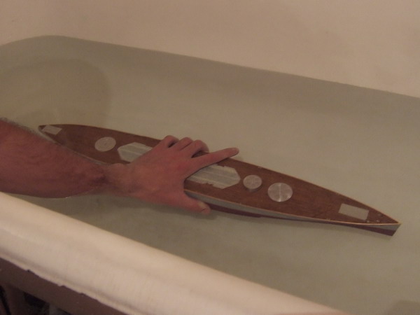

but your wooden deck caught my attention
can you please provide details on it, thanks

Maybe you can repost some of your deck mAking pictures, and maybe sme of of the sinking and recovery...?

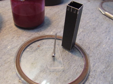

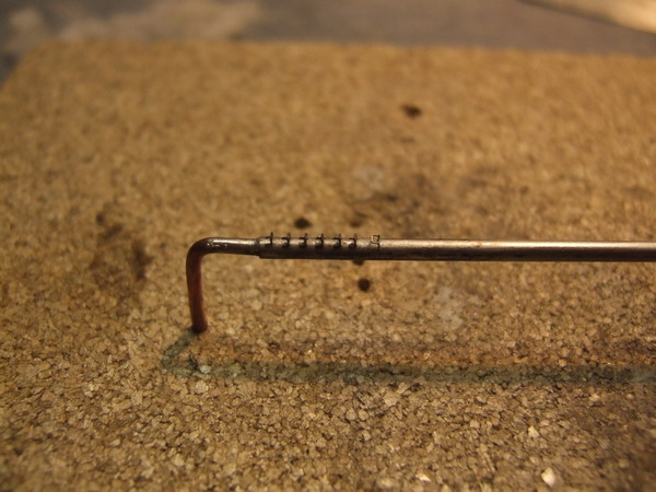

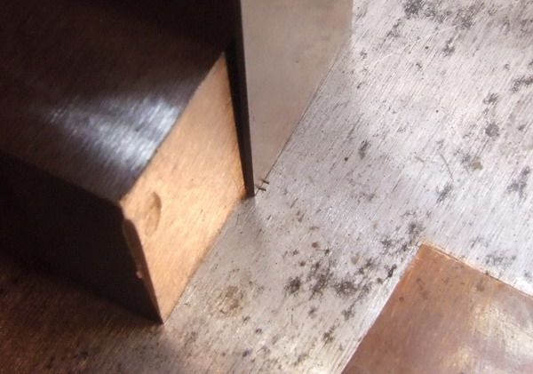

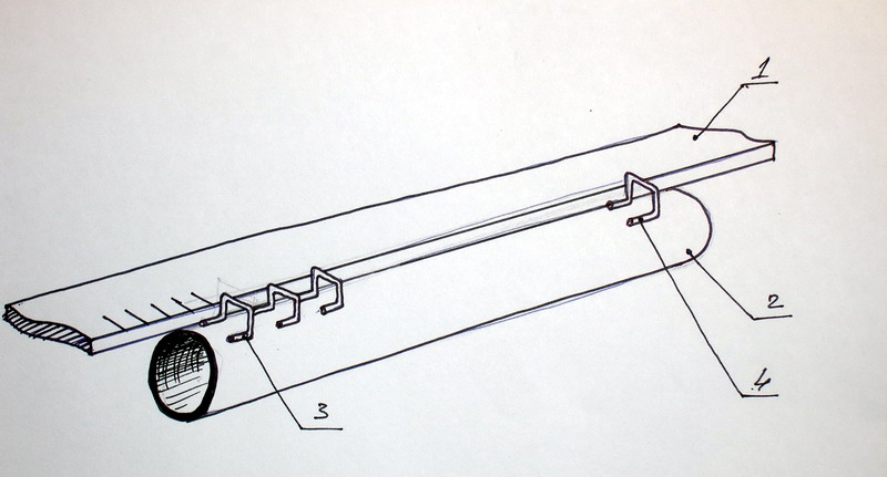

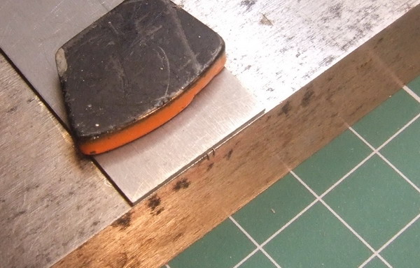

cut
soldering by gas (the right step cost (stand)s on acid
possible there was and so solder!)
Max

EXCELLENT Methodology!!!!
Love the forming of the steps in the Rubber-_ I have been using a soft pad of paper for a similar effect and similar purpose
but it does not do as good a job as your method-
I am off to look for some rubber....
JIM B
JIM B
Can you tell a little more on the soldering? I've been trying without much succes!
Foeth
Foeth

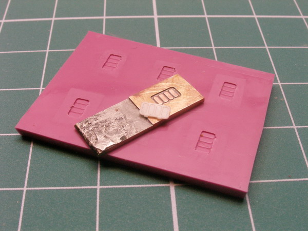

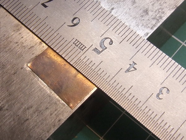

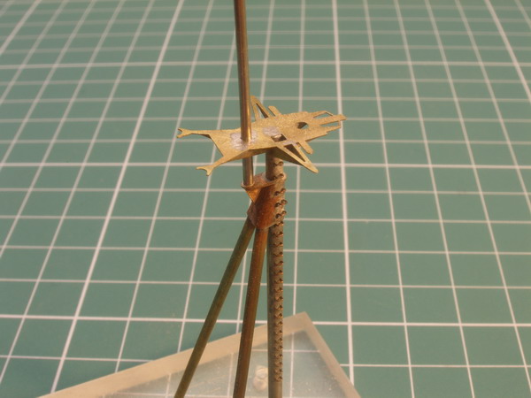

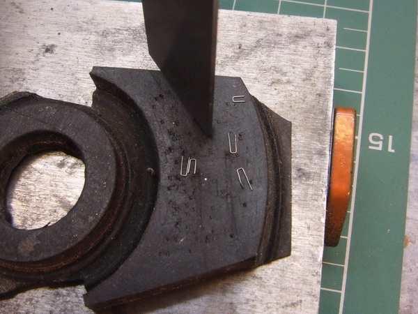

I am bad storyteller in english - so I has drawn.
Soldering:
1. Cover fine layer tin(?????) a whole tube. there where will be steps.
2. To drip the acids under extreme steps (the detail 3 and 4) install the steps. Neatly, (from afar) warm the tube by gas burner.
3. Salve acid a tube between stairs (3) and (4)
4. Place firmly straightedge (1) in steps (3) and (4)
E further I think all understandable.
Soldering:
Max
- Maximus
- Posts: 59
- Joined: Fri Aug 18, 2006 3:40 am
@ Maximus: I think I more or less understand, even though I do not understand how to apply the tin and what acid to use. Actually, I don't think I understand too much about the process so far ...
How do you apply a fine layer of tin? This is by heating solder or? I think I need a basic course in metal working!
Foeth
Foeth
but me with plastic!Guest wrote:I think I need a basic course in metal working!
Foeth
forgive me my english
1. tin(?????)=solder (http://en.wikipedia.org/wiki/Solder)
2. acid = ZnCl
Max

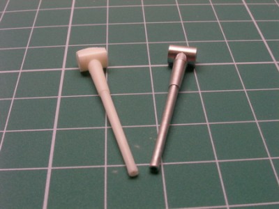

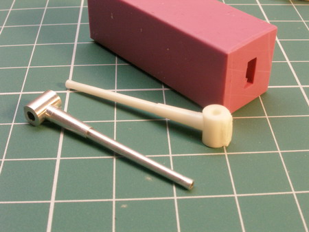

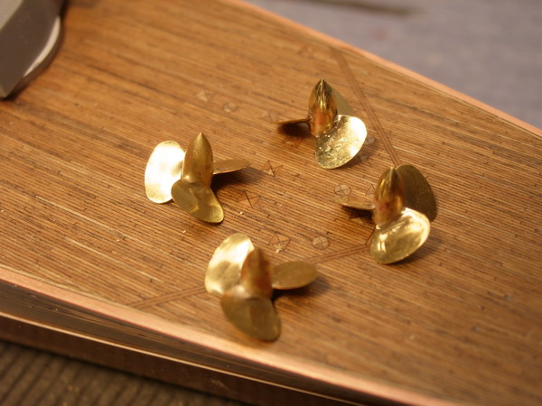

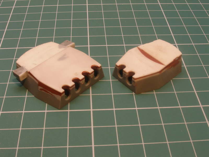

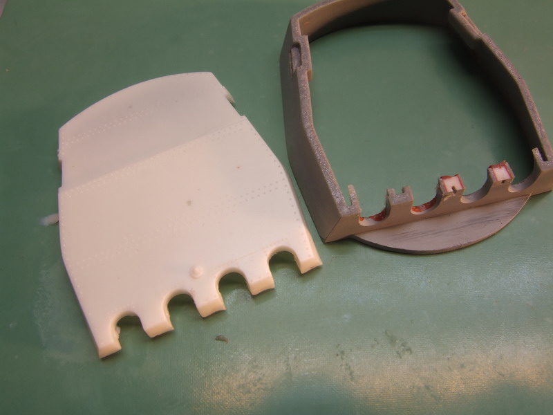

experimental "rabbits"
fabrication upper armor captive
original destruction
Max
- Maximus
- Posts: 59

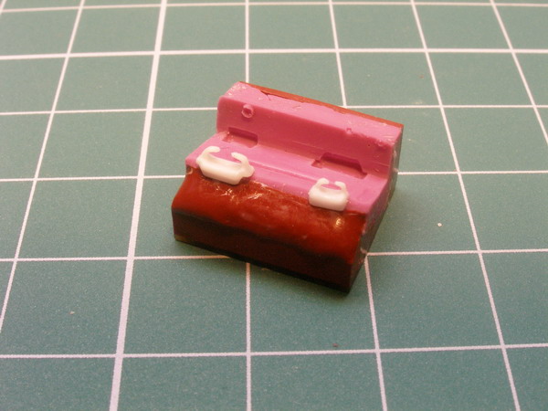

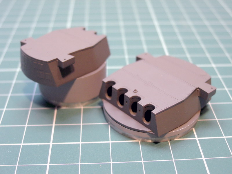

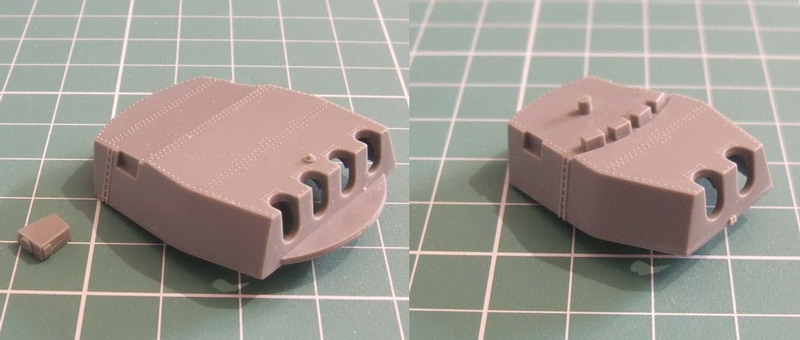

is it nearly ready
it is ready!
This not yet end. This only master-models
Max
