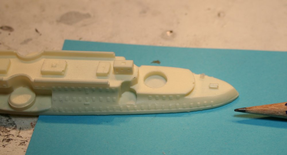

The stern is too wide in plan view, far too pointy and the superstructure aft is far too wide
Brutal stuff
The bottom of the open hull had a plate added to remove the hogging warp, the hatches were all removed, the cast on central turret barbettes were ripped off and the platform raised, hull reshaped to accentuate the tumblehome.Aft indents reshaped and the hollows above the aftermost turrets bridged and the deck made up.
Holes in deck filled and all deck structures removed or reshaped. Once faired it looked like this...
The cast on hatches now were all gone--and I wanted to depict most of the hatches open--as the ship both static and underway at speed is often depicted with them open...
The difficulty of cutting this vast number of square holes was quite simply beyond my methodology on a retro-fit kit-build...
So I cheated!
Black squares of decals strip were applied to represent the hole or void, once this has been complemented with the yop and bottom lids it should look fairly convincing....
...==> getting them all straight and in the correct place was done by steadying lies of adhesive tape and ...
mainly eyeball and judgement
Relative proportion is everything!
Once the armour belt( vinyl tape) had been added ( soaked on afterwards with CA)
the ship stared to vaguely(!) resemble the photos of the real thing...

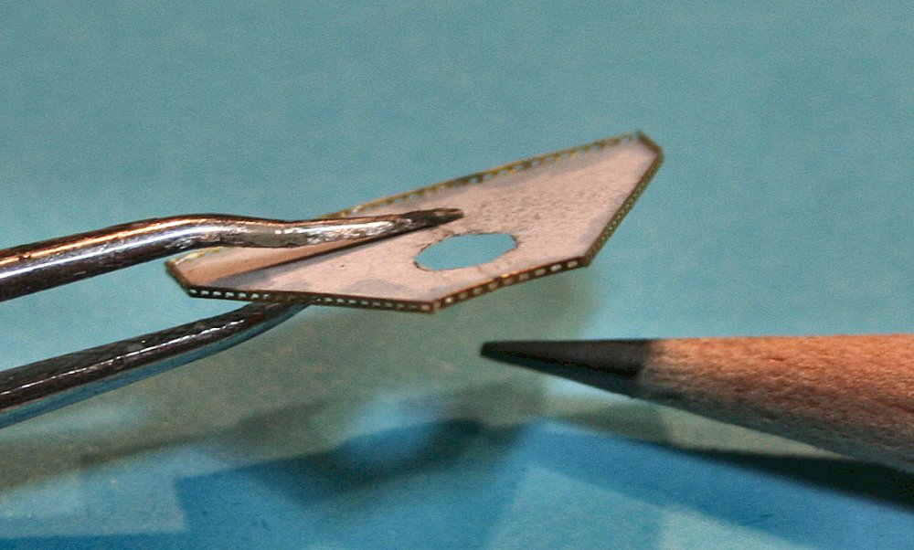

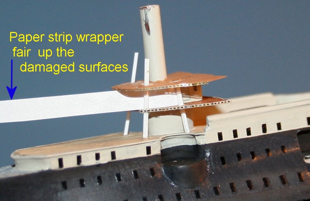

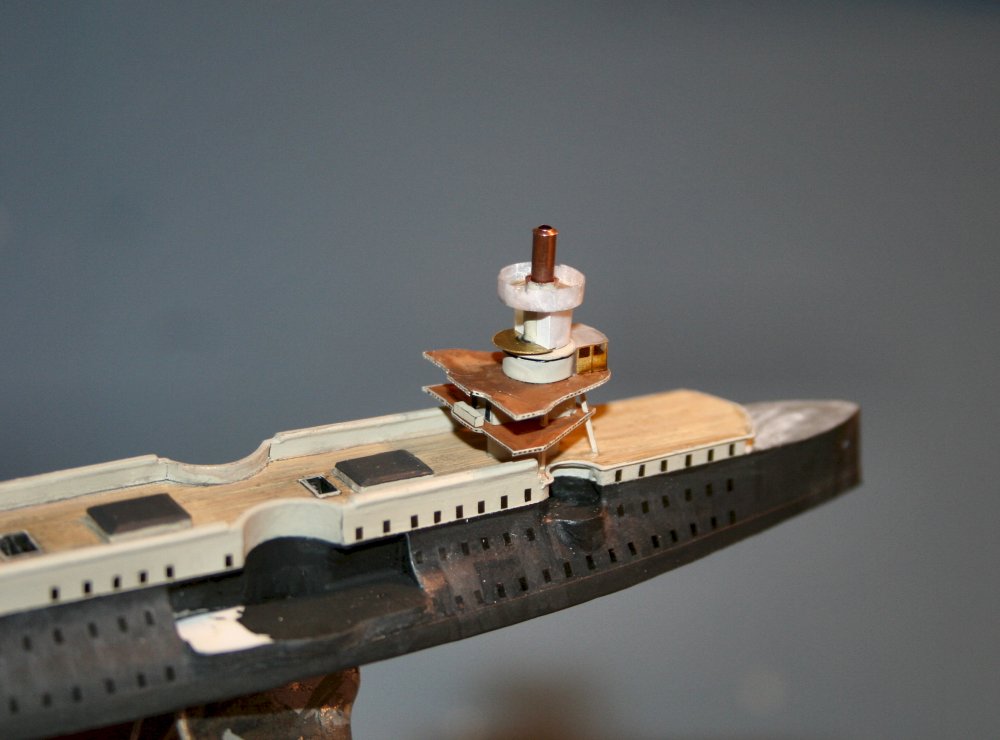

Prior to mounting the ship on her base I started on the fwd bridge structure. From spar deck up all will now be scratchbuilt.

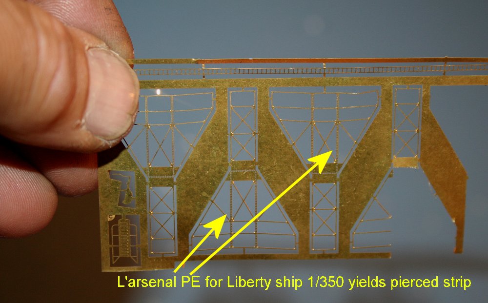

The fwd bridge levels have the distinctive pierced sides - these are made of thin PE strips- cut from a much larger PE structure gleaned from a L'Arsenal 1/350 PE set....( liberty ship )
Its a very fiddly pastime as each brass section is seperate...
The deck itself is made of paper - cut folded in half to give perfect symmetry, then pressed flat and infused with CA.
This gives a 'scale' thin deck....

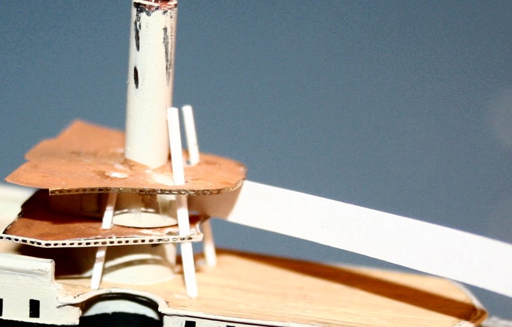

Carnot had a massive blockhouse really quite a long way up the fwd structure; this required additional bracing through the deck levels to support.
These supporting columns appear from photos to square in section. The positioning of these was tricky- to obtain alignment the decks needed to be affixed firmly-==> however the mainmast - made of copper tube was already well embedded and installed. To obtain the correct positions was a process of trial and error- which meant the decks took a hammering...-These were made good by filling with white glue--with the second coat it self-levelled
I have cut in main deck stairways-positions of which are based on those of other similar contemporary French pre-dreads; inevitably as soon as my model is finished numerous photos of the deck will suddenly surface and prove me wrong!!!
The fwd bridge is making steady progress, the lower and upper circular platforms were of paper, infused with CA glue wrapped around a floor of thin PE brass scrap. The lower platform had the gun notches cut into the paper whilst a flat layout.

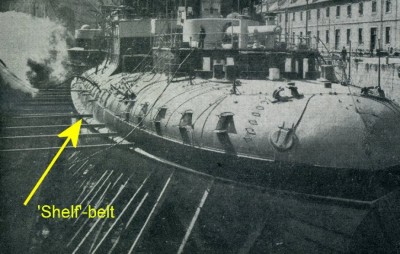

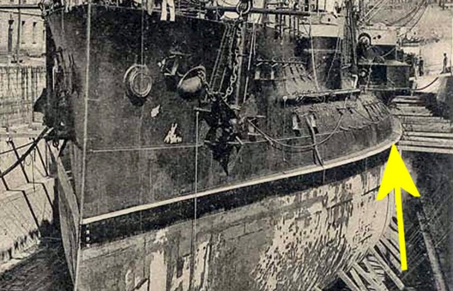

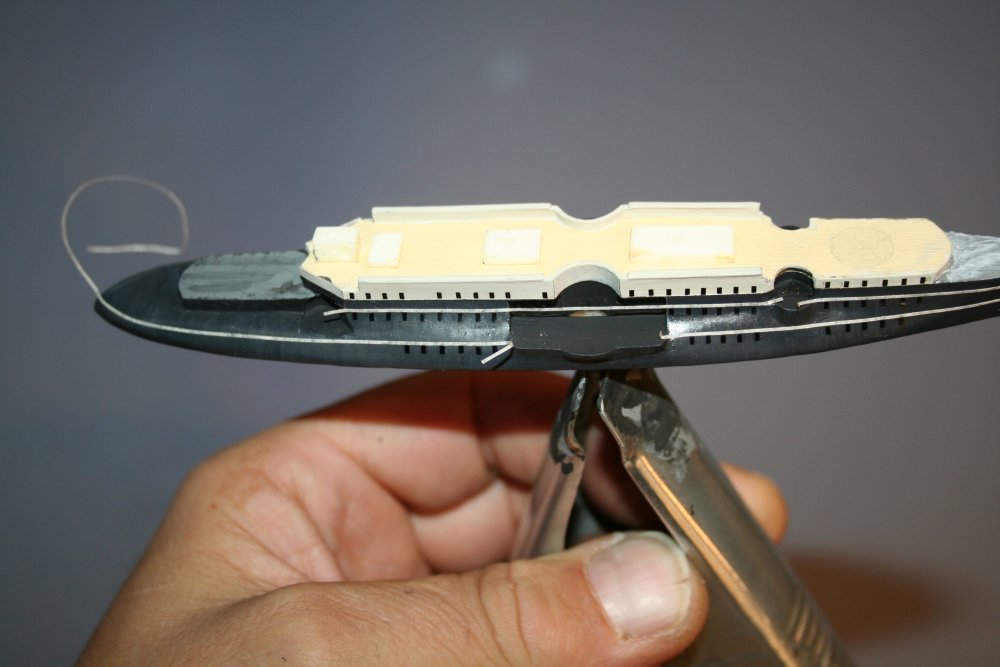

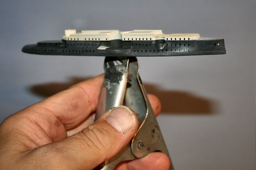

The ship-model was becoming increasingly hard to work on--the screw/clamp handle on the base did not lend itself to being laid down.
Prior to mounting-I had to add the armoured 'shelf belt'
( there are photos of crew members walking along this ledge..!)

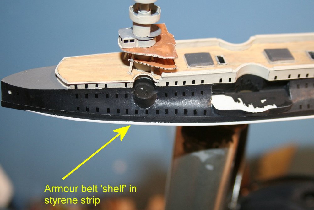

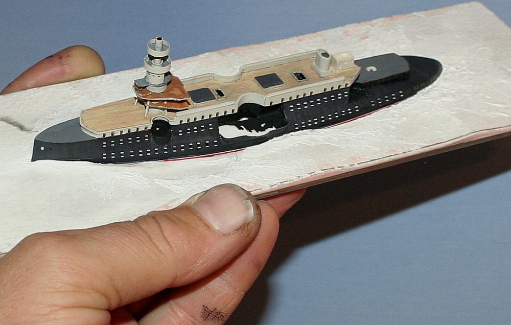

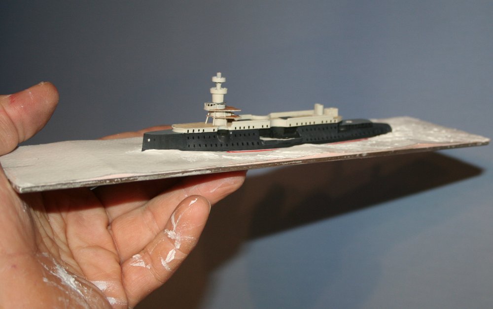

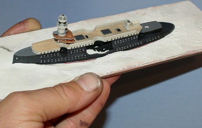

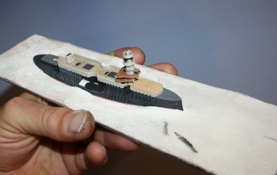

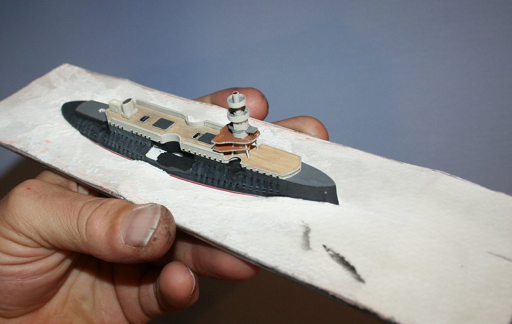

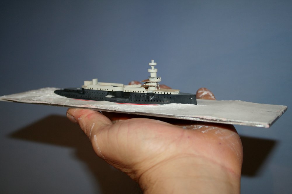

Thereafter I used the white styrene strip as the white water-line by virtue of adding a red boot-top
The model was screwed and glued into a pre-cut aperture in some artists watercolor paper
similar to the method I employ here:
viewtopic.php?f=4&t=37223
viewtopic.php?f=4&t=37406

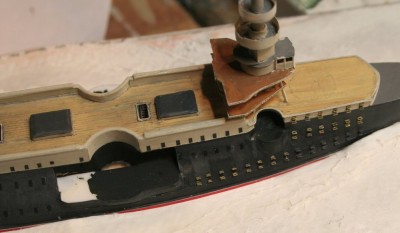

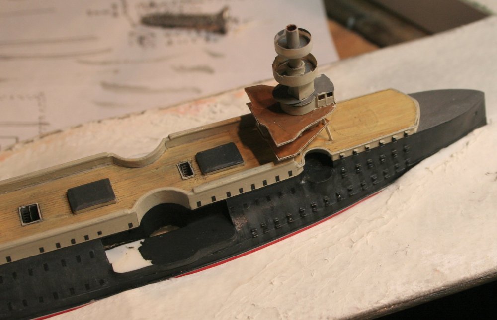

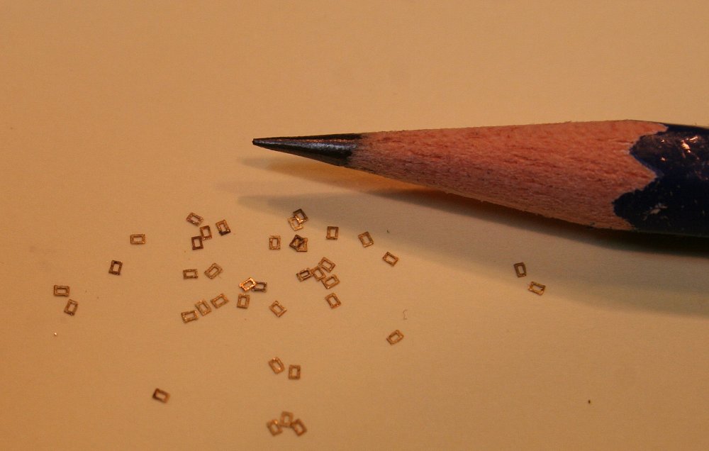

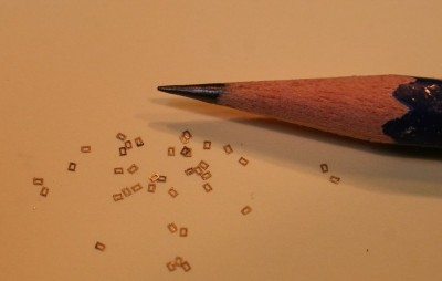

Carnot was to be shown with the hatches open- I had previously done this on my Massena build-
http://www.modelwarships.com/reviews/sh ... eview.html where I used paper to make the hatches.... however for a variety of reasons I wanted to try something different...
Madness prevailed-- and I decided to make the hatch lids--top and bottom of brass--more accurately-- I decided to cut pieces of 1/700 ladderstock into little squares-to get clean edges is harder than it sounds...!!
I used scissors to cut the squares, trimmed back whilst holding in tweezers- and then flattened each one in smooth face pliers to remove the curling caused by the cutting..... :Mad_5:
The resulting voids ( the centre square of the ladderstock) was filled with thinned whiteglue.
Once set and painted they have quite a pleasing bit of texture-

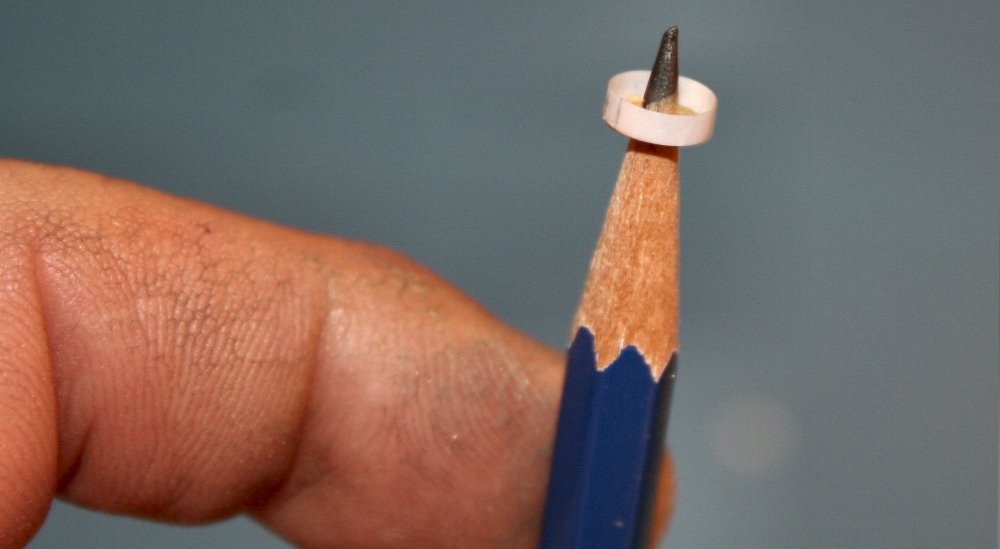

Just a question on making circular shields - how do you make them so that you don't have/need overlapping ends in order to provide a more secure integrity? What I mean is, I've been trying to make such things on my San Diego, but the strips (paper and styrene) will flex back apart if I don't overlap the ends when curving them into a circle.

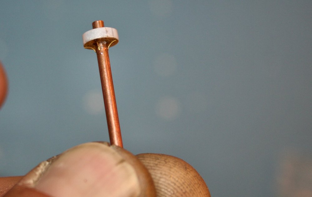

...when using paper to make splintershields etc--the trick is to pre-curl the paper using a rod of a much smaller diameter than the desired 'circle'.
This 'curling' needs to be done on a pad pf paper--such as post-it notes- until you get 'overcurl'...
Check the size and cut the strip of paper butt-to-butt--and offer up to your circle-If it is to large--easy-trim it off--if suddenly it is too small..(arghhh!) open it out flat and using you existing strip as a template cut it slightly longer on a new strip... ( it can be frustrating at times!)
-if it is right then I tack the two butt ends together using a droplet of thinned white glue==> quick tack.
Thereafter I tack the circle--which may not be perfectly circular--it is a soft medium paper-- in place at the join with a tiny droplet of thinned white glue.
When the tack has set- I work the edges along and over the 'floor'--be it plastic, card or brass.
Once this is satisfactory--I apply -carefully-so as not to dislodge it- thin CA0--which soaks into the paper and makes a continuous bead around the 'floor'-rendering it fine as well a strong.
The same technique can be used with brass strip ( PE fret surround) to make gun tubs and platform splintershields etc--the main advantage in this instance was that paper is easy to cut the gun-arc notches into symmetrically.

At long LAST-- :Mad_6: it seemed to take FOREVER!!!-- but all the hatches are now complete and installed.!!
On the starboard side they were all brass-as made in previous posting
- on the Port side I reverted to Paper.
On balance - the paper is MUCH quicker--easier to control- and easier to glue on using m,att varnish.
Being white against a black hull the paper hatches ARE also much easier to see for control of alignment vertically and horizontally...! :thumbs_up_1:
I did use the remaining brass hatches for the upper row on the grey portion- simply because if the vessel is viewed from dead above--any discrepancy-- no matter how minor... would be IMMEDIATELY visible!
More progress soon!
Jim B :wave_1:
