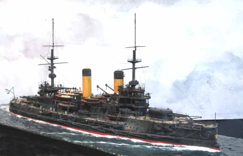

here is a presentable and handsome model of Borodino built recently by my chum Nick Johnson.
He made his own Porthole surrounds and eyebrows of brass wire--the PE items being decorative--but too clunky

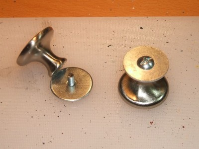

MOUNTING
So let me start with some of the boring background stuff on the project for starters...
In the old days, I just use the plastic stands that came with the kits. After drooling over a lot of fancy wood kits mounted on brass bells and such, I decided that from now on all my model ships would be mounted on pedestals. Being the cheapskate that I am, I don't want to spend a fortune on nautical warship model brass bells, so I am just going to use standard drawer pulls that I got at my local hardware store (I went with a Nickel finish because I like that better than brass.) You only need to make a few very simple modifications to make this work...
First, use a dremel (or a hacksaw) to cut off a bunch of the machine screw that comes with the drawer pull. After all, you're not going to be mounting through a 1/2 inch piece of wood - so make sure you leave enough to screw into the pull, but not so much that it can't totally disappear inside the pull when the pull is right up against the hull.
Second, get a box of large "fender washers" from the hardware store when you pick up the drawer pulls - they're really cheap, and the provide a larger mounting area than just the screw head.
Third, superglue the screw head to the washer.
File comment: A trip to the hardware store should provide some suitable drawer pulls that can work quite well as pedestals. While there, pick up some large washers with small holes, too.

Fifth, insert the screw heads through the pre-drilled holes in the hull, and press down firmly. The kneadatite will lock the fender washers and bolts to the hull, conforming to the interior hull shape as you go.
Sixth, screw on the drawer pulls to test fit, make any adjustments before the kneadatite turns to concrete, and you are good to go!

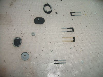

METAL GUN BARRELS
This is my first experience working with metal gun barrels, and… I LIKE ‘EM! I can’t see going back now…
Installation was straight forward… Cut off the old barrel, then drill a 1/64 hole to hold the pin on the replacement barrel. The biggest concern here was drilling the hole straight, and to make sure that the bit didn’t drift when starting the hole.
Even as a first timer I had great success. No problems at all, really, and a few misaligned holes could be easily corrected either by filling with CA and re-drilling, or simply by bending the barrel a little bit after assembly.
File comment: This shows my first barrel pair installation compared to the plastic kit part.
One trick I discovered for the Borodino kit… I reinforced the outside of the barrel swivel plate with a plastic rod. The assembly of the plate to the turret floor is not very strong; by putting in the reinforcing rod and applying a liberal amount of CA glue I am now confident that those suckers aren’t going anywhere – and I have extremely strongly mounted main battery guns that I can elevate to suit my fancy.
File comment: Placing small plastic rods inside the turret really helps to reinforce the swivel plate that the barrel mounts to.
The secondary battery guns just mount to the roof of the turret, but once again the metal barrels are so much better than the plastic blobs…
File comment: The secondary battery, while a lot smaller, follows the same basic process.

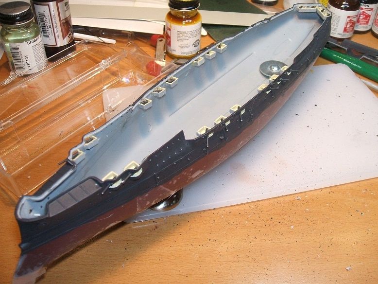

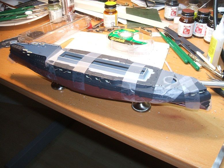

FIRST PLASTIC DECK TO HULL ASSEMBLY
This is actually a LOT easier now knowing that I have a wood deck coming in the next step. All that you need to do is just mount the deck to the hull, and fill in any gaps. I plan on adding etched brass railings, so I know that where this joins with the deck I can cover up a lot of errors, too.
File comment: Here is the hull mounted on the stands, with the casemate guns all in place. I am now ready to add the aft deck.
File comment: I used regular Testors plastic cement, then taped the deck down to get a snug fit at all the edges. Once dry, I filled in the small gaps with CA glue.

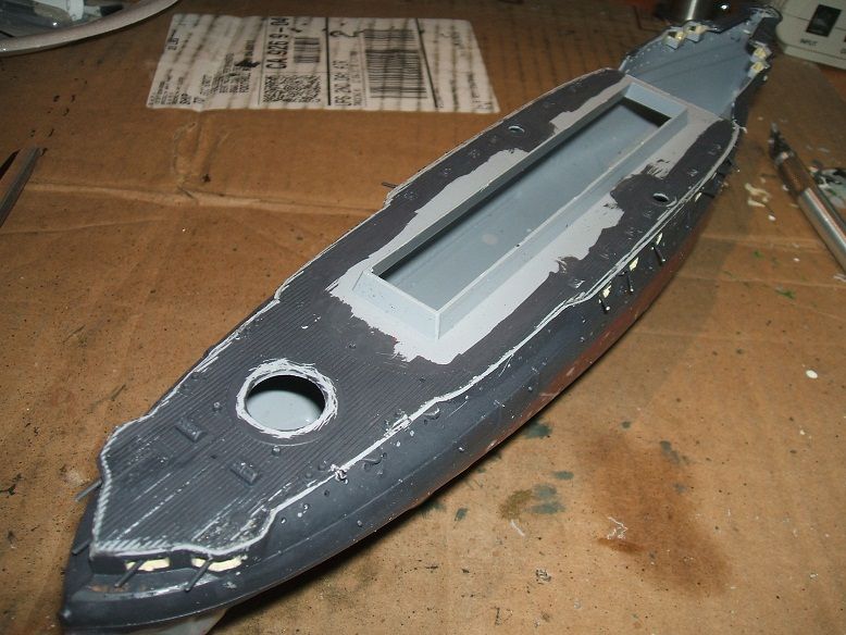

Knowing that I am going to be covering this with wood, I don’t have to worry at all about preserving the etched planking pattern in the plastic. I can fill and scrape away to my heart’s desire. As long as I have a good edge, I am golden.
File comment: Here you can see the rough trimming that I did at the edges; I have no concerns about preserving the deck detail.

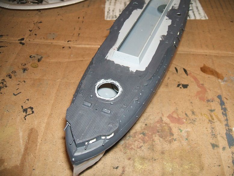

Painting is a snap, too. All that I need to do is to paint the entire deck the color of the metal fittings that will poke through. (I think that painting the deck a uniform color will be very important, as our decks are so thin that they are relatively translucent. I fear that if the deck has an uneven paint application that high-contrast differences might show through the wood. So just to be safe, I painted the whole thing and the edges the hull color of Floquil Weathered Black (which actually looks quite a bit darker in natural light than it appears in these flash pictures.)
File comment: A quick first coat of paint, and I can start to check the fit.

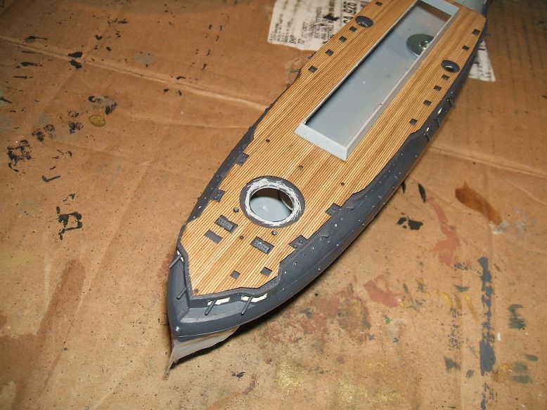

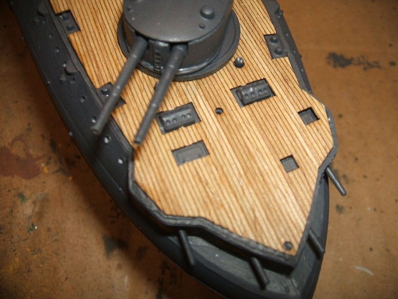

THE PAYOFF!
So here is the big moment that I have been waiting for… How will this new wood deck look when placed on the hull?
First, a few disclaimers. This particular deck was a test cut pattern, it is not our production deck. I’ll be swapping that in shortly. Also, these photos show nothing glued down – I am just trying to get a feel for the colors to see how the deck will look against the color of the hull and to see how fittings and turrets and such will look when poking through the wood.
This deck is made from genuine teak – the same wood used on most warships. It has a nice, rich tone – but it is just a bit darker than most hobbyists seem to paint their decks. Nonetheless, this is real teak, so it should be an accurate color to some degree. (I am also planning to offer all of our decks in the lighter wood maple as well to allow hobbyists to go with the lighter color that they may be used to.)
The deck itself is only 1/100 of an inch thick, and can be glued right to the top of the existing plastic deck. There are openings provided for all of the fittings to be mounted. The wood is backed with thermal fleece to provide some working strength and flexibility. I plan to glue the wood to the plastic using Testor’s liquid cement, which has worked really well in our tests. Fittings glued to the top of the wood will be locked down with CA glue just to be sure they stick forever.
As for the planking, that has proved to be problematic. To represent four inch planks in 1/350 scale, they would be barely larger than 1/100 of an inch apart. A typical laser printer can print at 300dpi resolution – about the maximum that the human eye can detect. So, if I were to print this on a laser printer with one line every three pixels, and the line one pixel thick, it would look like a grey sheet of paper – a blurry mess. Not good.
So what we are doing is cheating the scale up a bit. Our gaps between the boards are indeed one pixel thick, and we are spacing them ten pixels apart – or 3/100 of an inch. This makes a pretty nice scale effect that “looks right.” It definitely looks like wood planking.
And, yes – you read that right. Our manufacturing process is to print the planking (or other features) on the raw wood so that we can get that 1/300 inch resolution. Then we carefully line up the planking patterns with a laser cutter, then cut out the deck and all of the associated openings.
Some manufactures simply burn in the planking lines to save the step of pre-printing. But this can leave a much wider and brown line to show deck features. We think our thinner and black lines look more realistic. By working with a very thin sheet of wood, we are able to feed this through a specialty laser printer to get the patterns on the wood that we want.
Take a look, and let me know what you think…
File comment: Here is the prototype wood deck, first placed on the hull.

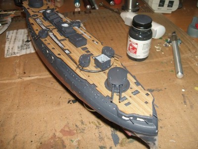

File comment: I just couldn't wait, so I placed some of the structure of the ship at the appropriate locations. Nothing is glued down here - I am simply take a look at the relationship between the decks, the lines, and the turrets and such.
File comment: Here is a closeup photo of the stern area. Again, this deck is NOT glued down - merely placed at this point to get an idea of fit and appearance.
If you can please leave your honest opinions, as that would help us to come up with better products. This Borodino deck is our very first test product, and we’re anxious to hear what the modeling community thinks about it!
More photos to follow as work progresses...

Yes, we are definitely planning on doing an Alabama (already have the Trumpeter kit to work off of!) and probably a Massachusetts adaptation after that.
Right now I am printing a one-pixel line on a our 300dpi laser printer. In case you're wondering, it's not easy to come by an 11x17 laser printer with a straigh paper path that is capable of printing on wood! And, the toner sticks to the wood pretty well, but not perfectly. So we actually get a very slight drop-off of some plank lines, making them almost imperceptible. Overall, the effect is pretty pleasing to the eye - even if it is by accident!
The cut lines at the plank ends are really, really tricky. For some reason, if you print those fully we get a much too think line. I don't know why that is, but it is. So what we do is to leave little gaps around the cuts; picture a pattern like |-| where the cuts don't actually form corners where the toner tends to accumulate. So that's a bit tricky, but I think we have some good results there. The trick is to make it "look right" with a "hint of a line" and let the human imagination do the rest.
And, for the record, we're using a fairly old printer now (it's what we could afford just to get started.) My dream is to get a nice, 11x17, straight path COLOR laser printer that we can use to print not only deck lines but camouflage patterns, national insignias (think Kriegsmarine swastikas) and other markings (such as aircraft carrier lines and numbers.) But that is all MUCH further down the road after the business starts paying its own way.

Actually, those are in development right now! Here's where we are in terms of what we are working on (all kits 1/350) and their status:
Available: Zvezda Borodino Class Battleship (Borodino, Oriol, Knyaz Suvarov) and Varyag Protected Cruiser
Final Test Cuts: ICM Konig Battleship, Tamiya I-400 aircraft carrying submarine, Dragon Scharnhorst Battlecruiser
Preliminary Drafting Underway: Tamiya Missouri (1945) and New Jersey (1980s) Battleships
Next candidates (This is what we have planned, but these are definitely subject to change due to demand):
A refit of the Tamiya Missouri/New Jersey to fit the Revell 1/350 kits of those two ships
Tamiya KGV and Prince of Wales
Revell Bismarck Super-Detail Deck
Tamiya Yamato Super-Detail Deck
Trumpeter 1/200 Arizona
Trumpeter Roma (as soon as it is released)
As for the comments about wood decks, take the North Carolina, Alabama, Massachusetts which are all preserved as museum ships - they all have natural wood decks today, so modelers wanting to render those ships as they appear as they visited it would want a wood deck - right?
I also have the Trumpeter Alabama and North Carolina on the shelf, but they haven't made their way onto the deck development list yet.
Now that you've given me this news, I don't even want to touch my New Jersey! Or at least glue anything down.

Not trying to rain on your parade; the technique looks like it shows promise, but when I see your tests, I still see 1/1 wood grain, and that kills it for me.
I hear you. Nothing I can do about that, unfortunately.
I will say this... The lines printed on the wood do a pretty good job of fooling the eyes. You see some light planks, and some dark planks in a nice variation - and the printed lines do tend to fool the brain into thinking that these are planks. Other areas in the wood that are darker or lighter across planks tend to look like stains or worn areas. And I do think that once you look at an entire model with etched brass and all the other detail that you eyes will take it all in and the reaction of the ship overall will be "wow." If you stare just at the wood, you can fixate on the grain pattern and your brain can conclude that it's "not right."
Again, nothing I can do about that.
For me, when it comes down to a choice between real wood with imperfect grain, or painting shades of tan - this wins hands down.
Your opinion may vary, of course, as this is more of an art than a science.
Thanks for the feedback, though. My parade is a little damp, but not drenched. :smallsmile:
