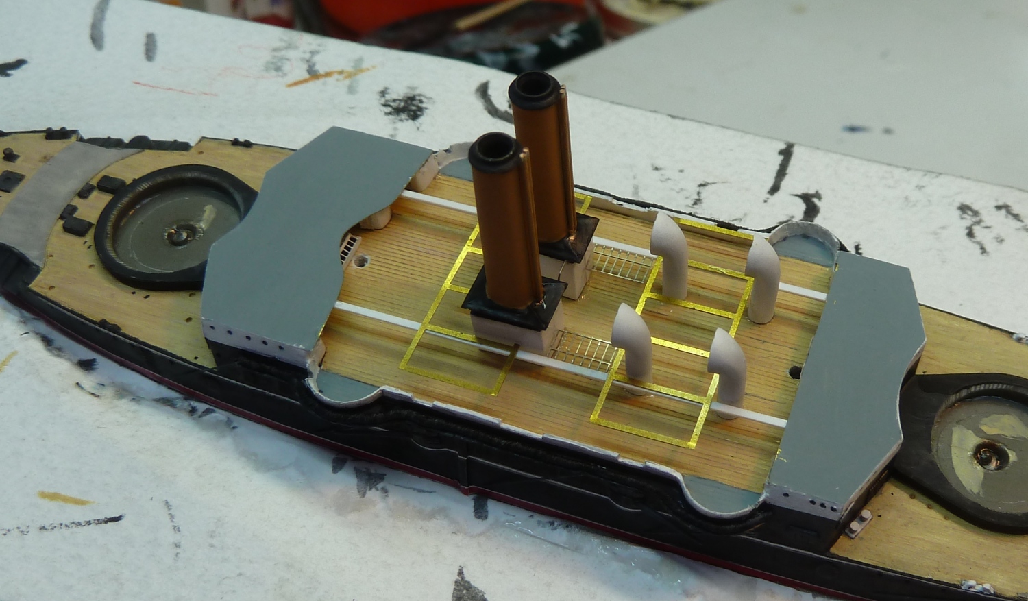

On my HMS Magnificent build I " could " probably have gotten away with not making the amount of work required to cure this,
as on Magnificent the boats and the sidedecks obscure most of the view.
here is what I did on Magnificent

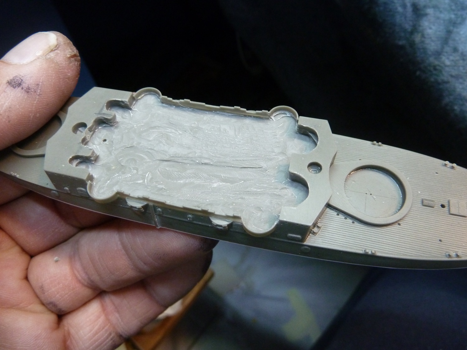

On Hood there is no such overhanging deck--and I knew I could not live with the compromise having solid bulwarks fore and aft

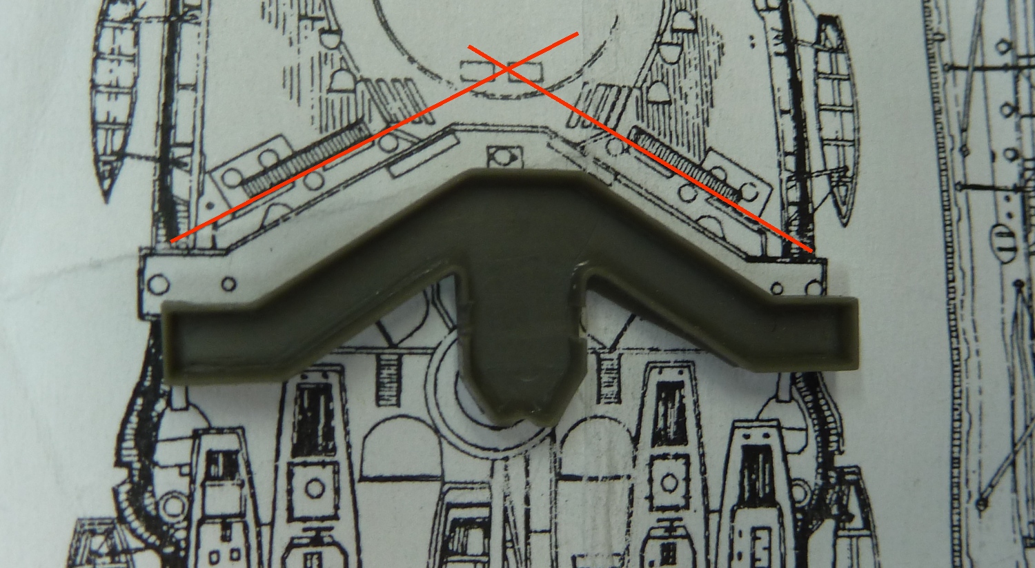

and I approached it in a similar fashion;

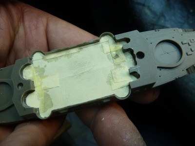

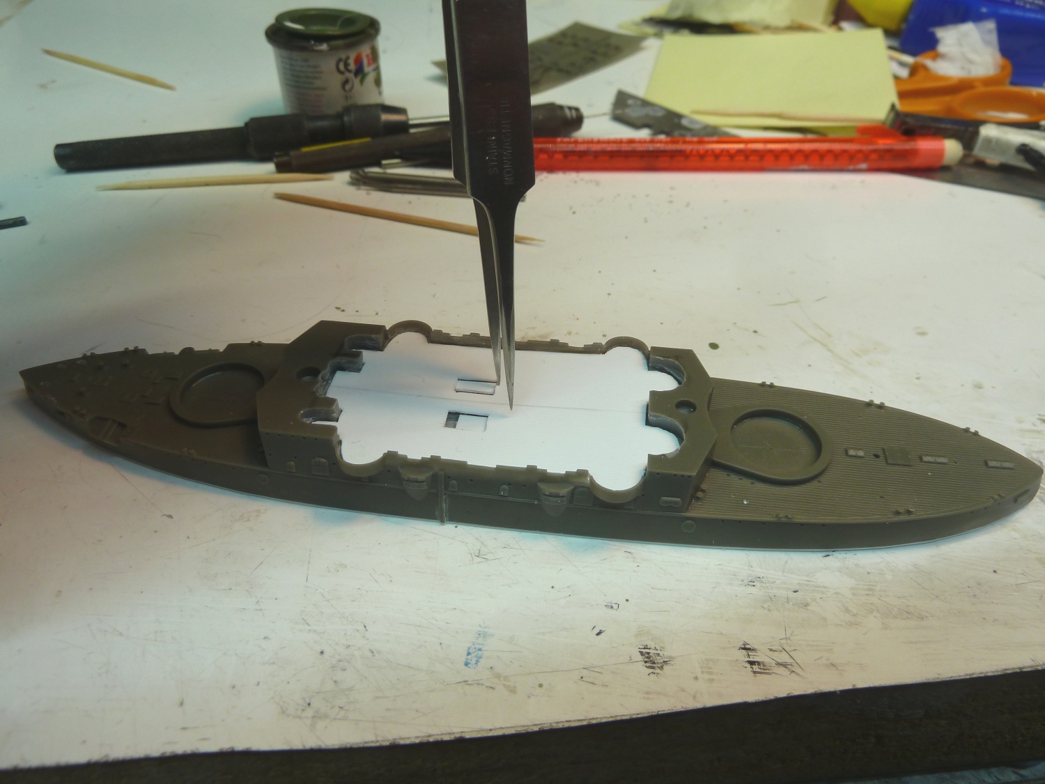

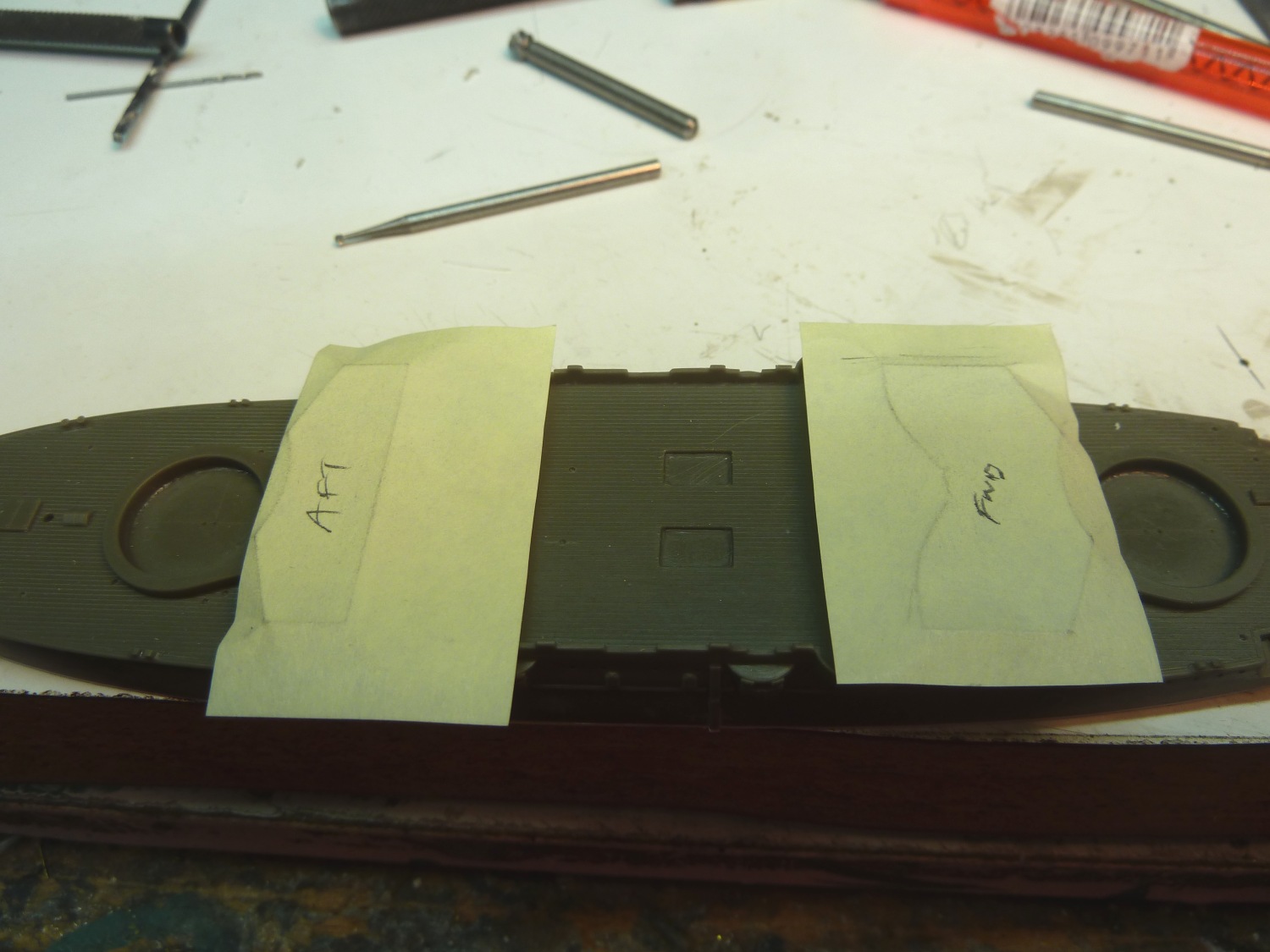

--after making paper templates of the decks ,

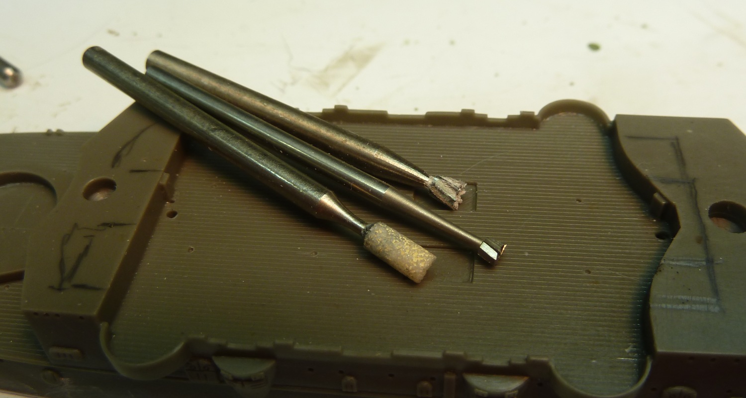

the tools I used were various undercutting dremel type heads in a mini-drill
I started grinding down the entire boat deck base to
make it lower to be able to accommodate the new deck to the correct height.
it was not pretty
after some smoothing and cleaning with a micro-chisel

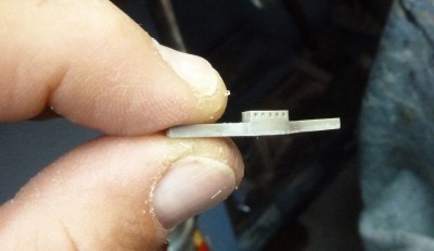

then a template was made for the new deck
and cut from 20 20 evergreen styrene sheet-- fit was not bad
even though the levels needed some help...

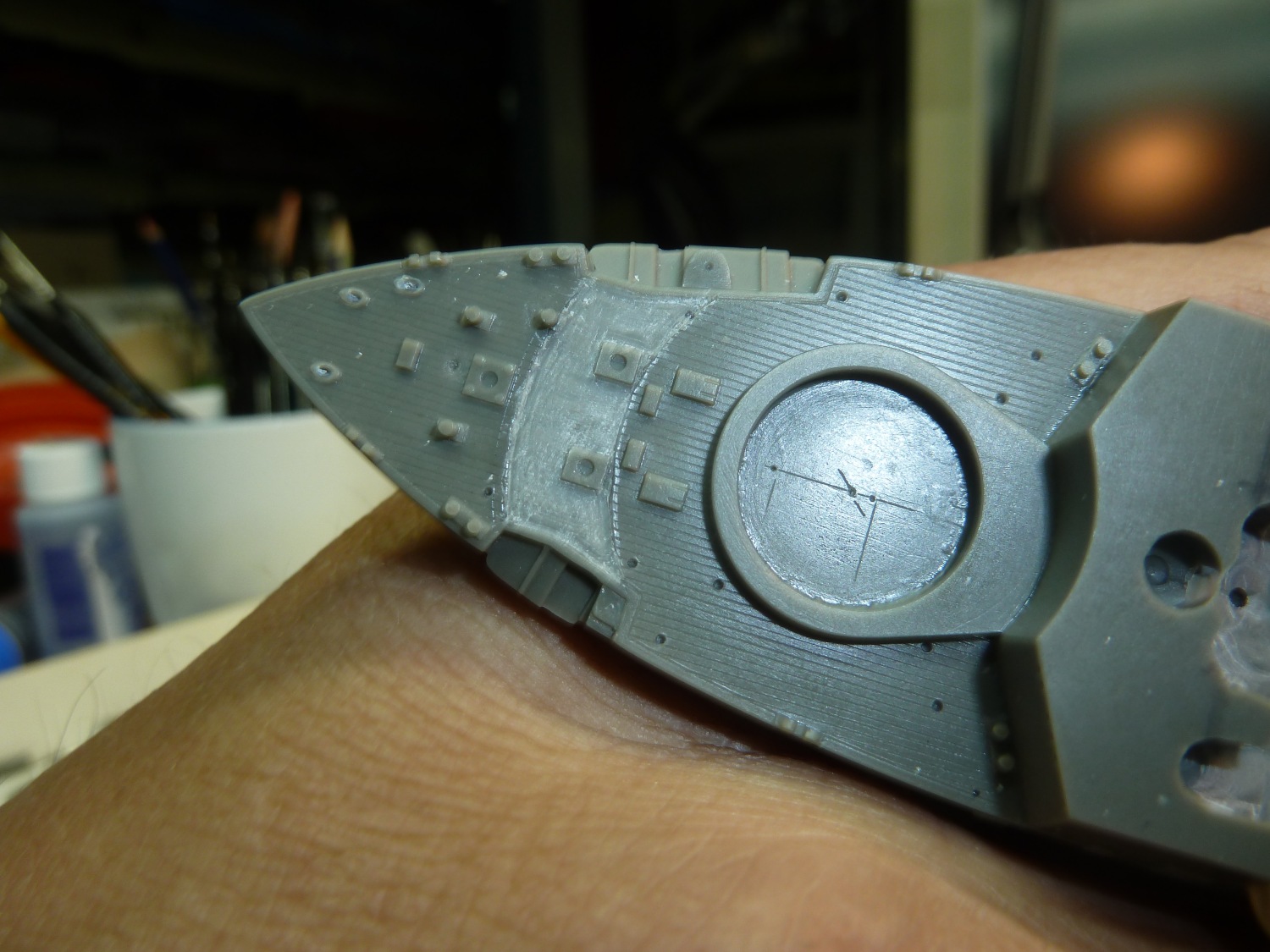

I omitted to mention earlier that I had previously fitted a styrene riser plate to the bottom of the ship-
( it can be seen as the white strip at the lower end of the hull
- as I wanted her to bed into the sea at her waterline--not get swallowed up

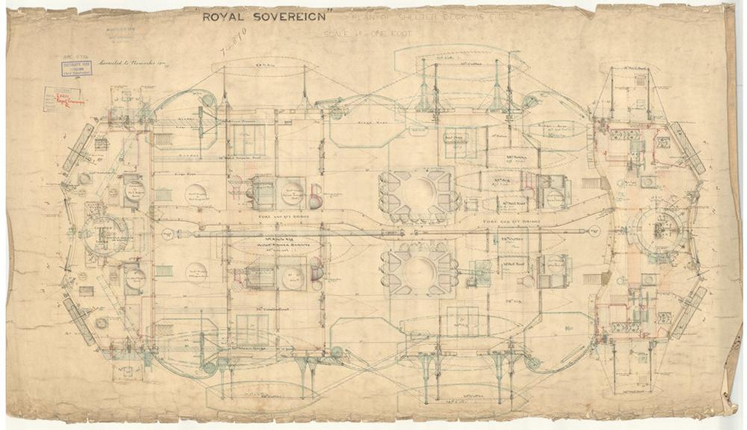

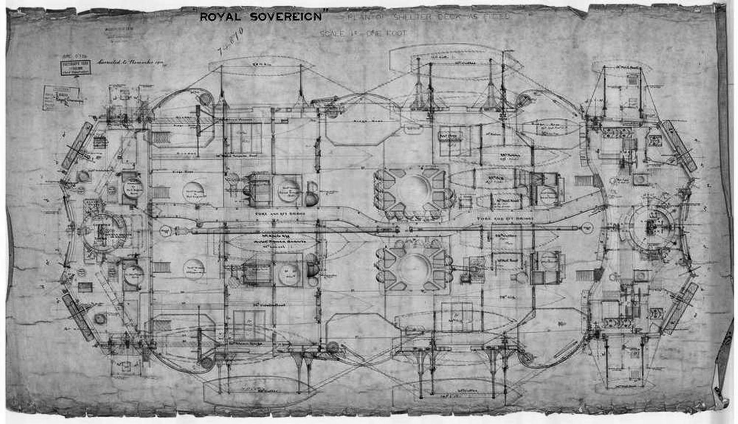

Steve Backer in his steel Navy review---linked above-
correctly I believe--identified that all the other Royal Sovereign( RS) class ships had muzzle blast plates on their decks at the radios of the gun barrel training circle, ==> and that the overhead plan enclosed with the kit showed these
( though I cannot find this drawing in my Burts book (?)--anyone have this drawing elsewhere? -in the new edition of the book perhaps ?
or was it perhaps adapted from the RS drawing?
anyhow-- I looked at my RS class photos and plans and agreed.

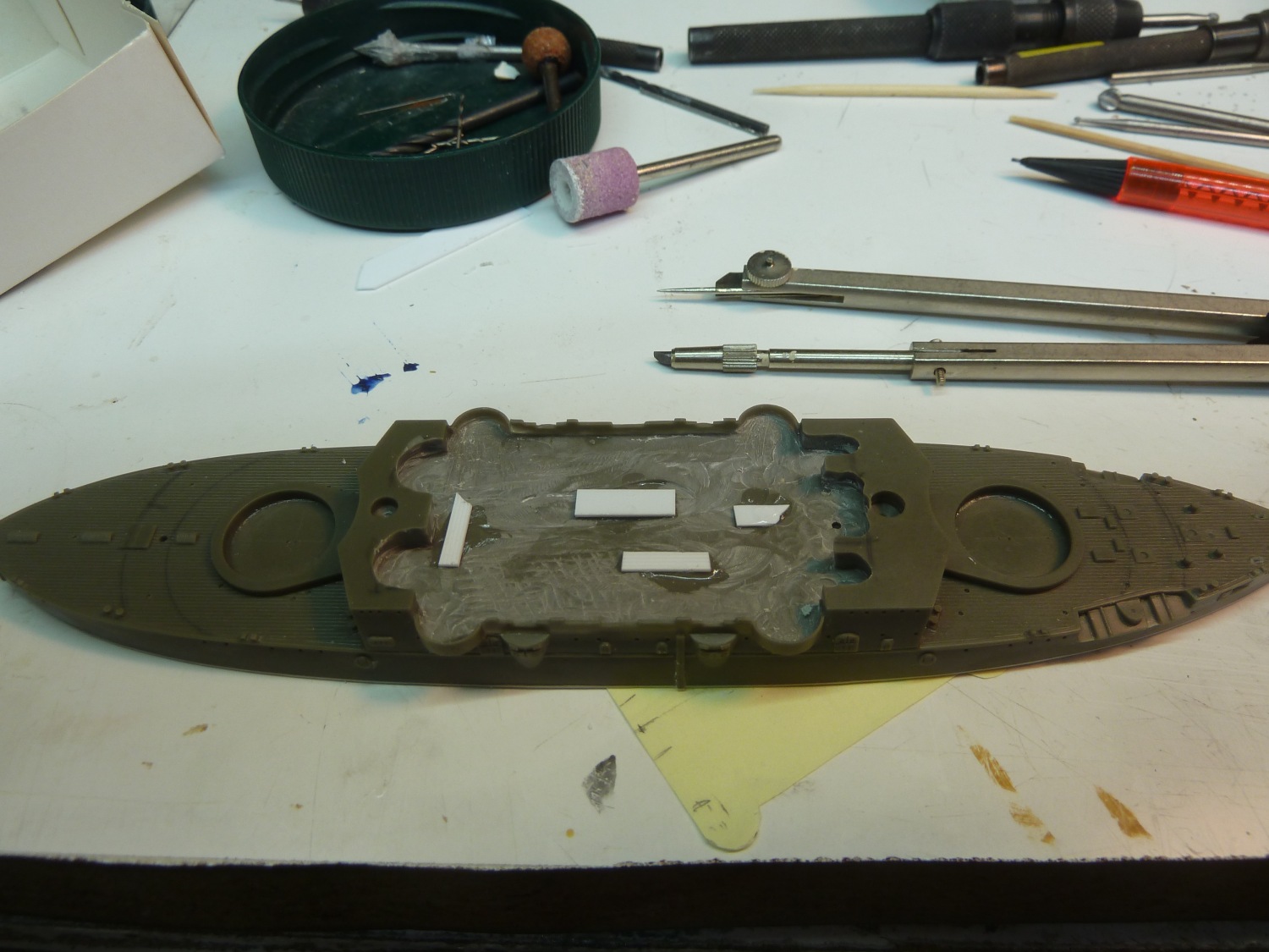

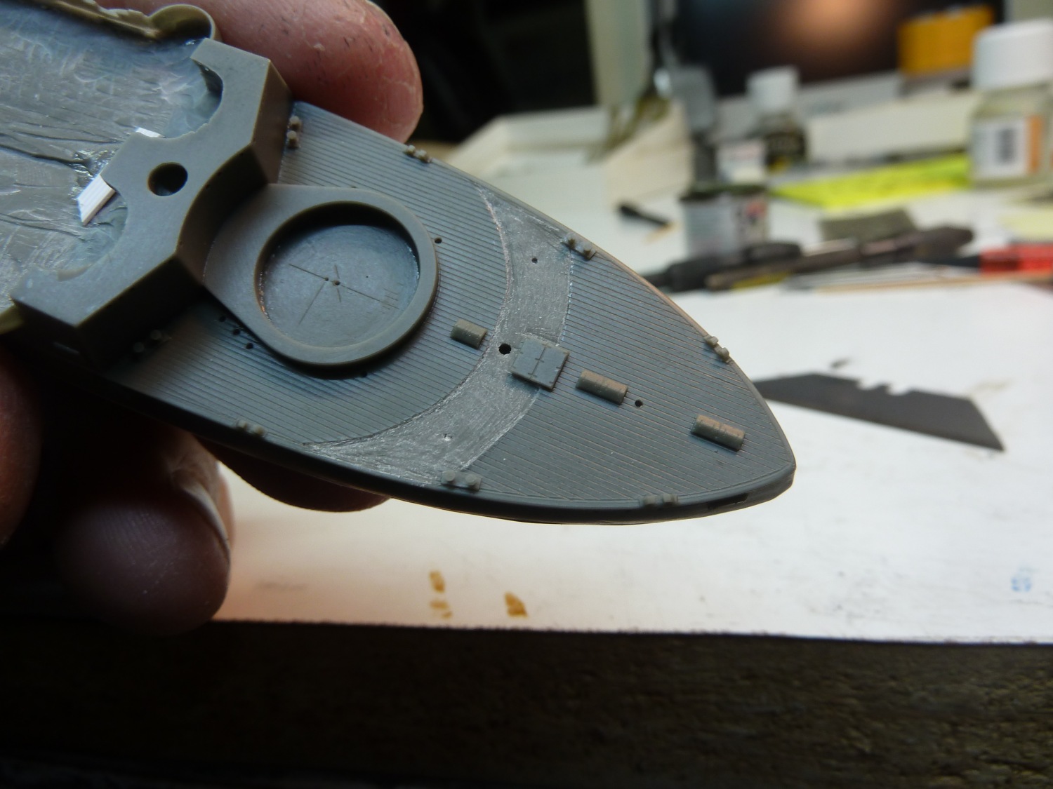

As the hull casting did not have these( which is a shame as the ones on the Magnificent were beautifully rendered!)
I drew the parameters using a compass with pencil
and then carved away and pared away the planking
==> Tthe plan is to flood this with a few coats of paint so as to to self level and bring up the heights...
( we shall see if that works... :thinking: )

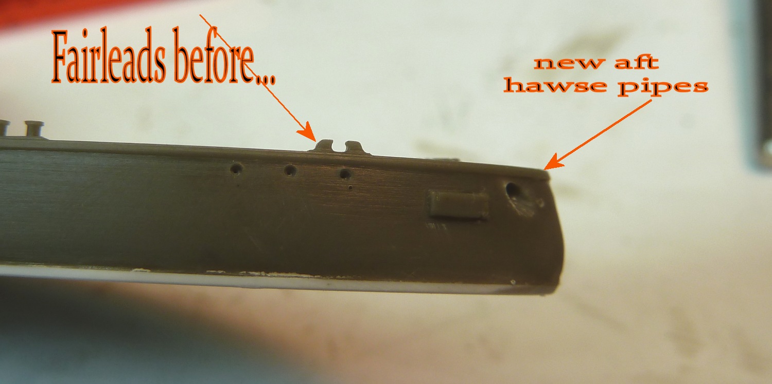

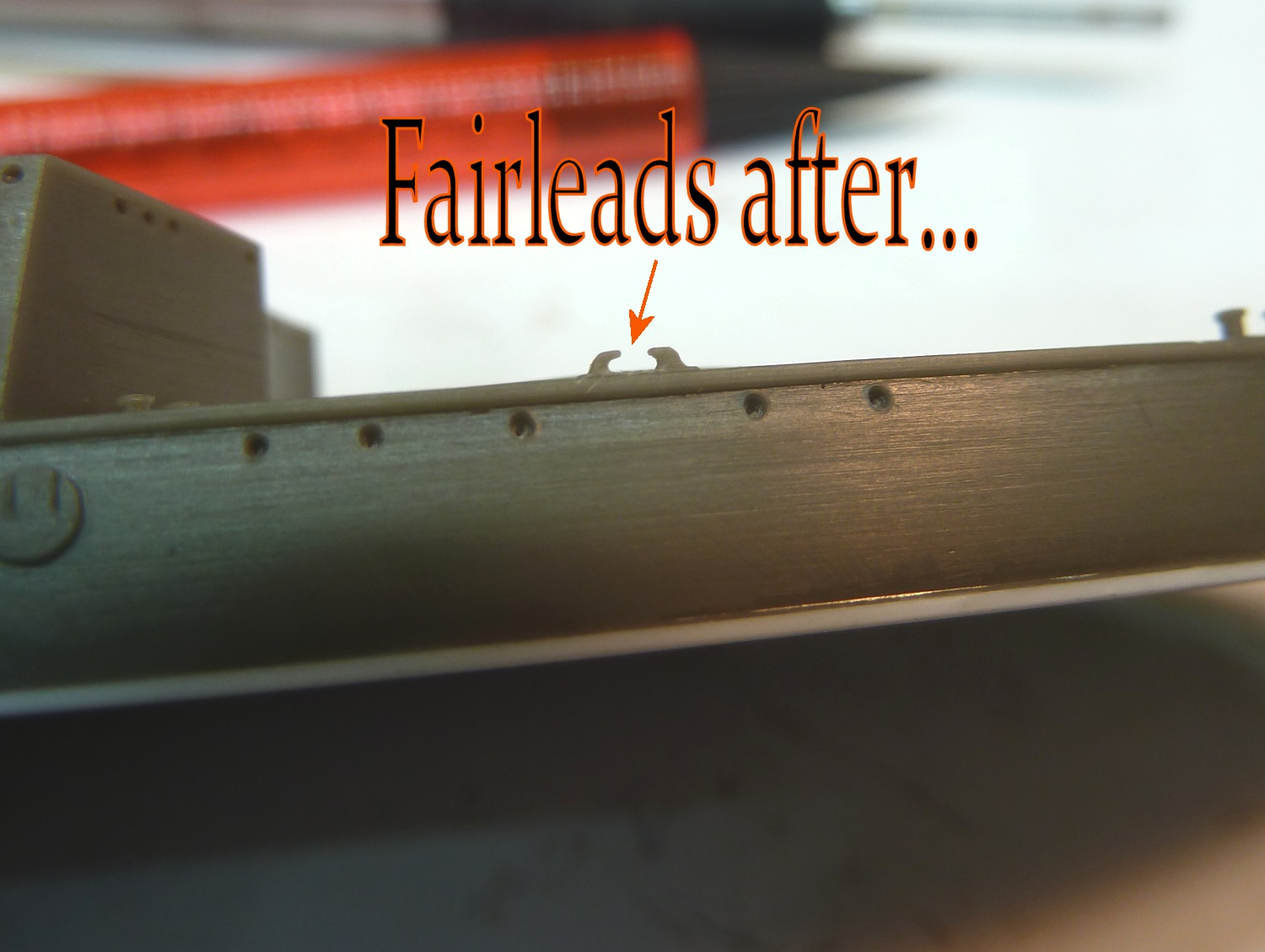

The fairleads are about the right shape and size-( huge)- they were very wide athwartships on the real thing
-- but not as 'thick' as cast--
but their disposition is about right , so I elected to use them
...but only after they had been thinned by sawing away at the resin with a very fine drill bit in a hand-held pin chuck
I took the opportunity to drill in the hawsepipes aft both sides

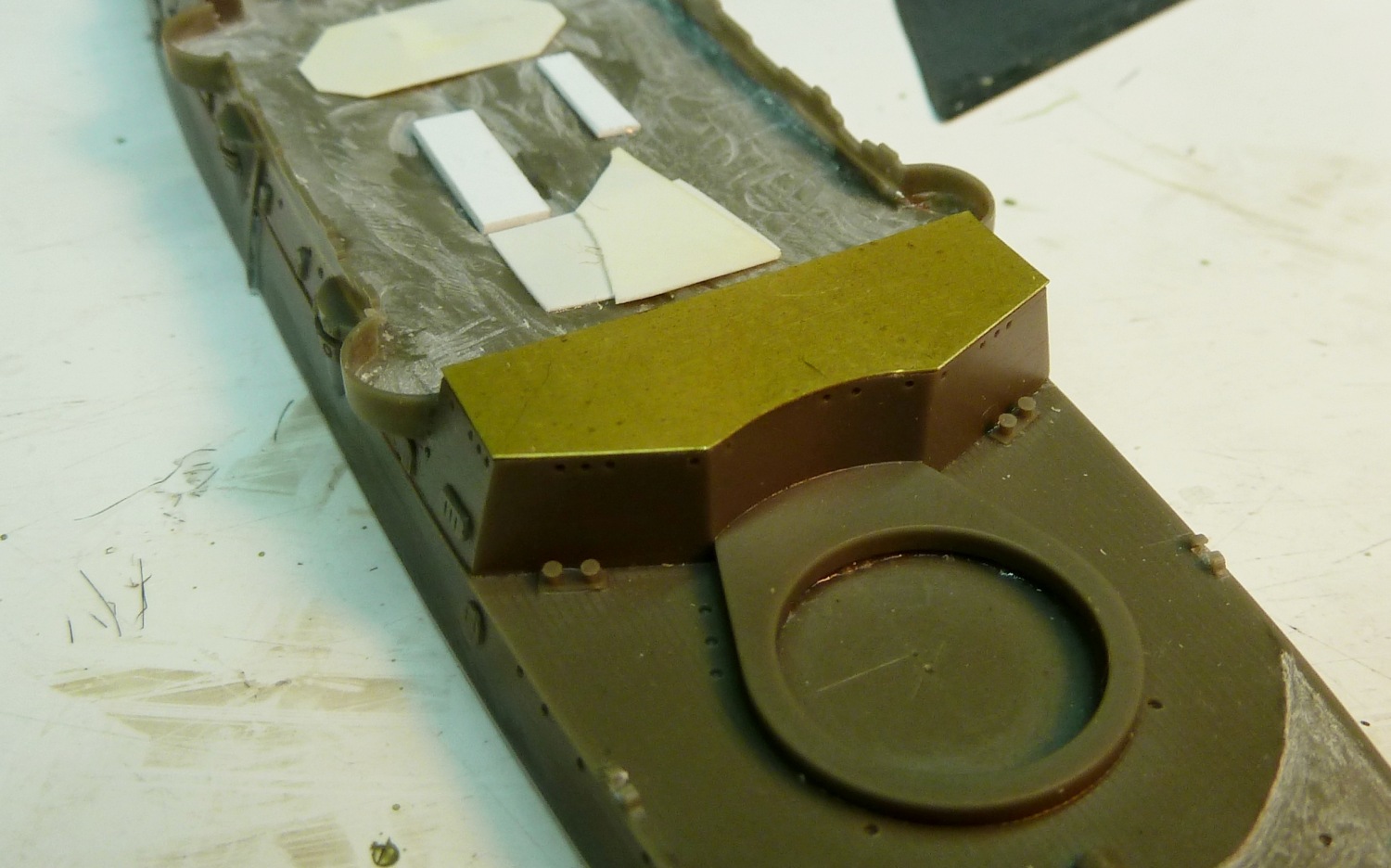

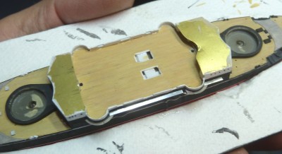

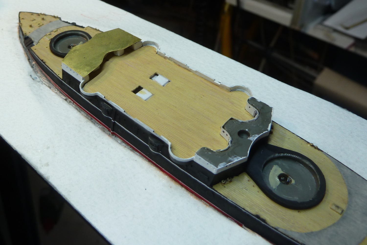

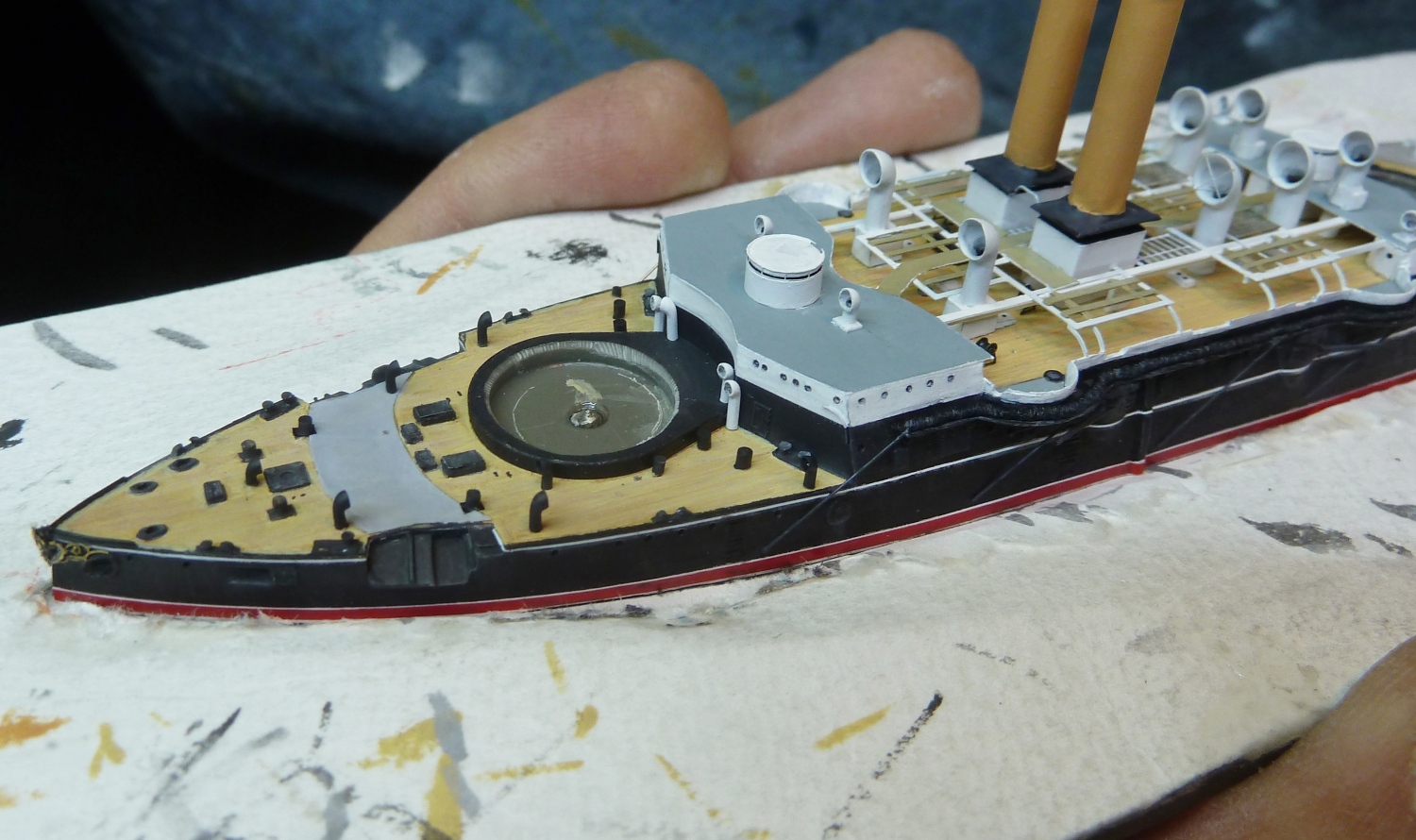

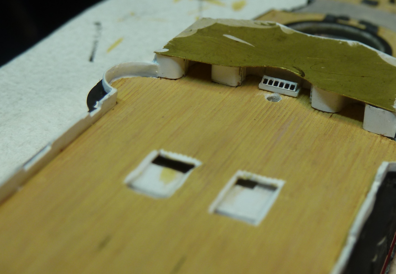

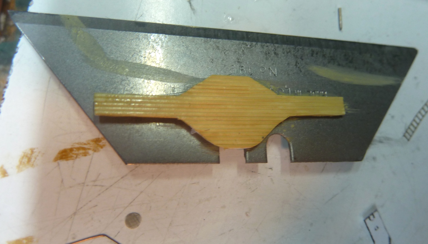

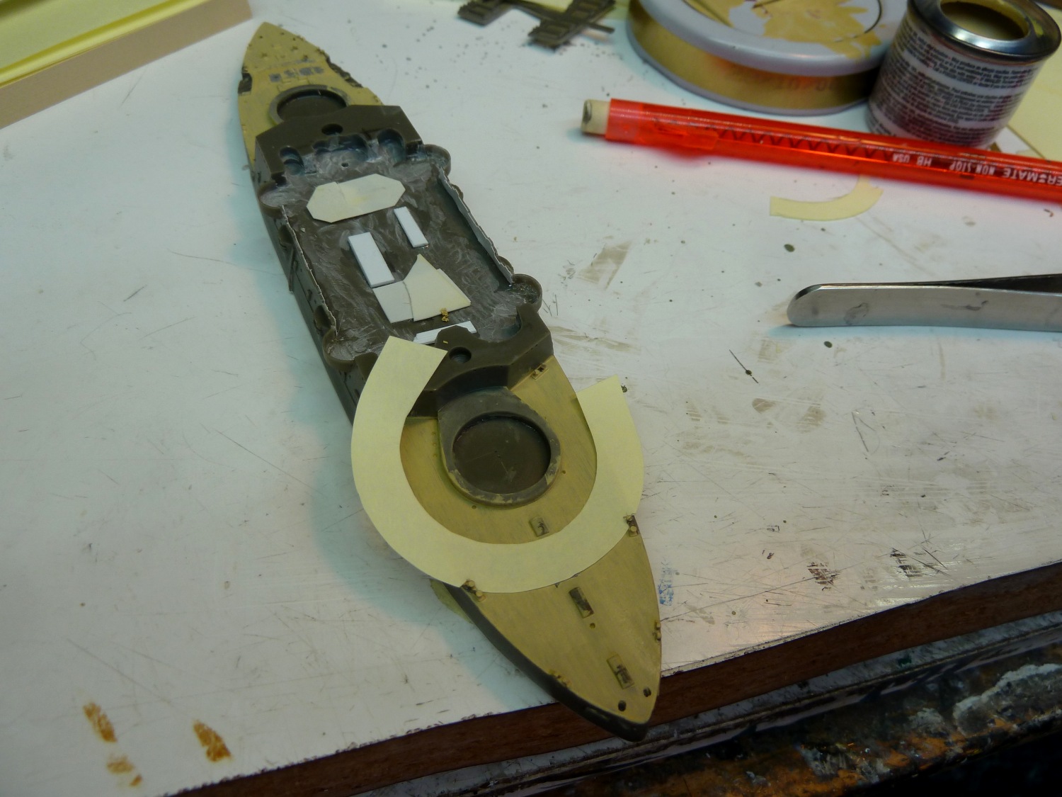

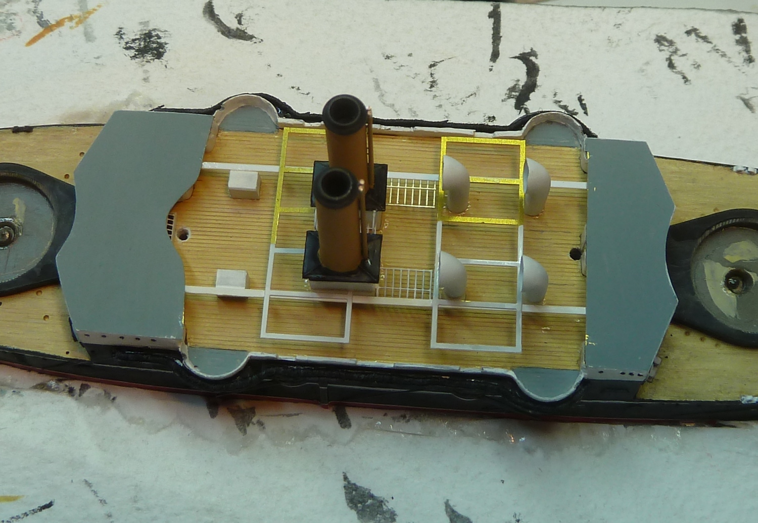

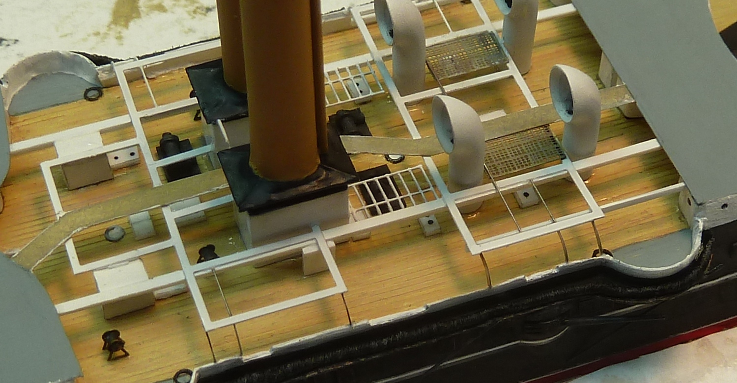

The previously templated decks were cut new of brass sheet ( ex-l'arsenal 1/350 liberty ship PE )
and testfitted them repeatedly with a swipe of a file until they all lay smooth and flush to the superstructure
==> boring and laborious ....

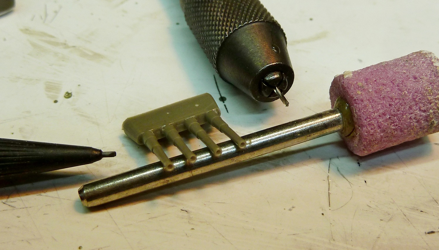

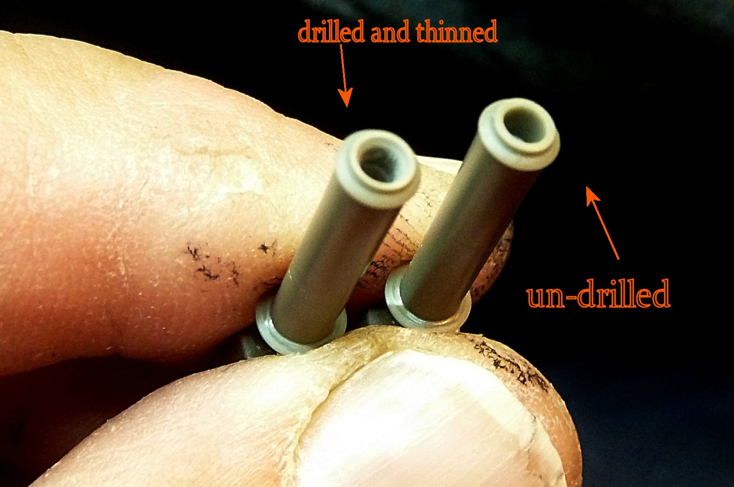

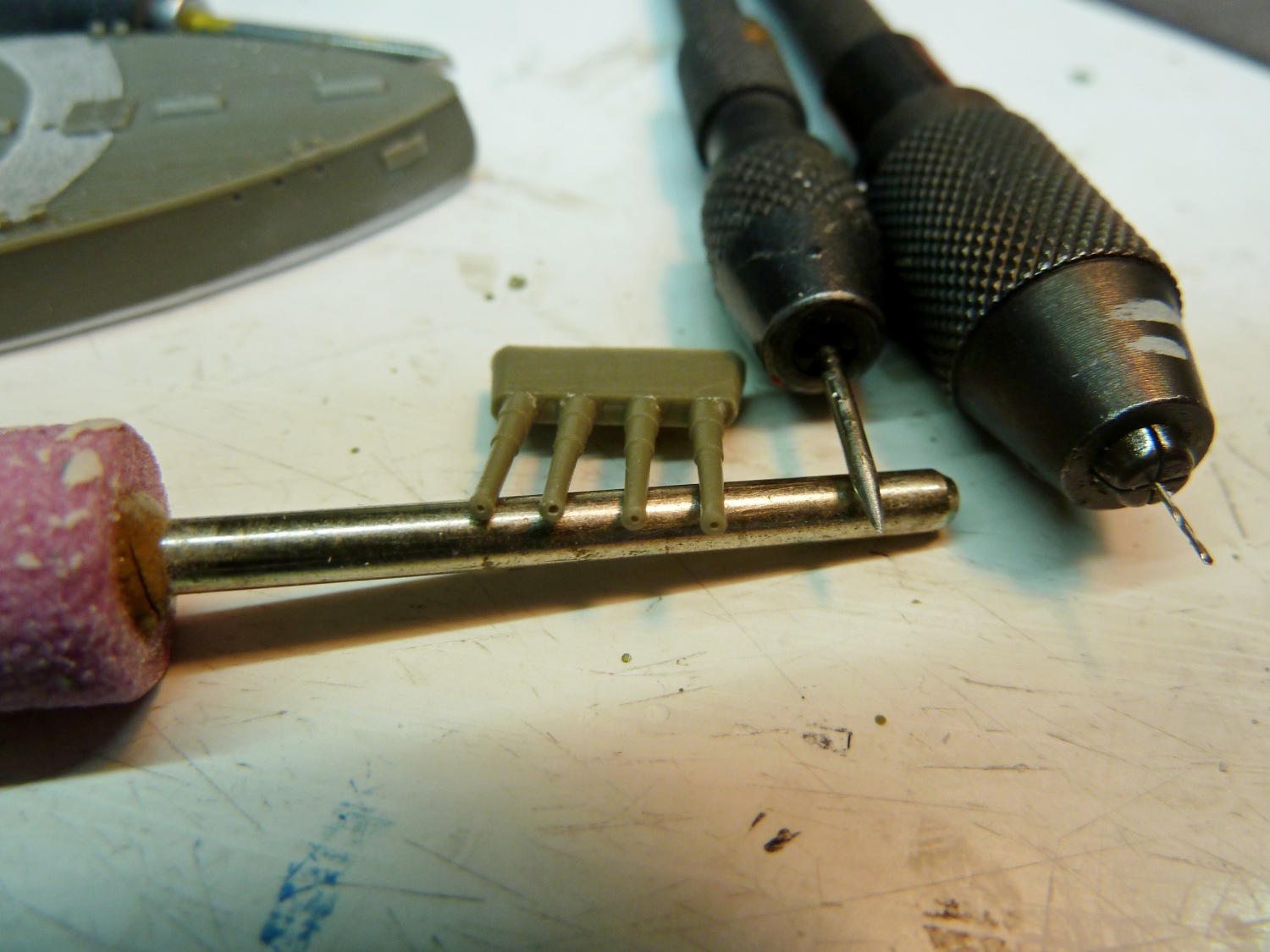

For a change of discipline I elected to drill out the gun barrels.
Usually I substitute for brass barrels-- but the resin items in the kit did have a pleasing flare of the muzzle--and being short I decided to use them
--but they needed drilling...
I made a centring divot with my spike and followed this up with thing drill bit as a guide
and then followed up with a 'bigger' ( Haha !) drill bit.

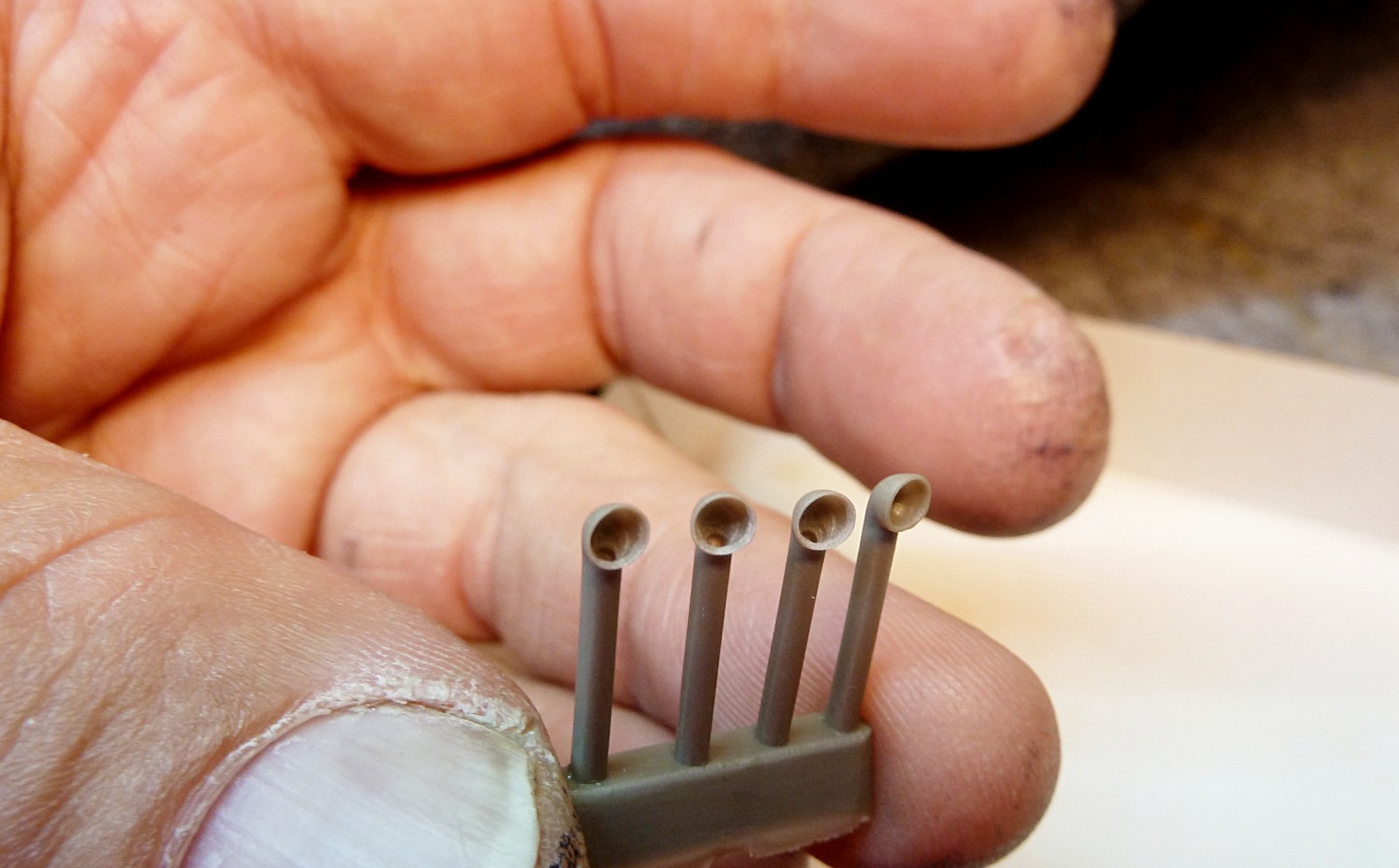

Whilst in drilling model I decided to make a start on the myriad of cowl vents.
Combrig did a good job on these ---the look right dimensionally as well as in shape--
so I proceeded to drill the vertical shaft hole, followed by grinding out the cowl further before thinning the rim to about 2 thou
Clunky vents can alas so often spoil a ship model-- and I do try and get them as thin as possible, hitherto without any catastrophe failures
nevertheless it can be nerve-wracking if/ when it goes wrong... :cool_2:

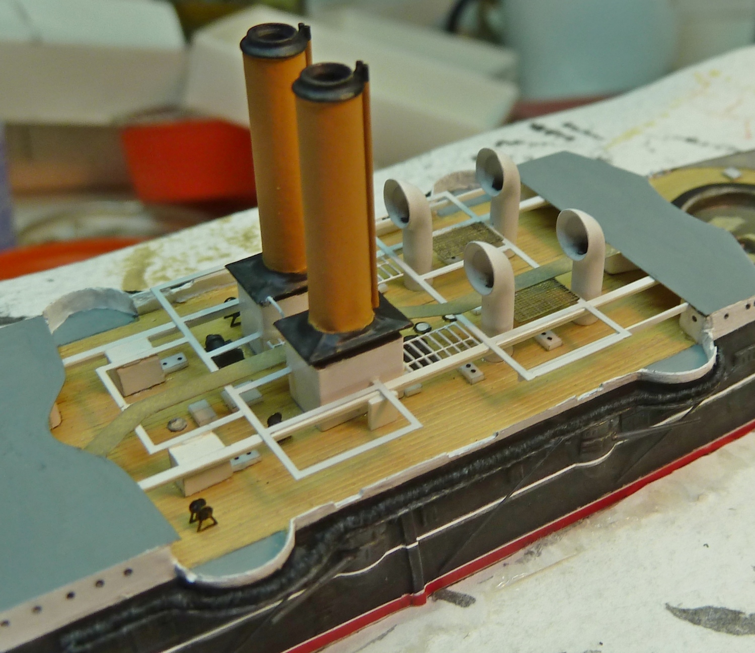

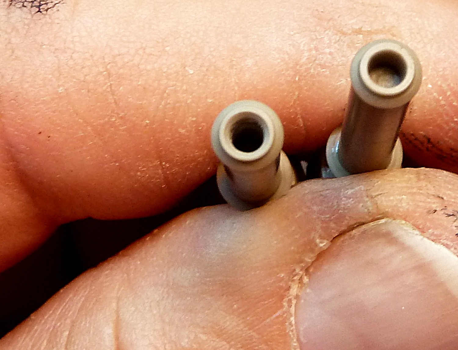

The funnels were actually rather nice in shape --apart from being solid and a bit thick on the upper rim
I drilled and thinned these and they will serve well--
no point in making life harder than need be..!

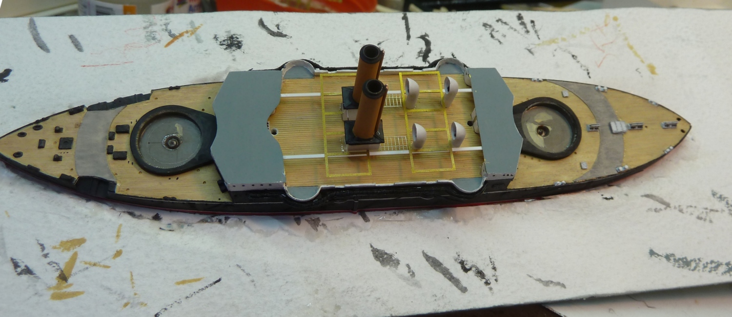

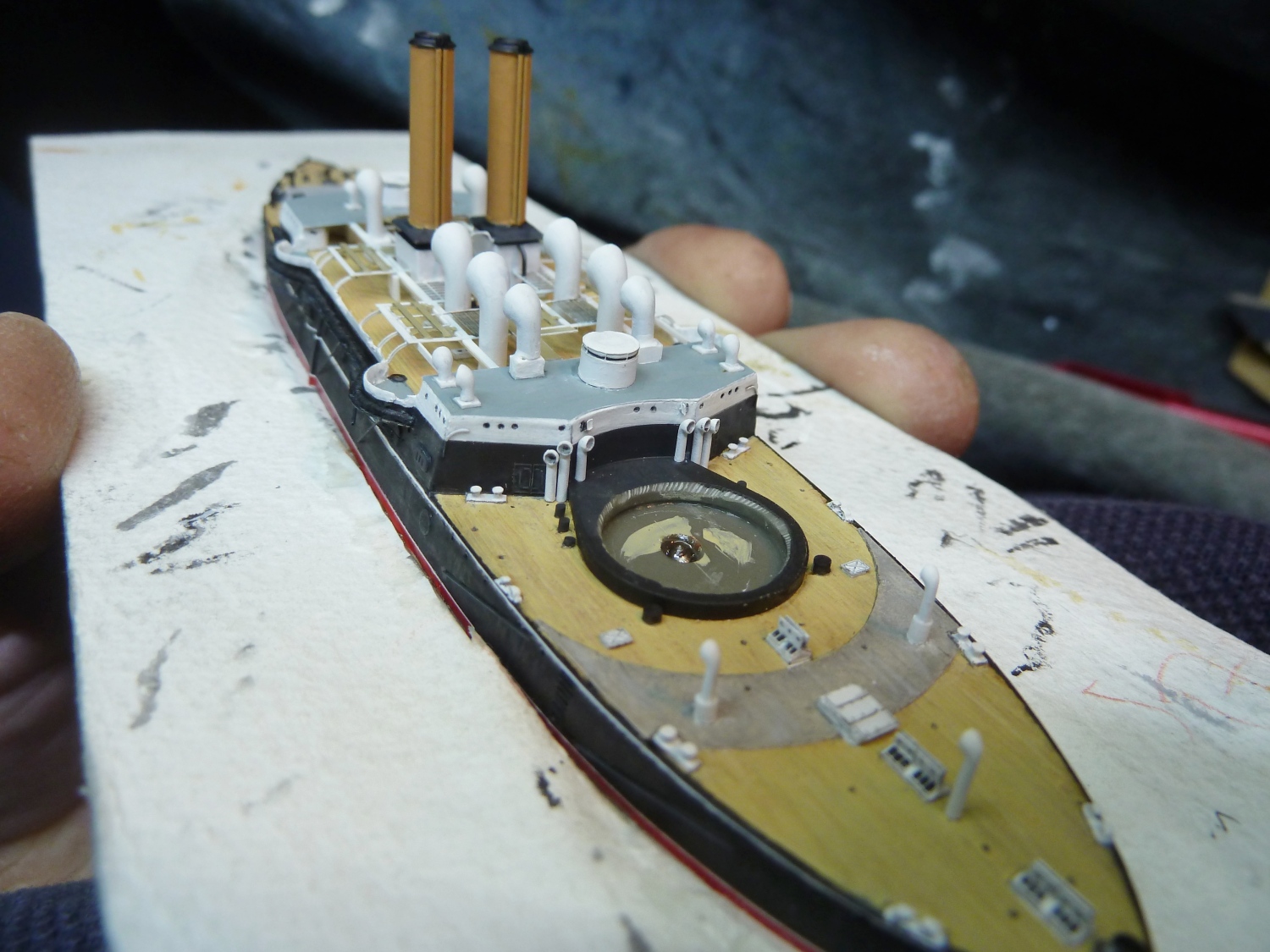

further recent progress;

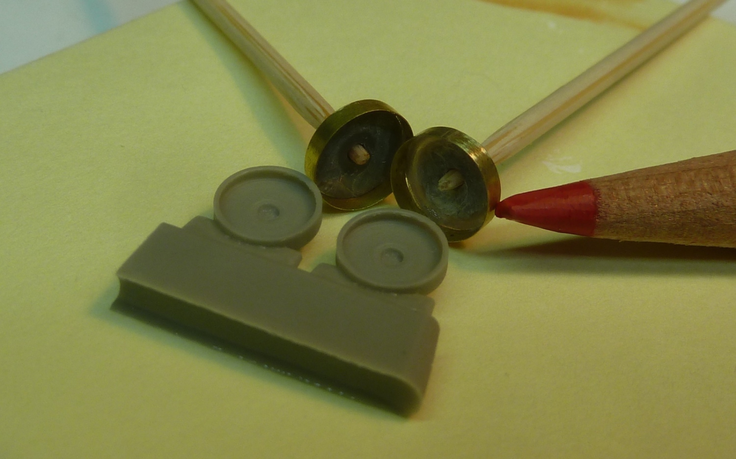

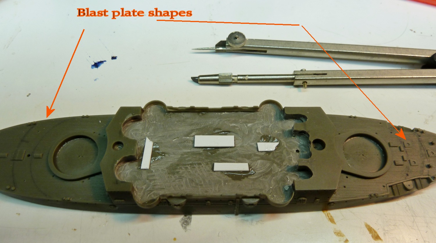

The excavated blast plate areas ..( filling with paint to self-level ..?-pah! what was I thinking! )
I made templates and drew them with a compass on paper
and selected the best part of my scissor cut edges

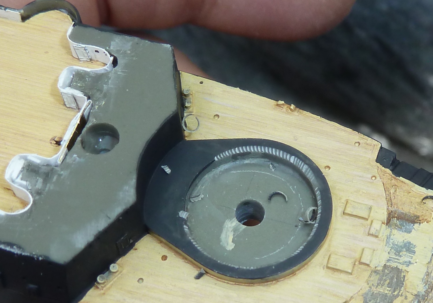

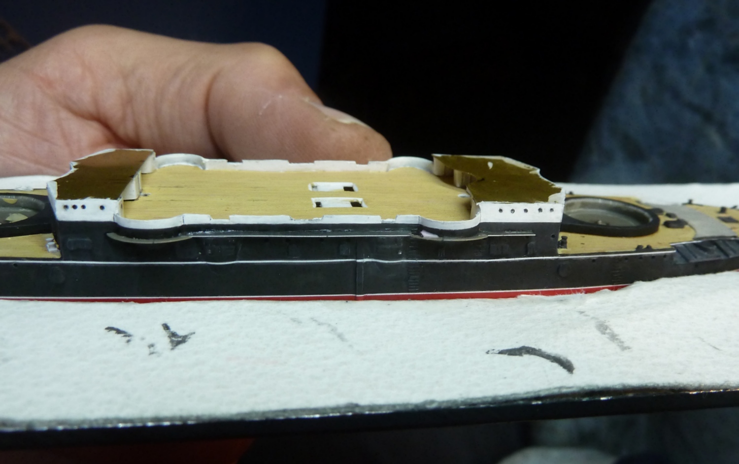

whilst in trhat vicinity, I testfitted the turrets ( after flatting their bottom by 1 mm )
a lovely fit but just up proud slightly due to the radius of the resin cast edge on the underside of the turret plug
Rather than hollowing out the bottom of the turret step edge--I simply rounded off the edge on the barbette-
(-this area will be concealed by the turret skirt )

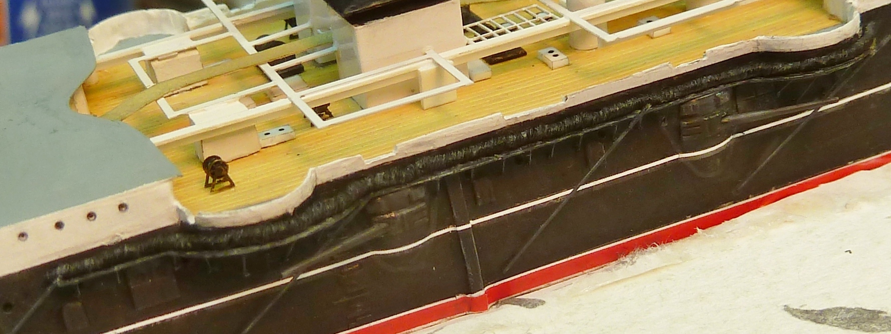

more butchery on the grand scale...

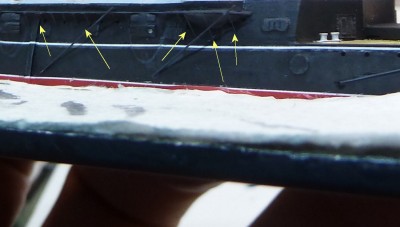

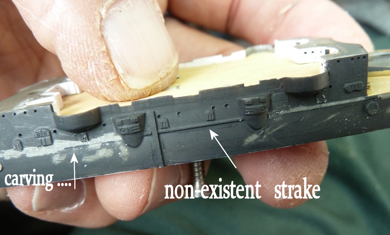

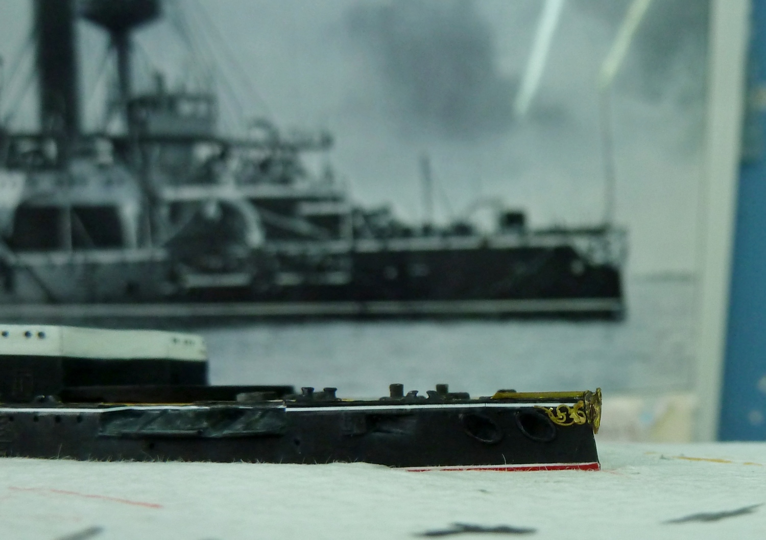

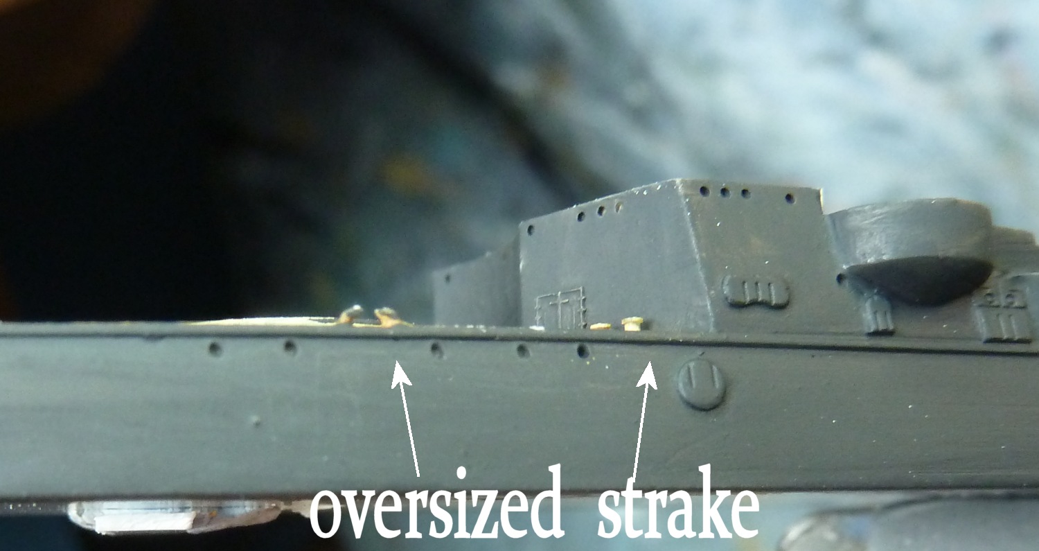

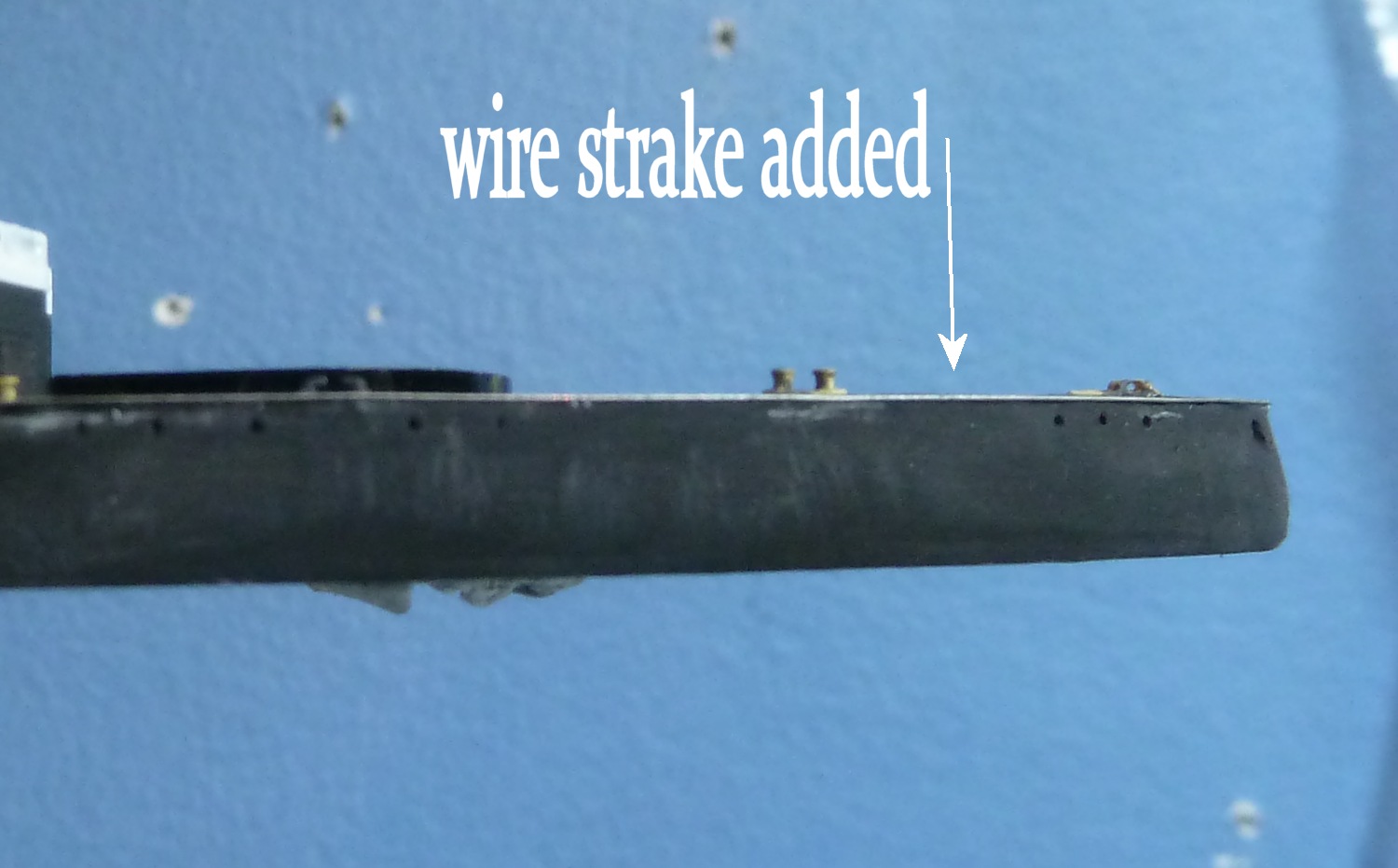

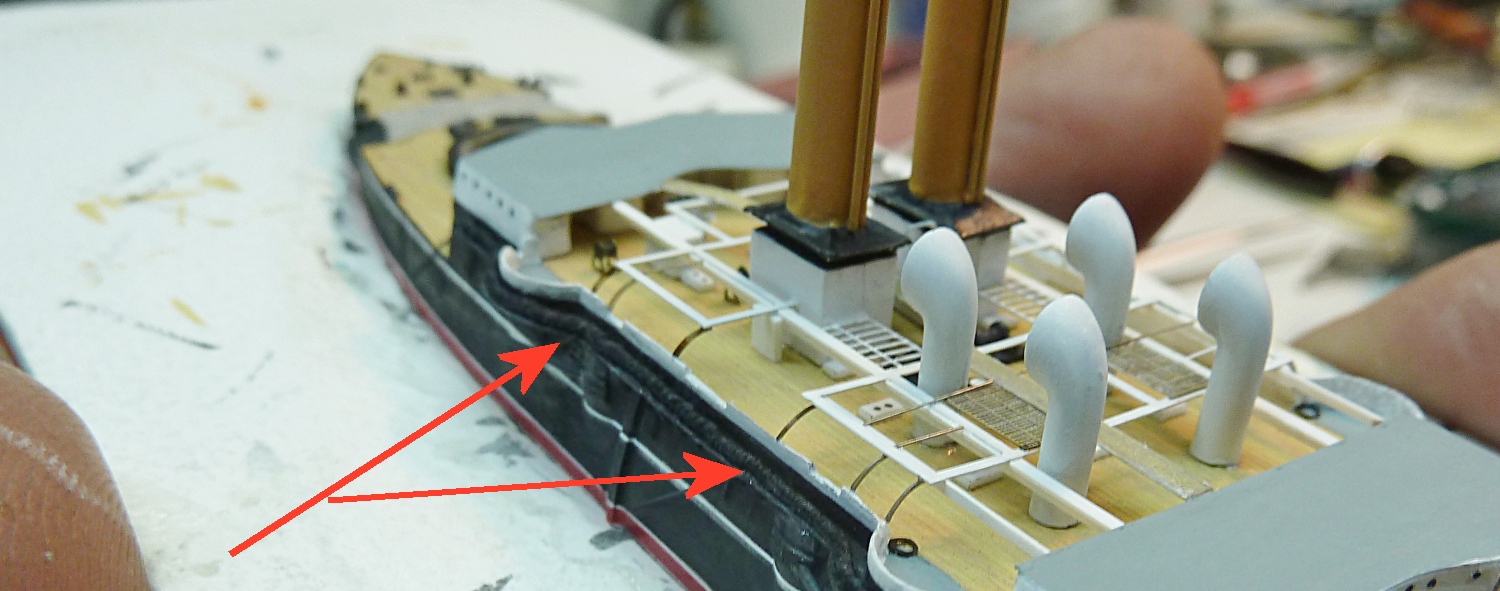

the position of the portholes ( which is correct in a vertical plane
was marred b the vastly oversized strake-- not allowing space for a white line and porthole and strake !!
off it came....-- along with the non existent fictitious stake in the midships area
after much careful paring, sanding and scraping...
( oftehn with heart in mouth carving away in a hollow...)
Once the new rubbing strake had been added using thin wire
there was actually room for the white line
Phew!

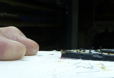

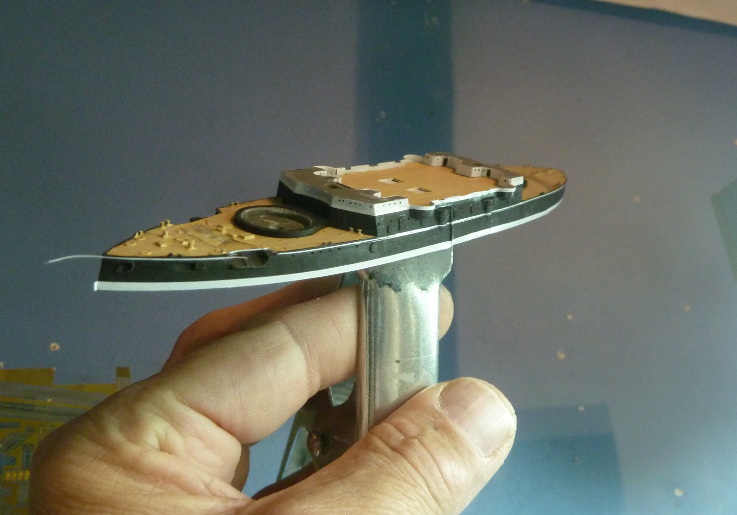

with the addition of the red decal stripe over the previously varnished white striping ( hence the additional waterline plate to gain the height needed
I was able to complete the underwater part ready for mounting to the sea-plate
with screws allowing for tuning the hull (cast) warp as well as securing mechanically :thumbs_up_1:
and getting my hands away !!!
More progress shortly !
JIM B

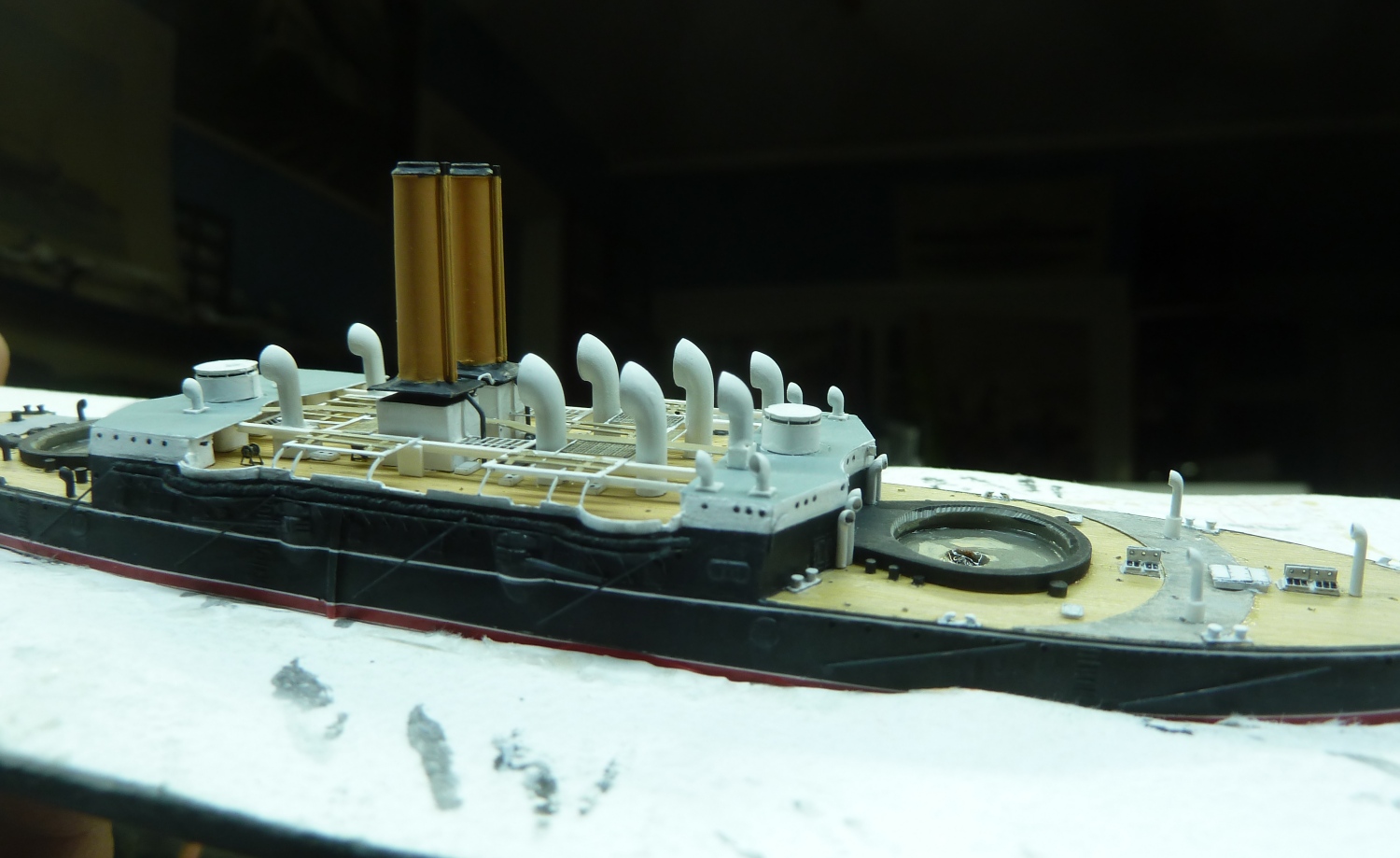

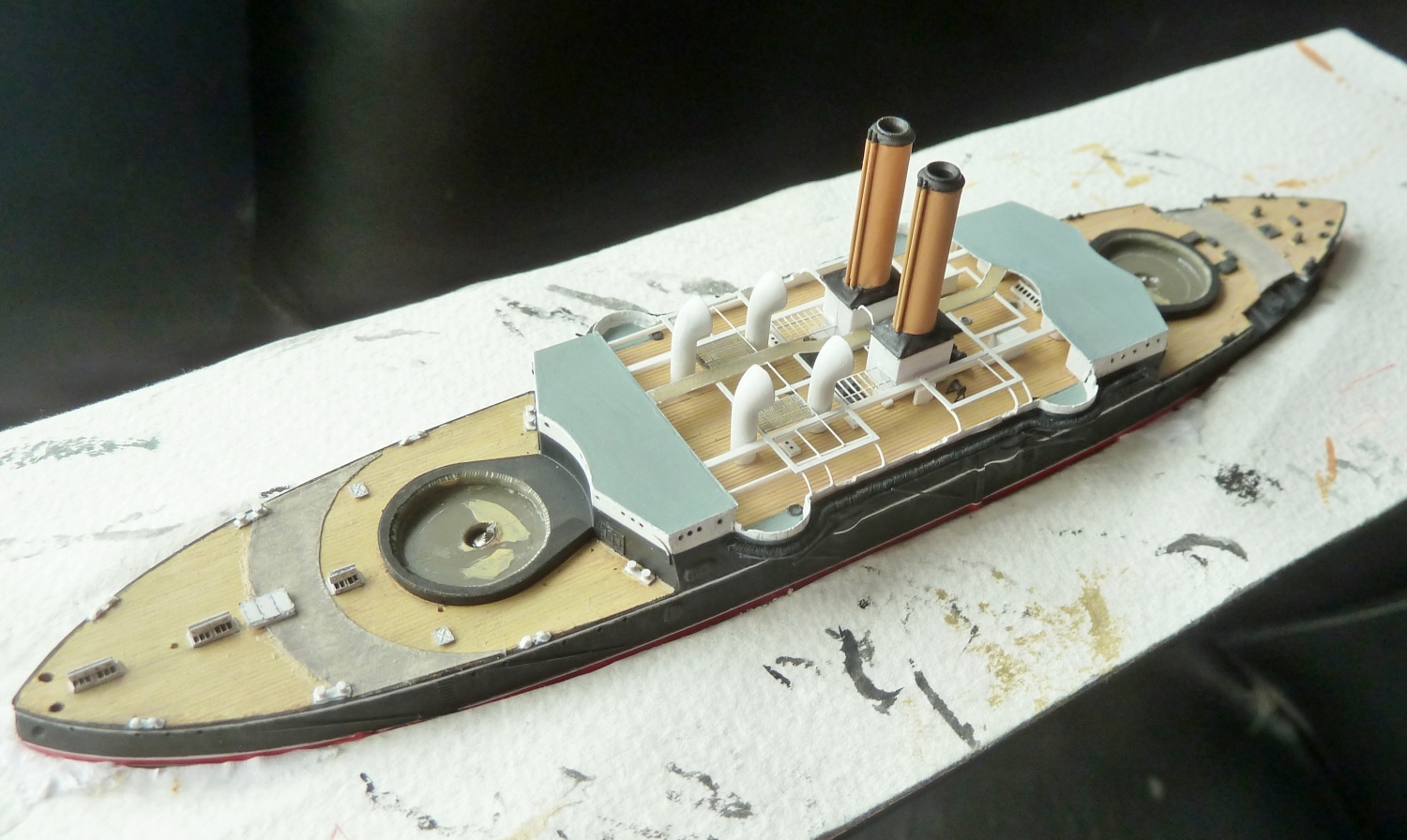

getting on with it-
-not as fast as hoped ( is it ever...?!)
--as staring at photos for ages trying to glean the information and compare to drawings of the " normal" Royal Sovereign class
does not always result in tangible progress!

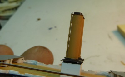

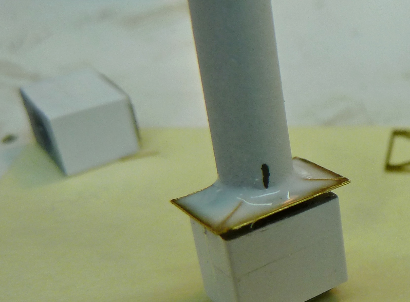

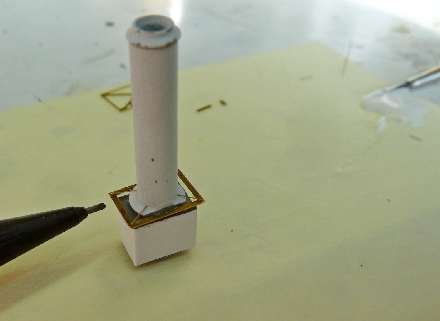

here are some 'halfway' stages of various elements,

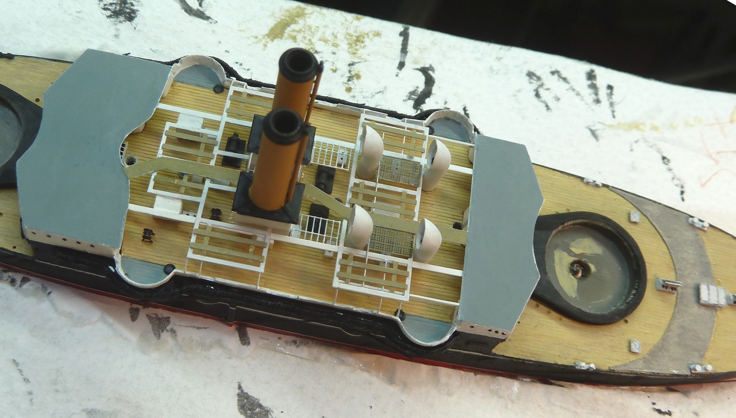

Hood's funnels--along with her near sister-ships had prominet cowl overhanging the uptake casing
these were square and faceted.
Tediously this was not on the castings.
They are quite a tricky shape to model--I tried cutting them of paper; whilst I could cut them cleanly I was unable to join them cleanly....
I resorted to a different ruse to be able to produce these shapes
I made some symmetrical oblongs in brass, larger, so as to overhang the square uptake shaft casing
The very incorrect round cowls were cut down and away-but used partially as a support
small pieces of brass were glued on to form the facet apex ridges
These were then spanned with white glue to produce the flats,
once dry and guide-coated in black they
received a second coat of glue
I am awaiting the glue to harden through completely and will then assess further after paint.

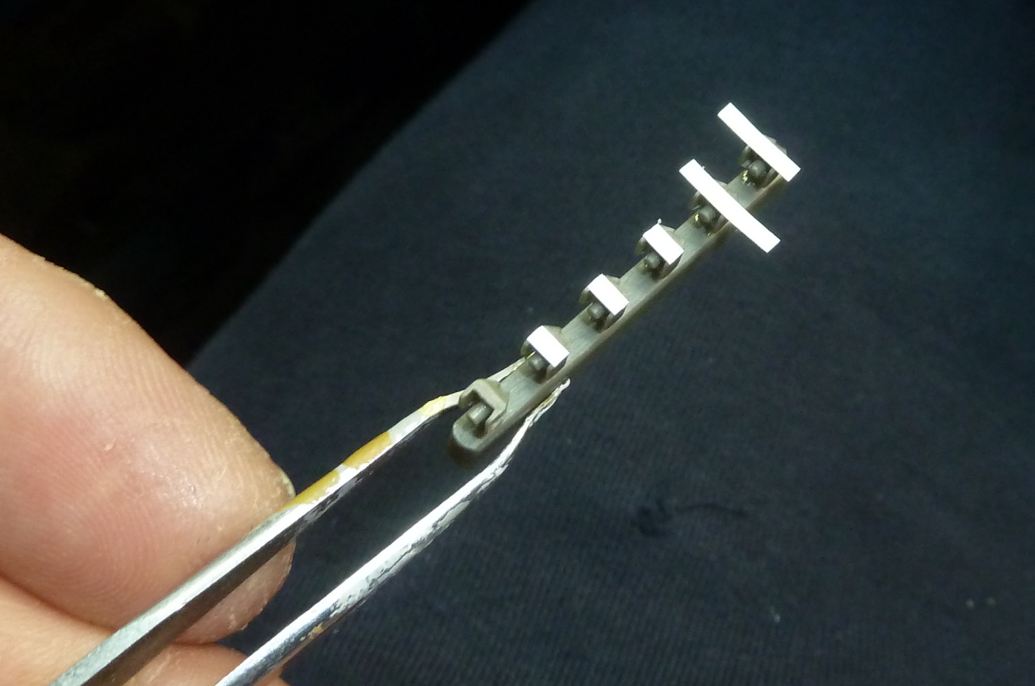

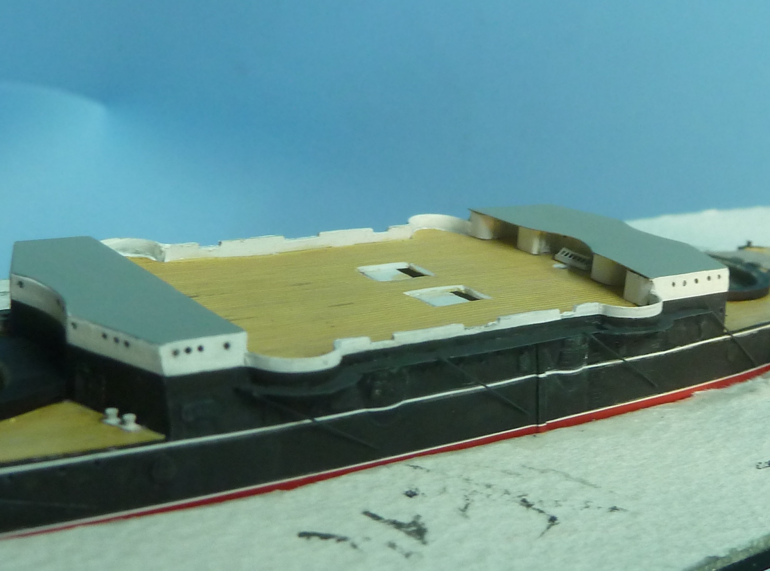

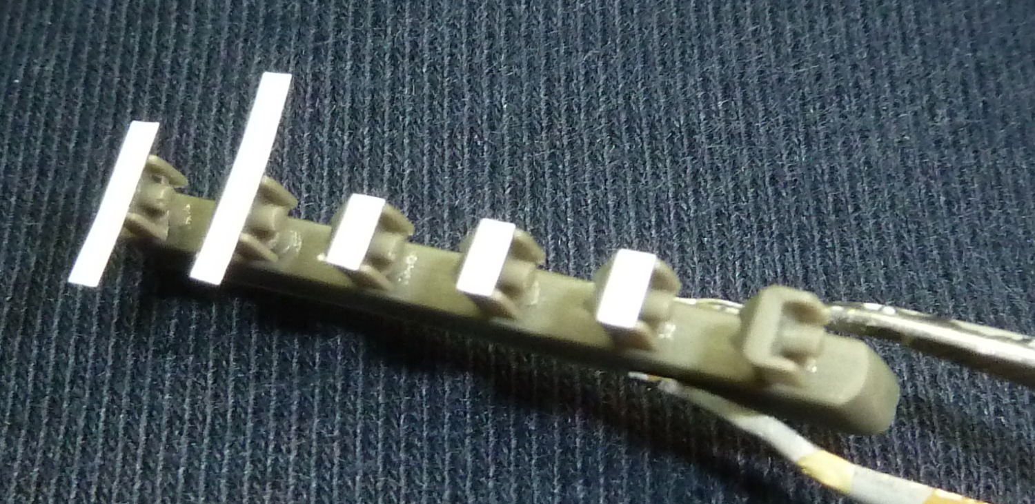

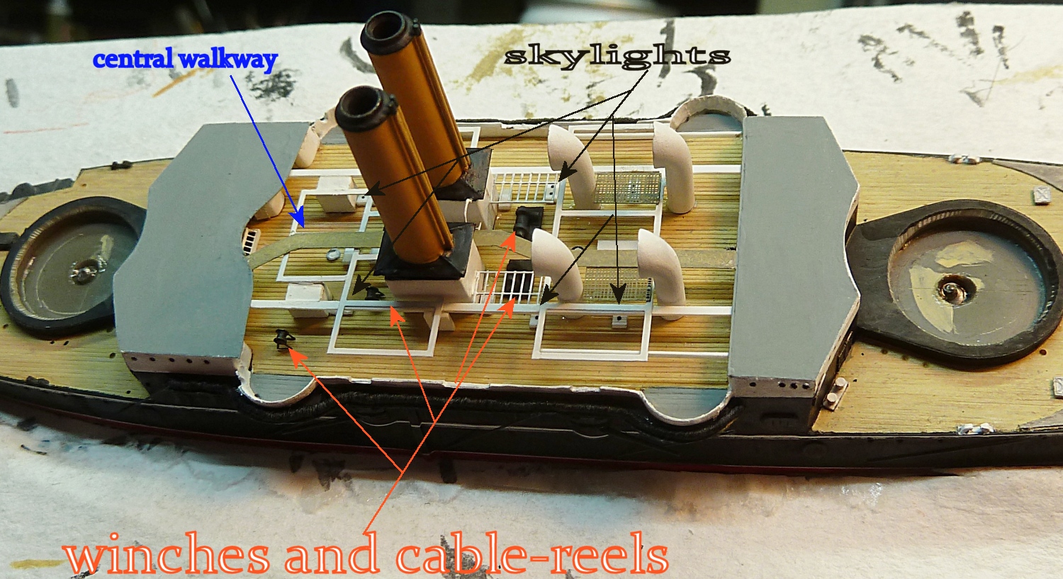

anyhow-- the 6 x 6 in gun houses...
Combrig had more or less captured the shape well enough... enough for me not to want to remake them...
However they were solid at the fwd enc and lacked sufficient overhang on the roof
that said the inboard face will not be visible really so I hope to get away with it..
I added the roofs of white tape, with the edges sealed with CA
I still need to thin the aft edges and then sharpen up the inclined edges of the sides

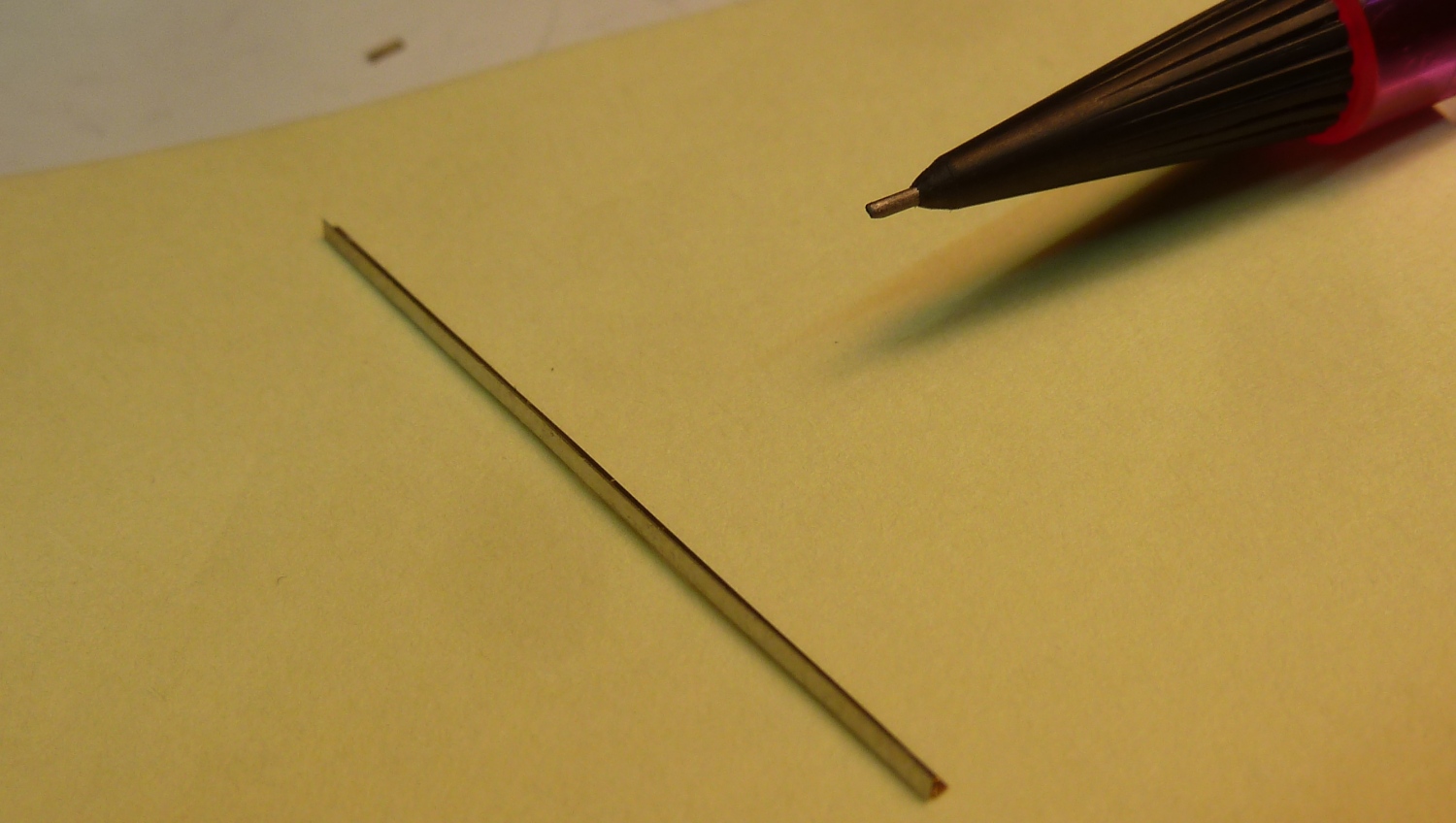

The fighting tops walls , as cast in 1: 1 scale -- would have the splinter shield walls at knee level--
ie they are not deep enough and the crew would simply stumble over the edge!

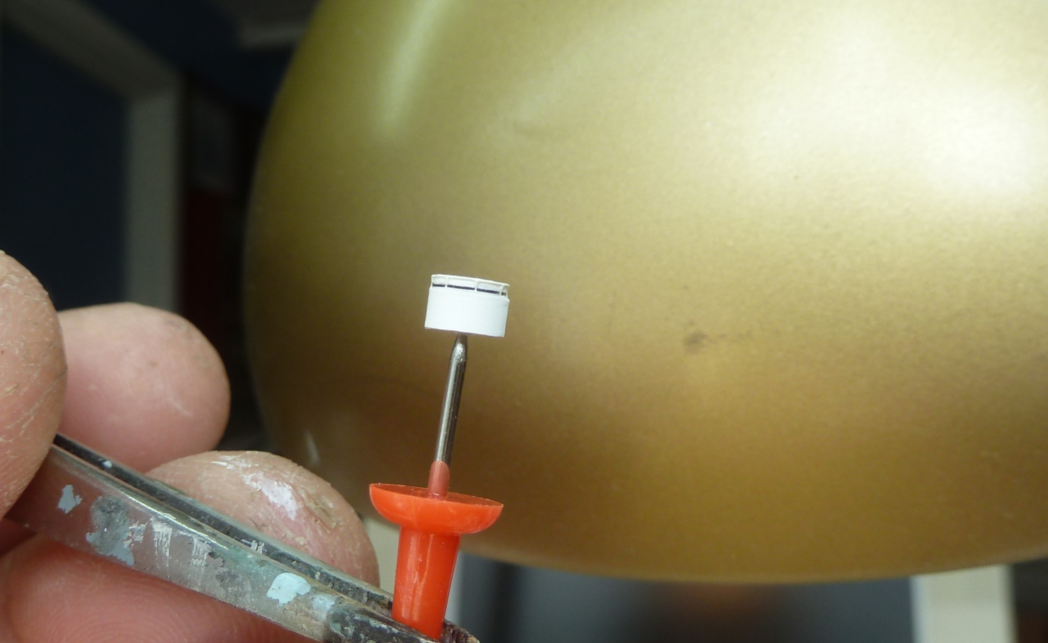

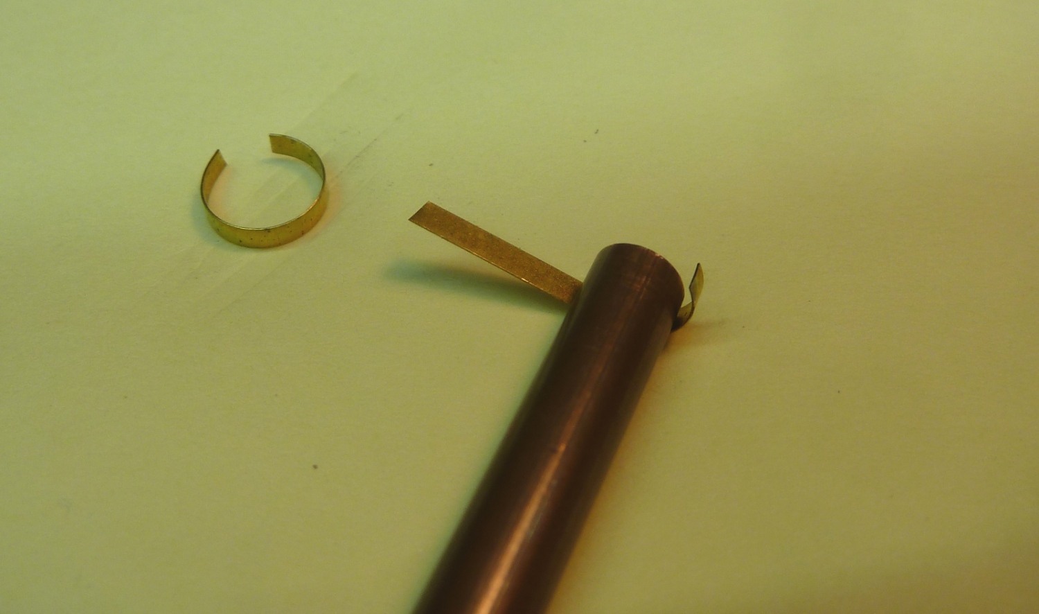

I removed the cast walls, ground down the insides
and made new walls of brass by rolling the brass strips on a post-it note pad with a piece of undersized tubing
surprisingly tricky to get the lengths EXACT for a clean join..(!! )
but the results were pleasing

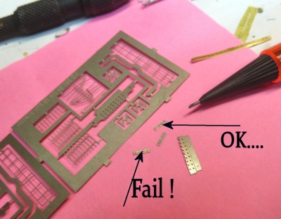

I spent considerable time looking through all my PE for possible sources of PE strips with suitably sized and spaced holes within
It took a while ..- but found some spare unused Regia Marina PE frets from my 1/350 Roma project a few years ago.
with a bit of deft cutting .... ( and a high rather UN-deft failure rate!! )
I was able to get something that looked acceptable

The Combrig model casting completely ignored the high torpedo net shelf ( This was lowered later in her career)
This high shelf did go around the 6 in gun turret sponsors, evidenced by the long legs supporting the net shelf in those area
I made the shelf of stainless steel PE waste strip along with cut-and-shut PE scrap pieces

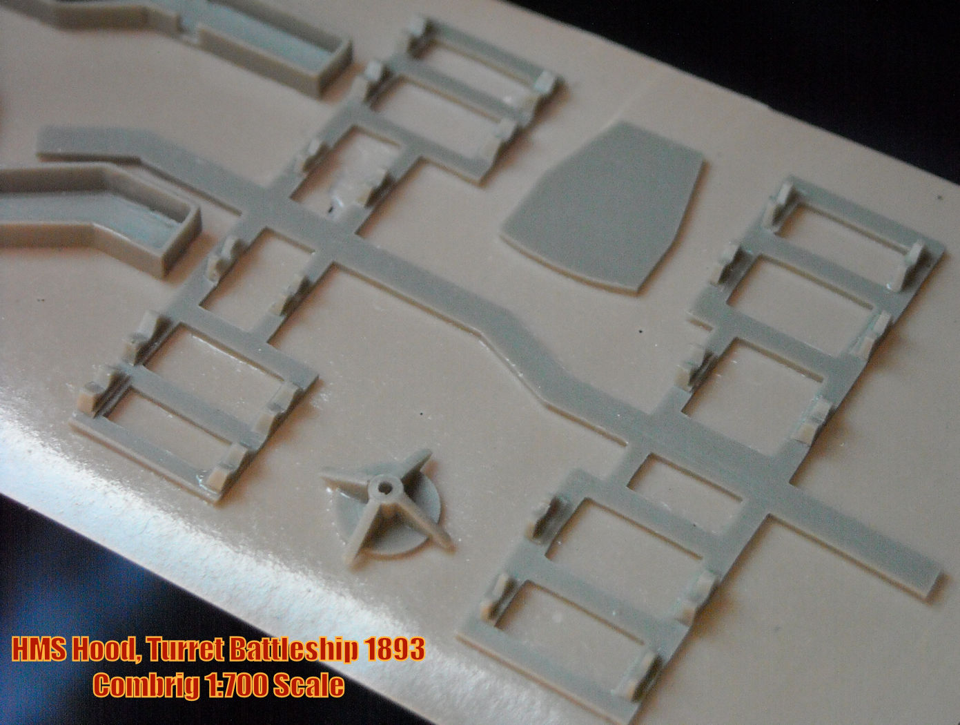

the cast resin boat skid structure as supplied by Combrig was simplified, chunky and fairly wrong !
(note: this photo is borrowed from the Steel Navy web-site review of this kit
-- as I broke and discarded my casting ) )
http://www.steelnavy.net/CombrigHood1893.html

It is decidedly tricky to extract the information for the ( more or less ) correct layout of these boat stow arrangements
as most drawings obscure it with the boats in place
Staring at the few large res photos I had show similarities( though not completely identical ) to the Royal Sovereign ,
drawings of which are available from the National Maritime museum ( at quite a price !! )
They do also have some original size artprints -low res -previews of these are online ( as the original drawings are 1.2 -- 2.6 meters long )
The most useful of these was the shelter deck drawing,
once I had fiddled with it on the PC and made it monochriome I found it easier to read/interpret
==> useful and helpful also was the Brian King 1/96 model of another RS class ship 'Empress of India'
though this also did not quite tally with the Hood photos ( do the drawings ever do so with photos ?! )

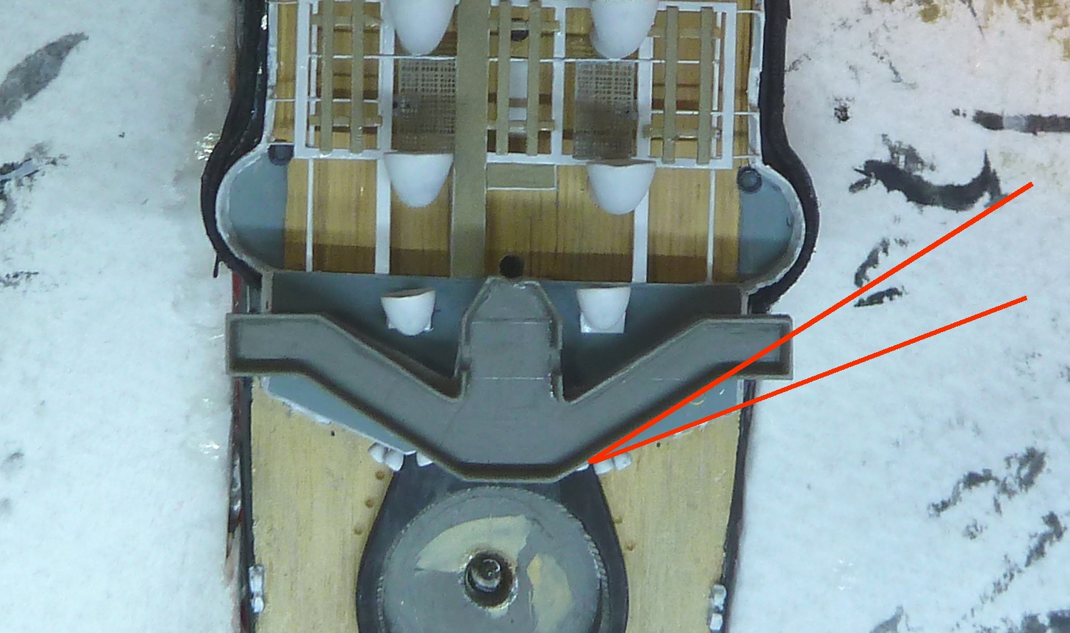

The issues were rather greater on the aft flying bridge
The kit part matched the drawings ok..( the red lines denote the angles running parallel of the superstructure and the bridge
at this point I nearly gave up on the model ...
as I think the drawings is accurate(ish) -==> but I fear the hull casting is not....
Tediously -- the casting when compared to photos actually looks ok--I have not yet established where it actually( is/ might be) wrong
I ( allegedly :cool_1: ) " suspect " the Hood overhead view drawing with the kit is an 'adjusted' version of the Royal Sovereign Burt drawings
with which it is completely and totally identical apart from the turrets
I have been hitherto unable to locate that Hood overhead view drawing, despite having both the new and old versions of Burts book
anyhow I digress-
-the kit part was in any case unusable--as the aft bridge wing angles need to be parallel to the superstructure-,-whilst clearing vents etc
some frustrating hours spent establishing the correct outline and relative proportions to gain correctly positioned overhangs
not as easy as it seems..
( it was made more difficult by me having installed the conning tower and vents /... doh! :doh_1:
I reached an acceptable compromise shape that looked about OK-- more of that soon

so set about installing the forest of cowl ventilators on foredeck , midships and aft.
Not all of the possible vent positions would have been used all the time at sea...( or in port)
so I made and installed many of the vent 'stub' positions as well

....... and having fun again at last...... I made the aft hawse-pipe surrounds

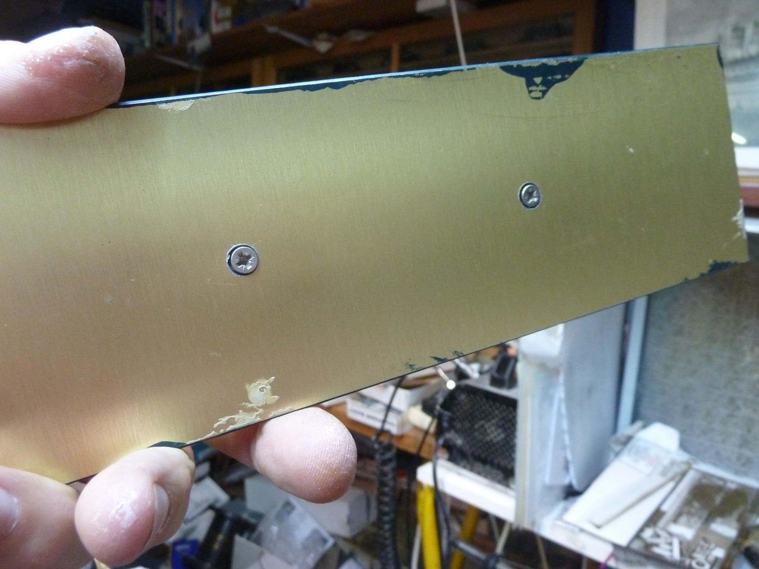

and the very large prominent bow-crest-- made of thin brass-wire twirled around other small wires and flattened
whilst not EXACTLY the same - the outline and proportions are about right
with some gold paint added and a bit of touching up it looked a bit crisper
( note also the low black coaming bulwark added of brass at the bow)

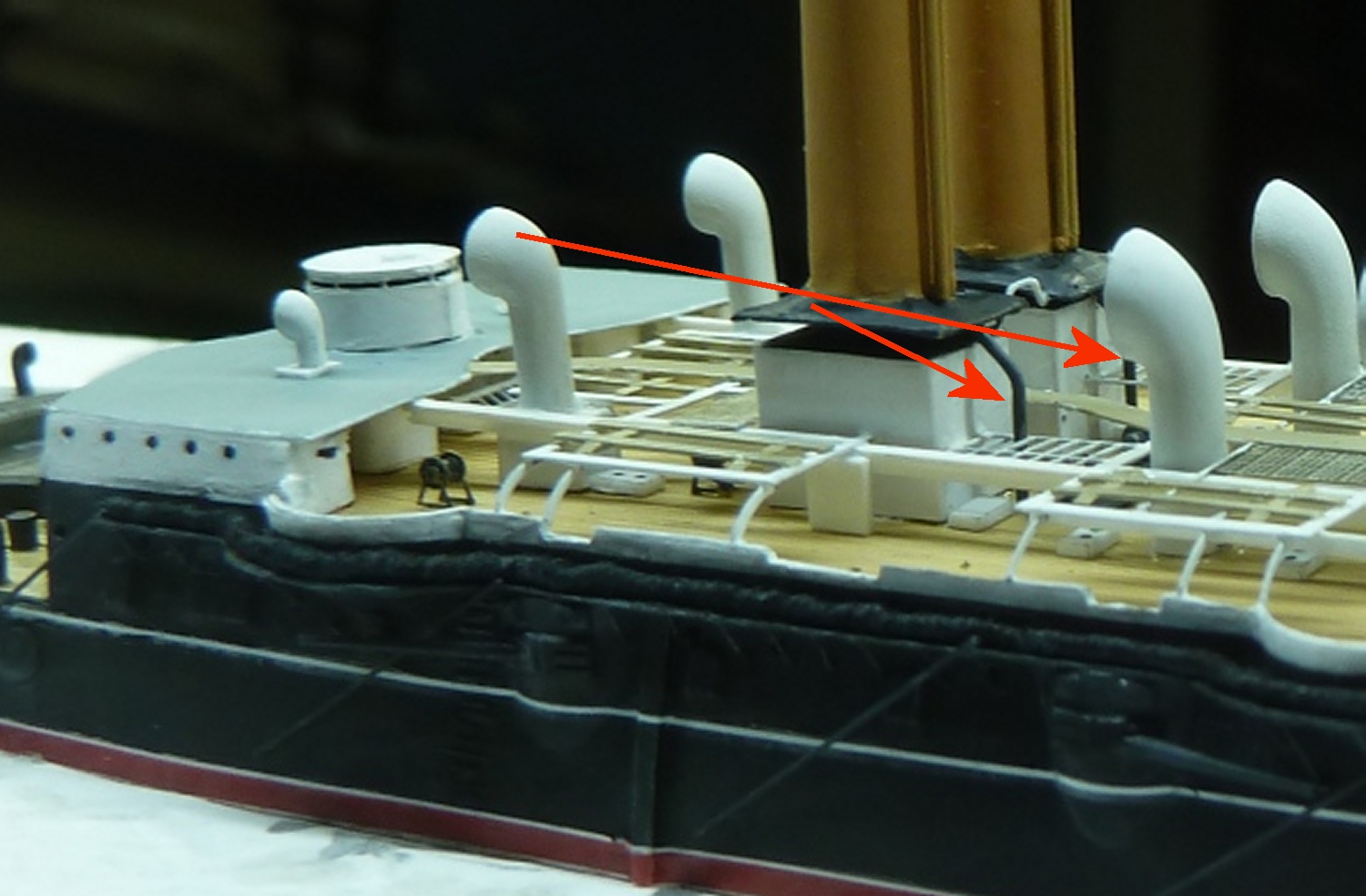

Back to obsessive minutia....
this is the ONLY image(I have found so far ) where these steam pipes are clearly identifiable-usually obscured by ships boats
-and as far as I can ascertain the other sisterships did not have them (?!)
they were fiddly to make and install
With the imminent building and installing of the flying bridges and their spindly supporting legs I think the model will start to look more interesting soon
JIM B :wave_1:
