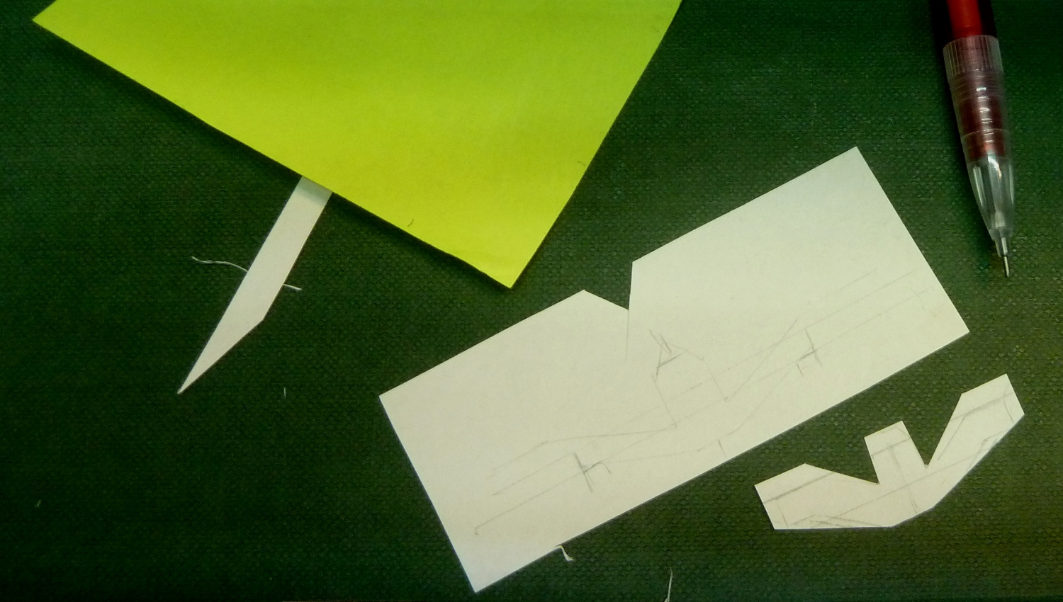

and I approached it in a similar fashion;
--after making paper templates of the decks ,

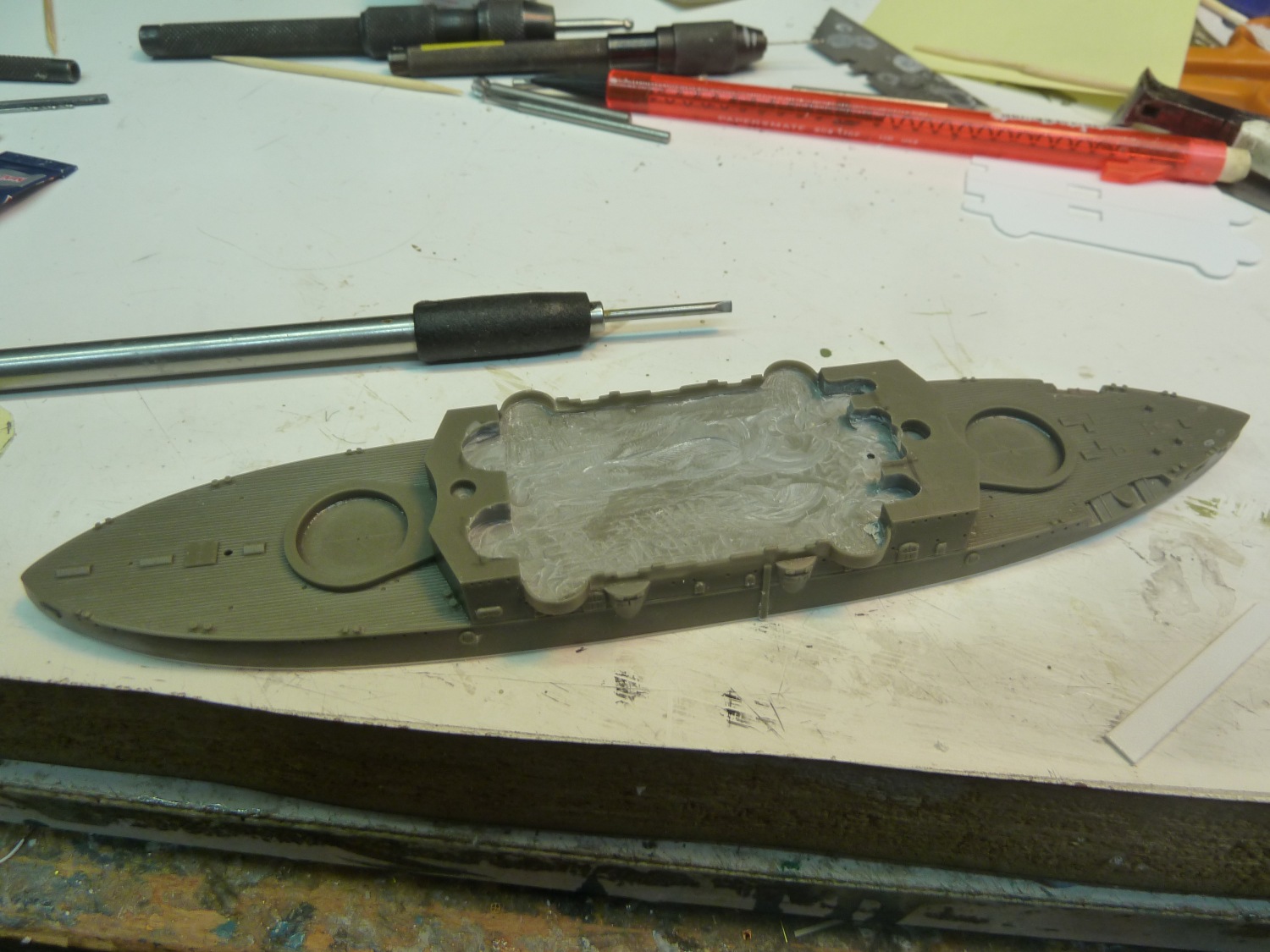

the tools I used were various undercutting dremel type heads in a mini-drill
I started grinding down the entire boat deck base to
make it lower to be able to accommodate the new deck to the correct height.
it was not pretty
after some smoothing and cleaning with a micro-chisel

I agonized about the portholes--trying to cut the the lids of paper and drawing them on, I tried drilling brass--
but it all was just not neat enough,
better under-scale than overscale and wonky!
I spent considerable time looking through all my PE for possible sources of PE strips with suitably sized and spaced holes within
It took a while ..- but found some spare unused Regia Marina PE frets from my 1/350 Roma project a few years ago.
with a bit of deft cutting .... ( and a high rather UN-deft failure rate!! )
I was able to get something that looked acceptable
it was equally empty as per the original Combrig casting...
