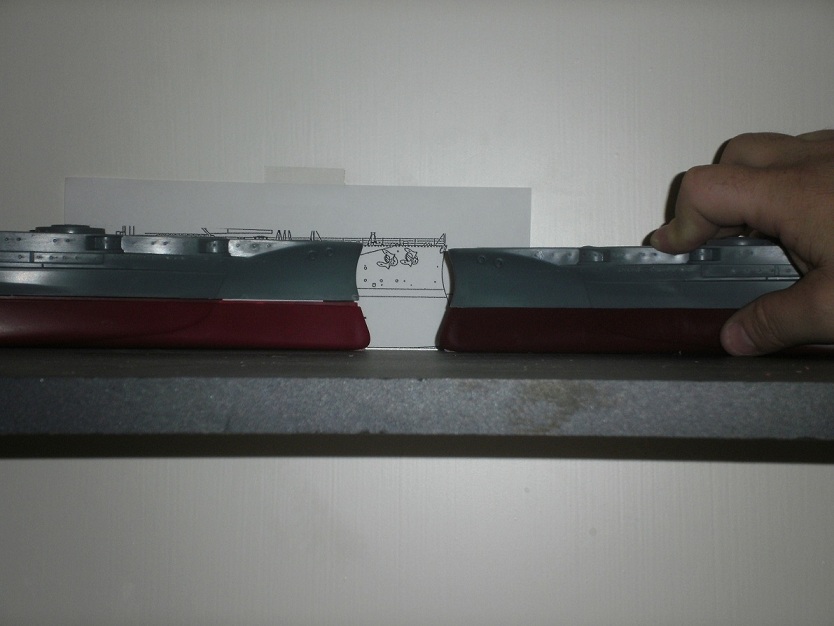

Hi all , while trying to get my 1916 Arizona right to drawing I think I have found a fix for the Banner 1/350.
the hull assembles too short on height by around 2mm, when measured against the morski and the Chesley dwgs. I think what they have done is instead of adding the flange to the lower half of the hull , they have cut the flange into the lower half thereby loosing around 2mm in height.
you can see my fix here http://s673.photobucket.com/albums/vv94 ... na%201941/
I also added putty to the stern so that I will be able to reshape the bottom to get the prop shafts to enter the hull at the correct positions.
http://i673.photobucket.com/albums/vv94 ... 080003.jpg
cheers Jay

here is just a comparison shot , I know there is some parralex error involved but you get the ideaEnsign Jay wrote:Hi all , while trying to get my 1916 Arizona right to drawing I think I have found a fix for the Banner 1/350.
cheers Jay
http://i673.photobucket.com/albums/vv94 ... 190007.jpg
this seems to bring it close to dwg
cheers Jay
