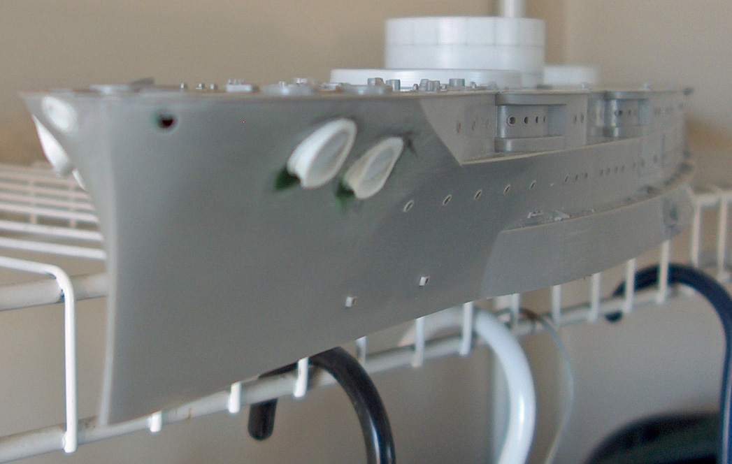

Re: Unboxing Arizona
Sadly, Loren Perry said he probably won't do a dedicated set for this kit
Also, my kit is still in transit, so I haven't laid eyes on it yet. Any of you guys who actually have it have any further insights into the upside down anchor and paravane hawse pipes? Is there a simple way to turn them around? I'm wondering if just scribing around the edge of the raised area on the outside of the hull until you go through (maybe thin down from the inside first?), then just rotate and re-glue. I'm sort of thinking out loud. Either way, that's gonna be a PITA if you display your model on a base with the anchor down as I plan to.
- BFR4570
- Posts: 403
- Joined: Sun Jul 25, 2010 5:13 am
- Location: Tucson, Arizona
Or with the anchor up, either. The anchor won't fit through the hole as molded. Unfortunately, the hole seems to have been molded in line with the outer part, so the hole actually lines up with the Hawserpipe on the opposite side, NOT with the deck. I don't know if it will work, but I plan to cut mine out with a Jeweler's saw, hole and all, and turn it to the proper orientation. I hope that will align it closer to the Deck hole. The deck holes may be off a smidge also. They don't appear to have as much angle away from the centerline as in pictures of the bow of the Arizona. But if I can turn around the Hawsepipes, and they can align with the Deck holes, I won't care how off they are. A 2/0 Jeweler's blade is smaller than a #80 drill bit, to my eye. I haven't measured one yet. So it won't remove much material around the Hawsepipe. I plan to angle in from the outside of the Hawsepipe frame to just outside the hole on the inside of the hull. If I can be careful enough, it should leave the hull with an angled hole and I can just turn the Hawsepipe 180 degrees and drop it back in. I hope! As for the Paravane Hawsepipes, right now, I don't have a clue because they are right near the top edge of the hull and cutting them out may maess up the fit of the bow section of the deck. So I am thinking I may need to fill and re-drill them. What do the rest of you folks think?
Tracy White
- Posts: 10632
- Location: EG48
The lip and the hole in the hull for the hawse pipes were set up around the molding.... they're perpendicular to the side of the ship. BFR isn't *quite* correct when he says they just need to be rotated, but he's close. Hawse pipes were not straight; they were curved so that the wearing of the chains was more even. So any modeler is going to be hard pressed to pack & redrill the actual way the hawse pipes traveled, unless you have a curved drill bit.
I haven't looked at it in any detail, but I've had similar models and was able to carve away the top of the hole somewhat on the hull so that it matched the opening above better. This works OK when you have an anchor stock present to hide things, but for Arizona, where she had four holes and I think only two anchors present on December 7th, what do you do for the wide open hawe pipes?
One thing I might try is packing as you suggest, with something like Apoxie Sculpt or Milliput, then drilling when it's still curing, and further boring and shaping with a wet Q-tip before it sets. A wet Q-tip should be a workable tool given the size of the pipes. This is a technique I haven't tried before though, and it may very well be a disaster, so take that with a grain of salt and experiment with one of the holes that will have an anchor in it in case you need to cover something up!

Tracy White
- Posts: 10632
- Location: EG48
Jon asked me to post these:
- Jon C Ryckert
- Posts: 592
Thanks Tracy for posting those for me. What I have done is not perfect by any means but hopefully I'll be able to get somewhat close to how it should be done. I spent a couple of evenings sanding away on both sides of the bow to get a more 'hour glass' shape to it but I'm running out of plastic just in front of the hawse pipes so I'll stop where I'm at. Unless I want to fill the inside hull cavity with epoxy resin or putty etc... and keep sanding , I just can't get the shape right with what the kit gives us. Anyways, there is still alot to do regarding the hawse pipes, two of them need to be reworked so they are more narrow to match pics and plans. Gotta go, Jon
p.s. Thanks again Tracy

How about drilling a smaller hole and opening it up with a round needle file, adding the curve by hand?Tracy White wrote:The lip and the hole in the hull for the hawse pipes were set up around the molding.... they're perpendicular to the side of the ship. BFR isn't *quite* correct when he says they just need to be rotated, but he's close. Hawse pipes were not straight; they were curved so that the wearing of the chains was more even. So any modeler is going to be hard pressed to pack & redrill the actual way the hawse pipes traveled, unless you have a curved drill bit.
