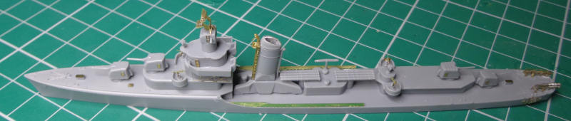

Hello, my name is Steven from Belgium and I'm going to show my 1/700 CV-5 Yorktown and destroyer build, which is already quite advanced by now. The carrier has been built up to most of the photo-etch details, I decided to use the WEM detail set because of the overscaleness of many tiny kit parts like the AA-cannons and DP-guns. Currently I'm building its escort, the USS Hammann, from the newest Tamiya waterline kit and - like some of my colleagues here - embellishing it with TMW's photo-etch. I'm very pleased that this configuration for the Yorktown has become possible by Tamiya's issuing the destroyer last year. I'll start my build log with some images of both models. The last three photos are from Hammann.

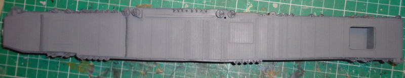

Hi, Taskforce. I guess that would be the easiest to do, because most of the deck pictures are taken on that day. I took care to admister the starboard side of Yorktown with .50 guns, as seen on the most famous picture of the island of cv-5.

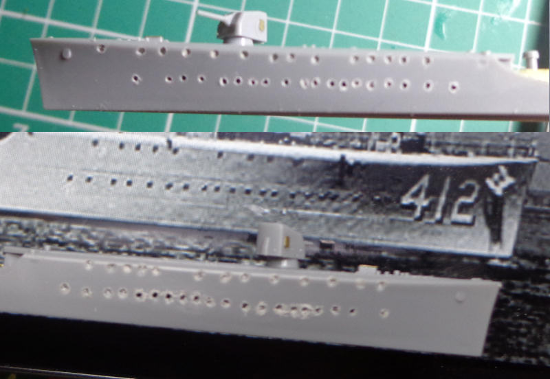

And I hate to be a bearer of bad news, but...
From this wartime photo, it appears the lower row of portholes were covered up by the time of her demise. I don't know what time period you are depicting the two ships, but with the lower row of portholes now drilled open, it seems that you can only portray them in prewar colours/fit.

Well, that is not very funny to discover, but at least it's not a terrible setback. I'll fill them up again. The picture dates from short before Midway, if I'm right. Thanks for this very valuable information, Timmy!

It took me a little while to recapitulate on the Hammann's porthole errors, but after almost 6 years and one address change I find the courage to end this project. I'm also armed with better paint provisions and some experience with waterline settings in the Princeton diorama, so I should be able to finish this in a few weeks.
I found this narrow base frame. They are quite close like this.
I had to redrill the wrong porthole row, to be able to insert the Evergreen slices. Now I only had to do a little clipping, sanding and filling up the seams.

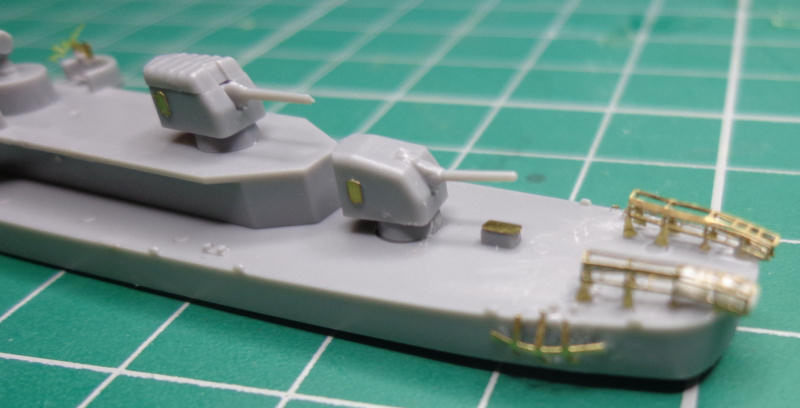

After adding the anti-submarine mortars, it should be ready to paint the deck.

The railing for both ships is now almost completely added after painting. I used grey Tamiya primer and Lifecolor ocean grey:
Hamman in fact was more difficult, because the pattern for railings is more complex and curved.
I had some difficulties trying to figure out how the PE railing was to be applied. In stead of readymade lengths for the forecastle and heck portions of railing, or otherwise generic railing parts without detail, you get 6 equal lengths as large as the fret, but with some seemingly random oblique stanchions and shortened intervals. No doubt these were copied from certain pictures, but the manual doesn't assist in the placement details, while it does for all the other additions there are for these ships. Therefore I cut the railing quite random and put it not symmetrically.
SC radar was provided by Tom's, so I deleted the plastic part around the masttop and fine-tuned it a bit. I discovered a waterline cover in the kit, which now could not be sanded on the already painted hull. It was added and painted black by hand.
Mk.12 antenna went down once again.
Railing on the bow went smoothly.
Catwalk is added. K-guns were forced upwards to get the railing on straight. The chocks on the kit make this difficult. Look for the life raft supports, these replace parts to be removed from the upper deck.
