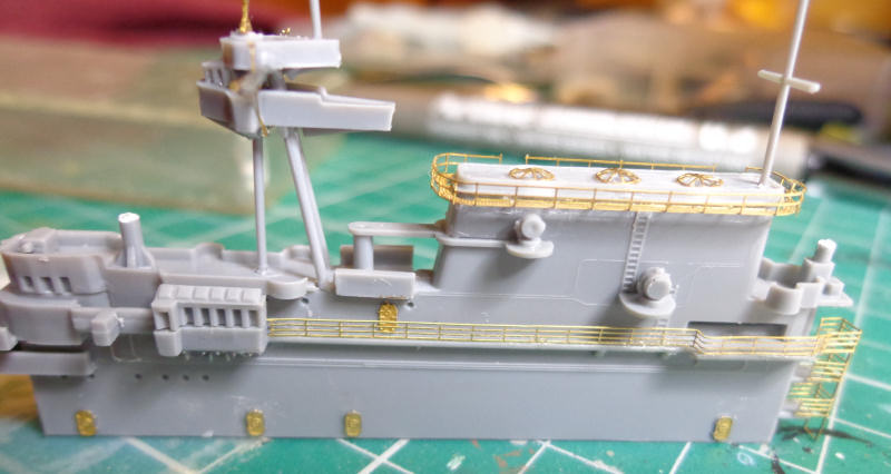

Hello, my name is Steven from Belgium and I'm going to show my 1/700 CV-5 Yorktown and destroyer build, which is already quite advanced by now. The carrier has been built up to most of the photo-etch details, I decided to use the WEM detail set because of the overscaleness of many tiny kit parts like the AA-cannons and DP-guns. Currently I'm building its escort, the USS Hammann, from the newest Tamiya waterline kit and - like some of my colleagues here - embellishing it with TMW's photo-etch. I'm very pleased that this configuration for the Yorktown has become possible by Tamiya's issuing the destroyer last year. I'll start my build log with some images of both models. The last three photos are from Hammann.

Steven,
Welcome aboard, looks like you are off too a great start. Are you doing them as on June 6th or before?

Hi, Taskforce. I guess that would be the easiest to do, because most of the deck pictures are taken on that day. I took care to admister the starboard side of Yorktown with .50 guns, as seen on the most famous picture of the island of cv-5.
