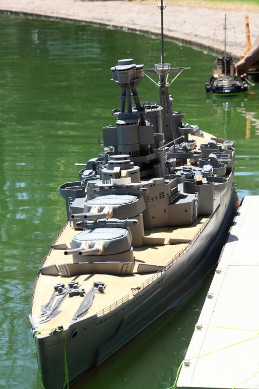

Re: Calling all HMS "Mighty" Hood fans
Here is a pic of my club mate Warner's 1/72 HMS Hood at todays running day
Cheers Bruce
