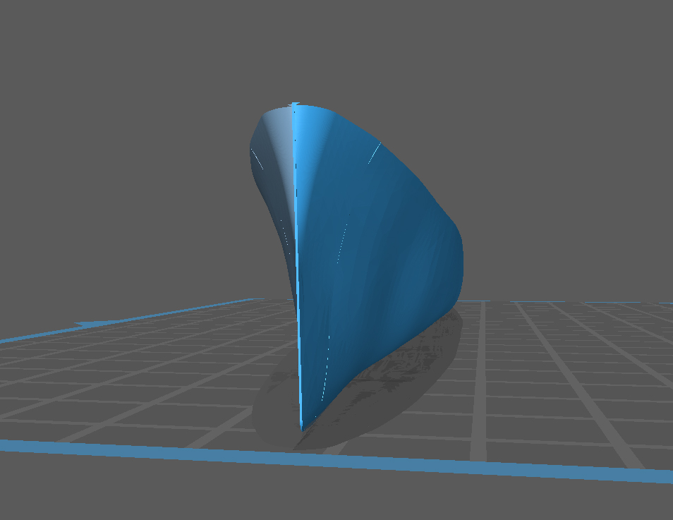

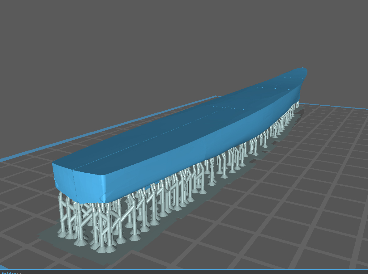

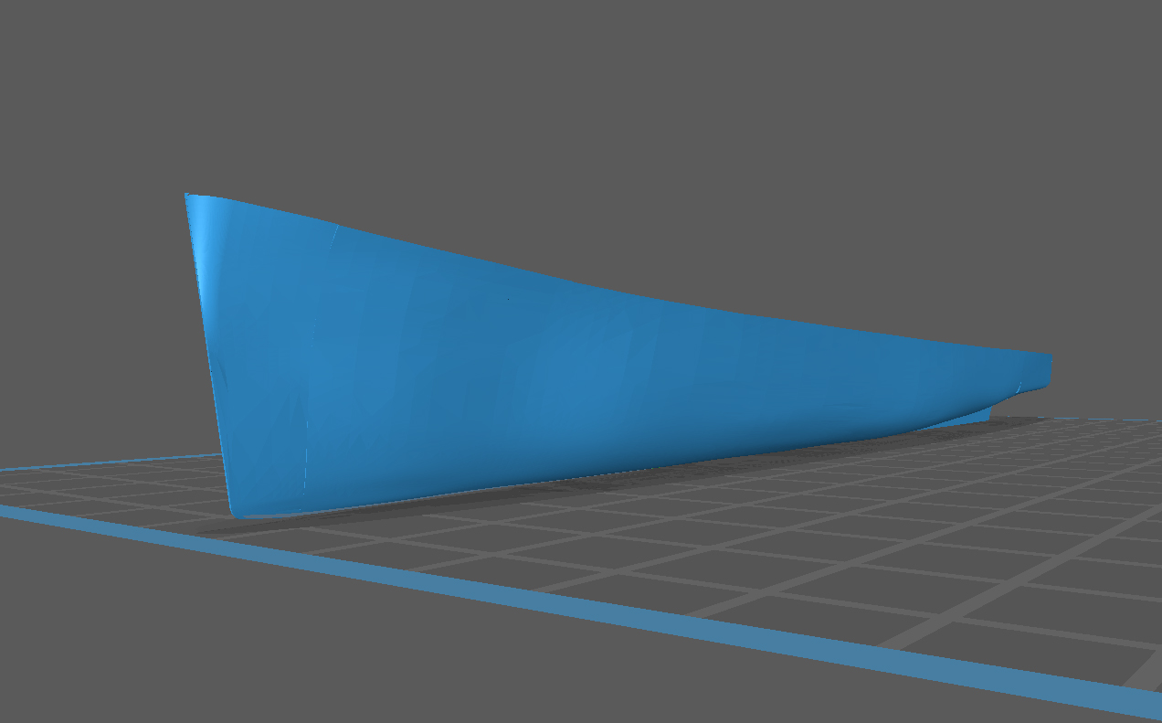

A series of Chitubox images of my 1:500 test hull.
The program I am using is capable of many things, ship hulls is not one of them so considerable legerdemain is required to get a hull that may need minor filling and sanding.

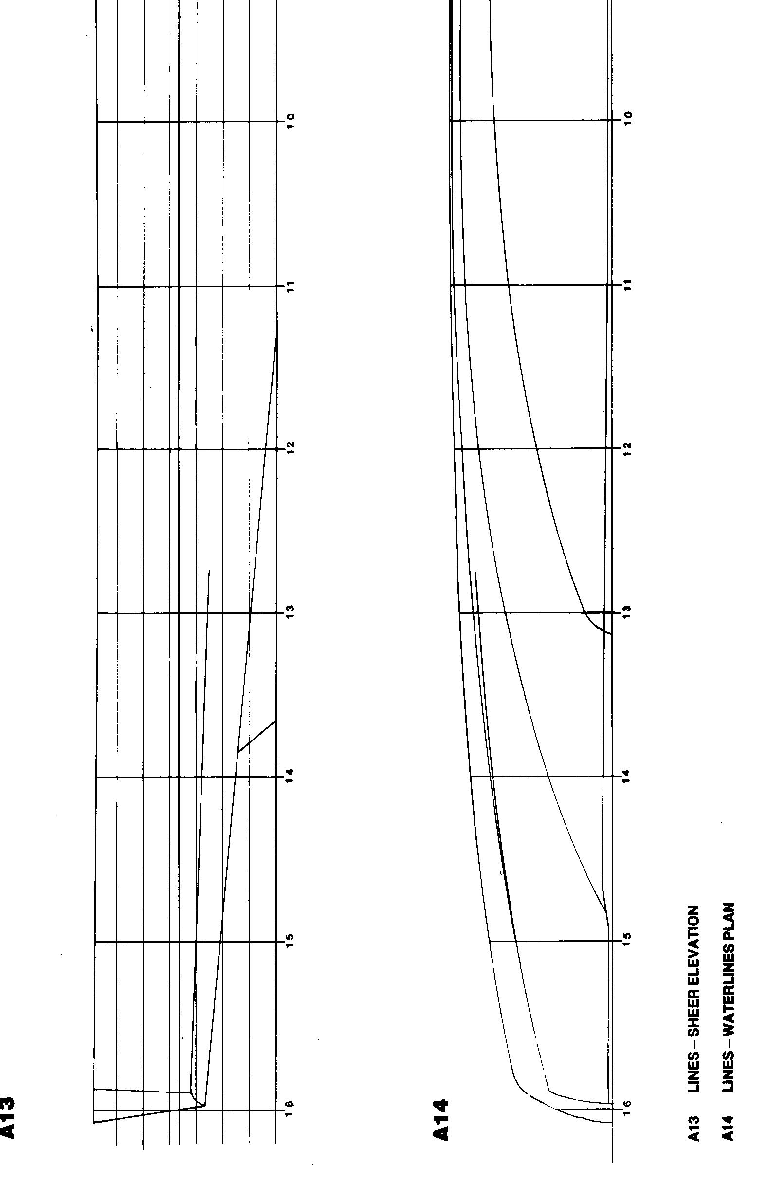

Do you have the Table of Offsets for the ship? Taking lines off of hull lines drawings is problematic, especially on small scale drawings. This is especially true when trying to work from scanned paper drawings.
For my OK City model I started with paper drawings from The Floating Drydock and discovered a serious error in the resulting CAD model between the lines for the front and rear halves of the hull.
Then I ordered microfilm from the National Archives and found the Table of Offsets. I entered the numbers into a spreadsheet and saved the data as comma separated variable (CSV) files. I read these into my CAD program and it generated all the section lines automatically, accurate to within 1/16 inch full scale (0.00065 inch at 1:96). The result was a very accurate CAD model of the molded hull (to the outer surface of the frames at the inside of the hull plating). There is no way I can actually build a physical model to this degree of accuracy!
The microfilm also included the Table of Hull Sight Lines. These were descriptions of the location of the horizontal edges of the hull plating strakes. This information was used to position the hull plates in the ways as the ship was being constructed. It is impossible to derive all of this information from hull lines drawings or from the hull plating diagrams. But the plating diagrams do show the weight (thickness) and dimensions of individual plates, and that allowed me to build the CAD model plate by plate to the correct outer dimensions.

It is interesting to see the variation in plating thickness over different parts of the hull, for a small ship generally the below waterline plating thickness was thicker. No I do not have the table of offsets and unfortunately my fairly simple 3D deign program would not be able to utilize them. More advanced CAD instruments have far greater capability but as an amateur (rank) buying one (or leasing) is not currently proportionally sensible given the earning curve. It's amazing we modelers do as well as we do considering the Model making companies often commit serious errors in producing kit runs, which must total millions in total investment. One can't be sure the actual ship is within 1/16" of planned dimensions as built.
At least I would expect drafted hull lines to be within a line width, not several feet off. Perhaps some day I will acquire and learn a more advance 3D program, the one I have is satisfactory for most ship model building tasks. Hulls? No. As far as I know NARA employees have not returned from Vacation? Good work if you can get it. Perhaps someone has an update?

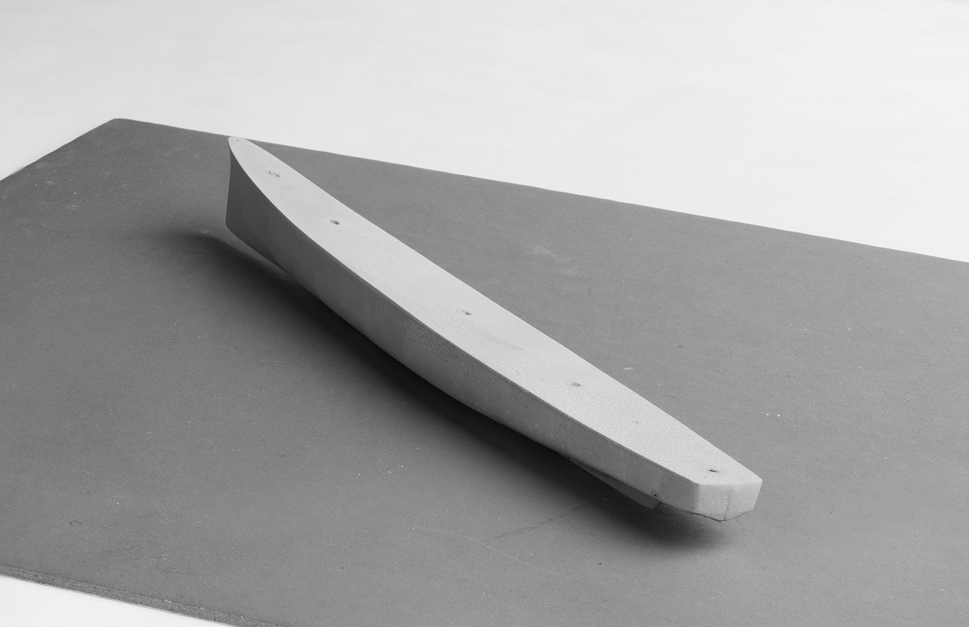

I'm still in the data gathering phase, though I did print out a 1:500 test hull, from which I learned a few things. Yes, primary sources are always the best!

A printed trial hull in 1:500. Learned a few things. The holes on the deck are weep holes to let fluids escape from the otherwise closed interior. If I do print a larger hull it will be in sections without this particular issue of trapped fluids.

I am currently as experimentation printing this hull in 1:550 vertically as opposed to horizontally as I have been experiencing curvature on drying and curing. So far the vertically printed hull is going well, doing it this way I could add the bilge keels which would not work out with the hull horizontal. A few more hours to go, it does seem the hull sprinting a little faster than the originally prognosticated time. If I do this again I'll try a .05 rather than a .035 mm layer thickness as there is really no detail. My primitive program certainly does not allow the capability of Pascal like weld lines and rivets on the hull surface. I'll have to look into the 3D max, I might have had it on some long dead computer as I remember trying to make a buzz bomb (flying) for flight sim.
