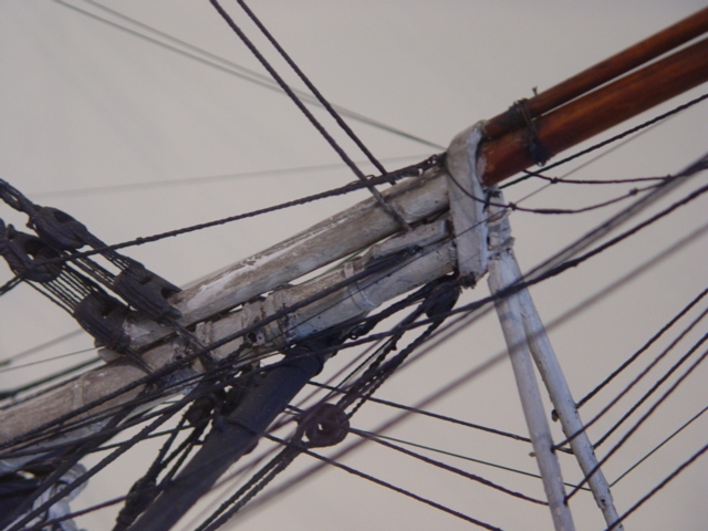

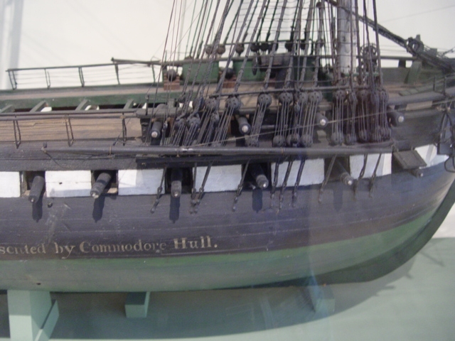

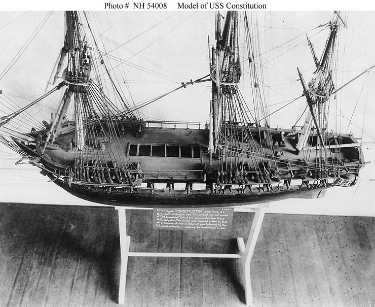

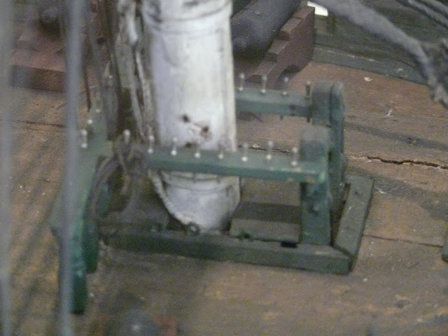

Smithsonian Museum's 1/48 scale model of USF Constitution.The three photos below are National Archives photos of the famous "Hull Model" named for the model's first owner and ship's captain at the time, Isaac Hull.
The Hull Model of USF Constitution was made by the real ship's crew and presented to their captain, Isaac Hull, as a gift just after their War of 1812 victories. The model now rests in the Peabody Museum in Massachusetts. Since the model was made by actual crew members it is considered to
definitively show Constitution's true War of 1812 appearance. Certainly the ship's own crew knew what their ship looked like and built an accurate representation for their captain.
Of the many injection-molded plastic kits now commercially available
the Revell 1/96 scale kit most closely resembles the Hull Model.
Note that Hull Model shows that Old Ironsides only carries gun port lids at the extreme bow. Period documents confirm that Old Ironsides carried
no hinged lids at this time. Those lids that were present were removable and stored below decks prior to going into action.
Also note the coloring of the masts and fighting tops (white) and yards (black) and that this model of
Constitution does not carry her name on the transom.

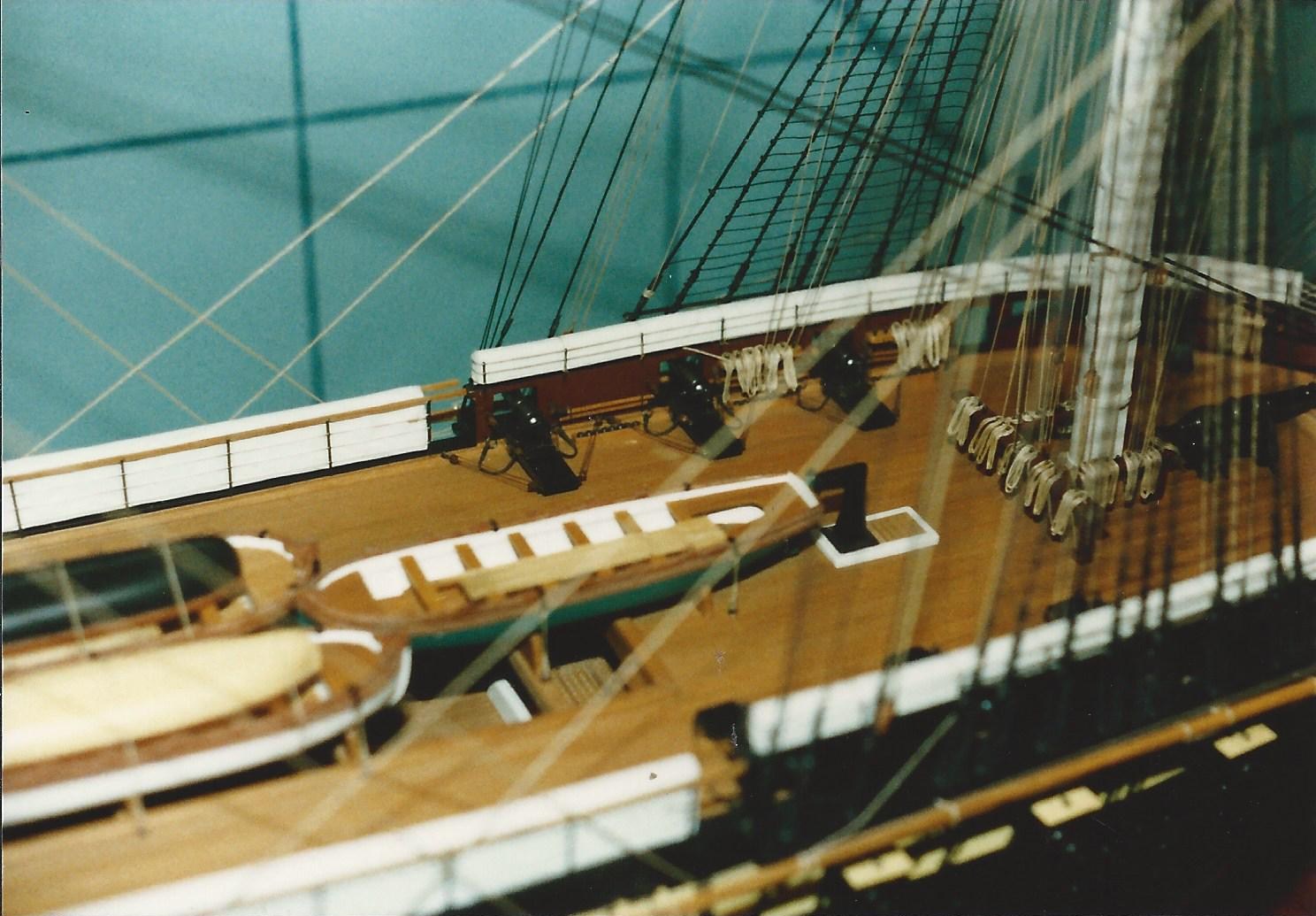

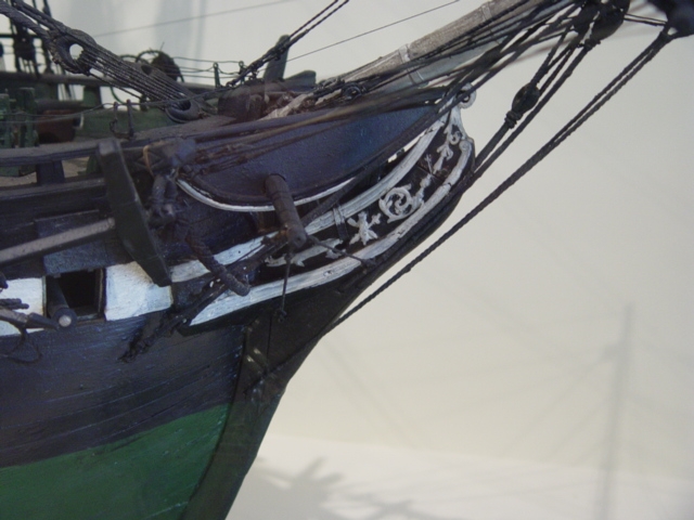

Compare the Hull Model photos to those of the Smithsonian Museum's 1/48 scale USF Constitution model which was built from early plans and using the Hull Model as a significant reference. The Smithsonian's modeler(s) chose to paint the gun deck stripe an off-white, very similar in tone and hue to what we today might call "radome tan". The rigging of this model is nearly identical to the Hull Model in arrangement.
Some sources state that about 1809, her inner spar deck (upper deck) and forecastle bulwarks may have been painted "red ochre", a common practice at the time. The Smithsonian model is painted this way. Sometime between 1812-1815 her inner spar deck and forecastle bulwarks were repainted from red ochre to green as they are today on the actual ship at Boston. The Hull Model's inner bulwarks, rails and trim are painted green as is most of the spar deck trim moldings and the pinrails. During the War of 1812 it is believed that the inner bulwarks of the gun deck, one deck below, were whitewashed to aid in visibility. Also note that the Smithsonian model's boats are all individually colored. This is consistent with period practice in order to help identify individual boats at a distance at sea.

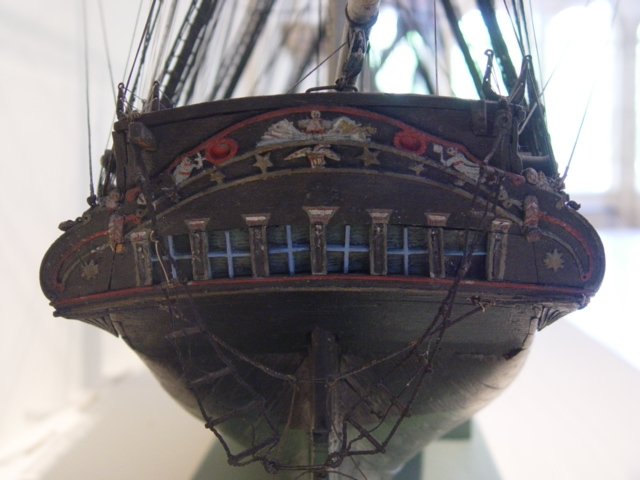

Compare the 1804 Corné painting to this superb model in the possession of the US Naval Academy Museum.
