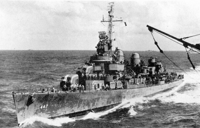

I about about to start my first build , I think I've done my research to where I got everything but looking to verify.
My planned build is the Jenkins early mid 43' and has been in first modification. Before the December 43' major refit.
Tamiya 1/350 Fletcher.
Eduard PE
5"/38s taken from The Sullivan's kit.
Keeping double 20mm on P/S midships.
Keeping Original High 40mm tub.
Adding rear tear drop 40mm tub
Adding bridge 20mm
Adding Top 20mm
And in MS21 Camo
Is this correct????

In early 1943, yes Ms 21 would be correct. USS JENKINS was painted in Ms 22 when she operated off North Africa for Operation Torch. Likely she went to the Pacific in Ms 22, but would have repainted shortly afterwards.

So Rick or Any others.
Great thanks for that info, So Would my post above about layout be correct for the reference picture. For my build.

I wasn't sure you were using the attached image as the baseline for your build. So I couldn't full address her 20-mm armament.
That image is dated 2 September 1943, as seen alongside USS SARATOGA (CV-3), and she is in well worn Ms 21.
USS JENKINS (DD-447) configuration at that time was;
Five Single 5-in/38 mounts
Two Twin 40-mm mounts; (elevated position between 53 and 54 mounts and fantail)
Eight Single 20-mm guns; two forward of bridge at 01 deck level, one in an elevated centerline platform forward of the bridge, one atop pilothouse, and two on both portside and starboard amidships on main deck.
Two Quint 21-in Torpedo Tubes mounts
Six K-guns with post arbor reload storage for depth charges
Two Depth Charge Drop Tracks
Also, she had the SC-1 radar, SG radar, BL "Stovepipe" IFF antenna, and TBS antenna on foremast.
